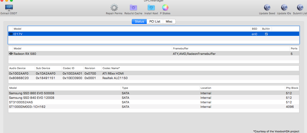

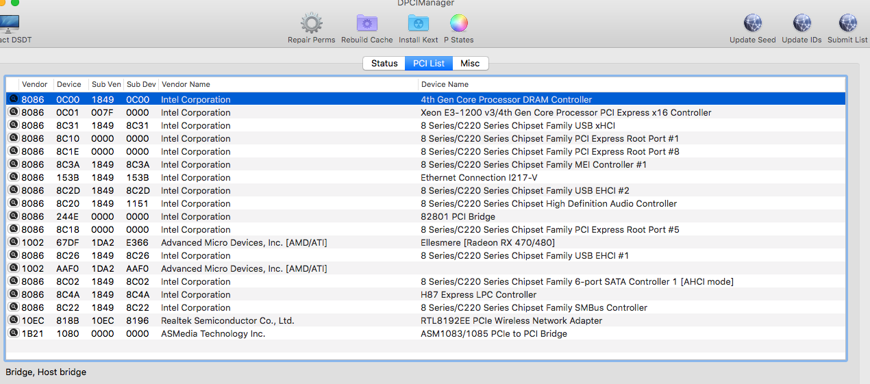

gengik84 Posted December 7, 2018 Share Posted December 7, 2018 posta nuovamente le immagini di dpci manager Quel wifi su 10.13 funziona benissimo già ti avevo detto. rimuovi questo kext VoodooTSCSync.kext Link to comment https://www.insanelymac.com/forum/topic/336718-high-sierra-su-asrock-fatal1ty-h87-performance/page/3/#findComment-2652478 Share on other sites More sharing options...
freek Posted December 7, 2018 Author Share Posted December 7, 2018 Link to comment https://www.insanelymac.com/forum/topic/336718-high-sierra-su-asrock-fatal1ty-h87-performance/page/3/#findComment-2652479 Share on other sites More sharing options...
gengik84 Posted December 7, 2018 Share Posted December 7, 2018 non vedo alcun wifi atheros... vedo solo un RTL8192 Link to comment https://www.insanelymac.com/forum/topic/336718-high-sierra-su-asrock-fatal1ty-h87-performance/page/3/#findComment-2652480 Share on other sites More sharing options...
freek Posted December 7, 2018 Author Share Posted December 7, 2018 3 minutes ago, gengik84 said: non vedo alcun wifi atheros... vedo solo un RTL8192 anche io..ma ho solo quella scheda wifi inserita.. Link to comment https://www.insanelymac.com/forum/topic/336718-high-sierra-su-asrock-fatal1ty-h87-performance/page/3/#findComment-2652484 Share on other sites More sharing options...
gengik84 Posted December 7, 2018 Share Posted December 7, 2018 Quel wifi monta un chipset atheros.. credo che tu abbia preso la V2... Link to comment https://www.insanelymac.com/forum/topic/336718-high-sierra-su-asrock-fatal1ty-h87-performance/page/3/#findComment-2652486 Share on other sites More sharing options...
freek Posted December 7, 2018 Author Share Posted December 7, 2018 (edited) si..è la v2..la rimando indietro, lho presa da amazon, ma quelle usb come vanno? perchè a parte che mi scoccia tirar fuori altri soldi..ho appena preso vga,ssd e altri 8Gb di ram..se poi mi arrivano come ora versioni non supportate..che palle.. Edited December 7, 2018 by freek Link to comment https://www.insanelymac.com/forum/topic/336718-high-sierra-su-asrock-fatal1ty-h87-performance/page/3/#findComment-2652487 Share on other sites More sharing options...
gengik84 Posted December 7, 2018 Share Posted December 7, 2018 la versione normale monta atheros (AR9287) e questa è compatibile wifi usb, ci sono alcuni che funzionano, ma in generale danno alcuni problemi come per esempio lo sleep Link to comment https://www.insanelymac.com/forum/topic/336718-high-sierra-su-asrock-fatal1ty-h87-performance/page/3/#findComment-2652488 Share on other sites More sharing options...
