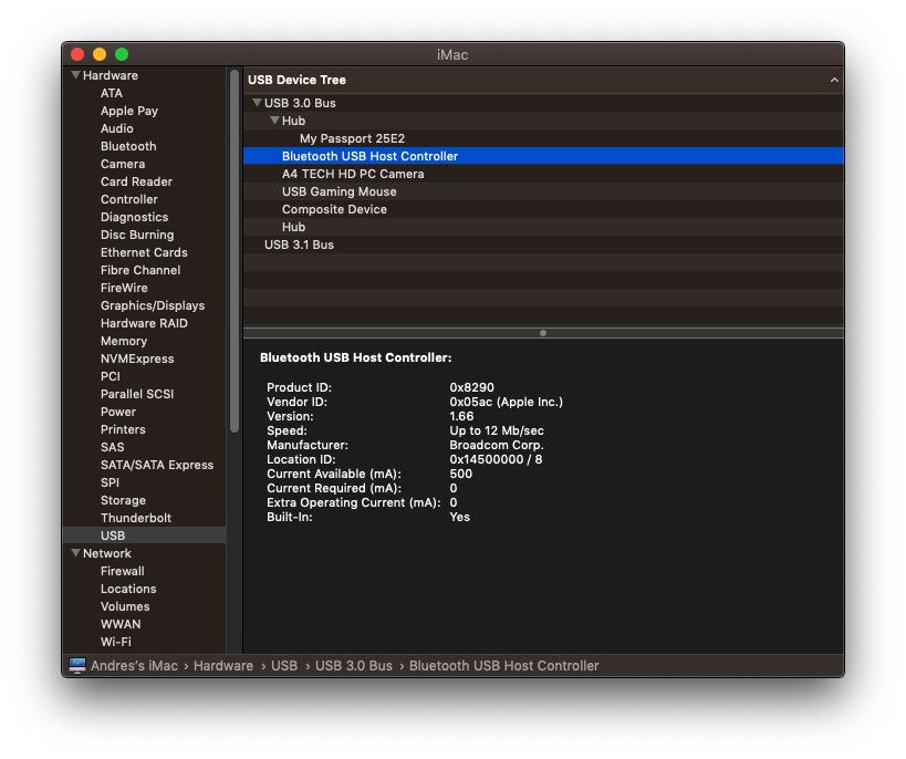

Andres ZeroCross Posted November 23, 2018 Share Posted November 23, 2018 Hope you'll find this info useful. To check bluetooth device is go to About This Mac -> System Report -> USB, and klik your bluetooth device. Product id and vendor name will be shownSent from my Mi Note 2 using Tapatalk Link to comment https://www.insanelymac.com/forum/topic/336413-can-someone-help-me-with-mojave/page/3/#findComment-2649292 Share on other sites More sharing options...
Shogun212 Posted November 23, 2018 Author Share Posted November 23, 2018 3 minutes ago, Andres ZeroCross said: To check bluetooth device is go to About This Mac -> System Report -> USB, and klik your bluetooth device. Product id and vendor name will be shown Sent from my Mi Note 2 using Tapatalk Link to comment https://www.insanelymac.com/forum/topic/336413-can-someone-help-me-with-mojave/page/3/#findComment-2649294 Share on other sites More sharing options...
Andres ZeroCross Posted November 23, 2018 Share Posted November 23, 2018 So you can't read my comment carefully. I said About This Mac -> System Report - > USb -> Bluetooth Device.Sent from my Mi Note 2 using Tapatalk Link to comment https://www.insanelymac.com/forum/topic/336413-can-someone-help-me-with-mojave/page/3/#findComment-2649297 Share on other sites More sharing options...
Shogun212 Posted November 23, 2018 Author Share Posted November 23, 2018 2 minutes ago, Andres ZeroCross said: So you can't read my comment carefully. I said About This Mac -> System Report - > USb -> Bluetooth Device. Sent from my Mi Note 2 using Tapatalk Usb doesn't show any bluetooth info, like it doesn't exist. Link to comment https://www.insanelymac.com/forum/topic/336413-can-someone-help-me-with-mojave/page/3/#findComment-2649300 Share on other sites More sharing options...

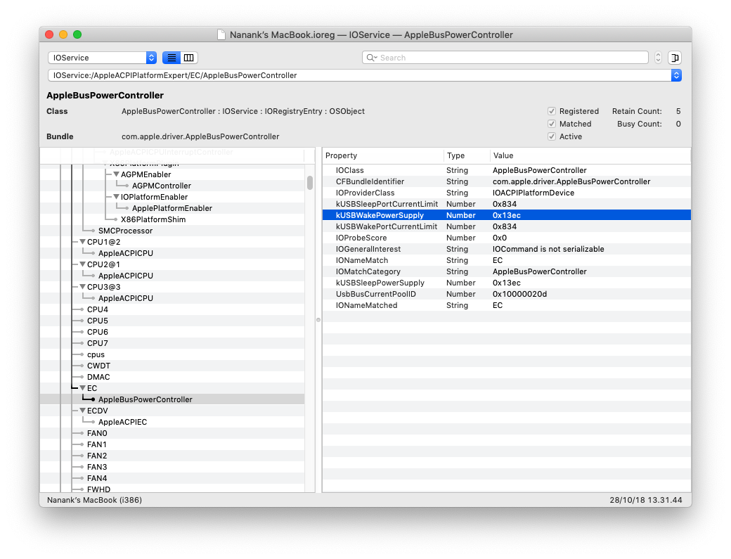

Andres ZeroCross Posted November 23, 2018 Share Posted November 23, 2018 (edited) 9 minutes ago, Shogun212 said: Usb doesn't show any bluetooth info, like it doesn't exist. Upload your IOREG,, It should be like this Edited November 23, 2018 by Andres ZeroCross Link to comment https://www.insanelymac.com/forum/topic/336413-can-someone-help-me-with-mojave/page/3/#findComment-2649304 Share on other sites More sharing options...

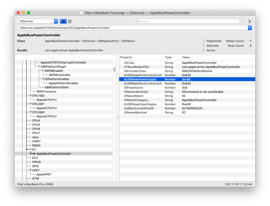

Shogun212 Posted November 23, 2018 Author Share Posted November 23, 2018 1 minute ago, Andres ZeroCross said: Upload your IOREG Filip’s MacBook Pro.ioreg Link to comment https://www.insanelymac.com/forum/topic/336413-can-someone-help-me-with-mojave/page/3/#findComment-2649305 Share on other sites More sharing options...
Andres ZeroCross Posted November 23, 2018 Share Posted November 23, 2018 3 minutes ago, Shogun212 said: Filip’s MacBook Pro.ioreg It's USB Power Problem,, you need to edit info.plist of IOUSBHostFamily.kext according to your SMBIOS. For SkyLake above we can do this with Rename EC0 to EC or H_EC to EC and add USBX device,, but your system is broadwell. Need manually edit IOUSBHostFamily.kext's info.plist This is yours,,, It should be like this, kUSBWakePowerSupply should be 5100 instead 3200 kUSBSleepPowerSupply should be 5100 instead 3200 Link to comment https://www.insanelymac.com/forum/topic/336413-can-someone-help-me-with-mojave/page/3/#findComment-2649311 Share on other sites More sharing options...

Shogun212 Posted November 23, 2018 Author Share Posted November 23, 2018 13 minutes ago, Andres ZeroCross said: It's USB Power Problem,, you need to edit info.plist of IOUSBHostFamily.kext according to your SMBIOS. For SkyLake above we can do this with Rename EC0 to EC or H_EC to EC and add USBX device,, but your system is broadwell. Need manually edit IOUSBHostFamily.kext's info.plist This is yours,,, It should be like this, kUSBWakePowerSupply should be 5100 instead 3200 kUSBSleepPowerSupply should be 5100 instead 3200 I'm having trouble finding IOUSBHostFamily.kext's info.plist, also, IOREG editor won't let me change anything. Can you please help me via TeamViewer? :/ 10 minutes ago, SavageAUS said: Which smbios did you end up going with? MacBookPro 12,1 Link to comment https://www.insanelymac.com/forum/topic/336413-can-someone-help-me-with-mojave/page/3/#findComment-2649317 Share on other sites More sharing options...
Andres ZeroCross Posted November 23, 2018 Share Posted November 23, 2018 1 hour ago, Shogun212 said: MacBookPro 12,1 Just upload your IOUSBHostFamily.kext from System/Library/Extensions,,, Link to comment https://www.insanelymac.com/forum/topic/336413-can-someone-help-me-with-mojave/page/3/#findComment-2649333 Share on other sites More sharing options...

Andres ZeroCross Posted November 23, 2018 Share Posted November 23, 2018 3 minutes ago, Shogun212 said: IOUSBHostFamily.kext.zip Install this kext with Kext Utility.app and reboot,, then post your IOREG again IOUSBHostFamily.kext.zip Link to comment https://www.insanelymac.com/forum/topic/336413-can-someone-help-me-with-mojave/page/3/#findComment-2649337 Share on other sites More sharing options...

Andres ZeroCross Posted November 23, 2018 Share Posted November 23, 2018 (edited) 3 minutes ago, SavageAUS said: No it is not normal, follow the link I gave you to create a custom USBPorts.kext BEFORE messing with any system kexts. Restore your original IOUSB*.kext before creating the kext. Sent from my iPhone using Tapatalk Custom USB Port is about USB Port,, not about Power USB. It's different. It looks you need to read this https://www.tonymacx86.com/threads/guide-usb-power-property-injection-for-sierra-and-later.222266/ Edited November 23, 2018 by Andres ZeroCross Link to comment https://www.insanelymac.com/forum/topic/336413-can-someone-help-me-with-mojave/page/3/#findComment-2649347 Share on other sites More sharing options...
SavageAUS Posted November 23, 2018 Share Posted November 23, 2018 Custom USB Port is about USB Port,, not about Power USB. It's different. It looks you need to read this https://www.tonymacx86.com/threads/guide-usb-power-property-injection-for-sierra-and-later.222266/Yes but the Bluetooth should be set to internal (255). And the smbios he is using IS included for USB port power in the IOUSB*.kext it just need to be set to an internal connection. Changing the USB power limit from a laptop spec to desktop spec cannot be a good idea.P.S I have read the link you posted a long time ago. My Asus (MacBook Pro 11,1) has USB power setup properly and I did not inject currents from a desktop yet Bluetooth works as it should and my iPhone charges. Sent from my iPhone using Tapatalk Link to comment https://www.insanelymac.com/forum/topic/336413-can-someone-help-me-with-mojave/page/3/#findComment-2649348 Share on other sites More sharing options...
