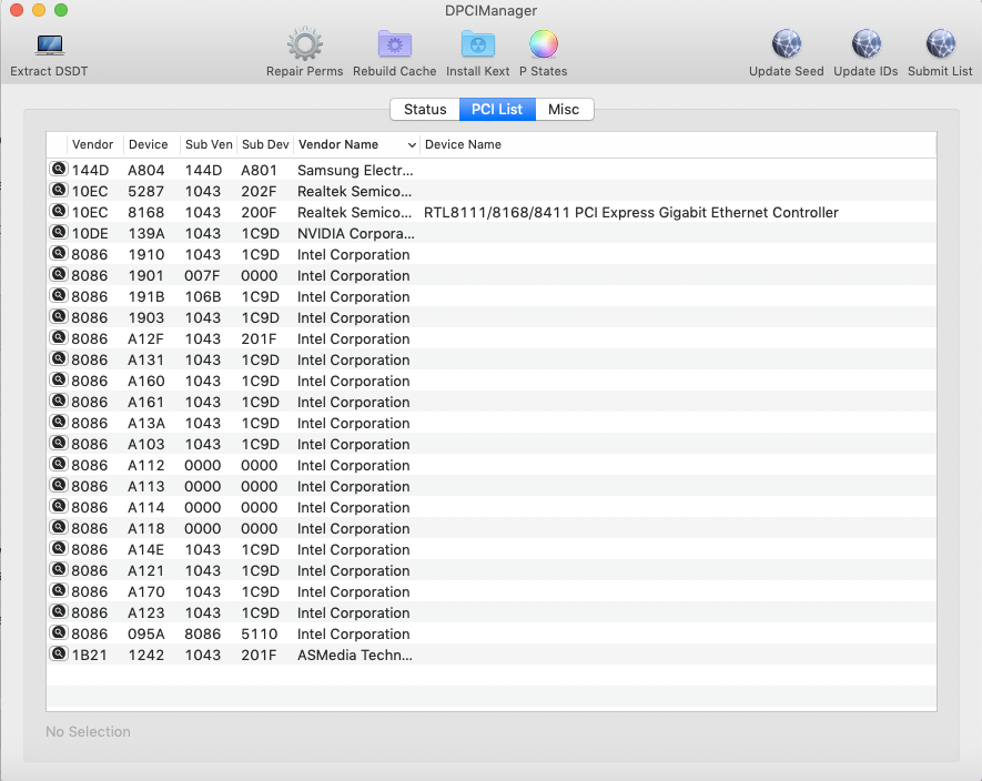

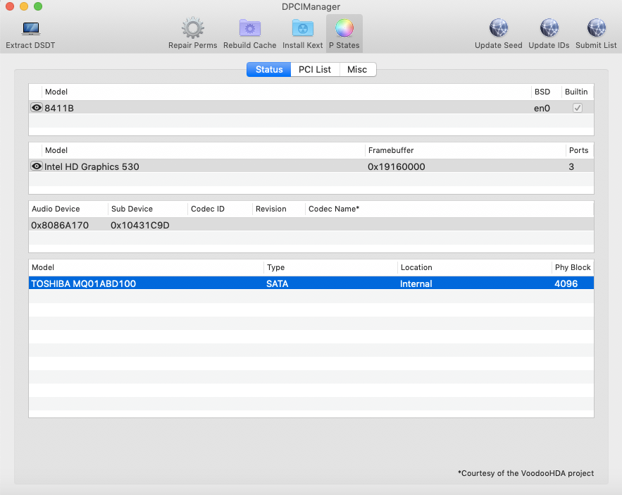

Baio77 Posted October 25, 2018 Share Posted October 25, 2018 Hello try this folder Clover, post IORegistryExplorer, attach photos DCPIManager section PCI List and STATUS and post Hack Info CLOVER.zip Link to comment Share on other sites More sharing options...

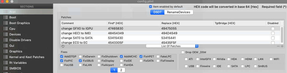

Baio77 Posted October 26, 2018 Share Posted October 26, 2018 Eccomi qua , ho appena modificato alcune impostazioni ....... Prova questa Clover se avvia esegui IORegistry ancora ..... In questa Clover ci sono TUTTE kext aggiornate , ti ricordo che stai usando 10.14 quindi devi aggiornare TUTTO , Clover , Kext ecc ecc , nella tua Clover iniziale sono OBSOLETE le kext .... Se hai dimestichezza con Cloverconfigurator controlla ciò ho variato in configplist questi in foto sono i GIUSTI Rename da utilizzare x il tuo PC ...... Nella mia firma trovi come dare info utili , posta la cartella trovi in Desktop dopo aver eseguito Hack Info ........... CLOVER.zip Link to comment Share on other sites More sharing options...

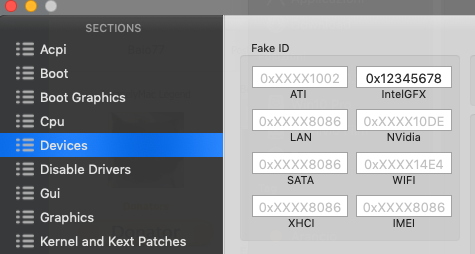

Baio77 Posted October 26, 2018 Share Posted October 26, 2018 (edited) Boss controlla , anche cosi va bene?? NON coincide il nome del DSDT da caricare è anche inserito il Fake ID come in foto in configplist Edited October 26, 2018 by Baio77 1 Link to comment Share on other sites More sharing options...
gengik84 Posted October 26, 2018 Share Posted October 26, 2018 Corretto...mia svista ...Grazie 1 Link to comment Share on other sites More sharing options...

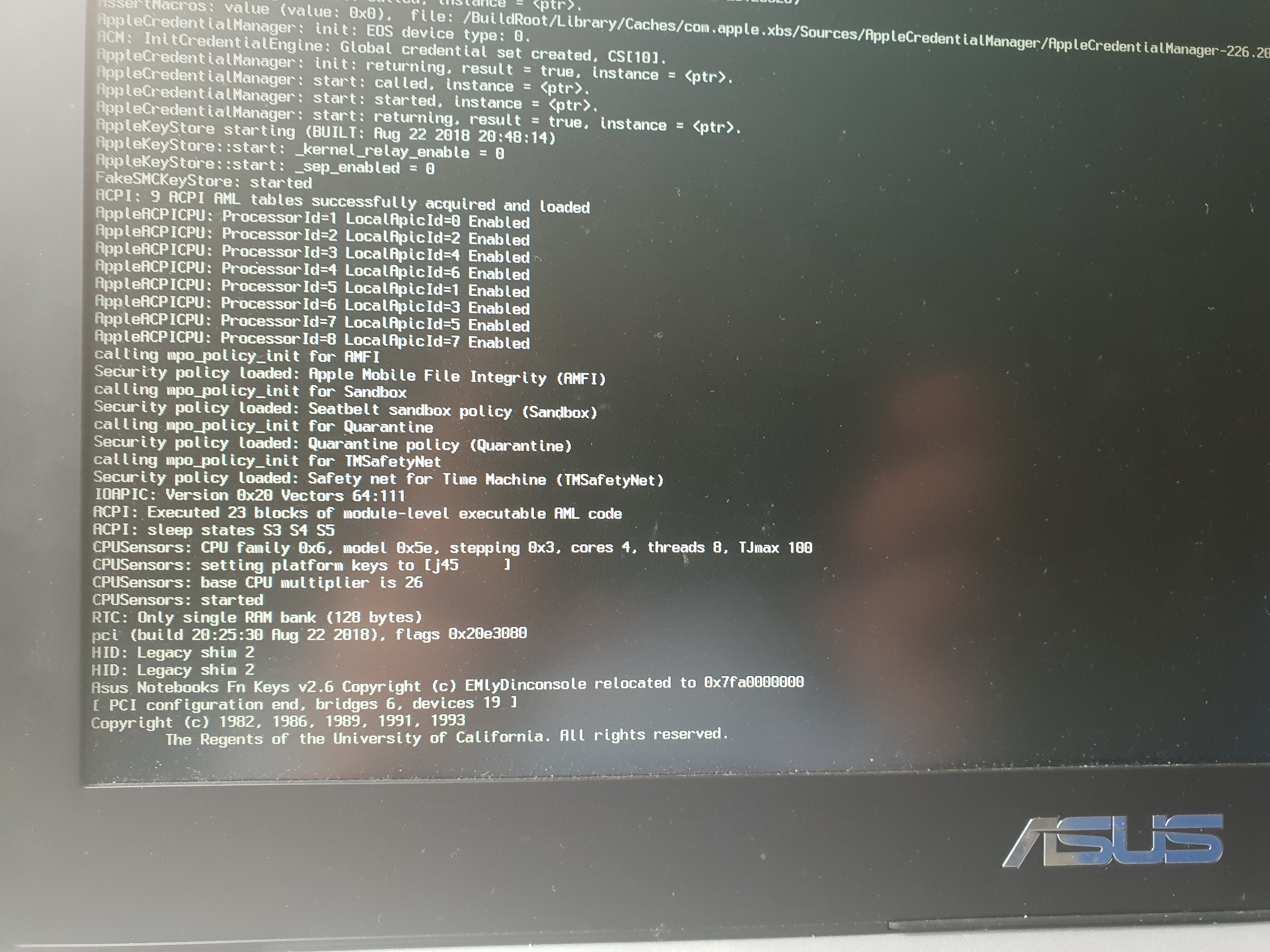

pccc Posted October 26, 2018 Author Share Posted October 26, 2018 Non riesce a partire, mi va in kernel Panic. Link to comment Share on other sites More sharing options...
gengik84 Posted October 26, 2018 Share Posted October 26, 2018 allega la foto Link to comment Share on other sites More sharing options...
