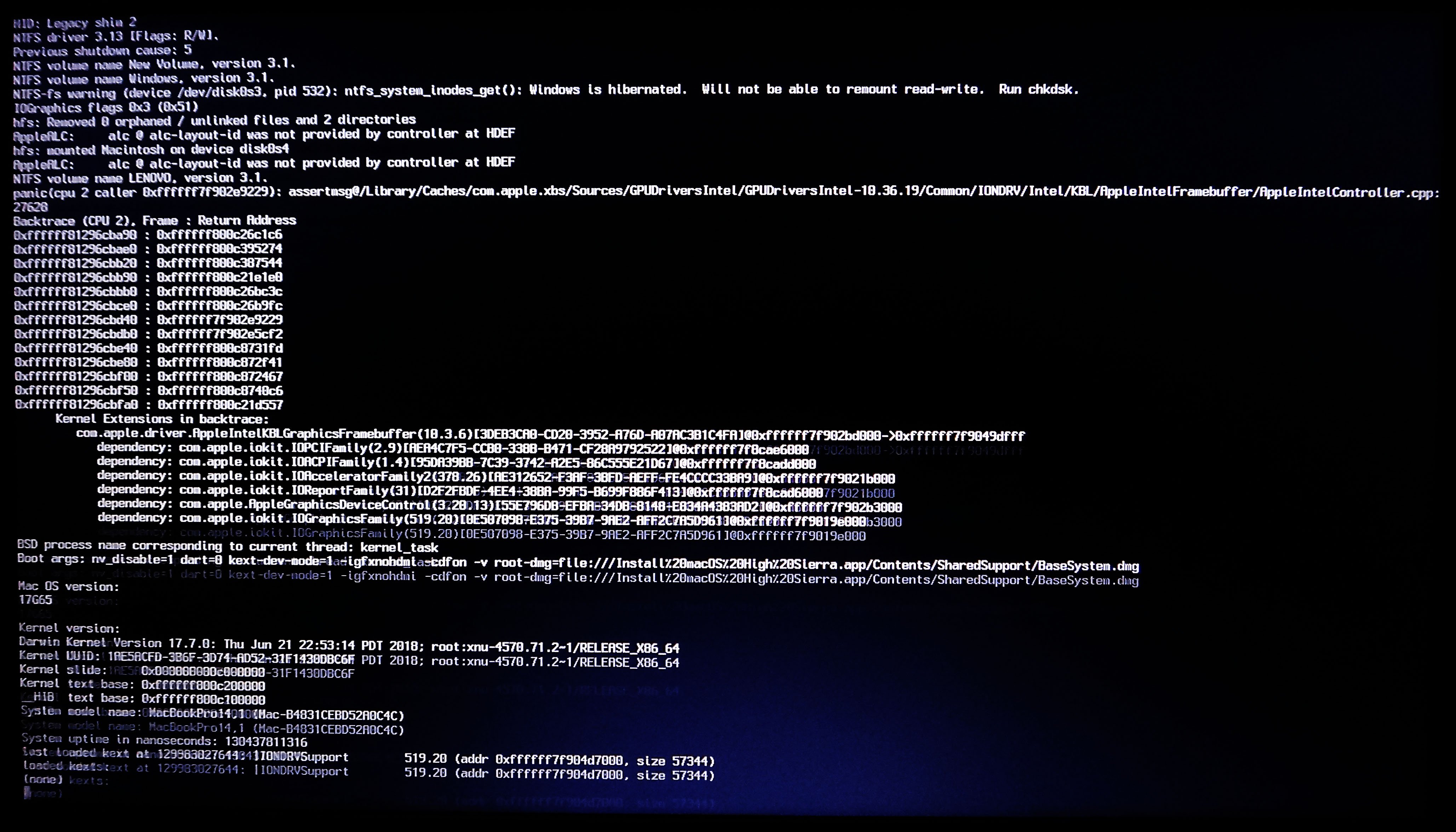

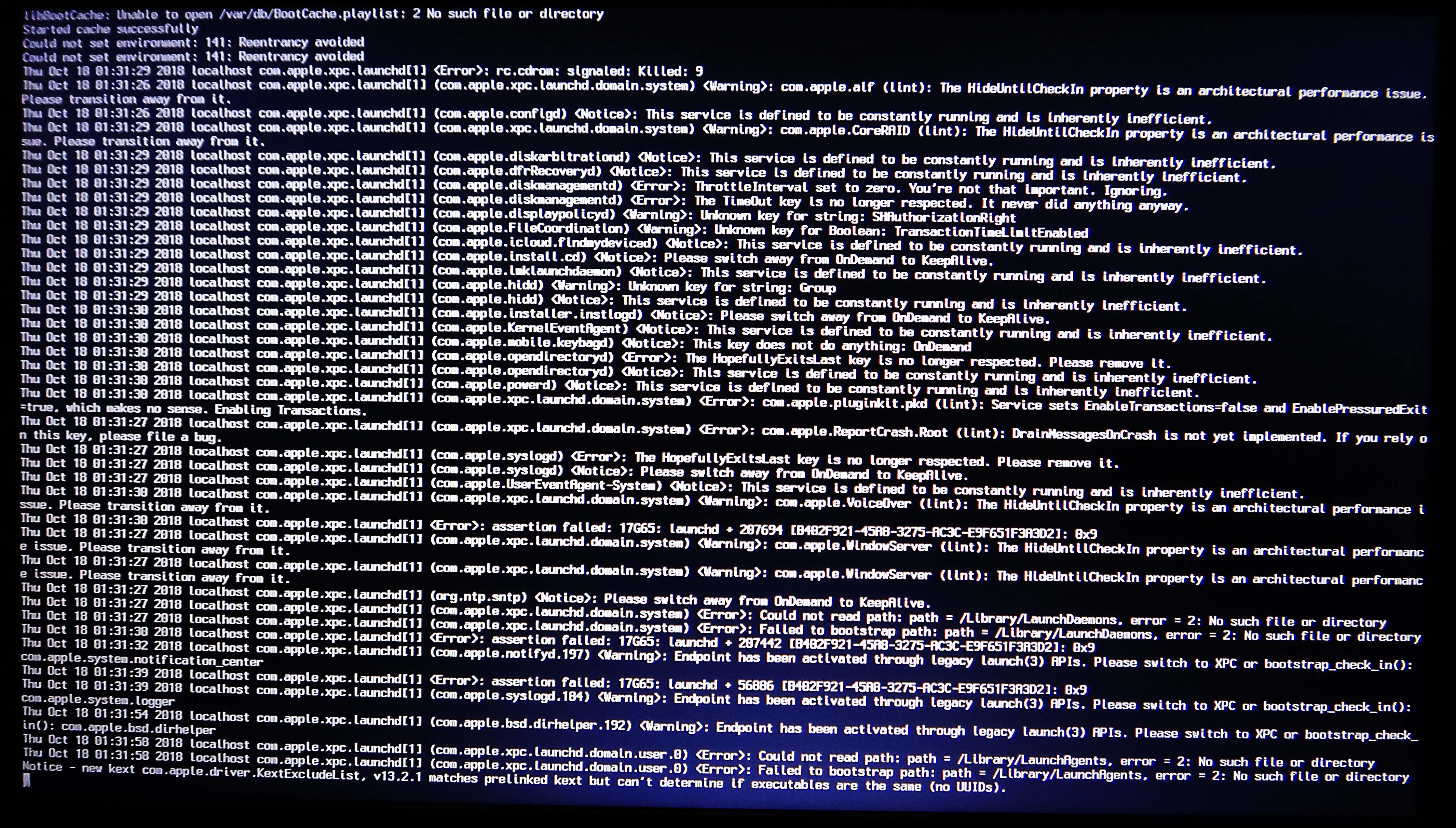

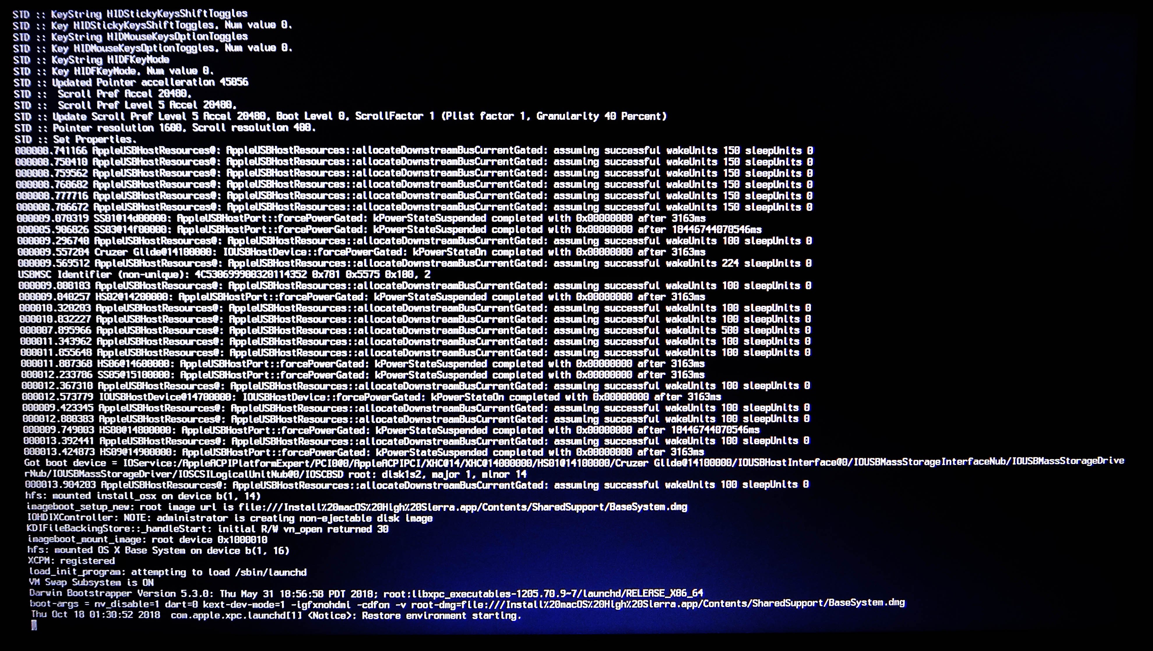

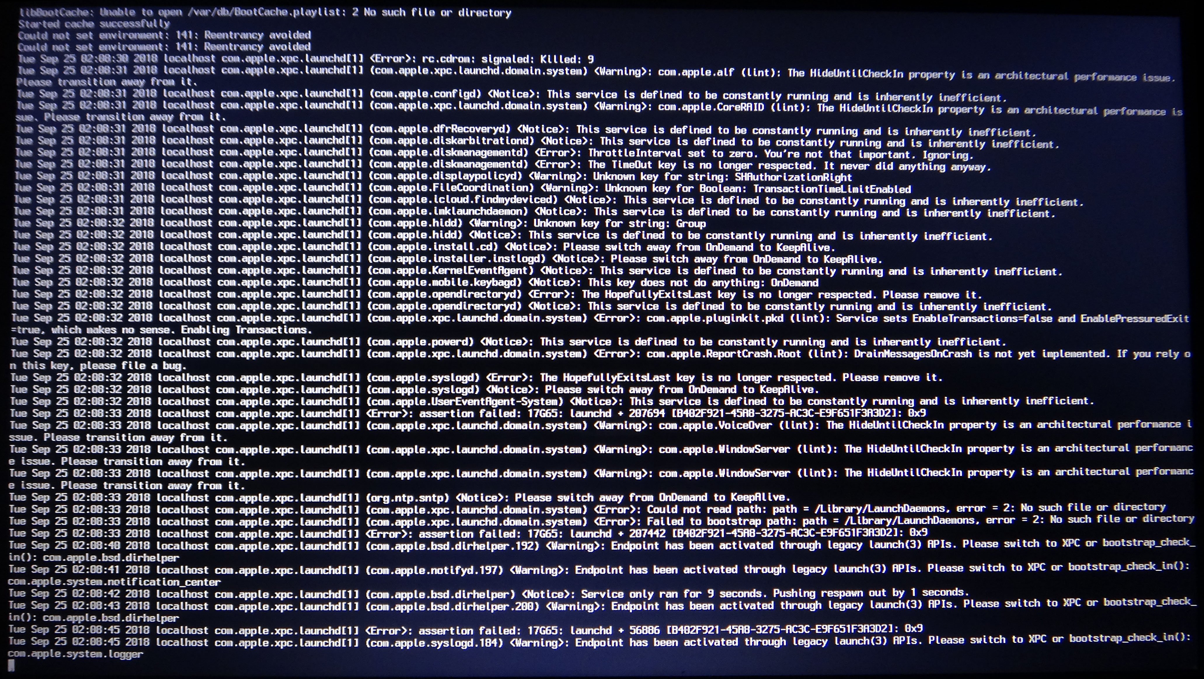

Masha24 Posted October 18, 2018 Author Share Posted October 18, 2018 HI Savage! Ok i just tried your clover, this is what i got: Before this one is the ' +++++++++++++++++++++++++++++++ ' Intro screen, then it redraws and Very quickly drops all this text, i tried a few times to get pics of the beginning, but many were blurred because it moves so fast ... if you would like something in any of these spots i can try even harder to get it :) Some of that text in the beginning i haven't seen before, hopefully you can make it out sorry This last pic was the hardest to grab, it runs off the bottom of the screen in a fraction of a second, you can see the frame ghosting ..lol I took a look at the Drivers64 folder, do you think the reason it wouldn't go into the 'installer' screen is because it needs the 'HFSPlus.efi' driver? errrr .... maybe .. you know what ... actually i have no idea ..hahha, i'm at your mercy :P I'm so enamored i'll try anything .... Anyway, THANK YOU SO MUCH for helping me!! i'm bouncing in my chair :) Link to comment https://www.insanelymac.com/forum/topic/335979-semi-noob-trying-to-install-hs-epic-fail-please-help/#findComment-2641543 Share on other sites More sharing options...
SavageAUS Posted October 18, 2018 Share Posted October 18, 2018 (edited) 13 minutes ago, Masha24 said: HI Savage! Ok i just tried your clover, this is what i got: Before this one is the ' +++++++++++++++++++++++++++++++ ' Intro screen, then it redraws and Very quickly drops all this text, i tried a few times to get pics of the beginning, but many were blurred because it moves so fast ... if you would like something in any of these spots i can try even harder to get it Try this config.plist. Sent from my iPhone using Tapatalk config.plist Edited October 18, 2018 by SavageAUS Link to comment https://www.insanelymac.com/forum/topic/335979-semi-noob-trying-to-install-hs-epic-fail-please-help/#findComment-2641544 Share on other sites More sharing options...

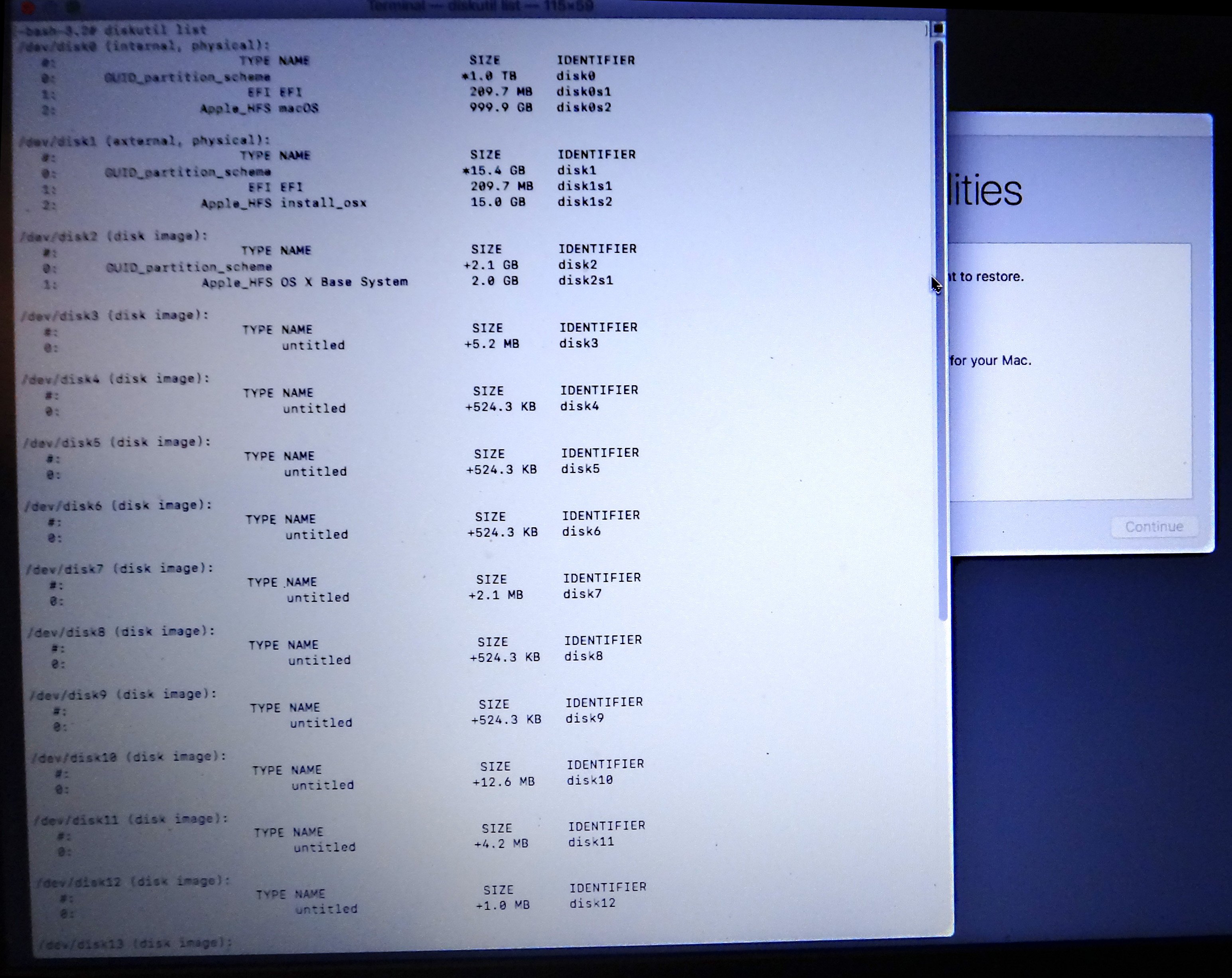

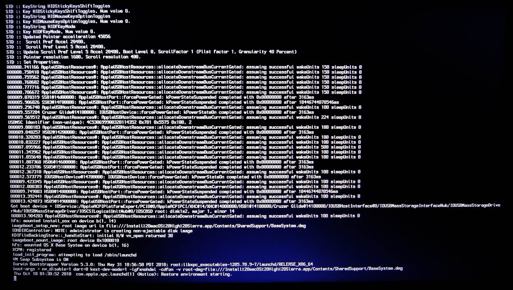

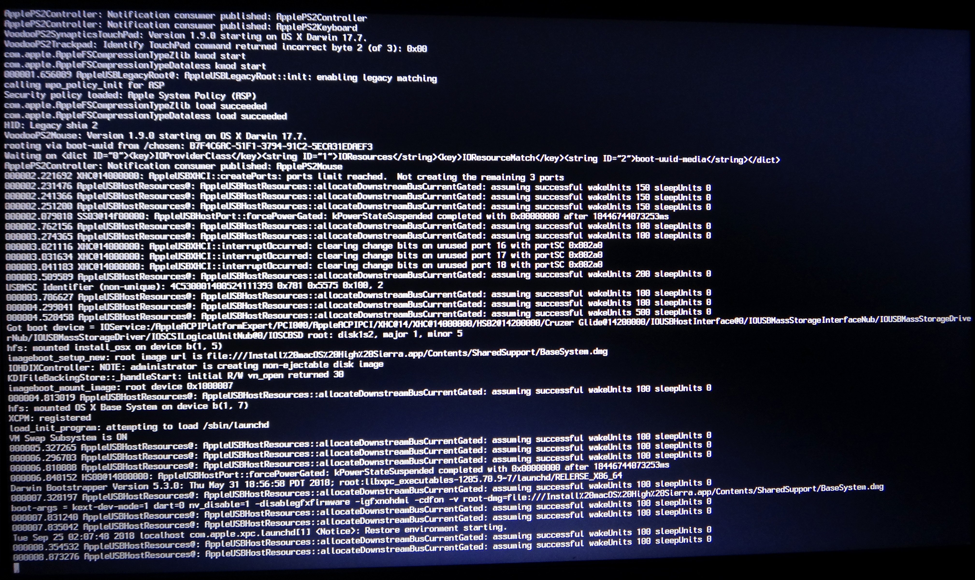

Masha24 Posted October 18, 2018 Author Share Posted October 18, 2018 Hieee ok i had to go out for a bit, i tried the new plist and it was successful in going into the macOS installer now. i tried to erase the partition with disk utility, but it hung up while it was doing it, and i had to go to shutdown/reset i started it again, got into the installer, and this time i just went strait to 'install macOS' but unfortunately the same scenario happened again - it loaded untill 2 mins remaining, and inside the installer Log it displayed the same output as my first post :/ ..lol ...The output is exactly the same as in the last image hummmm, there's a few things i was thinking it could be ... maybe i need to modify something ... errrr i dunno' .. really, all i can see is it may be something to do with usb - or - SATA .. orrrr like chipset detecting sOmmmething ... hummm maybe there's a way to just bypass the verification of the chunks or whatever - but then it also says the other stuff, like 'no fs for null' and no chip ID .... well, all the stuff i typed out in the first post at the end. anyway, just thinkin' Link to comment https://www.insanelymac.com/forum/topic/335979-semi-noob-trying-to-install-hs-epic-fail-please-help/#findComment-2641569 Share on other sites More sharing options...
SavageAUS Posted October 18, 2018 Share Posted October 18, 2018 Hieee ok i had to go out for a bit, i tried the new plist and it was successful in going into the macOS installer now. i tried to erase the partition with disk utility, but it hung up while it was doing it, and i had to go to shutdown/reset i started it again, got into the installer, and this time i just went strait to 'install macOS' but unfortunately the same scenario happened again - it loaded untill 2 mins remaining, and inside the installer Log it displayed the same output as my first post :/ ..lol ...The output is exactly the same as in the last image hummmm, there's a few things i was thinking it could be ... maybe i need to modify something ... errrr i dunno' .. really, all i can see is it may be something to do with usb - or - SATA .. orrrr like chipset detecting sOmmmething ... hummm maybe there's a way to just bypass the verification of the chunks or whatever - but then it also says the other stuff, like 'no fs for null' and no chip ID .... well, all the stuff i typed out in the first post at the end. anyway, just thinkin' Well now that we’re reaching the installer you could try adding back your sata kext as I removed it in my clover folder. Just what ever you do, only change 1 thing at a time that way it’s easier to undo and keep track of what you do. Sent from my iPhone using Tapatalk Link to comment https://www.insanelymac.com/forum/topic/335979-semi-noob-trying-to-install-hs-epic-fail-please-help/#findComment-2641571 Share on other sites More sharing options...

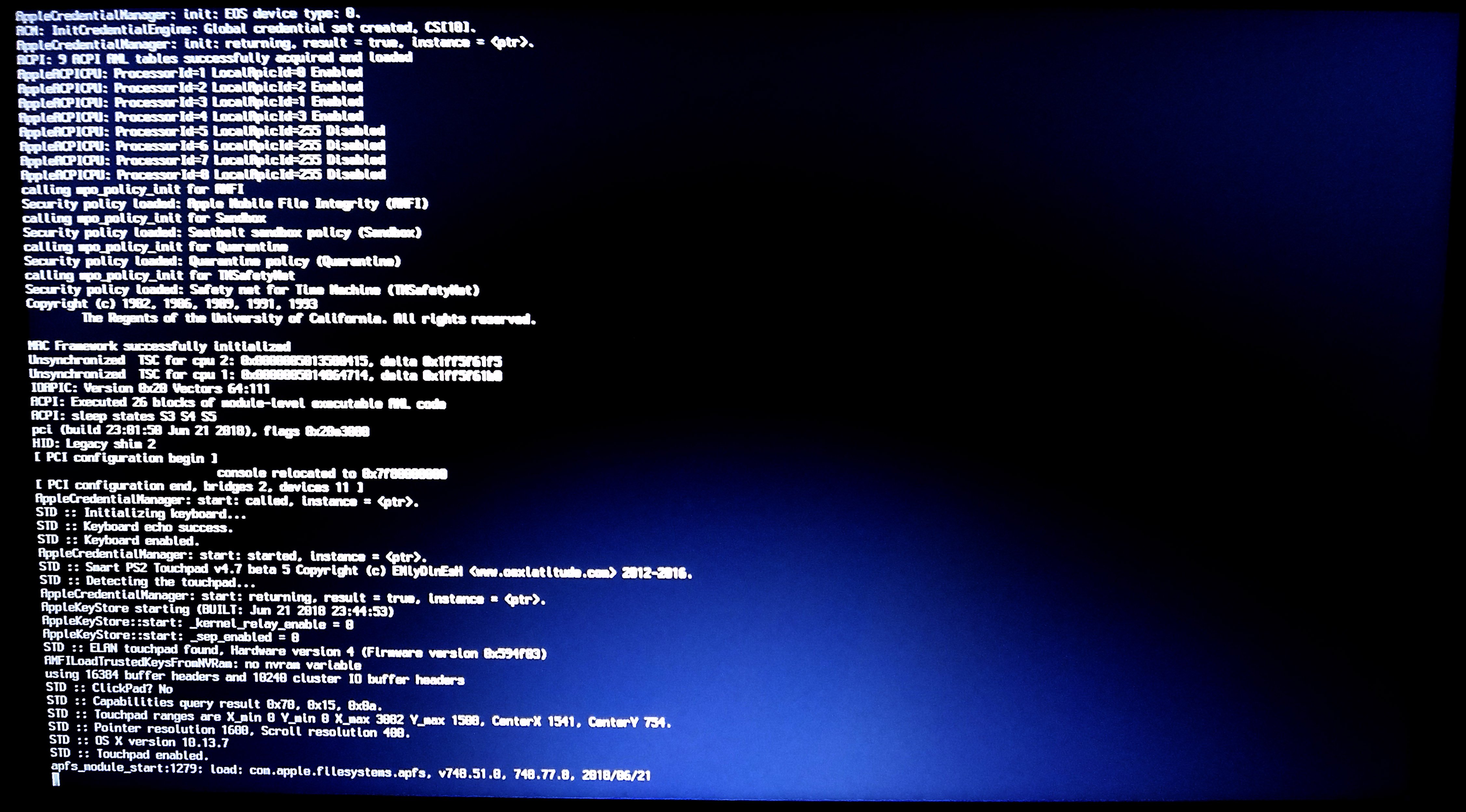

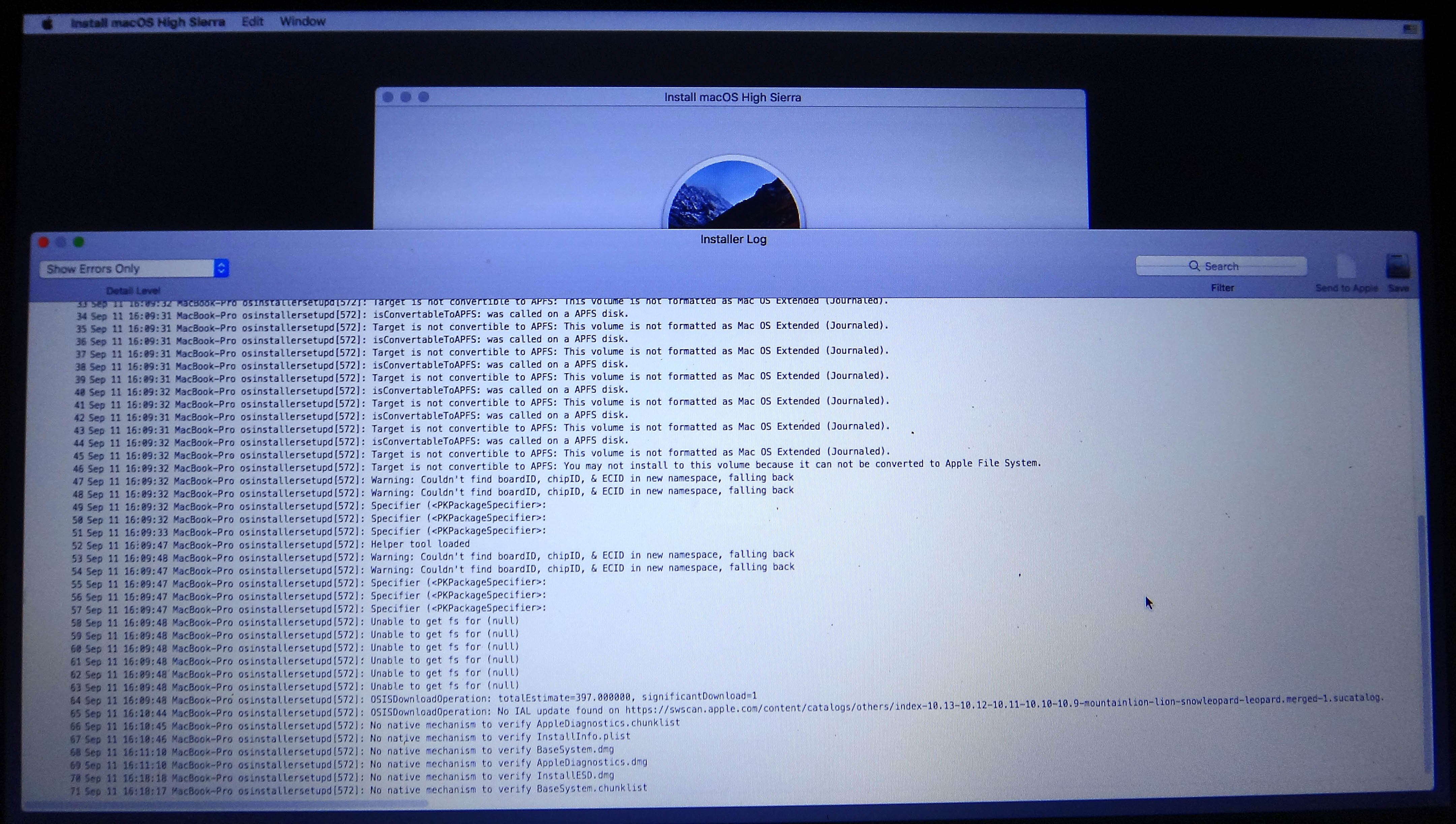

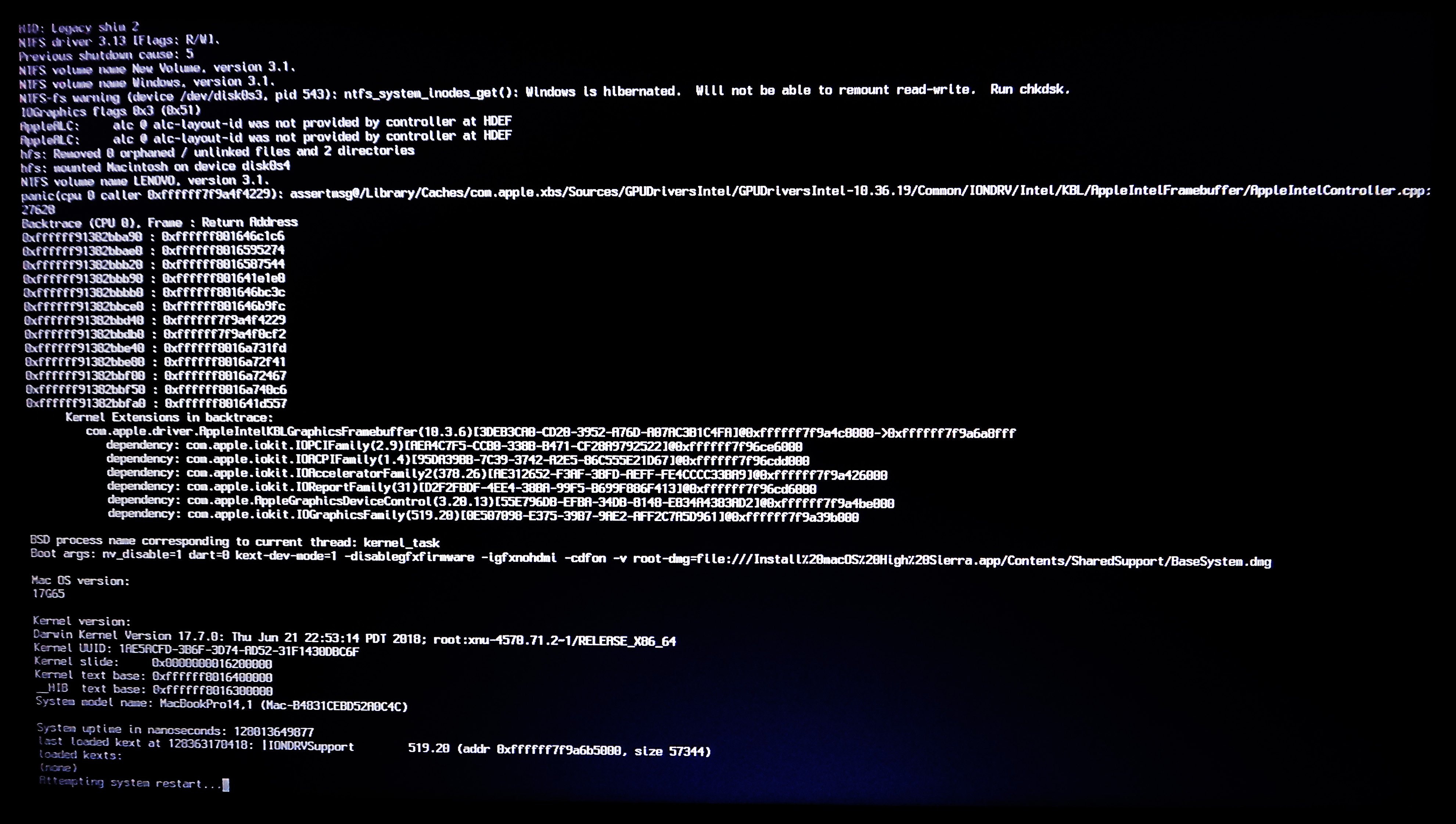

Masha24 Posted October 19, 2018 Author Share Posted October 19, 2018 (edited) Mr Savage, I have updates! Ok, i took your advice and one by one tried to add the kexts and drivers back in, this is my report: I put in the " SATA-100-Series-unsupported.kext" and Right away it started letting me use Disk Utility! - i erased the drive as usual, and then went to 'Install macOS' - no go .. same thing, went to 2 mins left and hung, with the same output in the installer log. But! - for sure that confirms that i definitely have the 9Dxx SATA controller ... so thats something. - I'm keeping in the SATA-100 kext now. - I put in "SMChelper.efi" - no change, Disk utiltiy not working, [removed.] - I put in "XHCI-200-series-injector.kext" - no change, made track pad vERy sketchy to use, [removed] (not using USB3 to install anyway) - I put in "DataHubDxe-64.efi" - no change in the installer log, same problem [removed.] So i'm looking at the other ones i had before (which i'm not so sure i was right in my selections anyway ..lol) and the 'PartitionDxe-64.efi' i only had that one because it was suggested on the clover wiki website ... sooooo ... yea.... the other ones i'm not sure if they will make a difference ... i'll try the 'AptioInputFix-64.efi' next now ... but all i've read is that the 'AptioMemoryFix.efi' is the one you should have.... i was just trying everything .... like a crazy girl ... So, i guess i'm in your hands now ...lol ... i officially have no idea where to go next... Ohhh one last thing, the Last config ^^ (not the simple/generic one, the one above it) wouldn't download from here ? .. i guess something happened. it just goes to a page and says 404 .... i'll try again in a bit .. Thank you so much for helping me Edited October 19, 2018 by Masha24 I just tried the download again now - Config.plist Download worked from your other post ! ..i'll try it now. Link to comment https://www.insanelymac.com/forum/topic/335979-semi-noob-trying-to-install-hs-epic-fail-please-help/#findComment-2641736 Share on other sites More sharing options...
SavageAUS Posted October 19, 2018 Share Posted October 19, 2018 I’ll see if I can get the config again and re upload it if you can’t get it. Some of those drivers you have are for FileVault like the aptioinput. I suspect it’s a config problem somewhere. But for it to only stall right at the end puzzles me. I’ll try do some research and get back to you. But yeah keep posting updates, feel free to make changes and see how you go. Sent from my iPhone using Tapatalk Link to comment https://www.insanelymac.com/forum/topic/335979-semi-noob-trying-to-install-hs-epic-fail-please-help/#findComment-2641737 Share on other sites More sharing options...

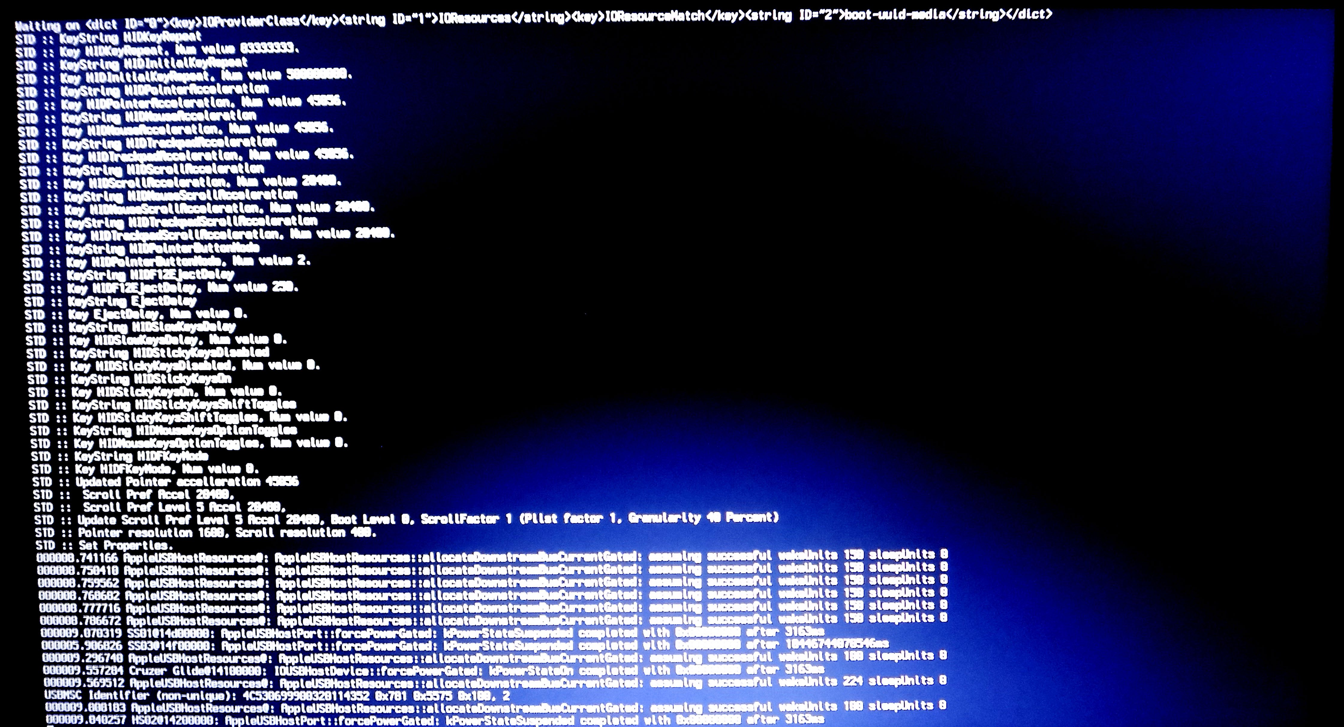

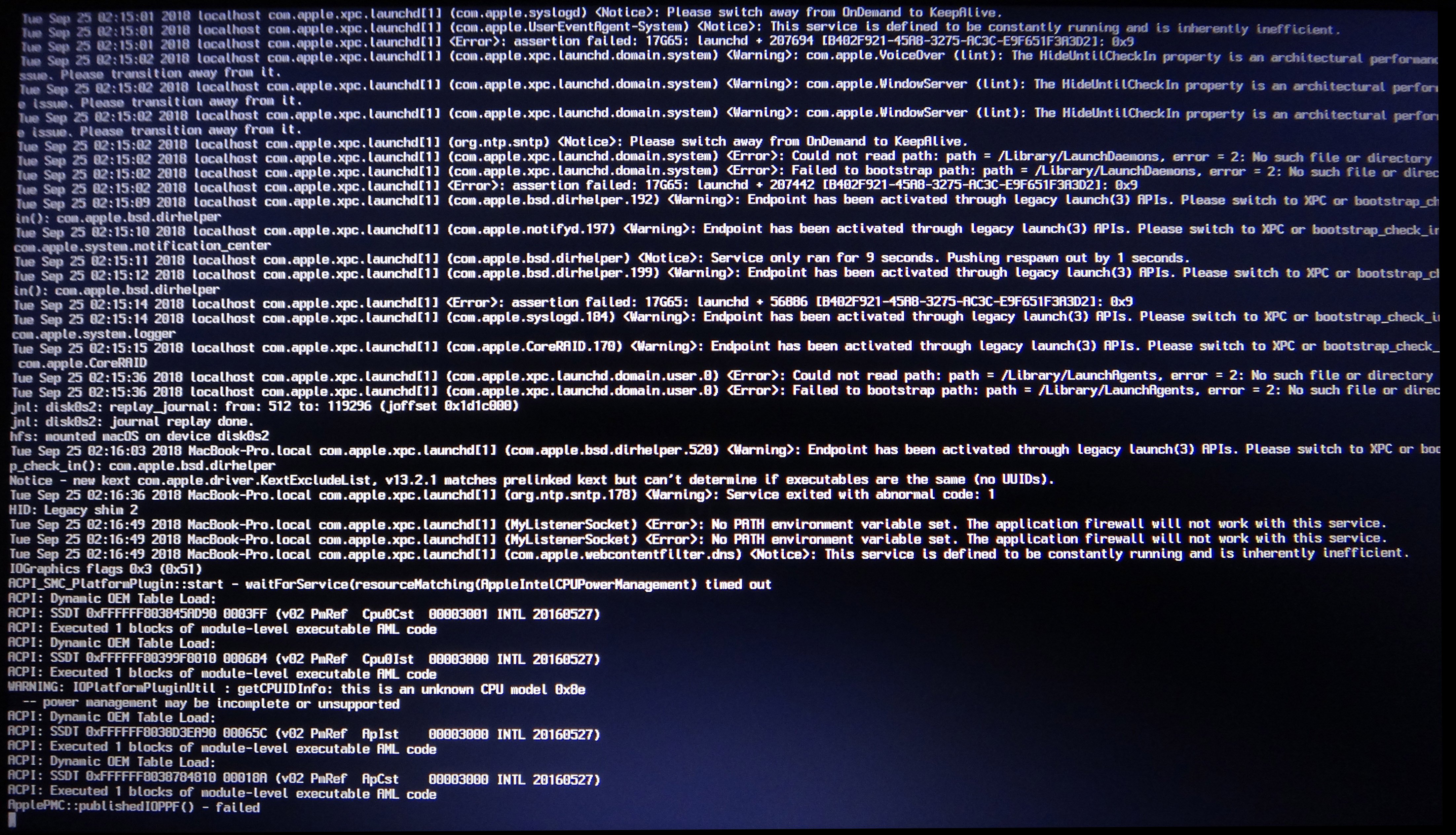

Masha24 Posted October 19, 2018 Author Share Posted October 19, 2018 hey! yupperz! i'm testing different stuff .. i really wana figure this out yea i figured the aptioinputfix driver was for filevault ... but ... yea, i'm trying everything now ...hahaha I got the new config.plist you posted! - i tried it again and it downloaded, there must have been some glitch but it unfortunetly didn't work .. it had what seemed to be the video pre allocation problem ... like a kernel panic at the end of the verbose - before the installer*. but hey! ..ok i messed around with a video clip of the verbose log, and i think i got something for you! it's bad, i know, i tried to fit the bit-rate to be under 10mb for this site to upload. it's blurry when it moves, but if you pause it, or go fame-by-frame, you can see everything i do let me know if anything looks interesting, i'll try to get a better pic or something: Masha_log_1.mp4 You should download it and use something to go frame by frame, like VLC, if it's too crazy to see here. So to clarify: This is the 3rd Config.plist you gave me [not the newest one i downloaded just now, from your post ...uhh 2 posts ago] This one allows me to get into the installer. The only thing i added to the clover you gave me is "SATA-100-series-unsupported.kext" - all the other drivers/kexts are removed as of the making of this video. some things that look interesting: - The UUID right at the beginning " Root device uuid is '233FBECE-2985-34C0...' " .. i wonder if it's right ..like wow ..i don't even know where to look for that ... just shootin' ideas - right at about 2 seconds - so aprox frame 59 it sorta blurry says - " VirtualSMC: __x__ failed to find valid status ___x__ VirtualSMC EFI module is broken " --- don't know if that matters.. - One of the lines says " STD :: OS X version 10.13.7 " - i thought it was 10.13.6 ? ... they made a newer one ? .. err .. uhhh - It says "NTFS-fs error____x__" --- this i'm guessing is because i used an image from a backup to reflash the drive a few days ago, i'm using this machine to talk with you, cuz my other laptop crapped out :( .. BUT i would like to mention, 90% of all the testing/attempts i've done before coming to this site, was on this drive the way it is now, then i erased the drive bare, and did about a month of testing -- now it's back the way it was before ... i believe i've prepared this drive (with a 330GB partition) to properly install macos .. i deleted the MSR between the EFI and the first partition - because i have read that the MSR can cause problems, so that's gone. ALSO, the EFI is 260mb factory - so there shouldn't be issues with it's size. Anyway, i'm just throwing out ideas... hopefully i'm not rambling ..LOL ..sorry. maybe the video will help :) Link to comment https://www.insanelymac.com/forum/topic/335979-semi-noob-trying-to-install-hs-epic-fail-please-help/#findComment-2641757 Share on other sites More sharing options...
SavageAUS Posted October 19, 2018 Share Posted October 19, 2018 Besides the virtualSMC error everything else looks fine. You could remove VirtualSMC and SMCProcessor and SMCBattery and use FakeSMC as a test. FakeSMC.kext.zip Link to comment https://www.insanelymac.com/forum/topic/335979-semi-noob-trying-to-install-hs-epic-fail-please-help/#findComment-2641759 Share on other sites More sharing options...

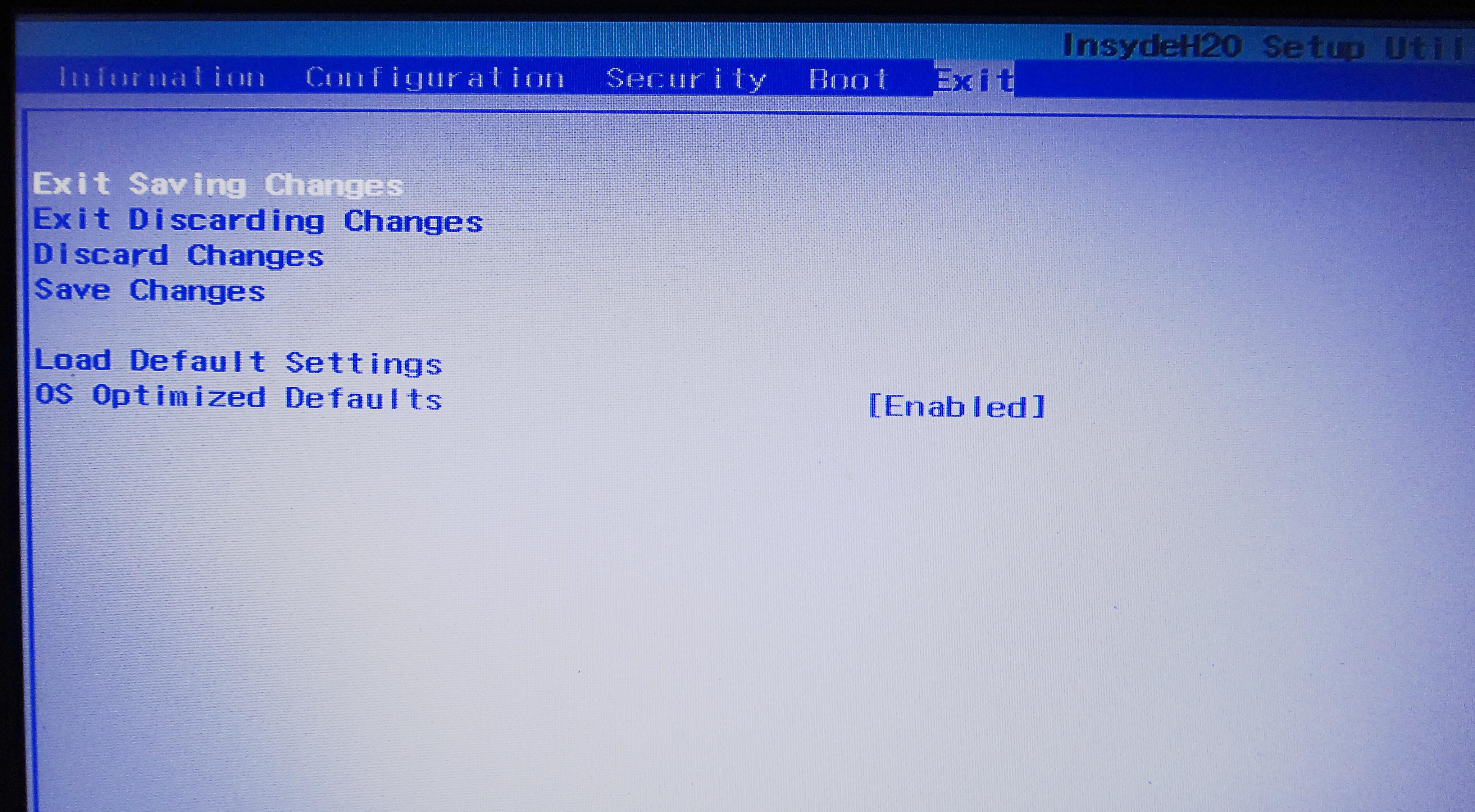

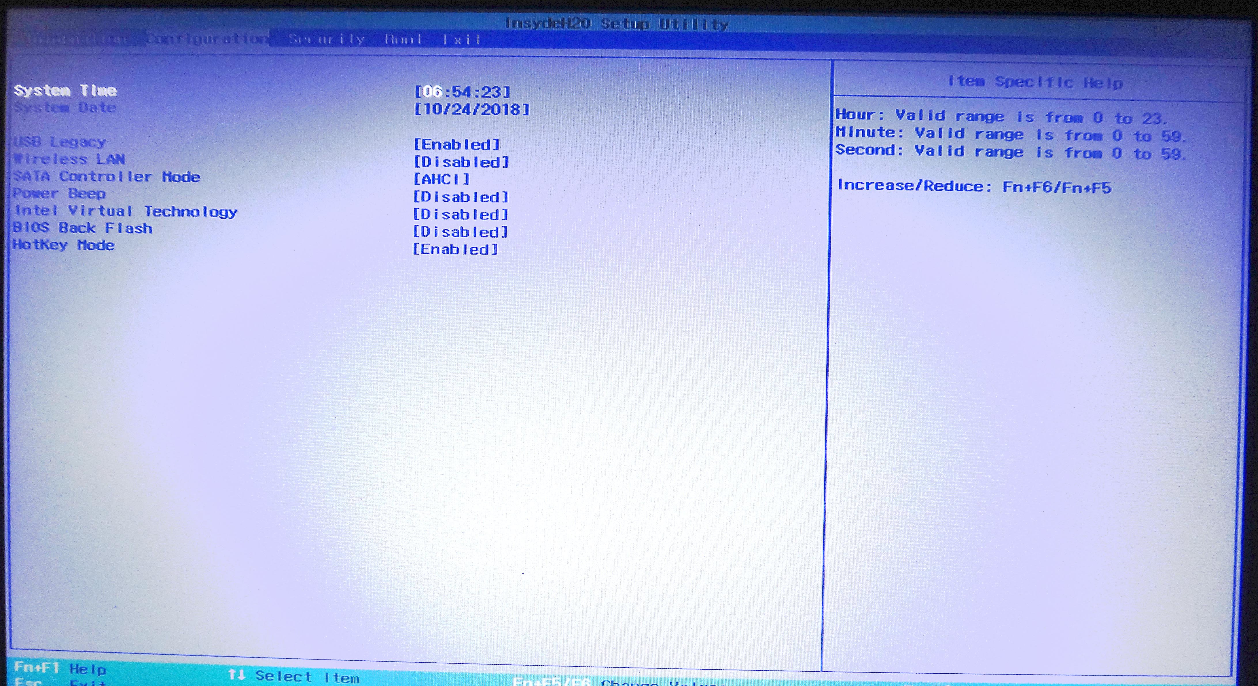

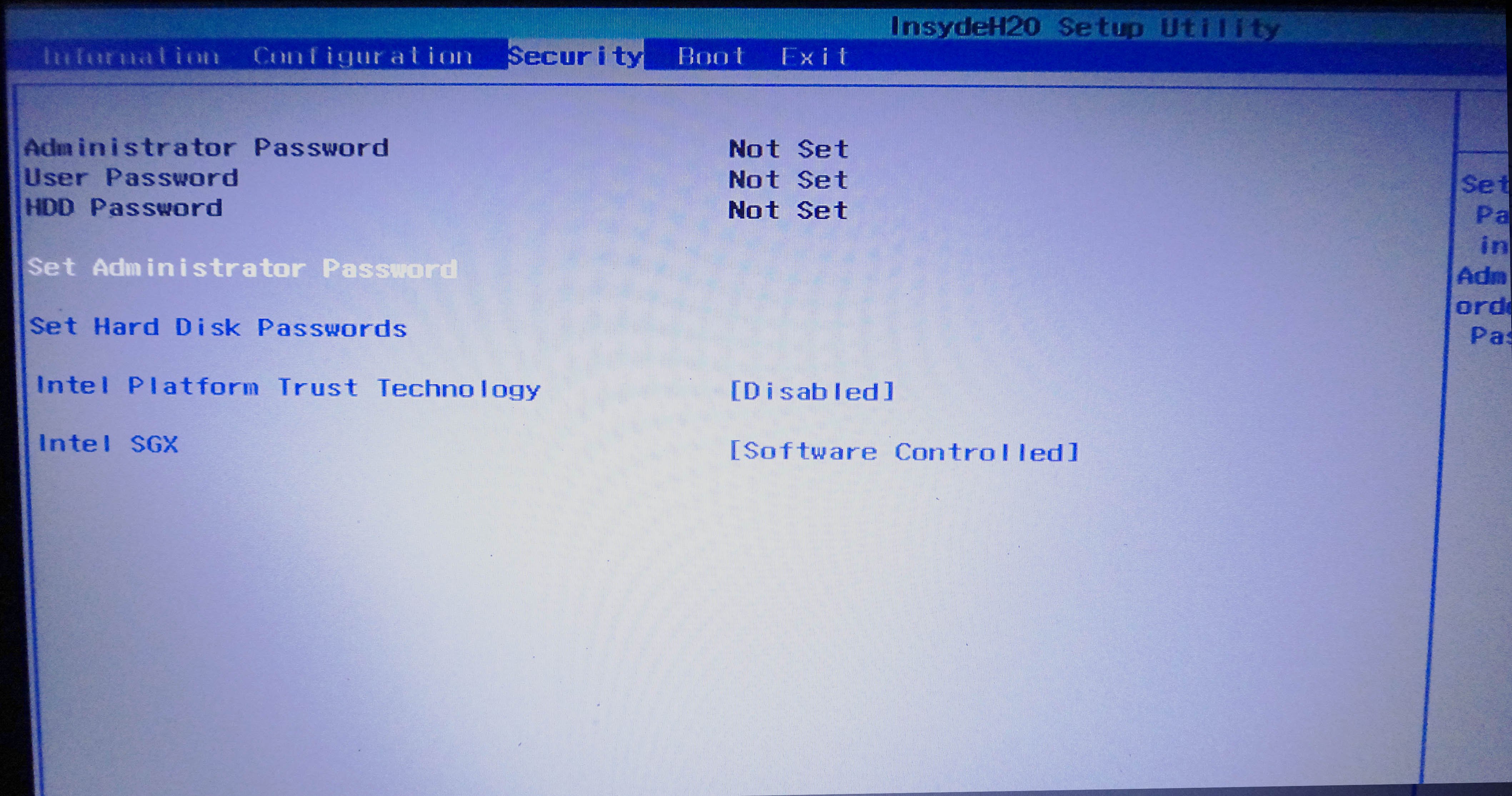

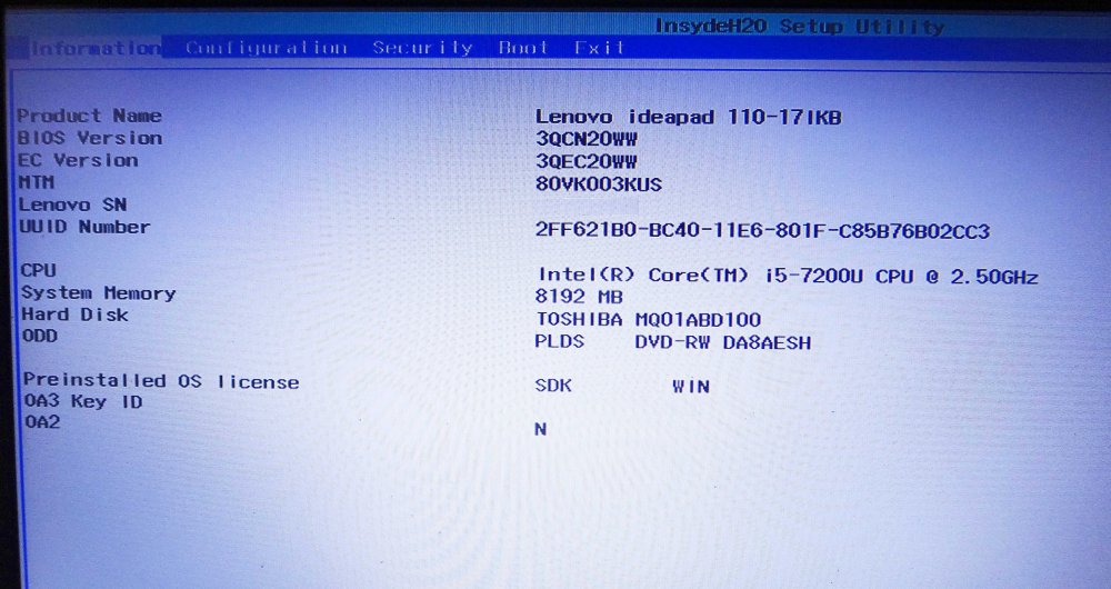

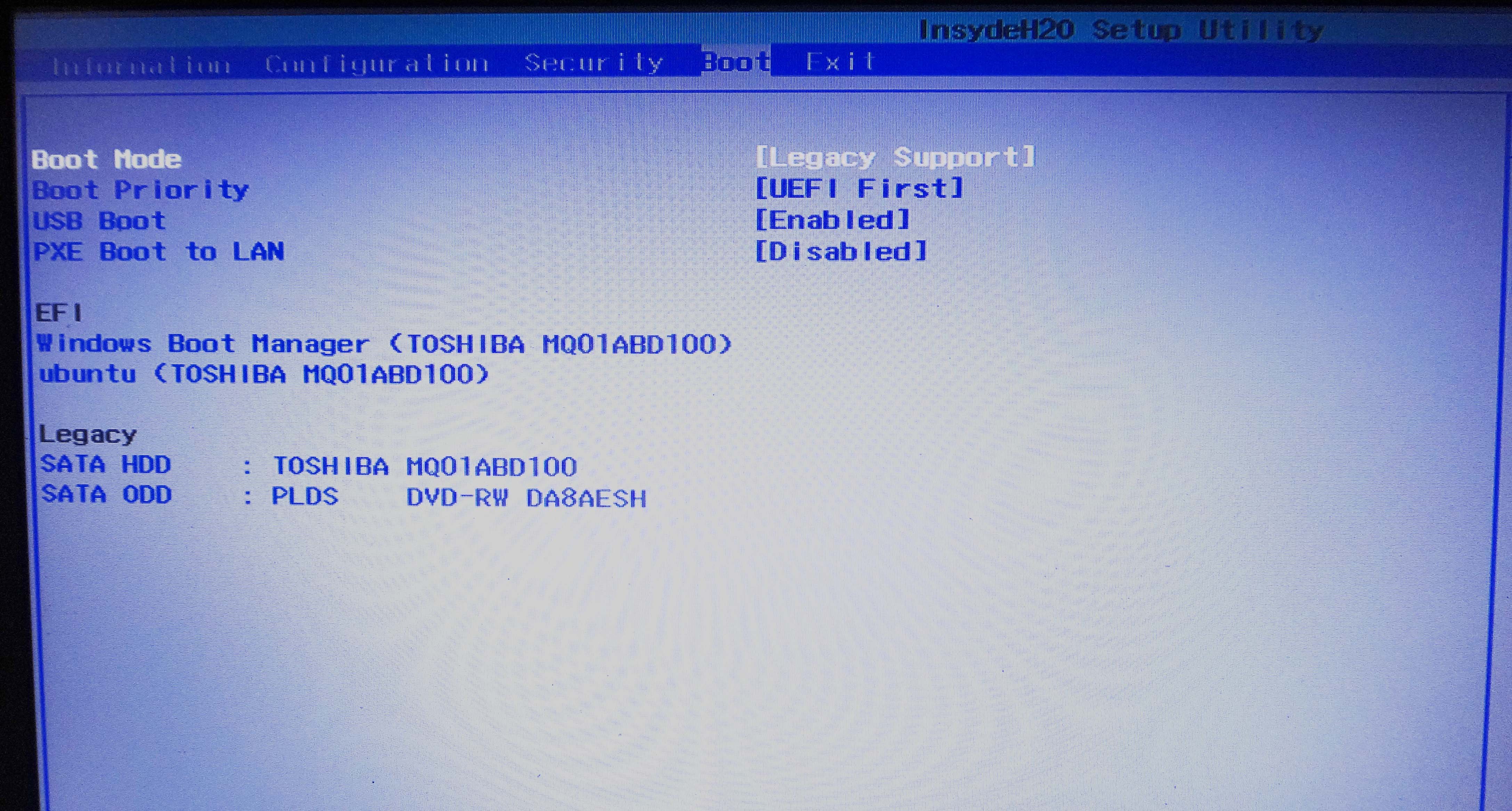

SavageAUS Posted October 20, 2018 Share Posted October 20, 2018 Also can you upload pics of your bios settings?Sent from my iPhone using Tapatalk Link to comment https://www.insanelymac.com/forum/topic/335979-semi-noob-trying-to-install-hs-epic-fail-please-help/#findComment-2641911 Share on other sites More sharing options...
Masha24 Posted October 24, 2018 Author Share Posted October 24, 2018 Hi Savage, sorry i didn't reply sooner, i had to go away for a few days :) Ok, So i prepared pictures of the bios for you here: sorry about the picture quality, i tried to enhance it a bit, this is a lower quality TN panel .. i'm hoping i can find a suitable replacement IPS. *** This is the 5 different pages of the Bios, These settings i have had the same since the beginning of the summer. I hid a few things on the first image just in case some other people can learn from this thread, if you need something i can give it to you privately :) Hopefully everything is right. I have a question though, the ' Intel SGX --- Software controlled ' Setting. - This is the only selection that it stays on, after updating the bios (prior to attempting to install OSX) To the version you will see on the first image ' 3QCN20WW ' from an earlier version, if i attempt to set it to 'Enabled' or 'Disabled' Just switching the bios page left or right - it returns back to 'Software Controlled' automatically. Is this normal now? In other words, i do not have control of this setting. I have Boot Legacy active, but UEFI Predominance. I have Wifi disabled because i use Ethernet anyway. etc. - Your other questions: 1. I believe i do have another drive i could try - another 1TB 2.5in HDD in another laptop that went poop - but i believe the drive itself it still fine. - I will take it out and put it in this machine to try it. [ But i will have to find small screwdrivers tomorrow, because i'm not at home for a number of months, and i have limited stuff here .... but i'll figure it out forsure :) ] 2. I would like to just try the new mojave osx - maybe there is something not agreeing with HS on this machine. I only have an older MBP 4,1 from 2008 with me to get on the apple store - and it won't let me download mojave, no matter what i do! :( ... i have read somewhere on here there are some ways to get it without the store - do you know of a way? --- i would use my mac but apple likes making things complicated sometimes ... guhhhhh 3. One last thing, I just downloaded the 2 files you left for me to try on saturday, I will try it when i wake up tomorrow, Thank you :)))) but I think i'm going to just try Mojave anyway if i can get it. Thank you for your help :) Link to comment https://www.insanelymac.com/forum/topic/335979-semi-noob-trying-to-install-hs-epic-fail-please-help/#findComment-2642767 Share on other sites More sharing options...
SavageAUS Posted October 24, 2018 Share Posted October 24, 2018 No issues at all, yeah I’m not sure what intel sgx is either. Maybe try resetting to factory defaults and then try changing it? Other than that everything else looks fine. I think the best course of action is a different hdd unless the new files I sent work (fingers crossed) or maybe someone more knowledgeable will chime in. Sent from my iPhone using Tapatalk Link to comment https://www.insanelymac.com/forum/topic/335979-semi-noob-trying-to-install-hs-epic-fail-please-help/#findComment-2642772 Share on other sites More sharing options...
