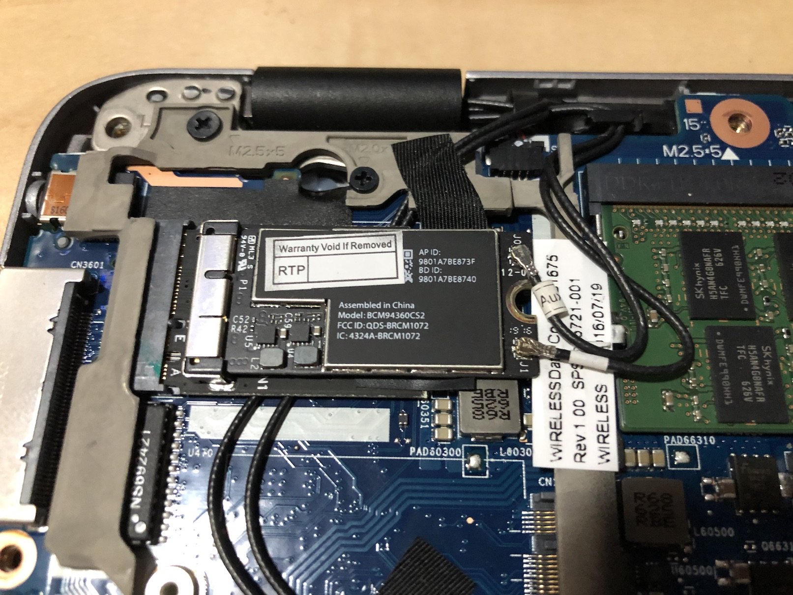

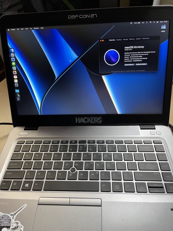

Donw35 Posted August 22, 2018 Share Posted August 22, 2018 (edited) OpenCore 0.7.5 and Monterey fully working My G3 has the BCM84360CS2 mod, I got the module from eBay for $10 and the adapter for $10 off amazon. Method: USB Big Sur installation Create an Monterey or Big Sur USB installer (google is your friend here, plenty of tutorials there) Mount the EFI partition of your USB installer using Clover Configurator Copy the EFI file attached here. Boot your laptop using F9 and choose the USB installer and follow the prompts Spoiler Credits go to Jake Lo for creating this EFI file. I did make some changes to his, this one is Open Core 0.7.5 and latest kexts, make sure you get your own serial numbers in the config.plist HP-840-G3-Opencore_0.7.5.zip Edited November 1, 2021 by Donw35 updated 10 1 Link to comment https://www.insanelymac.com/forum/topic/335269-hp-840-g3-elitebook-wifi-and-bluetooth-resolved-monterey-big-sur/ Share on other sites More sharing options...
Donw35 Posted August 26, 2018 Author Share Posted August 26, 2018 (edited) I resolved the WiFi and Bluetooth issues by using a supported module NOTE I have found that the NCM94322 doesn't work well in Catalina, it does kind of work but other problems like iMessage and FaceTime are problematic. I recommend using the BCM94360, its supported and all works. BCM943224PCIEBT2 Card To NGFF(M.2) Key A/E Adapter from Amazon for $14 MacBook Air 13 A1369 11 A1370 WiFi Bluetooth Air Port Card from eBay $10 I had to do some cutting on the A/E adapter but was able to get it to fit, its a lot taller but the case closes without problems. I rather like this hack as the WiFi and Bluetooth are needed services and OS support will increase over all performance and confidence. Edited October 23, 2019 by Donw35 2 Link to comment https://www.insanelymac.com/forum/topic/335269-hp-840-g3-elitebook-wifi-and-bluetooth-resolved-monterey-big-sur/#findComment-2631729 Share on other sites More sharing options...

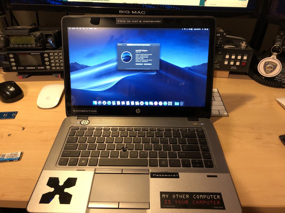

Donw35 Posted September 26, 2018 Author Share Posted September 26, 2018 If you want Mojave on this system, this is what I did. Copied EFI folder to a thumb drive took the SSD out of the laptop and installed Mojave from a real mac installed clover and put the EFI folder from the thumb drive reboot and done. 2 Link to comment https://www.insanelymac.com/forum/topic/335269-hp-840-g3-elitebook-wifi-and-bluetooth-resolved-monterey-big-sur/#findComment-2636820 Share on other sites More sharing options...

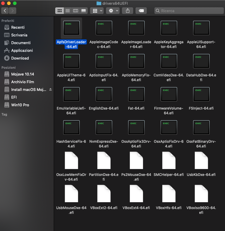

Baio77 Posted November 11, 2018 Share Posted November 11, 2018 On 9/28/2018 at 9:36 PM, Donw35 said: I haven't done it but you will have to contact HP and flash the bios using a CMOS.bin file. For those that are interested, here is my clover stuff for the HP 840 G3 HP_840_G3_Clover.zip Donw35 this your DRIVER UEFI , they are too many, you put them ALL ... the renames see in the pictures are correct for your HW The kext are to be updated Test this Clover and Post ioreg with these settings if it starts Clover.zip 1 Link to comment https://www.insanelymac.com/forum/topic/335269-hp-840-g3-elitebook-wifi-and-bluetooth-resolved-monterey-big-sur/#findComment-2646936 Share on other sites More sharing options...
Donw35 Posted November 11, 2018 Author Share Posted November 11, 2018 (edited) Correct, that is an old EFI folder, I am going to remove it and add the latest one when I get home. sorry for the confusion. EDIT- I added the new clover folder Edited October 30, 2019 by Donw35 3 Link to comment https://www.insanelymac.com/forum/topic/335269-hp-840-g3-elitebook-wifi-and-bluetooth-resolved-monterey-big-sur/#findComment-2647013 Share on other sites More sharing options...

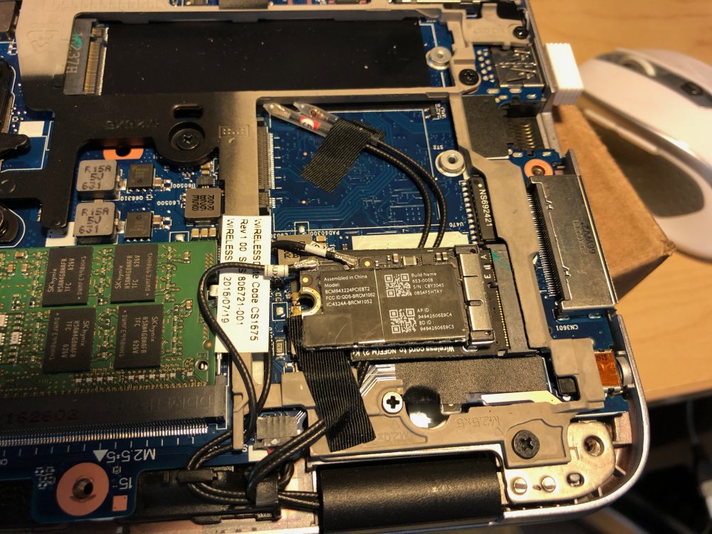

linuxmac Posted May 5, 2019 Share Posted May 5, 2019 (edited) El 26/8/2018 a la 1:40, Donw35 dijo: BCM943224PCIEBT2 Tarjeta a NGFF (M.2) Adaptador A / E de Amazon por $ 14 MacBook Air 13 A1369 11 A1370 WiFi Tarjeta de puerto Bluetooth Air de eBay $ 10 Hola ¿Tienes un enlace a este producto? gracias Hello do you have a link to this products? thanx and sorry my english Edited May 5, 2019 by linuxmac Link to comment https://www.insanelymac.com/forum/topic/335269-hp-840-g3-elitebook-wifi-and-bluetooth-resolved-monterey-big-sur/#findComment-2672681 Share on other sites More sharing options...
Donw35 Posted May 5, 2019 Author Share Posted May 5, 2019 adapter https://www.amazon.com/gp/product/B01JGERLOS/ref=ppx_yo_dt_b_search_asin_title?ie=UTF8&psc=1 wifi card https://www.ebay.com/itm/MacBook-Air-13-A1465-A1466-2013-2014-WiFi-Bluetooth-Air-Port-Card-BCM94360CS2-AP/262144387375?hash=item3d0905e92f:g:rfUAAOSwTGBcmoCR:sc:USPSFirstClass!90245!US!-1 Link to comment https://www.insanelymac.com/forum/topic/335269-hp-840-g3-elitebook-wifi-and-bluetooth-resolved-monterey-big-sur/#findComment-2672683 Share on other sites More sharing options...

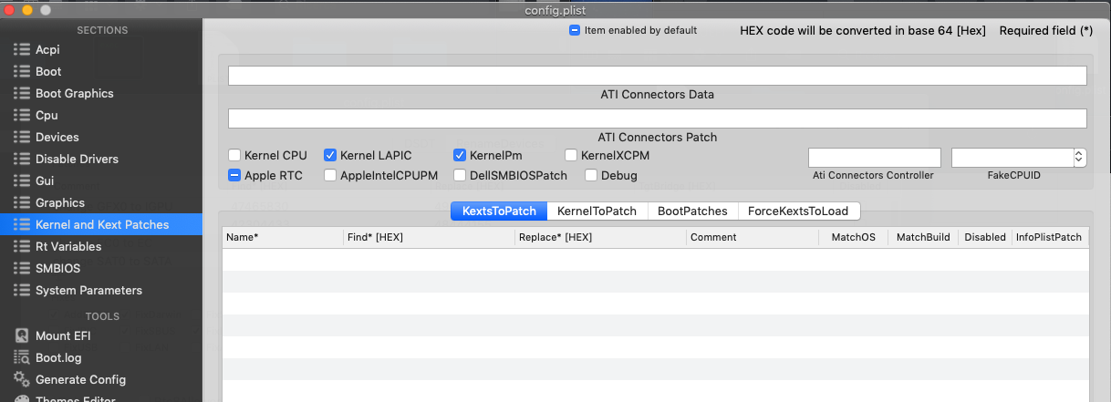

Isaac24 Posted September 7, 2019 Share Posted September 7, 2019 first of All, thanks for sharing your own experience and Clover with us here ... it made it much easier to install, since i'm not a fan of DSDT patching stuff ! Nonetheless I have some issues would be glad if someone can help me with: 1- I can't upgrade Clover every-time i do that the Laptop fails to boot ,it shows Apple Logo only and shut down no idea what the problem , so I keep on the latest version shared here 4920 . 2- the Sound output doesn't change automatically when 3.5 mm plugged in , with googling I understood this has to do with AppleALC patching i'm not sure . 3- the laptop doesn't always sleep with closing Lid or it sleeps and wakes up immediately , I wonder if USB wifi is the reason ? I did order BCM94360CS2 card and its adapter maybe this issue would be solved after replacement. Away from that I guess the device is doing great on Mojave ! i'm glad that I could use it for everyday stuff and my studying anyone has faced those troubles or has suggestions - solutions ? would be thankful ! 1 Link to comment https://www.insanelymac.com/forum/topic/335269-hp-840-g3-elitebook-wifi-and-bluetooth-resolved-monterey-big-sur/#findComment-2689091 Share on other sites More sharing options...
