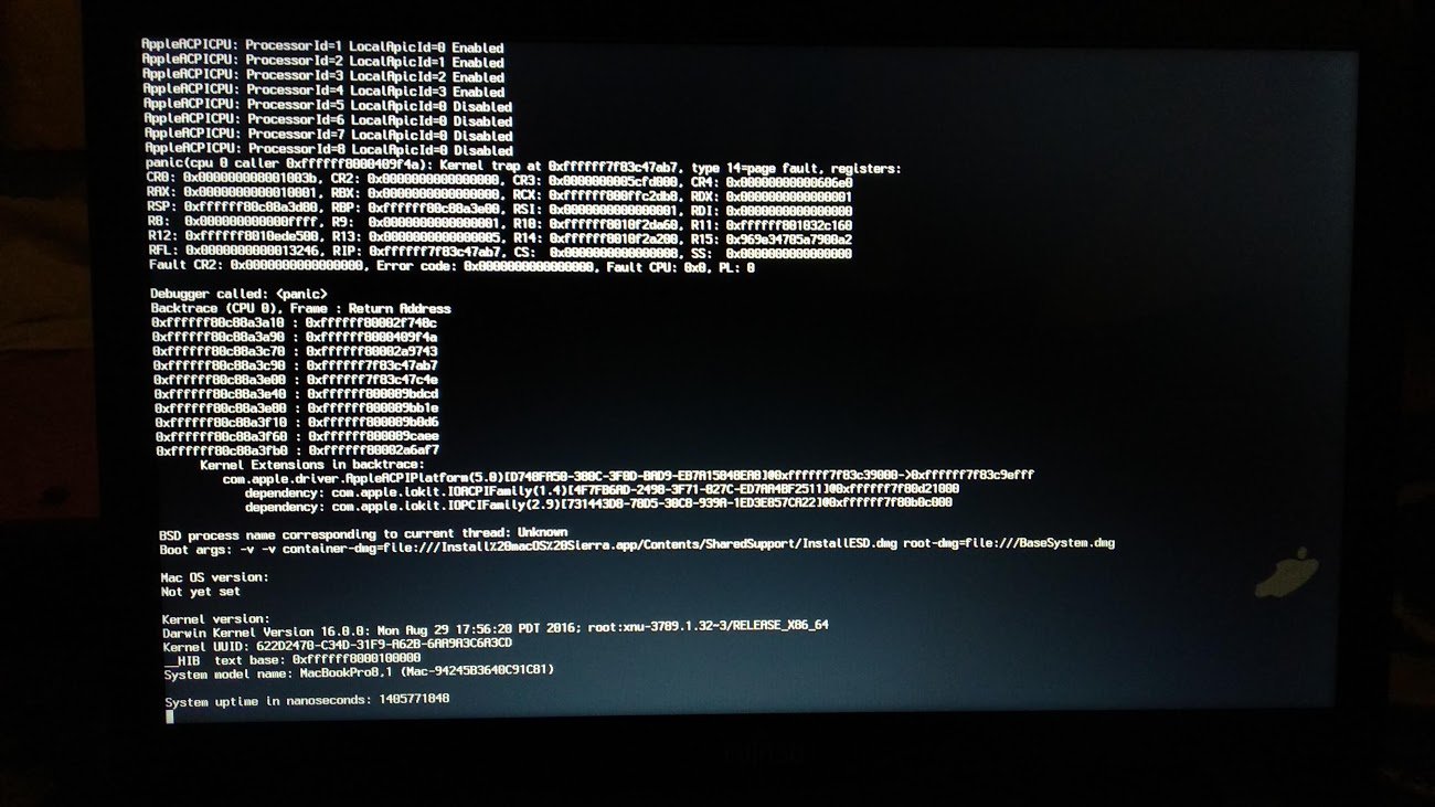

Guest Posted July 31, 2018 Share Posted July 31, 2018 (edited) Hi All, I've recently bought a Fujitsu Ah512 (please move this thread if it's in the wrong place, apologies if so!) I've fitted an Intel I5 2450m SandyBridge (HM75 7 series chipset) to the board, It has internal GPU of HD 3000 (1368 x 768). The Motherboard is FJNBB29. I've been trying for a week to get this to run the Sierra Installer, but sadly it hits an unresponsive, black screen when I select it. There's nothing outputting to the HDMI port, (I haven't checked VGA, but being VGA I'd assume not.) I cannot boot verbose either so I cannot log what's going on. FakeSMC is present in the kext/other folder. I've tried to boot with intel injection disabled and still that hasn't helped. Please let me know if you've any suggestions, I was really hoping to get this sorted as my macbook pro is getting on and I'd like to use this one to carry some of the macbook's work. Many Thanks Jiji CLOVER.zip Edited August 23, 2018 by JijiTheFox Corrected wrong information Link to comment https://www.insanelymac.com/forum/topic/335037-solved-issues-booting-sierra-installer-unable-to-reach-installer/ Share on other sites More sharing options...
Guest Posted July 31, 2018 Share Posted July 31, 2018 24 minutes ago, Hervé said: Any reason why you're injecting some nVidia + ATI graphics properties in Clover? Hi Hervé I'll be honest I have no idea. I have been trying many things across the forums and sites. The config plist was generic/prebuilt for HD3000 at my resolution, it was one of the the last thing I tried. Will happily try disabling all those if it could help Link to comment https://www.insanelymac.com/forum/topic/335037-solved-issues-booting-sierra-installer-unable-to-reach-installer/#findComment-2628297 Share on other sites More sharing options...
Guest Posted July 31, 2018 Share Posted July 31, 2018 Just gave it a try, still black screen sadly. Would it be just a display issue or something more? The LEDs on the USB hard drive just stop flashing the moment I select the installer. Link to comment https://www.insanelymac.com/forum/topic/335037-solved-issues-booting-sierra-installer-unable-to-reach-installer/#findComment-2628305 Share on other sites More sharing options...

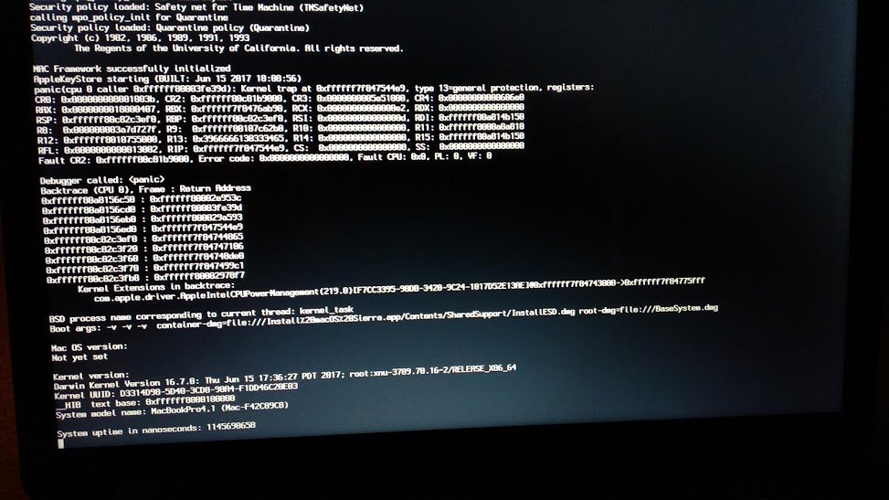

Guest Posted August 1, 2018 Share Posted August 1, 2018 I had 5 minutes free this morning, so I made an Enoch USB Bootloader. This gets me further into the installer with a verbose screen! I've used Clover for what seems like forever now as it's been on my desktop, so I'm getting rusty. I've hit the AppleCPUPowerManagement kernel panic intsantly.. should this be resolved with a NULLCPUPower kext? Also with Enoch.. being that it is a branch of Chameleon, should this be Extra/Extensions? I had to manually make that folder and add FakeSMC and NULLCPU but I hit that panic again (I know this is a basic issue I've fixed it in the past, it's just been a long time.) Link to comment https://www.insanelymac.com/forum/topic/335037-solved-issues-booting-sierra-installer-unable-to-reach-installer/#findComment-2628362 Share on other sites More sharing options...

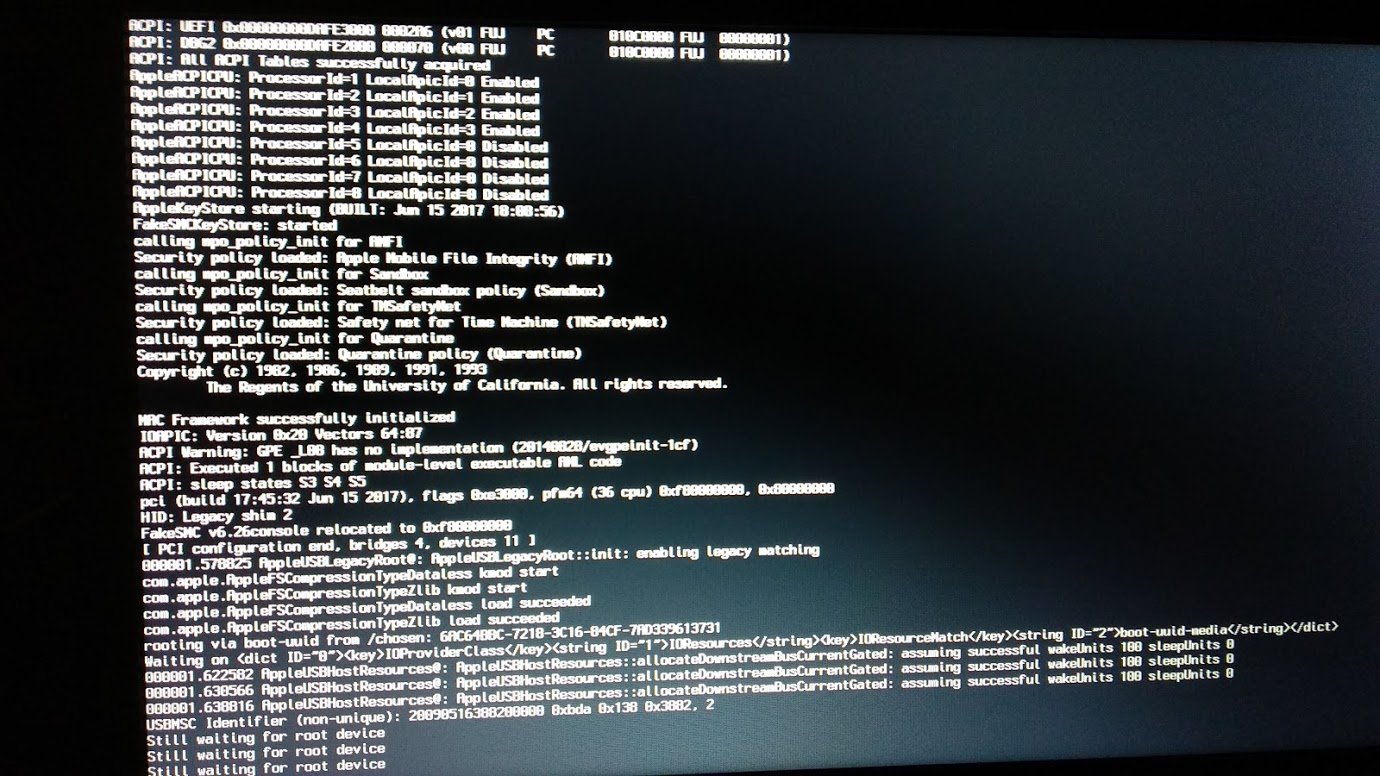

Guest Posted August 1, 2018 Share Posted August 1, 2018 (edited) Hervé, thank you so much for your help so far that could not have been more helpful. I've gotten much further in and I'm now stuck at USBMC Identifier (non-unique): 20090516388200000 0xbda 0x138 0x3882, 2 I've looked around on Google but there's no specific root cause found on any thread. Would you happen to know about this? Many Thanks again Edited August 1, 2018 by Jiji The Fox Link to comment https://www.insanelymac.com/forum/topic/335037-solved-issues-booting-sierra-installer-unable-to-reach-installer/#findComment-2628418 Share on other sites More sharing options...
Guest Posted August 3, 2018 Share Posted August 3, 2018 Quick question for anyone who may see this: Would Clover Legacy be more recommended than Enoch? This USBSMC error doesn't seem to be very positive in terms of fixing, i've not found much information on it online. I've not been home much lately due to work commitments but I'll try to make a legacy Clover boot if that'd be a preferable option. Link to comment https://www.insanelymac.com/forum/topic/335037-solved-issues-booting-sierra-installer-unable-to-reach-installer/#findComment-2628635 Share on other sites More sharing options...
Guest Posted August 7, 2018 Share Posted August 7, 2018 Update: Neither Clover Legacy or EFI works, so I've stuck with enoch. I've bought a USB 3.0 express card, which when booted through gets me past any USB SMC hangs. I'm now stuck at a different line.. IOSCSIPeripheralDeviceType05... Link to comment https://www.insanelymac.com/forum/topic/335037-solved-issues-booting-sierra-installer-unable-to-reach-installer/#findComment-2629270 Share on other sites More sharing options...

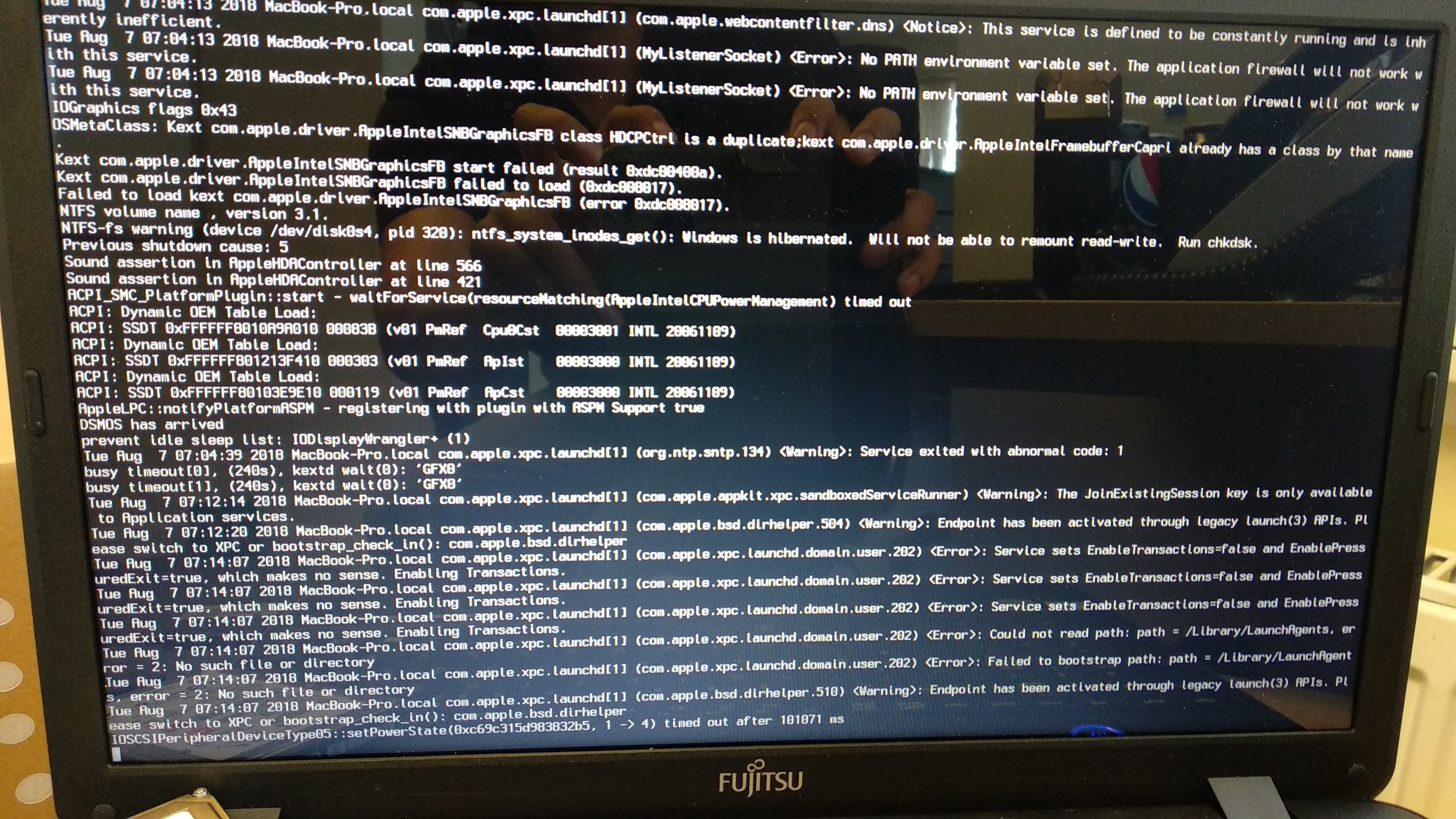

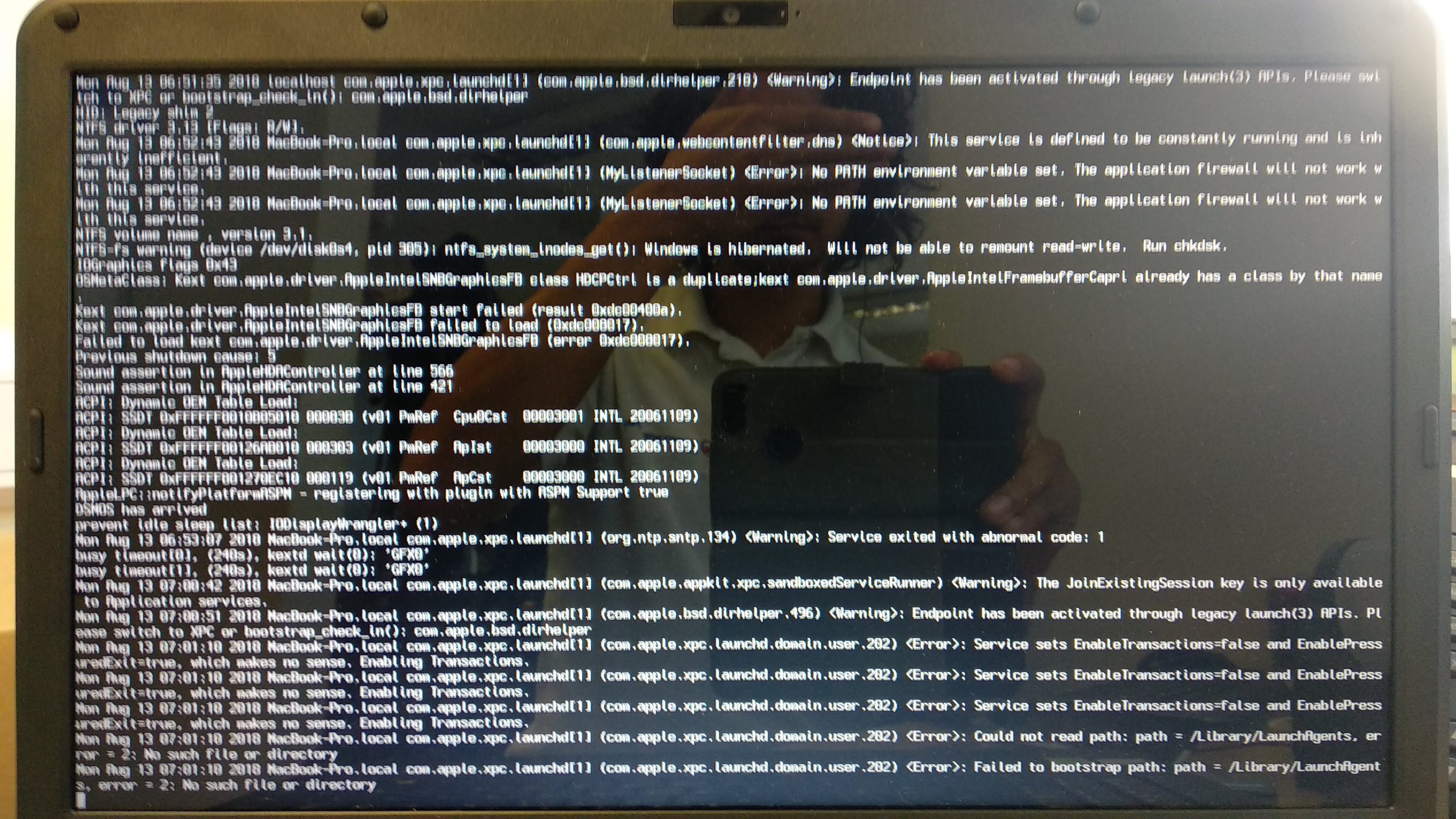

Guest Posted August 13, 2018 Share Posted August 13, 2018 Gotten further with Enoch Bootloader. I'm stuck here and the scouring the internet isn't helping me. Anyone have any ideas? Thank you in advance Link to comment https://www.insanelymac.com/forum/topic/335037-solved-issues-booting-sierra-installer-unable-to-reach-installer/#findComment-2629927 Share on other sites More sharing options...
Baio77 Posted August 13, 2018 Share Posted August 13, 2018 Rename GFX0 to IGPU Link to comment https://www.insanelymac.com/forum/topic/335037-solved-issues-booting-sierra-installer-unable-to-reach-installer/#findComment-2629956 Share on other sites More sharing options...
Guest Posted August 13, 2018 Share Posted August 13, 2018 1 hour ago, Baio77 said: Rename GFX0 to IGPU Hi Baio77, Is this on the DSDT I need to do the rename? Link to comment https://www.insanelymac.com/forum/topic/335037-solved-issues-booting-sierra-installer-unable-to-reach-installer/#findComment-2629971 Share on other sites More sharing options...
Baio77 Posted August 13, 2018 Share Posted August 13, 2018 you can try patching on DSDT or Fix in Bootloader google traslate Link to comment https://www.insanelymac.com/forum/topic/335037-solved-issues-booting-sierra-installer-unable-to-reach-installer/#findComment-2629987 Share on other sites More sharing options...
Guest Posted August 13, 2018 Share Posted August 13, 2018 I tried to patch the DSDT via the method here https://github.com/Ramalama2/Clover-DSDT/blob/master/DSDT Patches/[ALL] 3. Rename GFX0 IGPU.txt But I'm getting a kernel panic Link to comment https://www.insanelymac.com/forum/topic/335037-solved-issues-booting-sierra-installer-unable-to-reach-installer/#findComment-2630006 Share on other sites More sharing options...
fusion71au Posted August 14, 2018 Share Posted August 14, 2018 (edited) 12 hours ago, Jiji The Fox said: Gotten further with Enoch Bootloader. I'm stuck here and the scouring the internet isn't helping me. Anyone have any ideas? Thank you in advance Your boot log shows "Kext com.apple.driver.AppleIntelSNBGraphicsFB failed to load" ---> will need graphics_MEI_sandy dsdt fix or use FakeID with Clover. Google for @RehabMan guide for running Sandy Bridge CPU (with HD3000) on 7 series board. He has a GIT hub with some sample Clover configs eg https://github.com/RehabMan/OS-X-Clover-Laptop-Config/blob/master/config_HD3000_1366x768_7series.plist. Edited August 14, 2018 by fusion71au Link to comment https://www.insanelymac.com/forum/topic/335037-solved-issues-booting-sierra-installer-unable-to-reach-installer/#findComment-2630019 Share on other sites More sharing options...
Guest Posted August 14, 2018 Share Posted August 14, 2018 20 hours ago, fusion71au said: Your boot log shows "Kext com.apple.driver.AppleIntelSNBGraphicsFB failed to load" ---> will need graphics_MEI_sandy dsdt fix or use FakeID with Clover. Google for @RehabMan guide for running Sandy Bridge CPU (with HD3000) on 7 series board. He has a GIT hub with some sample Clover configs eg https://github.com/RehabMan/OS-X-Clover-Laptop-Config/blob/master/config_HD3000_1366x768_7series.plist. I've tried the above DSDT fix but sadly it hasn't worked, oddly enough still the same error. I can't use the config plists as Clover is a dead end for me, I'm only getting a Verbose with Enoch/Chameleon, would there be any equivalence in bootflags, or entry to add to the org.chameleon.boot.plist? Link to comment https://www.insanelymac.com/forum/topic/335037-solved-issues-booting-sierra-installer-unable-to-reach-installer/#findComment-2630132 Share on other sites More sharing options...
