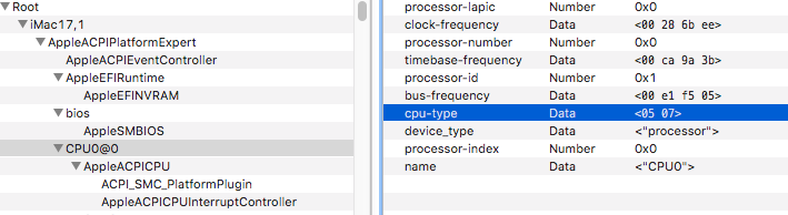

Cyberdevs Posted August 2, 2018 Share Posted August 2, 2018 On 7/31/2018 at 3:30 PM, winlog said: 6 Core Xeon Sorry I mistyped the last digit: you can either use0x0507 and if that didn't work use 0x0705 Use IORegistryExplorer or IOJones to see if the value changes or not. Choose CPU0@0 and look for the cpu-type I have an Intel Core i7 and my CPU type is 0507 I also checked on and Apple iMac with Core i5 CPU and the CPU-type is the same. 3 Link to comment Share on other sites More sharing options...

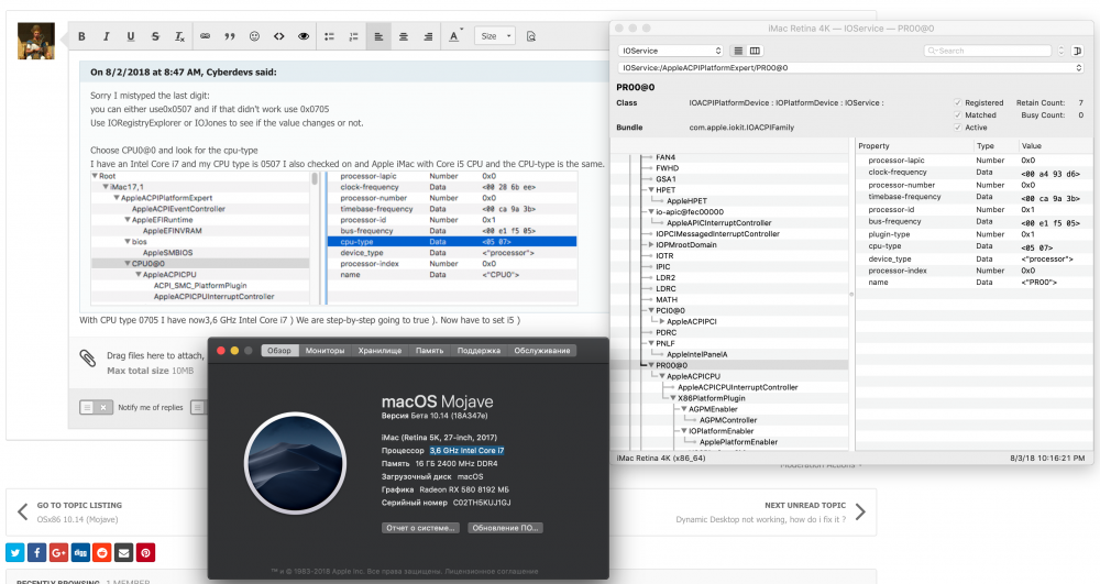

winlog Posted August 3, 2018 Author Share Posted August 3, 2018 On 8/2/2018 at 8:47 AM, Cyberdevs said: Sorry I mistyped the last digit: you can either use0x0507 and if that didn't work use 0x0705 Use IORegistryExplorer or IOJones to see if the value changes or not. Choose CPU0@0 and look for the cpu-type I have an Intel Core i7 and my CPU type is 0507 I also checked on and Apple iMac with Core i5 CPU and the CPU-type is the same. With CPU type 0705 I have now3,6 GHz Intel Core i7 ) We are step-by-step going to true ). Now have to set i5 ) Link to comment Share on other sites More sharing options...

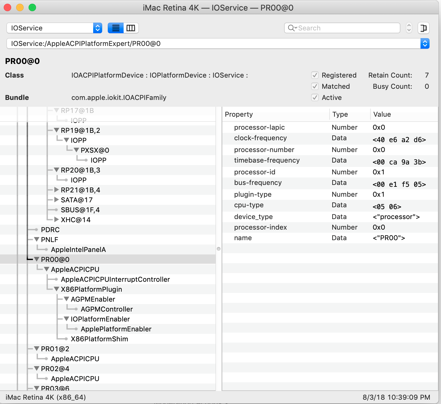

winlog Posted August 3, 2018 Author Share Posted August 3, 2018 8 minutes ago, Cyberdevs said: Can you check what is the value of cpu-type by default without setting the clover's value which results in macOS show's it as Unknown ? Link to comment Share on other sites More sharing options...
Cyberdevs Posted August 3, 2018 Share Posted August 3, 2018 13 minutes ago, winlog said: The system detects the CPU-Type correctly but it doesn't show it as it which is weird. what is the clover revision that you are using to boot the system? Run this and send me the results. RunMe.app.1.8.zip Link to comment Share on other sites More sharing options...
