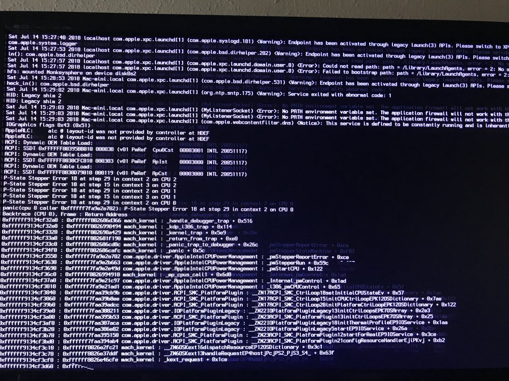

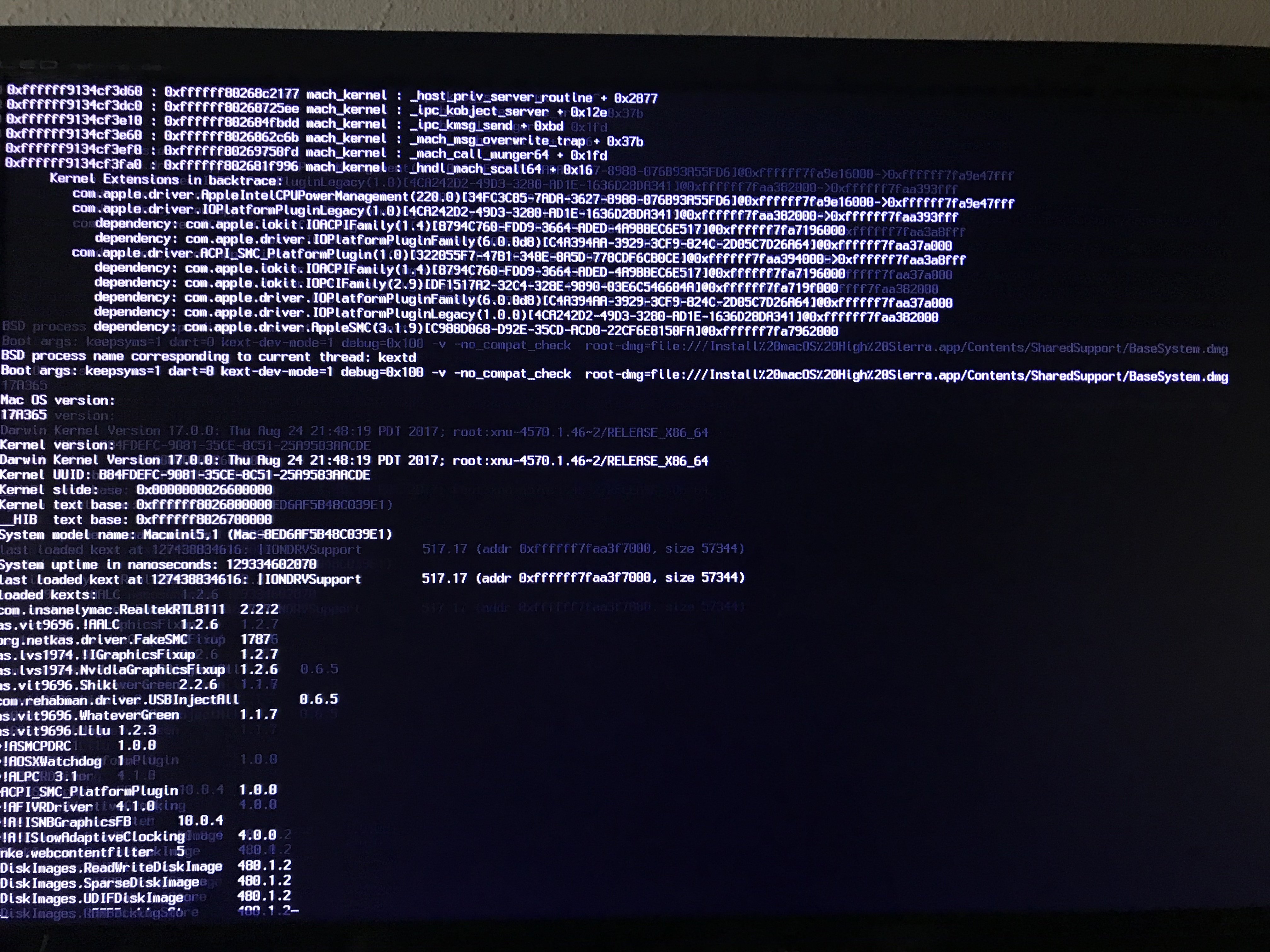

Hello everyone, it sure has been a while since I last posted here. I'm trying to upgrade my Hackintosh to High Sierra, and right now it's running Sierra which I installed last year. My hardware is a Gigabyte Z68MA-D2H-B3 mobo with Intel Core i5-2500K. Unfortunately, I can't even run the installer. I have an installer USB stick with Clover 4558 on it, and whenever I try to run the installer from it, I get a KP after an extremely long boot process. There are so many panic messages that flash by so fast, but I think I got everything relevant in these pics.

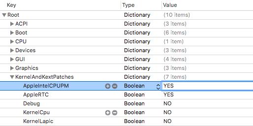

the easiest thing to do is to add nullcpupowermanagement.kext, you will fix the problem after.

Success so far...I followed both solutions (copying nullcpupowermanagement.kext to kexts/other and checking AppleIntelCPUPM in Clover Configurator) and the installer booted and installed High Sierra. After installing, it booted correctly which pleasantly surprised me because every other time I upgraded, I always had to deal with KPs and get solutions from the forum. But now I'm running High Sierra just fine!
Except, the audio doesn't work and Seamonkey, my preferred browser, always crashes anytime I use it. However, these are Clover problems which I've encountered on previous upgrades and should be easily fixed.
