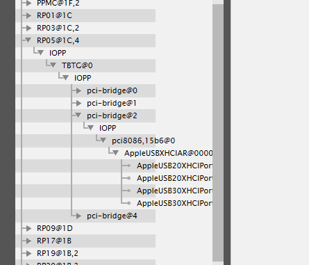

firstmiro Posted June 24, 2018 Share Posted June 24, 2018 Hi, I need help with fixing Thunderbolt on High Sierra and GA-Z170X-UD5 TH mobo. Anyone who is willing to invest some time, and share his knowledge (DSDT/SSDT) with me? Can be commercial help ;-) Setup: GA-Z170X-UD5 TH i7-7700K Radeon RX 580, 8GB Crucial MX500 SSD 32GB RAM Broadcom BCM43xx (AirPort Extreme) WiFi + Bluetooth Clover Windows 10 dual boot (separate disk) System is up and running. Sleep, shutdown, power management - fully working. Whatever I will do - no way to keep Thunderbolt on. But - it is on the system. Sometimes it works (randomly after restart). As mentioned above - any help (commercial also) fully appreciated. Best, fm Link to comment https://www.insanelymac.com/forum/topic/334672-ga-z170x-ud5-th-with-thunderbolt-working-high-sierra/ Share on other sites More sharing options...

Slice Posted August 31, 2018 Share Posted August 31, 2018 I have this motherboard and I have Thunderbolt working in High Sierra. But it is possible if a device already inserted into thunderbolt (for example USB-C to USB-3 adapter) because PCIe has no hot plug in MacOS. Link to comment https://www.insanelymac.com/forum/topic/334672-ga-z170x-ud5-th-with-thunderbolt-working-high-sierra/#findComment-2632555 Share on other sites More sharing options...
firstmiro Posted September 14, 2018 Author Share Posted September 14, 2018 Hi Slice. Thank you for your answer. I've got TB3 port working like that. Link to comment https://www.insanelymac.com/forum/topic/334672-ga-z170x-ud5-th-with-thunderbolt-working-high-sierra/#findComment-2634757 Share on other sites More sharing options...
