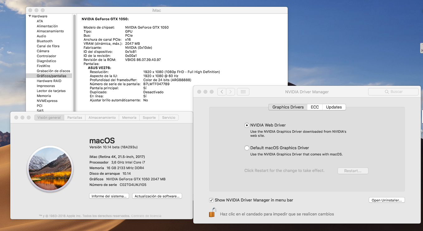

Derty Posted June 6, 2018 Share Posted June 6, 2018 No me van la grafica ni el sonido aun. clover 4515 Clover_v2.4k_r4515.pkg.zip montador EFi para 10.14 MountEFI-update.zip fakesmc que me funcionó RehabMan-FakeSMC-2018-0403.zip apfs.efi apfs.efi.zip 2 Link to comment https://www.insanelymac.com/forum/topic/334351-material-de-instalaci%C3%B3n-de-la-beta/ Share on other sites More sharing options...

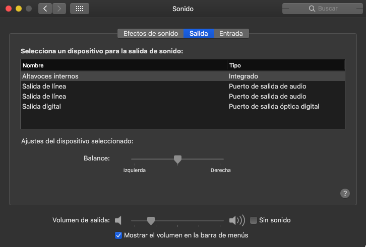

camillionario Posted June 6, 2018 Share Posted June 6, 2018 Grafico= no Sonido=Si Alc 1150, Layout 7 + Alc/Lilu recientes + -alcbetaall Flag. Intenta cambiar Layout y prueba. Link to comment https://www.insanelymac.com/forum/topic/334351-material-de-instalaci%C3%B3n-de-la-beta/#findComment-2617331 Share on other sites More sharing options...
Derty Posted June 6, 2018 Author Share Posted June 6, 2018 ok sonido cambiando ID a 7 y -alcbetaall -lilubeta Link to comment https://www.insanelymac.com/forum/topic/334351-material-de-instalaci%C3%B3n-de-la-beta/#findComment-2617349 Share on other sites More sharing options...

Derty Posted June 7, 2018 Author Share Posted June 7, 2018 nada la 1050 por ahora no tira... la reconoce ahora, con su memoria.. pero sin aceleración.. el mouse por ahí se relentiza, el Chrome hace cosas raras, y así y todo puedo ver youtube.. Link to comment https://www.insanelymac.com/forum/topic/334351-material-de-instalaci%C3%B3n-de-la-beta/#findComment-2617540 Share on other sites More sharing options...

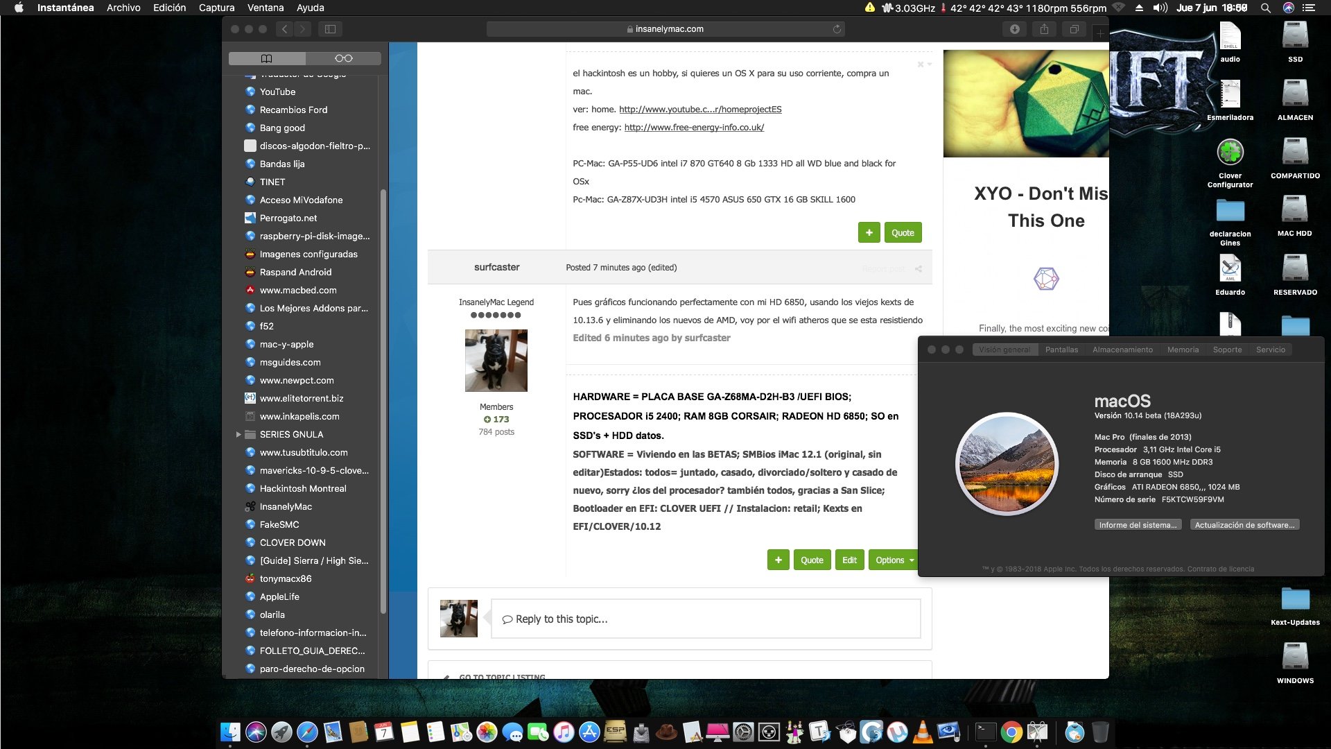

surfcaster Posted June 7, 2018 Share Posted June 7, 2018 (edited) Pues gráficos funcionando perfectamente con mi HD 6850, usando los viejos kexts de 10.13.6 y eliminando los nuevos de AMD, voy por el wifi atheros que se esta resistiendo Edited June 7, 2018 by surfcaster 1 Link to comment https://www.insanelymac.com/forum/topic/334351-material-de-instalaci%C3%B3n-de-la-beta/#findComment-2617543 Share on other sites More sharing options...

kaoskinkae Posted June 11, 2018 Share Posted June 11, 2018 (edited) En mi caso el sonido chip via vt2021 no funciona si no le añades -lilubetaall . El wifi esperare a versiones siguiente aunque se que es posible activarlo usando el kext de High Sierra. Edited June 11, 2018 by kaoskinkae Link to comment https://www.insanelymac.com/forum/topic/334351-material-de-instalaci%C3%B3n-de-la-beta/#findComment-2618434 Share on other sites More sharing options...

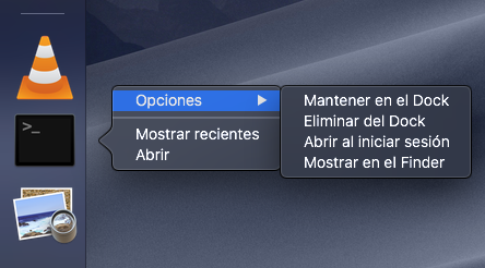

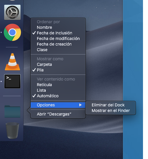

uzmi Posted June 17, 2018 Share Posted June 17, 2018 (edited) Hola: Si abro algún programa (ejemplo Terminal) se queda fijo en el Dock. O sea que para quitarlo del dock debo ir a opciones y eliminar del dock. ¿Alguien mas? ¿Tiene solución? Edited June 17, 2018 by uzmi Link to comment https://www.insanelymac.com/forum/topic/334351-material-de-instalaci%C3%B3n-de-la-beta/#findComment-2620278 Share on other sites More sharing options...
surfcaster Posted June 17, 2018 Share Posted June 17, 2018 (edited) cierto pero solo me almacena hasta un cierto numero de programas, luego va sustituyendo los mas viejos o anteriores, es una especie de ultimas aplicaciones usadas, para ser mas exactos en preferencias del dock, la ultima linea desmárcala //show recents in Dock// me has hecho reiniciar desde Yosemite para verlo y soy muyyyyy vago, te resto una cerveza de las que te debo que son muchas Edited June 17, 2018 by surfcaster 1 Link to comment https://www.insanelymac.com/forum/topic/334351-material-de-instalaci%C3%B3n-de-la-beta/#findComment-2620395 Share on other sites More sharing options...
