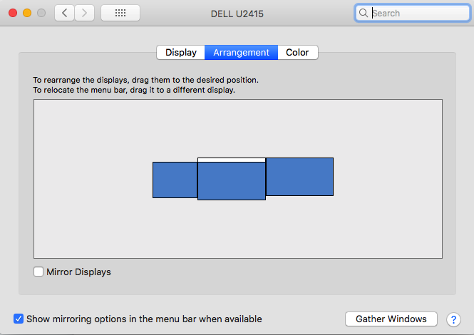

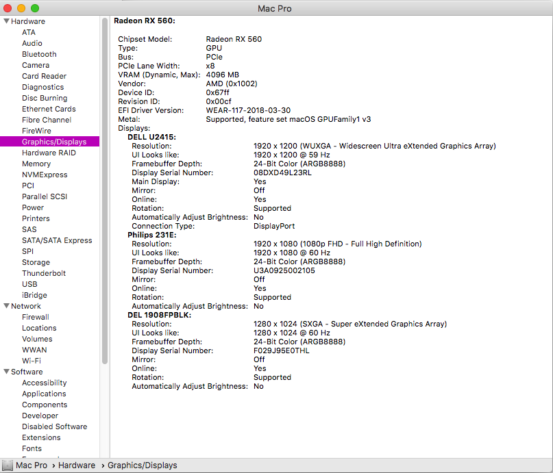

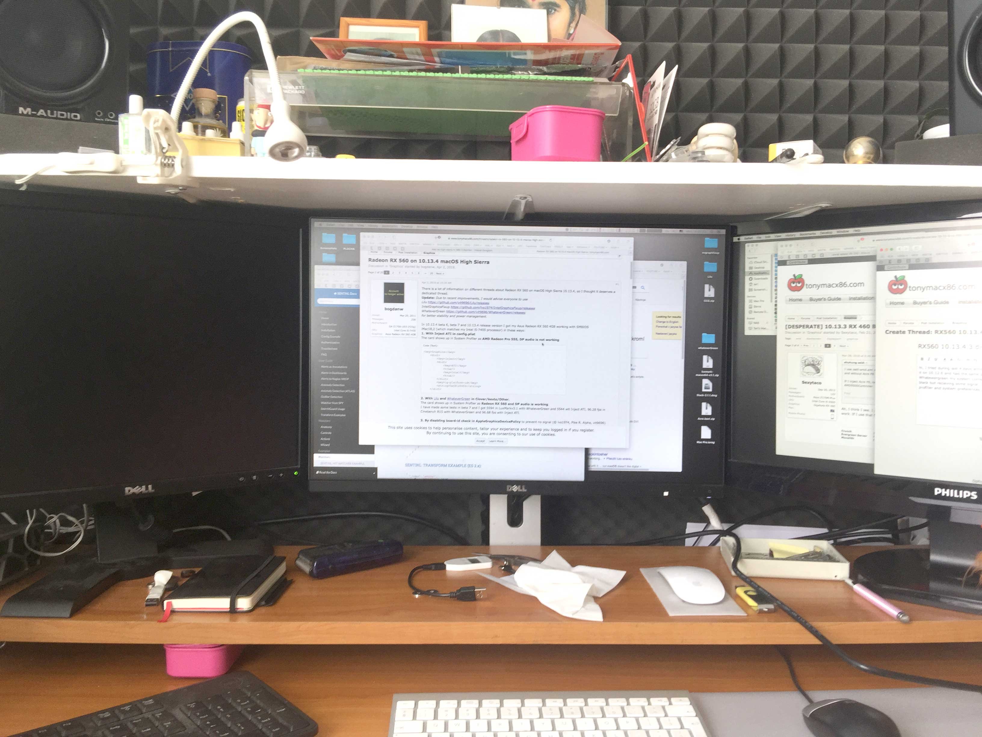

Teress Posted May 28, 2018 Share Posted May 28, 2018 Hi, I tried during last 4 days almost everything but now I call for help. I have RX560 running on 10.13.4. Previously I was running it on 10.12.6 and had the same problem, but after waking from sleep my thiord display came to life, but it is not working anymore on 10.13.4. Without or with Lilu & Whatewergreen my system correctly recognize my gpu as RX560 but only 2 of 3 displays are displaying content, third display is black but recieving some signal. When I change cabling and connect only two, any combination of 2 displays is working. System profiller and system preferences are sayin I have 3 displays connected.Please can somebody help me to figure it out?Thanks a lot in advance. Tried to upload my ioreg but it is greater than 10MB allowed for me :( Link to comment https://www.insanelymac.com/forum/topic/334212-rx560-10134-3-displays-two-ok-third-is-black/ Share on other sites More sharing options...
Pavo Posted May 28, 2018 Share Posted May 28, 2018 I'm assuming the Dell 1908FPBLK is the monitor that is not working and the Philips 231E is using DVI cable? What cable are you using to connect the Dell 1908FPBLK? Link to comment https://www.insanelymac.com/forum/topic/334212-rx560-10134-3-displays-two-ok-third-is-black/#findComment-2615511 Share on other sites More sharing options...
Teress Posted May 28, 2018 Author Share Posted May 28, 2018 @Pavo Yes left black screen is the DELL 19. But when I connect middle display Dell and left Dell without the right Philips, the left Dell is working. When I plug the third right Philips to it, then system is telling all 3 is working but at this moment only left and mmiddle Dell are displaying some content. So which display will be black depends on order in which they are connected. Link to comment https://www.insanelymac.com/forum/topic/334212-rx560-10134-3-displays-two-ok-third-is-black/#findComment-2615516 Share on other sites More sharing options...

Pavo Posted May 28, 2018 Share Posted May 28, 2018 1 minute ago, Teress said: @Pavo Yes left black screen is the DELL 19. But when I connect middle display Dell and left Dell without the right Philips, the left Dell is working. When I plug the third right Philips to it, then system is telling all 3 is working but at this moment only left and mmiddle Dell are displaying some content. So which display will be black depends on order in which they are connected. What connectors are you using for each display? Link to comment https://www.insanelymac.com/forum/topic/334212-rx560-10134-3-displays-two-ok-third-is-black/#findComment-2615518 Share on other sites More sharing options...
Teress Posted May 28, 2018 Author Share Posted May 28, 2018 Left Dell is connected DVI - DVI, Middle Dell is DP - DP, right Philips is HDMI - DVI. Link to comment https://www.insanelymac.com/forum/topic/334212-rx560-10134-3-displays-two-ok-third-is-black/#findComment-2615519 Share on other sites More sharing options...

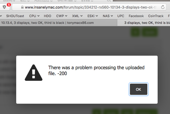

Teress Posted May 28, 2018 Author Share Posted May 28, 2018 The ioreg is here: https://www.tonymacx86.com/attachments/mac-pro-ioreg.333243/ Tried to upload a 3.5MB ZIP to here, but it gives me error -200. Weird. Link to comment https://www.insanelymac.com/forum/topic/334212-rx560-10134-3-displays-two-ok-third-is-black/#findComment-2615520 Share on other sites More sharing options...

Teress Posted May 28, 2018 Author Share Posted May 28, 2018 (edited) Unabke to send the generated ZIP Edited May 28, 2018 by Teress Link to comment https://www.insanelymac.com/forum/topic/334212-rx560-10134-3-displays-two-ok-third-is-black/#findComment-2615527 Share on other sites More sharing options...
Pavo Posted May 28, 2018 Share Posted May 28, 2018 Just now, Teress said: Unabke to send the generated ZIP Use Dropbox Link to comment https://www.insanelymac.com/forum/topic/334212-rx560-10134-3-displays-two-ok-third-is-black/#findComment-2615528 Share on other sites More sharing options...

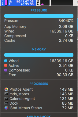

Teress Posted May 28, 2018 Author Share Posted May 28, 2018 (edited) 12 minutes ago, Pavo said: Unzip this and copy and replace inside your Clover folder with the ones from the zip file and test. CLOVER.zip So I deleted all my kexts in 10.12 and 10.13 folders and copied all your files to propper location. It booted. But my RAM is not recognized correctly and still have only 2 displays with content, one still black. I my old clover conf had the ram slots exact as it should. I have 96GB RAM, now it shows 48 and istats are going crazy. I also lost all my icloud, imessage etc. because of different settings. From Safari I can't even post a message to forum. Edited May 28, 2018 by Teress Link to comment https://www.insanelymac.com/forum/topic/334212-rx560-10134-3-displays-two-ok-third-is-black/#findComment-2615546 Share on other sites More sharing options...
