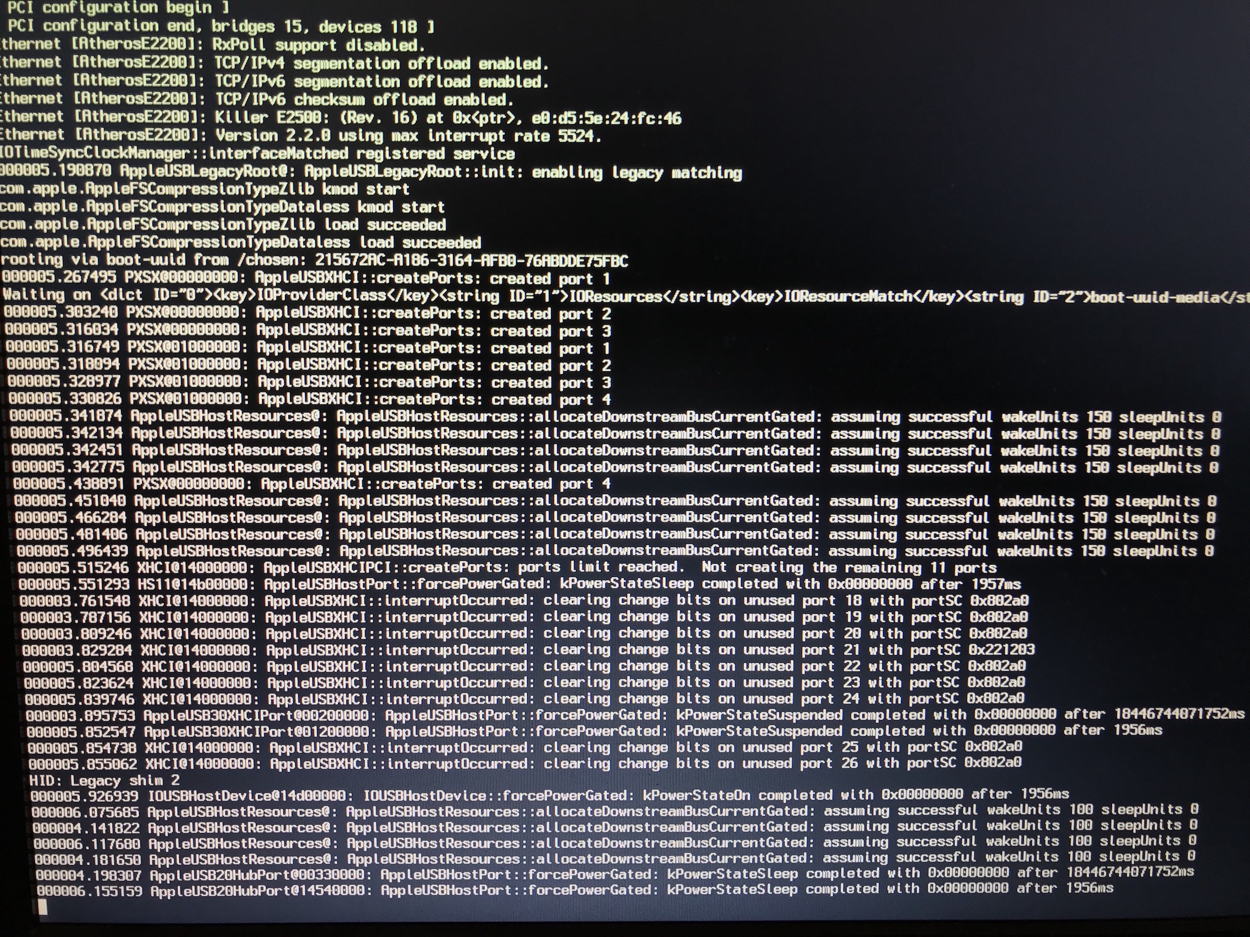

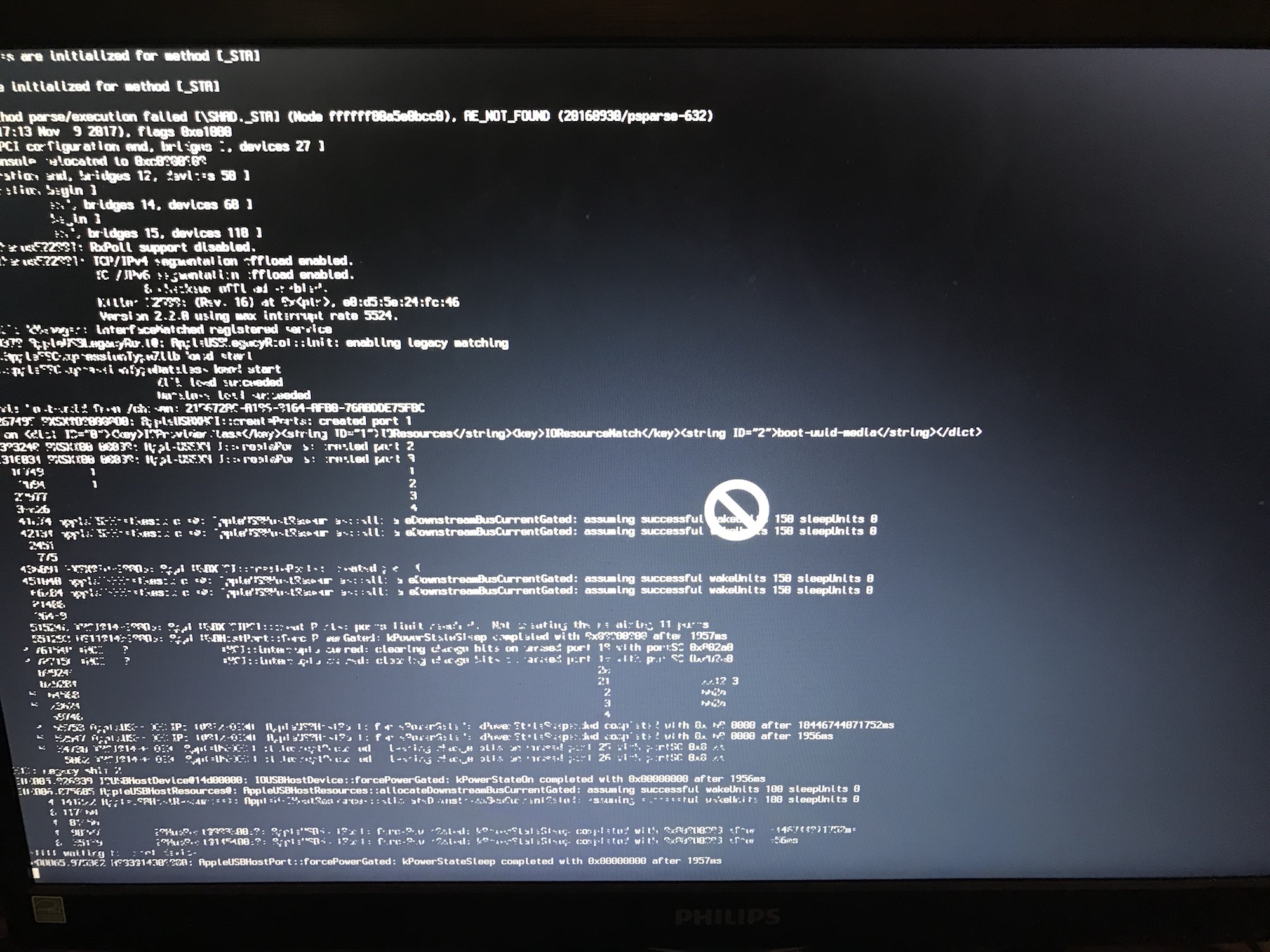

Delecta Posted April 16, 2018 Share Posted April 16, 2018 (edited) Hi ! I started a new build today with this parts : Mobo : Gigabyte x299 Gaming 7 CPU : Intel i9-7980XE Extreme Edition (2,6 GHz) RAM : 64 Gb RAM Corsair Vengeance LED 3200Mhz GPU : AMD Vega FE 16Gb I tried to install MacOS High Sierra on a SSD Samsung Evo 1Tb and sometimes I've got "Does printf work ?' and sometimes I've got a ban sign after the lines I atteched you below. I tried to minimise my kext in my clover folder because one time the boot stuck at the IntelMausiEthernet kext. Thank you if you got advices. EFI.zip Edited April 16, 2018 by Delecta Link to comment https://www.insanelymac.com/forum/topic/333883-i9-7980xe-install-issue/ Share on other sites More sharing options...

Delecta Posted April 16, 2018 Author Share Posted April 16, 2018 Got the ban sign after a line of USB 3 port loading with the AptioMemoryFix.@Allan I use the only method I know which is I try to install MacOS via clover on my usb stick who's got a 10.13.0 install. Thank you Link to comment https://www.insanelymac.com/forum/topic/333883-i9-7980xe-install-issue/#findComment-2610327 Share on other sites More sharing options...
Guest Posted April 16, 2018 Share Posted April 16, 2018 (edited) you have to change your USB port (ban sign and screen corruption is this problem) or add a correct usb patch limit for your osx version.. for this I was asking..which version? Edited April 16, 2018 by Guest Link to comment https://www.insanelymac.com/forum/topic/333883-i9-7980xe-install-issue/#findComment-2610335 Share on other sites More sharing options...
Allan Posted April 16, 2018 Share Posted April 16, 2018 And try always use a USB 2.0 port. Link to comment https://www.insanelymac.com/forum/topic/333883-i9-7980xe-install-issue/#findComment-2610338 Share on other sites More sharing options...

Delecta Posted April 16, 2018 Author Share Posted April 16, 2018 Ok it works with the USB 2.0 front ports or I test the USB 2 mobo port. Whatever, the install is going but it was like very "laggy" in the install screen. I will let you know the following. Thank you Link to comment https://www.insanelymac.com/forum/topic/333883-i9-7980xe-install-issue/#findComment-2610349 Share on other sites More sharing options...
