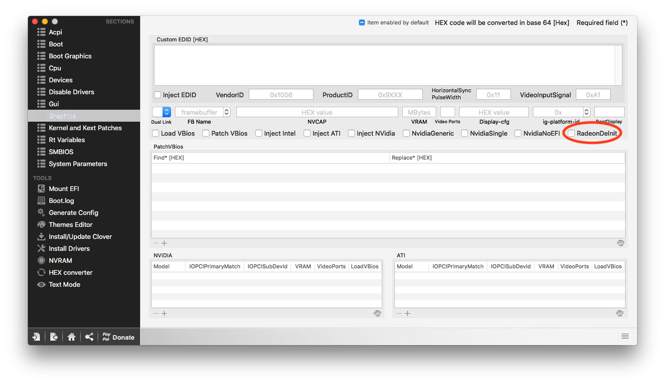

AceMcLoven Posted April 26, 2018 Author Share Posted April 26, 2018 6 minutes ago, ammoune78 said: Can you try to add wathevergreen kext and untick LoadVBios from Graphics in the config, also you can add RadeonDeInit! How do I add RadeonDelnit? I did try WhateverGreen without LoadVbios checked and it's not working for me. Link to comment https://www.insanelymac.com/forum/topic/333775-xfx-r9-280x-black-editionz87x-ud7-th-with-i7-4770k-cpu-sierra-freeze-and-reboot/page/3/#findComment-2611588 Share on other sites More sharing options...
Cyberdevs Posted April 26, 2018 Share Posted April 26, 2018 You can use clover configurator to open the config.plist and under the graphic section there's a RadeonDeInit flag or open the config.plist and add the following code to under the Graphics section: <dict> <key>RadeonDeInit</key> <true/> </dict> You might need to update your clover to the latest version because RadeonDeInit won't work in clover revisions prior to 4296 if I remember correctly. 1 Link to comment https://www.insanelymac.com/forum/topic/333775-xfx-r9-280x-black-editionz87x-ud7-th-with-i7-4770k-cpu-sierra-freeze-and-reboot/page/3/#findComment-2611591 Share on other sites More sharing options...

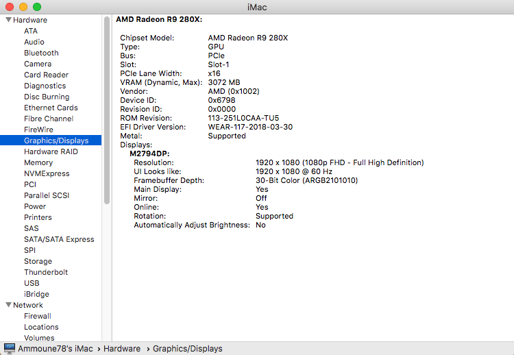

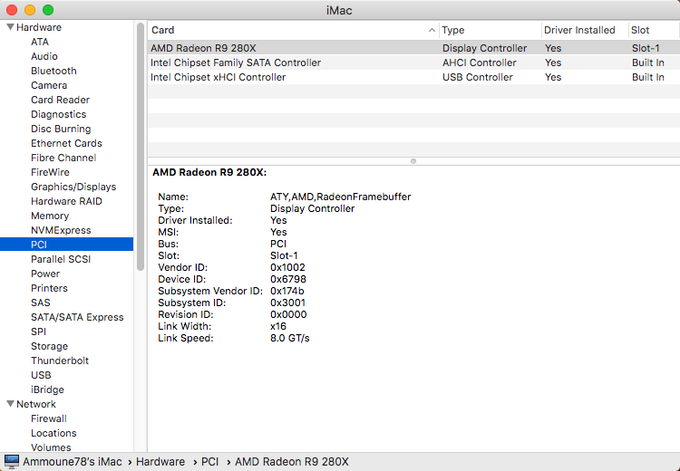

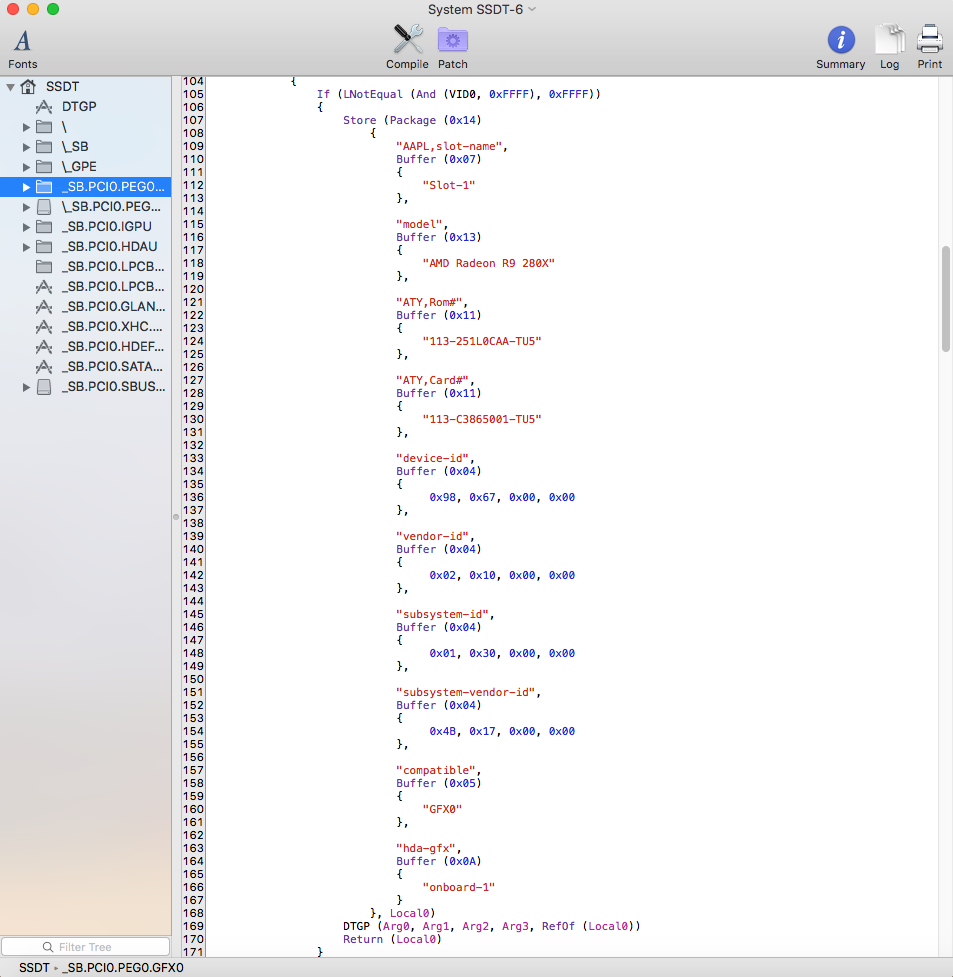

ammoune78 Posted April 26, 2018 Share Posted April 26, 2018 (edited) 6 hours ago, Cyberdevs said: @AceMcLoven R9 270X and R9 280X don't need anything to work in a Hackintosh, I have a MSI R9 270X and it works 100% OOB without any injection or selecting the framebuffer if I set InjectATI=True or select a framebuffer Futomaki it will go to black screen. Don't inject anything in the Graphics section. You don't even need the RadeonDeInit either, just make sure that the CSM is disabled in BIOS/UEFI. I've been using HDMI and DP ports and both work ok. It worked hhh, but it's so slow, i mean booting up to login screen, it take too much time, going from losing screen to the Finder takes too much time, loading the things and settings take too much time and also clicking on app it will to. So here are screenshots from About this Mac and SSDT patch working with: Looking here, from the Name it says ATY,AMD,RadeonFramebuffer hhhh, is it the defaults one or because of the unknown framebuffer that have to be used for? Edited April 26, 2018 by ammoune78 Link to comment https://www.insanelymac.com/forum/topic/333775-xfx-r9-280x-black-editionz87x-ud7-th-with-i7-4770k-cpu-sierra-freeze-and-reboot/page/3/#findComment-2611639 Share on other sites More sharing options...
