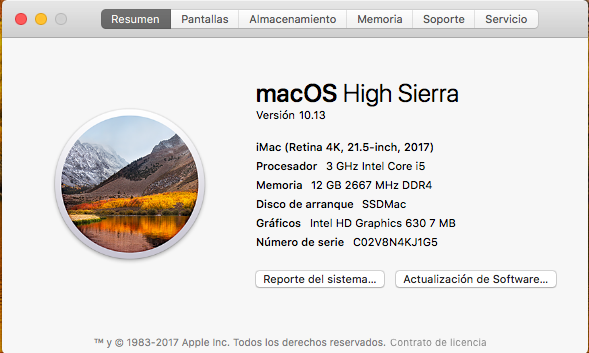

deejaystage Posted January 11, 2018 Share Posted January 11, 2018 Hi guys! I have not acceleration in my IGPU graphic card, the system says: 7mb vram and everything goes very slowly, neither can to change resolution. I used lilu.kext and inteligraphicsfixup.kext but nothing happens. I tried a lot of things but nothing changes. Tried changing my Fake ID Intel: 0x59128086 and Inject Intel ig-platform: 0x59120000 but nothing happens. I`ve got this issue from 20 days ago and I don´t find the solution. My specs: Desktop Asus H110M-D mobo i3 7100 Kaby Lake Intel HD 630 IGPU 4gb ddr4 ram 500GB HDD WD High Sierra 10.13 OSX Any suggestion will be very appreciated!! Thanks in advance 1 Quote Link to comment https://www.insanelymac.com/forum/topic/331516-intel-hd-630-shows-7mb-vram-no-acceleration-qe_ci-kaby-lake-high-sierra/ Share on other sites More sharing options...

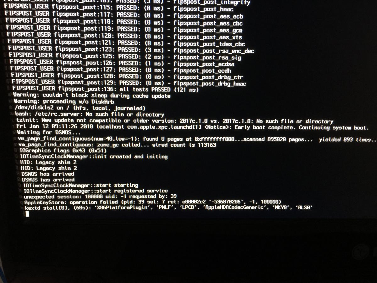

MaLd0n Posted January 12, 2018 Share Posted January 12, 2018 Here you got it!! Thanks!! first -Go to Library/Extensions and System/Library/Extensions and remove: VoodooTSCSync.kext AppleHDADisabler.kext VoodooHDA.kext RealtekRTL8111.kext Shiki.kext USBInjectAll.kext -After remove all kexts above, run kext utility one time, just run Kext Utility.app.zip -Update Clover bootloader Clover_v2.4k_r4372.pkg.zip -Replace full Clover folder CLOVER.zip -Reboot Quote Link to comment https://www.insanelymac.com/forum/topic/331516-intel-hd-630-shows-7mb-vram-no-acceleration-qe_ci-kaby-lake-high-sierra/#findComment-2567854 Share on other sites More sharing options...
deejaystage Posted January 12, 2018 Author Share Posted January 12, 2018 MaLdOn, my system don't want to boot. It's stucked in that screen. Only boot in safe mode 1 Quote Link to comment https://www.insanelymac.com/forum/topic/331516-intel-hd-630-shows-7mb-vram-no-acceleration-qe_ci-kaby-lake-high-sierra/#findComment-2567965 Share on other sites More sharing options...
MaLd0n Posted January 12, 2018 Share Posted January 12, 2018 boot in safe mode, move all kext in clover/kext/other to Library/Extensions and run kext utility the problem i think is inject kext Quote Link to comment https://www.insanelymac.com/forum/topic/331516-intel-hd-630-shows-7mb-vram-no-acceleration-qe_ci-kaby-lake-high-sierra/#findComment-2568056 Share on other sites More sharing options...
deejaystage Posted January 12, 2018 Author Share Posted January 12, 2018 boot in safe mode, move all kext in clover/kext/other to Library/Extensions and run kext utility the problem i think is inject kext System can´t to boot... I think I have to make a fresh instalation again... Quote Link to comment https://www.insanelymac.com/forum/topic/331516-intel-hd-630-shows-7mb-vram-no-acceleration-qe_ci-kaby-lake-high-sierra/#findComment-2568259 Share on other sites More sharing options...

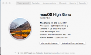

deejaystage Posted January 13, 2018 Author Share Posted January 13, 2018 Replace your clover folder with this one attached, before you forget to make a backup of your current clover folder. No working, now my system show 3mb vram Quote Link to comment https://www.insanelymac.com/forum/topic/331516-intel-hd-630-shows-7mb-vram-no-acceleration-qe_ci-kaby-lake-high-sierra/#findComment-2568485 Share on other sites More sharing options...

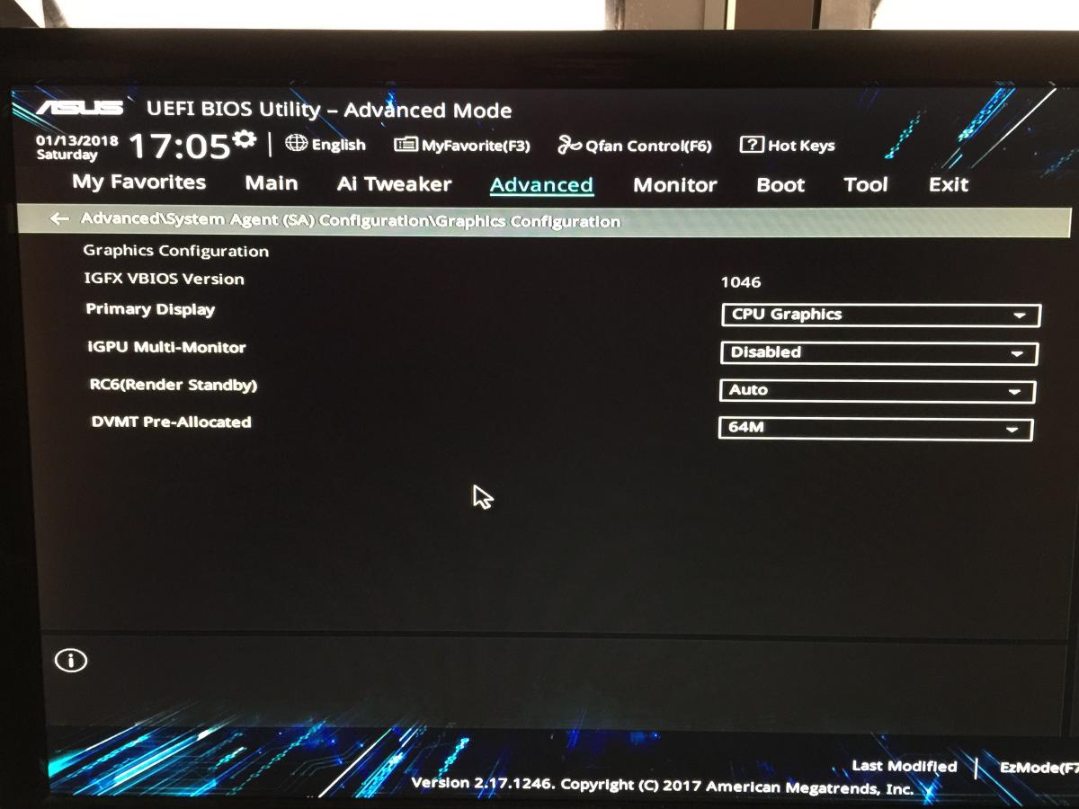

Gigamaxx Posted January 13, 2018 Share Posted January 13, 2018 Bios settings for IGPU/IGFX minimum memory allocation 64mb? Quote Link to comment https://www.insanelymac.com/forum/topic/331516-intel-hd-630-shows-7mb-vram-no-acceleration-qe_ci-kaby-lake-high-sierra/#findComment-2568625 Share on other sites More sharing options...
deejaystage Posted January 13, 2018 Author Share Posted January 13, 2018 Bios settings for IGPU/IGFX minimum memory allocation 64mb? Yes I think is ok Quote Link to comment https://www.insanelymac.com/forum/topic/331516-intel-hd-630-shows-7mb-vram-no-acceleration-qe_ci-kaby-lake-high-sierra/#findComment-2568664 Share on other sites More sharing options...
Gigamaxx Posted January 13, 2018 Share Posted January 13, 2018 Yes I think is ok Eneble multi monitor. Quote Link to comment https://www.insanelymac.com/forum/topic/331516-intel-hd-630-shows-7mb-vram-no-acceleration-qe_ci-kaby-lake-high-sierra/#findComment-2568665 Share on other sites More sharing options...
