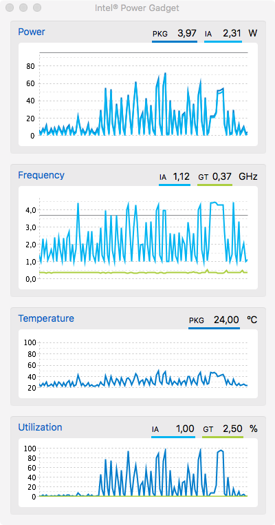

Jolly Posted January 13, 2018 Share Posted January 13, 2018 Se hai overclockato a 4800 si. Quello che ti ho passato è per la cpu a valori stock 1 Link to comment https://www.insanelymac.com/forum/topic/331469-installazione-high-sierra-su-z370-hd3p-e-cpu-i7-8700k/page/2/#findComment-2568479 Share on other sites More sharing options...
taetae Posted January 13, 2018 Author Share Posted January 13, 2018 ecco Link to comment https://www.insanelymac.com/forum/topic/331469-installazione-high-sierra-su-z370-hd3p-e-cpu-i7-8700k/page/2/#findComment-2568484 Share on other sites More sharing options...
gengik84 Posted January 13, 2018 Share Posted January 13, 2018 Ora ci siamo...puoi vedere anche tu la differenza rispetto la prima foto che hai postato... Link to comment https://www.insanelymac.com/forum/topic/331469-installazione-high-sierra-su-z370-hd3p-e-cpu-i7-8700k/page/2/#findComment-2568493 Share on other sites More sharing options...

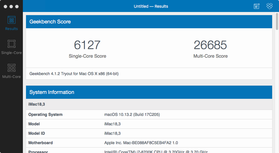

taetae Posted January 13, 2018 Author Share Posted January 13, 2018 si si grazie ragazzi un'altra domanda .... se faccio overclok sulla cpu da bios cmq dovro fare il passaggio dall'ssdt?? se installo una scheda video esterna tipo la nvidia 730 gt devo disabilitare e togliere tutte le diciture della scheda intel? Link to comment https://www.insanelymac.com/forum/topic/331469-installazione-high-sierra-su-z370-hd3p-e-cpu-i7-8700k/page/2/#findComment-2568499 Share on other sites More sharing options...
Jolly Posted January 13, 2018 Share Posted January 13, 2018 Mi aspettavo qualcosina in più da geekbench però ora il grafico soddisfa le specifiche. Comunque apri il config con Clover configurator e nella sezione ACPI togli la spunta a Plugin Type nella sezione Generate Option Link to comment https://www.insanelymac.com/forum/topic/331469-installazione-high-sierra-su-z370-hd3p-e-cpu-i7-8700k/page/2/#findComment-2568502 Share on other sites More sharing options...

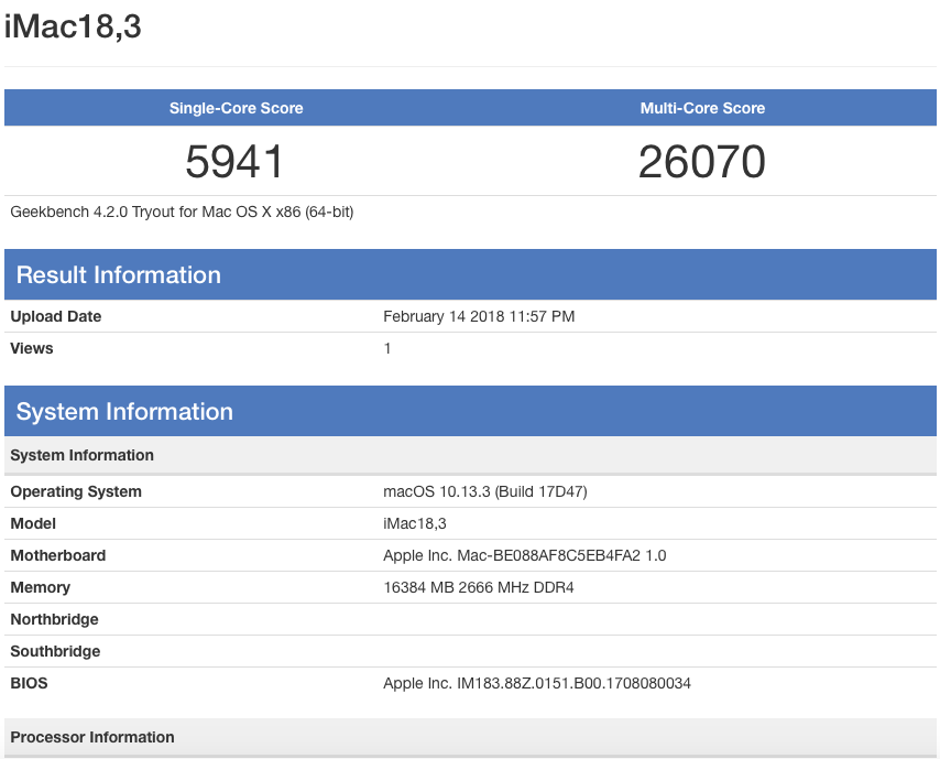

Dread One Posted February 14, 2018 Share Posted February 14, 2018 Ciao, ho creato un hackintosh con la stessa configurazione HW e High Sierra, ogni tanto all'avvio il sistema crasha dopo il logon, schermo nero e reboot, il successivo riavvio non mostra invece anomalie, temo sia la scheda video, posto i risultati dell'hack come da indicazioni "Cose da postare quando si chiede aiuto" - vedete problemi o migliorie apportabili? La gpu è quella integrata nella mobo. Grazie 1k Alessandro Archivio.zip Link to comment https://www.insanelymac.com/forum/topic/331469-installazione-high-sierra-su-z370-hd3p-e-cpu-i7-8700k/page/2/#findComment-2591764 Share on other sites More sharing options...
MaLd0n Posted February 14, 2018 Share Posted February 14, 2018 Ciao, ho creato un hackintosh con la stessa configurazione HW e High Sierra, ogni tanto all'avvio il sistema crasha dopo il logon, schermo nero e reboot, il successivo riavvio non mostra invece anomalie, temo sia la scheda video, posto i risultati dell'hack come da indicazioni "Cose da postare quando si chiede aiuto" - vedete problemi o migliorie apportabili? La gpu è quella integrata nella mobo. Grazie 1k Alessandro Non usare DSDT da un altro mobo Link to comment https://www.insanelymac.com/forum/topic/331469-installazione-high-sierra-su-z370-hd3p-e-cpu-i7-8700k/page/2/#findComment-2591963 Share on other sites More sharing options...
Dread One Posted February 14, 2018 Share Posted February 14, 2018 Ciao, grazie per l'informazione, è vero, usavo il file sbagliato perché non costruito sulla mia mobo. Ho ripristinato il dsdt.aml premendo F4 sulla GUI di Clover. Ho cancellato quello omonimo che avevo nella cartella patched e mantenuto le patch sul dsdt configurate in Clover, basta questo vero? Ci sono altre cose da modificare per renderlo il più stabile possibile? Nella sezione di Clover "Kernel and Kext Patches" trovo 3 chiavi relative alle ACL1220, credo a seguito dell'installazione dei drivers della scheda audio (allegate), sono necessarie?Ho creato il file ssdt e copiato nella cartella patched. Inoltre MACIAsl mi restituisce l'errore allegato, è dovuto alla versione di OS ? Vedo l'ultimo update a gennaio 2017.. Nonostante queste modifiche ho ancora il problema del crash al logon, dopo 5 reboot il sistema si stabilizza, quali log posso controllare? Allego nuovo geekbench. Grazie1k Non usare DSDT da un altro mobo HackInfo_Report.zip config.plist.zip Link to comment https://www.insanelymac.com/forum/topic/331469-installazione-high-sierra-su-z370-hd3p-e-cpu-i7-8700k/page/2/#findComment-2592122 Share on other sites More sharing options...

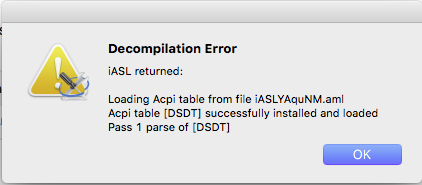

foskvs Posted February 15, 2018 Share Posted February 15, 2018 Che versione di MaciASL stai usando? A me lo apre senza problemi. Quelle patch non dovrebbero essere necessarie. Per i crash, sarebbe interessante se riuscissi a caricare dei log di errore. Quelli che ti compaiono al riavvio o il system log. Link to comment https://www.insanelymac.com/forum/topic/331469-installazione-high-sierra-su-z370-hd3p-e-cpu-i7-8700k/page/2/#findComment-2592467 Share on other sites More sharing options...
Dread One Posted February 15, 2018 Share Posted February 15, 2018 Questa: https://bitbucket.org/RehabMan/os-x-maciasl-patchmatic/downloads/RehabMan-MaciASL-2017-0117.zip A quali patches ti riferisci?Dove vengono salvati i log che hai menzionato?Grazie Link to comment https://www.insanelymac.com/forum/topic/331469-installazione-high-sierra-su-z370-hd3p-e-cpu-i7-8700k/page/2/#findComment-2592484 Share on other sites More sharing options...
foskvs Posted February 15, 2018 Share Posted February 15, 2018 Questa: https://bitbucket.org/RehabMan/os-x-maciasl-patchmatic/downloads/RehabMan-MaciASL-2017-0117.zip È giusta. Prova ad aprirlo di nuovo. A me apre normalmente il DSDT che hai in origin. A quali patches ti riferisci? A quelle per AppleHDA Dove vengono salvati i log che hai menzionato? Da terminale cd ~/Desktop log show --predicate "processID == 0" --start 2018-02-15 --debug > log_di_sistema.txt Link to comment https://www.insanelymac.com/forum/topic/331469-installazione-high-sierra-su-z370-hd3p-e-cpu-i7-8700k/page/2/#findComment-2592509 Share on other sites More sharing options...
