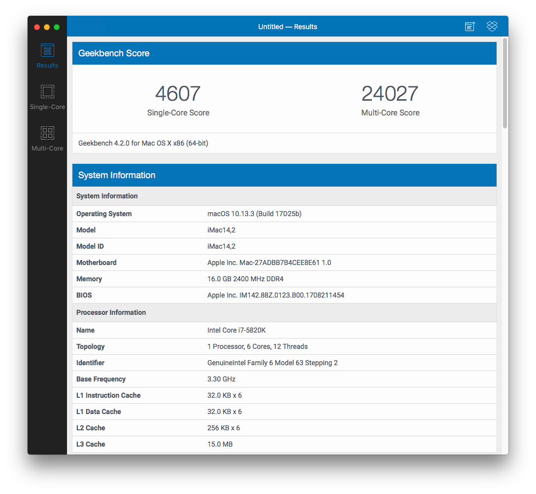

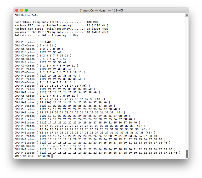

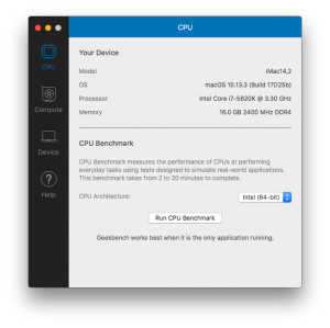

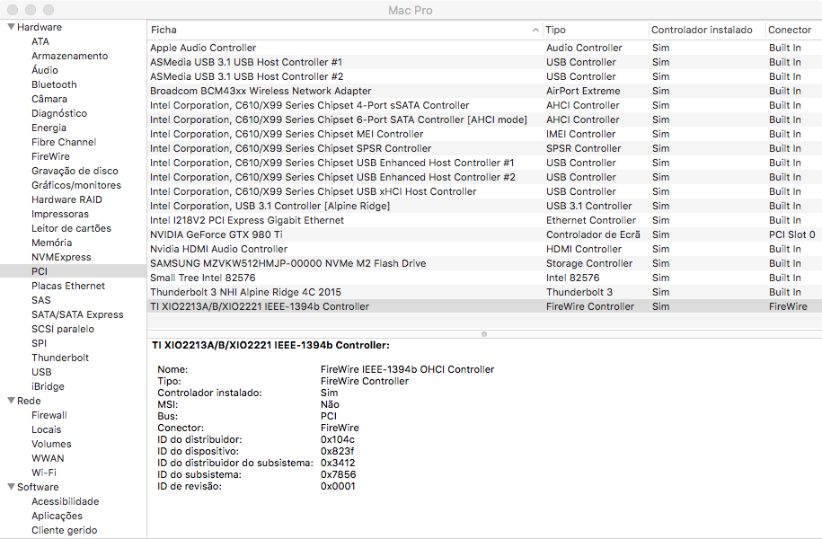

MaLd0n Posted December 26, 2017 Share Posted December 26, 2017 Now have a Olarila app, just download app and clover folder for your Chipset! https://olarila.com/forum/viewtopic.php?f=81&t=6771 Install MacOS with Olarila Image, Step by Step, Install and Post Install https://olarila.com/forum/viewtopic.php?f=50&t=8685 --Install Follow my tutorial and use my Clover folder http://www.insanelymac.com/forum/topic/323052-guide-sierra-high-sierra-on-intel-5-6-7-8-and-9-chipset-series-nehalem-sandybridge-ivybridge-haswell-broadwell/ CLOVER Install.zip --Post Install --Install Clover bootloader and replace with my folder CLOVER Post Install.zip Bingo! Now you need a fine tune! DSDT time! If you need edited DSDT... -Post your full Clover folder with original tables in Origin folder(Extract with F4 in Clover boot screen) -Post Ioreg, extract with Ioreg Explorer IORegistryExplorer.app.zip -Run it, post files generate in your desktop RunMe.app -DSDT bios F23 My DSDT DSDT.MaLd0n GA X99-UD3P.zip -Patches -FIX ERRORS AND WARNINGS -HPET -SATA -sSATA -DMAC -SLPB -DARWIN -LPC -XHCI -EHCI -PLUGIN TYPE -ALZA to HDEF -HDEF -RTC -IRQs -SBUS -BLC0 -BUS1 -MCHC -ALS0 -IMEI -SHUTDOWN -LAN -SPSR -EC -PNLF -HDMI e.g -Clover https://sourceforge.net/projects/cloverefiboot/files/Installer/ -FakeSMC https://bitbucket.org/RehabMan/os-x-fakesmc-kozlek -Audio https://github.com/vit9696/AppleALC -USB https://bitbucket.org/RehabMan/os-x-usb-inject-all/downloads -LAN https://github.com/Mieze/IntelMausiEthernet -Credits and thanks to the old and new people in the community who developed patches, kexts and bootloaders! Apple, Slice, Kabyl, usr-sse2, jadran, Blackosx, dmazar, STLVNUB, pcj, apianti, JrCs, pene, FrodoKenny, skoczy, ycr.ru, Oscar09, xsmile, SoThOr, RehabMan, Download-Fritz, Zenit432, cecekpawon, Intel, Apple, Oracle, Chameleon Team, crazybirdy, Mieze, Mirone, Oldnapalm, netkas, Elconiglio, artut-pt, ErmaC, Pavo, Toleda, Master Chief and family, bcc9, The King, PMheart, Sherlocks, Micky1979, vit9696, vandroiy2013, Voodoo Team, Pike R. Alpha, lvs1974, Austere.J, CVad, nmano and many, many, many others! We're all here to have fun and learn from each other! 6 Link to comment Share on other sites More sharing options...
