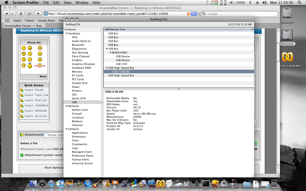

bubbageek75 Posted October 27, 2008 Share Posted October 27, 2008 Posted this in another forum the other day and haven't heard anything. Hoping someone here can help. A little background first: System: iATKOS v4i (10.5.4) on Acer Aspire 4720z laptop I am dual booting with Vista with no problems. I have the sound working and power management is working correctly. The built-in Ethernet (Broadcom 57xx) does not work under OSX and neither does the built-in Atheros 5007EG (PCI Express mini card). The wireless is what brings me to my question. I just purchased a MacSense WUA-880 wireless usb adapter for Mac/PC. It works with no issues on my Hackintosh laptop. It is an Atheros 5007UG chipset. So my question is this: Is there any way to modify the driver for the USB adapter to have it see and initialize the pci-e 5007EG? Any help would be appreciated. Thanks. Link to comment https://www.insanelymac.com/forum/topic/33089-atheros-ar5005g/page/11/#findComment-945715 Share on other sites More sharing options...

mcsmart Posted November 5, 2008 Share Posted November 5, 2008 Are you sure your USB Wireless Stick has an Atheros Chipset? In the screenshot it says its a ZyDAS... Link to comment https://www.insanelymac.com/forum/topic/33089-atheros-ar5005g/page/11/#findComment-955963 Share on other sites More sharing options...
