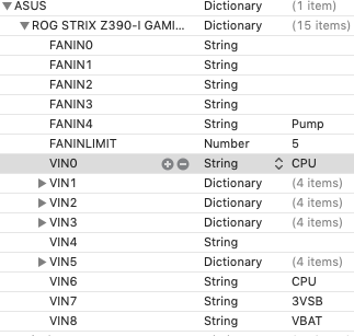

Modmike Posted April 2, 2019 Share Posted April 2, 2019 (edited) I created a ROG STRIX Z390-I GAMING node, modified the labels and had to change the FANINLIMIT to 5 to see the pump RPM. I only have 1 pump and the fans are on a single speed hub. Everything shows up in HWMonitor SMC2 as laid out and it no longer crashes. Config question: What are the VIN1 to VIN8 entries in the plist for, core readings? Do I need to put the fans to 7 and add FANIN5 and FANIN6 to access the onboard temperature probe connector? How do I remove a category, like Battery from HWMonitorSMC2 Is there a way to customize the labels in HWMonitorSMC2? What is the fan slider size for? Tuning RPM? What if you have different size fans? Is there a config Guide for HWMonitorSMC2 you can point me to? The IGPU seems like it's not working. Are these readings ok? Compiling: I compiled the latest version of HWMonitorSMC2 using Xcode and that went fine. I also built FakeSMC, W386x, and IntelCPUMonitor but had a few issues: I got the error "unable to find sdk 'macosx10.11'". and had to change all the base SDKs to macOS to build. Is that ok? Everything ran but I had the 16366 fan rpm issue with my built versions. Is that because you didn't finish making changes? It's basically perfect all I need is to learn how to configure it. You just made the whole Z370 and Z390 community very happy! Thank you very much! Edited April 3, 2019 by Modmike 1 Link to comment https://www.insanelymac.com/forum/topic/330640-winbondnuvoton-monitor/page/6/#findComment-2668894 Share on other sites More sharing options...

vector sigma Posted April 3, 2019 Share Posted April 3, 2019 (edited) On 4/2/2019 at 9:43 PM, Modmike said: Config question: What are the VIN1 to VIN8 entries in the plist for, core readings? Do I need to put the fans to 7 and add FANIN5 and FANIN6 to access the onboard temperature probe connector? How do I remove a category, like Battery from HWMonitorSMC2 Is there a way to customize the labels in HWMonitorSMC2? What is the fan slider size for? Tuning RPM? What if you have different size fans? Is there a config Guide for HWMonitorSMC2 you can point me to? The IGPU seems like it's not working. Are these readings ok? voltage register at index 1 to 9 for example. Each motherboard can assign, for the same chip, different sensors. The same chip has always the same ability in all motherboards.. but different motherboards have different soldered capacitors, resistors (and so on) that make the input/output to have different calculations. So the formula to get voltages it is vendor and product specific. From what I now, and it is really an NTC6796D, it has a max of six fans registers. My code set the max fans number to be never major of this, e.g. even if you set FANINLIMIT = 15.... the max will always be 6. FANIN0 ~ FANIN5 if set, serves only to show a name you decide to give to it and to be shown. It is just the name for the index of the fan register where different mobos can have different fan type (e.g. fan at index 0 i.e. FANIN0 can be the CPU fan...or be something else fan) it is just doing it automatically. Ensure to not show empty groups in the preferences and anyway there is a checkbox you can deactivate to never show that group of sensors. No, this depend what you wrote in the kext, otherwise you will see "Fan x speed" if left empty. It is only the time polling... as should be already written just above. What the hell, it is self explanatory, just take a look in the preferences. Anyway the app just read SMC keys published by a real SMC device... or in this cases by FakeSMC and its plugins or by polling the drivers you have installed. Sorry not mine or the app fault. It is just the vanilla driver that publish 0 for this entry in the ioreg. Only apple can fix its own buggy driver(s). OT ..then during the week really not able to do more as lately I have job and jobs to do that makes me boring turning on a pc at home after dinner. Anyway on the next version I'll filter good and bad values to be shown, in a way, for example, that a frequency or a fan rpm of 0 will never show up. Edited April 3, 2019 by vector sigma Link to comment https://www.insanelymac.com/forum/topic/330640-winbondnuvoton-monitor/page/6/#findComment-2669003 Share on other sites More sharing options...

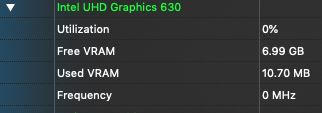

vector sigma Posted April 3, 2019 Share Posted April 3, 2019 23 hours ago, Modmike said: With a discrete GPU active can be normal to see the IGPU using zero resources.... until you have to decode videos using the Intel Quick Sync tech... and see those values becoming greater then 0. Sorry for the OT as this is not the right Topic Link to comment https://www.insanelymac.com/forum/topic/330640-winbondnuvoton-monitor/page/6/#findComment-2669004 Share on other sites More sharing options...
