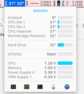

nomadturk Posted February 1, 2016 Share Posted February 1, 2016 Now Hwmonitor can read CPU Heatsink, motherboard temp and Voltages. But not the fan: And the System log result: 01/02/16 16:41:49.196 com.apple.kextd[45]: kext-dev-mode allowing invalid signature -67062 0xFFFFFFFFFFFEFA0A for kext "/Library/Extensions/W836x.kext" 01/02/16 16:41:49.306 com.apple.kextd[45]: kext signature failure override allowing invalid signature -67062 0xFFFFFFFFFFFEFA0A for kext "/Library/Extensions/W836x.kext" 01/02/16 16:41:49.379 com.apple.kextd[45]: kext-dev-mode allowing invalid signature -67062 0xFFFFFFFFFFFEFA0A for kext "/Library/Extensions/W836x.kext" 01/02/16 16:41:49.430 com.apple.kextd[45]: kext signature failure override allowing invalid signature -67062 0xFFFFFFFFFFFEFA0A for kext "/Library/Extensions/W836x.kext" 01/02/16 16:41:49.000 kernel[0]: W836x: found NCT6793D 01/02/16 16:41:49.000 kernel[0]: W836x: mother vendor=ASUSTeK COMPUTER INC. product=Z170-DELUXE 01/02/16 16:41:49.000 kernel[0]: W836x: [Warning] set default configuration Link to comment https://www.insanelymac.com/forum/topic/330640-winbondnuvoton-monitor/page/2/#findComment-2212382 Share on other sites More sharing options...
Slice Posted February 1, 2016 Author Share Posted February 1, 2016 Because it is default configuration. Look other ASUS configs and create your own to be more or less like real. Link to comment https://www.insanelymac.com/forum/topic/330640-winbondnuvoton-monitor/page/2/#findComment-2212406 Share on other sites More sharing options...
