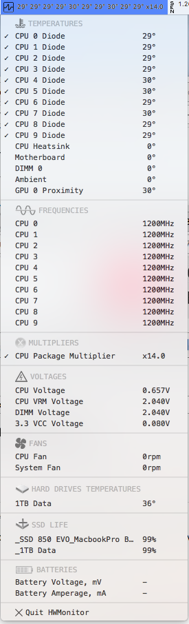

ccozmo Posted November 27, 2017 Share Posted November 27, 2017 Not sure if I upload right version this is newer W836x.kext.zip There is also new kext for Radeon, if someone want to test RadeonMonitor.kext.zip A few more field Link to comment https://www.insanelymac.com/forum/topic/330640-winbondnuvoton-monitor/page/3/#findComment-2540644 Share on other sites More sharing options...

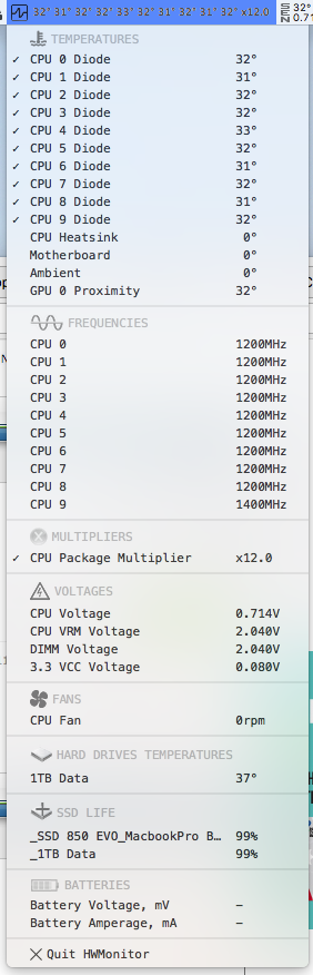

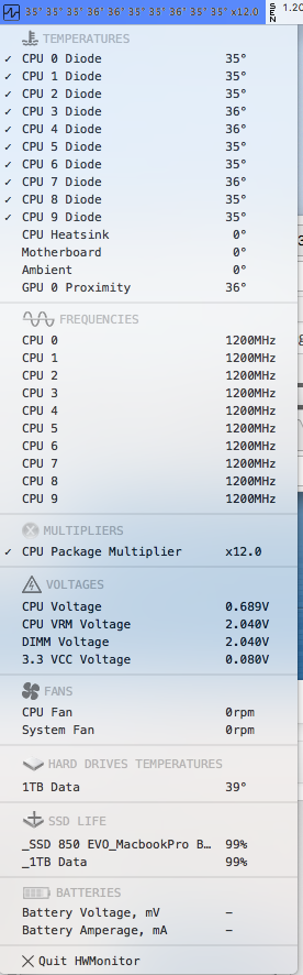

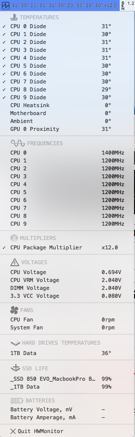

ccozmo Posted December 1, 2017 Share Posted December 1, 2017 I expect better result with this version W836x.kext.zip Still don't see many motherboard values Link to comment https://www.insanelymac.com/forum/topic/330640-winbondnuvoton-monitor/page/3/#findComment-2542295 Share on other sites More sharing options...
Slice Posted December 1, 2017 Author Share Posted December 1, 2017 Still don't see many motherboard values Screen Shot 2017-12-01 at 9.47.26 AM.png Any messages in system.log? Or in console? Link to comment https://www.insanelymac.com/forum/topic/330640-winbondnuvoton-monitor/page/3/#findComment-2542339 Share on other sites More sharing options...

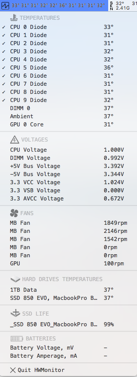

ccozmo Posted December 11, 2017 Share Posted December 11, 2017 This is the HW sensor output from your bundle and then the one from the other kext I am using. Yours is missing quite a few fields and also the Motherboard, ambient temps & fan speed Link to comment https://www.insanelymac.com/forum/topic/330640-winbondnuvoton-monitor/page/3/#findComment-2548868 Share on other sites More sharing options...
