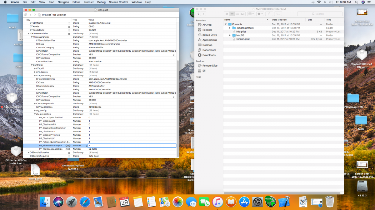

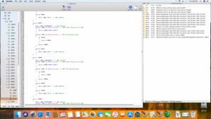

ydeng Posted December 29, 2017 Share Posted December 29, 2017 this is a fix for fan speeds but it seems to be limiting frequency. Maybe someone can find a path based on this to fix to the issue. If you change this value from 0 to 1 it fixes the fan speed but performance takes a hit. Screen Shot 2017-12-29 at 8.36.54 AM.png Hi MaLdOn and or Pavo, I tried this ssdt for my Ryzen 7 1700 but it crashes during boot. If either of you have time could you look at my files attached. Ive tried several DSDT and SSDT fixes for Ryzen but the guides are generally written for Intel CPUs. The terminologies differ when I try to edit DSDT or SSDt files. The edits assign new names or values but they don't match what is expected from Intel systems. I have also noticed that Ryzen systems have lower graphics performance than Intel systems in OSX and I think it may be because of the PCI slot running at i386 (32bit) instead of x64 speeds. For Nvidia cards its even worse and I recently read that Nvidia will be dropping 32 bit support for its web drivers very soon. My IOPlane shows the assigned graphics PCIslot with i386 and Power setting at 0x3 max. Ryzen support is getting better but solving the graphics issue seems to be elusive especially for Nvidia users all my AMD cards work but have a 10% lower performance than with Intel systems for Nvidia its about 50% loss. Do you think it is possible to assign graphics to the correct PCI slot value @ 64 bit using a DSDT or SSDT? Any help would be much appreciated! P.S.. I currently have my RX 480 in system but will put the Vega 64 back in for any testing. Funny, force power limit functions seem to do nothing. __ZN22Vega10PowerPlayManager15forcePowerLevelEj: // Vega10PowerPlayManager::forcePowerLevel(unsigned int) 0000000000021460 pushq %rbp 0000000000021461 movq %rsp, %rbp 0000000000021464 subq $0x10, %rsp 0000000000021468 movl $0xe00002c7, %eax 000000000002146d movq %rdi, var_8(%rbp) 0000000000021471 movl %esi, var_C(%rbp) 0000000000021474 addq $0x10, %rsp 0000000000021478 popq %rbp 0000000000021479 ret ; endp 000000000002147a nopw (%rax,%rax) ; ================ B E G I N N I N G O F P R O C E D U R E ================ ; Variables: ; var_8: -8 ; var_C: -12 __ZN22Vega10PowerPlayManager12setIdleLimitEj: // Vega10PowerPlayManager::setIdleLimit(unsigned int) 0000000000021480 pushq %rbp 0000000000021481 movq %rsp, %rbp 0000000000021484 subq $0x10, %rsp 0000000000021488 movl $0xe00002c7, %eax 000000000002148d movq %rdi, var_8(%rbp) 0000000000021491 movl %esi, var_C(%rbp) 0000000000021494 addq $0x10, %rsp 0000000000021498 popq %rbp 0000000000021499 ret ; endp 000000000002149a nopw (%rax,%rax) 1 Link to comment https://www.insanelymac.com/forum/topic/330533-inject-fb-name-for-amd-radeon-rx-vega-64/page/2/#findComment-2558318 Share on other sites More sharing options...
MaLd0n Posted December 29, 2017 Share Posted December 29, 2017 this is a fix for fan speeds but it seems to be limiting frequency. Maybe someone can find a path based on this to fix to the issue. If you change this value from 0 to 1 it fixes the fan speed but performance takes a hit. Screen Shot 2017-12-29 at 8.36.54 AM.png Hi MaLdOn and or Pavo, I tried this ssdt for my Ryzen 7 1700 but it crashes during boot. If either of you have time could you look at my files attached. Ive tried several DSDT and SSDT fixes for Ryzen but the guides are generally written for Intel CPUs. The terminologies differ when I try to edit DSDT or SSDt files. The edits assign new names or values but they don't match what is expected from Intel systems. I have also noticed that Ryzen systems have lower graphics performance than Intel systems in OSX and I think it may be because of the PCI slot running at i386 (32bit) instead of x64 speeds. For Nvidia cards its even worse and I recently read that Nvidia will be dropping 32 bit support for its web drivers very soon. My IOPlane shows the assigned graphics PCIslot with i386 and Power setting at 0x3 max. Ryzen support is getting better but solving the graphics issue seems to be elusive especially for Nvidia users all my AMD cards work but have a 10% lower performance than with Intel systems for Nvidia its about 50% loss. Do you think it is possible to assign graphics to the correct PCI slot value @ 64 bit using a DSDT or SSDT? Any help would be much appreciated! P.S.. I currently have my RX 480 in system but will put the Vega 64 back in for any testing. post one ioreg with ioreg explorer IORegistryExplorer.app.zip 1 Link to comment https://www.insanelymac.com/forum/topic/330533-inject-fb-name-for-amd-radeon-rx-vega-64/page/2/#findComment-2558323 Share on other sites More sharing options...

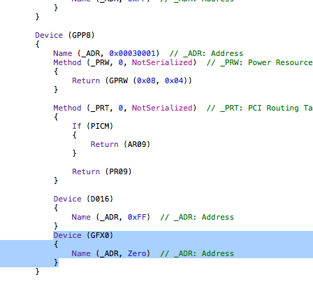

MaLd0n Posted December 29, 2017 Share Posted December 29, 2017 Here it is. DonkeyMac’s iMac IOREG foe MaLdOn.zip I create GFX0 device into Device (GPP8) DSDT.aml.zip Apply _DSM into GFX0 into device label GFX0 parent_label GPP8 insert begin 1 Link to comment https://www.insanelymac.com/forum/topic/330533-inject-fb-name-for-amd-radeon-rx-vega-64/page/2/#findComment-2558332 Share on other sites More sharing options...
Gigamaxx Posted December 29, 2017 Share Posted December 29, 2017 It worked, now reads GFX0 DonkeyMac’s iMac IOREG w:dsdt MaLdOn.zip Send me DonkeyMac’s iMac.zip 1 Link to comment https://www.insanelymac.com/forum/topic/330533-inject-fb-name-for-amd-radeon-rx-vega-64/page/2/#findComment-2558338 Share on other sites More sharing options...

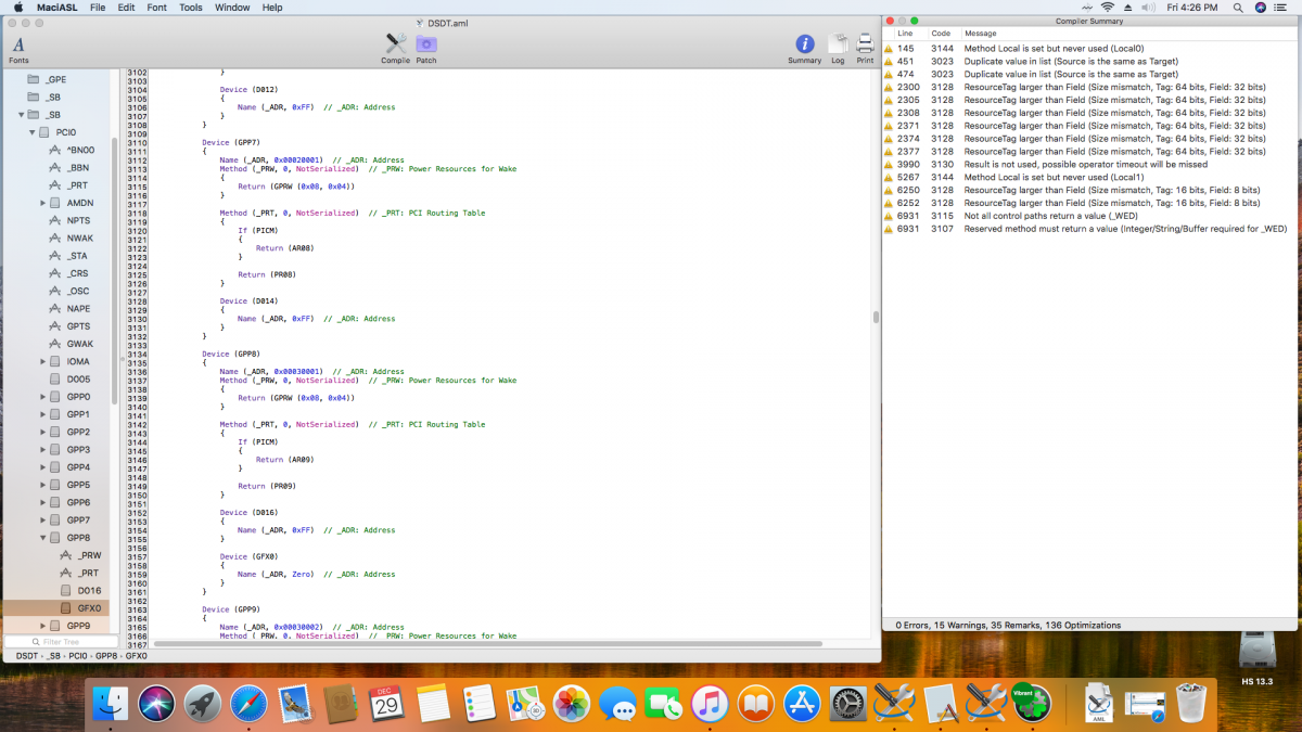

Gigamaxx Posted December 30, 2017 Share Posted December 30, 2017 what u need apply there? I.m not sure, PCIO@2? I can't seem to locate the IOPLane where I saw the i386 listing but running your DSDT through MacAISL app form Rehabman I'm getting this error which seems to be my issue with 32 bit. Link to comment https://www.insanelymac.com/forum/topic/330533-inject-fb-name-for-amd-radeon-rx-vega-64/page/2/#findComment-2558354 Share on other sites More sharing options...
MaLd0n Posted December 30, 2017 Share Posted December 30, 2017 send me patch/ssdt, i apply for u _SB/PCI0/GPP8/GFX0 Use last version and acpi6.1 Link to comment https://www.insanelymac.com/forum/topic/330533-inject-fb-name-for-amd-radeon-rx-vega-64/page/2/#findComment-2558356 Share on other sites More sharing options...
ydeng Posted December 30, 2017 Share Posted December 30, 2017 I.m not sure, PCIO@2? I can't seem to locate the IOPLane where I saw the i386 listing but running your DSDT through MacAISL app form Rehabman I'm getting this error which seems to be my issue with 32 bit. 32 bit.png You might need a newer version of iasl. I had trouble with MacIasl before but no problem with command line tool. https://github.com/RehabMan/Intel-iasl 1 Link to comment https://www.insanelymac.com/forum/topic/330533-inject-fb-name-for-amd-radeon-rx-vega-64/page/2/#findComment-2558362 Share on other sites More sharing options...

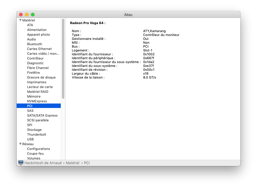

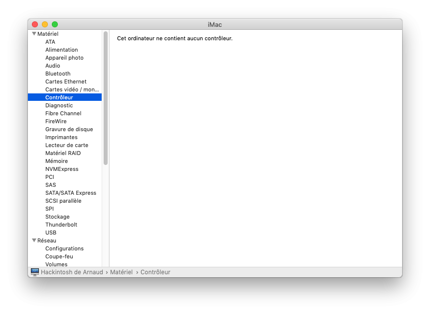

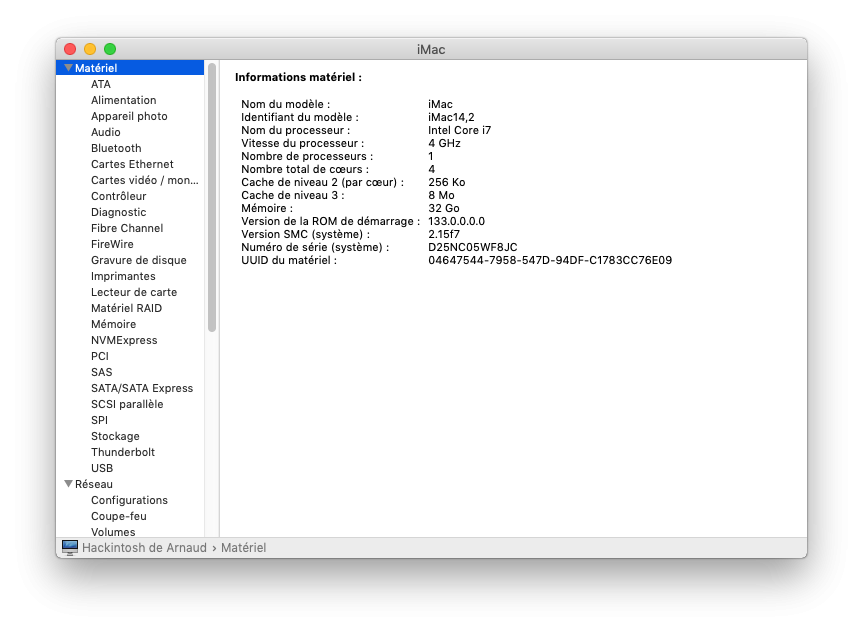

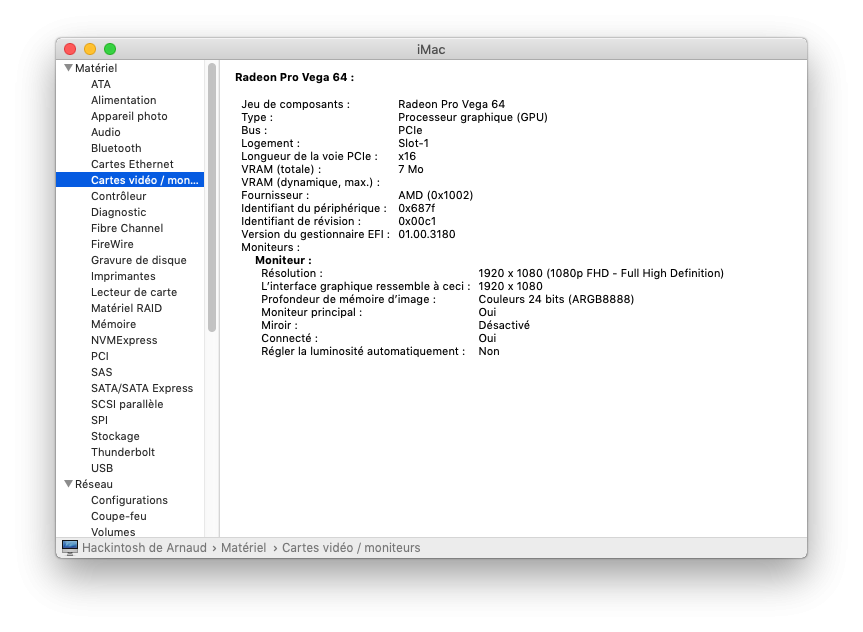

Arnaud Posted January 25, 2019 Share Posted January 25, 2019 Hello Guys, I decided to switch my NVIDIA GTX980ti for an AMD Radeon Vega RX 64 Nitro+. MB : Gigabyte GA-Z97X-UD7-TH CPU : i7 4790K PC1150 8MB Cache 4GHz RAM : 32 Go (4x DDR3 8GB PC 1600 CL11 CORSAIR) Since the CPU is Haswell, I choose iMac 14,2 (closest to my CPU) I installed the system, following the tutorials and finally got the finder injecting your SSDT-Vega64-FBName-Kamarang.aml or SSDT-Vega.aml From there, I cannot have my system working (my Hackintosh is dedicated to CC19 suite). Enclosed the screenshots of the system info, my config.plist Radeon with 7MB VRAM Adobe doesn't recognize the GPU. Well, I don't know what to do ... Can you please help me guys ? Many thanks in advance AG Config.zip Link to comment https://www.insanelymac.com/forum/topic/330533-inject-fb-name-for-amd-radeon-rx-vega-64/page/2/#findComment-2661294 Share on other sites More sharing options...
