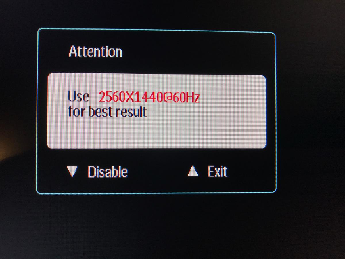

arsradu Posted November 19, 2017 Author Share Posted November 19, 2017 That is normal You sure...? Cause it definitely doesn't react that bad with the GTX 650. It's no flashing actually. Just a pause between first and second stage boot. Which, while it's not really intended, nobody found a solution for it...so yeah, you could say it's normal. Have you seen the video I made about this? Do you know anyone else with the exact same issue? Also, I've got a weird one... Right when I'm booting up the computer, the monitor says "use recommended 2560x1440 resolution" or something similar. This doesn't occur with the GTX 650. And so far, I got no idea why does this happen. I'll take a picture. This occurs with any OS, it's displayed before anything. It could be the cable (DVI) but then again, the same cable is used with the GTX 650 and I don't have this issue. Link to comment Share on other sites More sharing options...
Pavo Posted November 19, 2017 Share Posted November 19, 2017 You sure...? Cause it definitely doesn't react that bad with the GTX 650. It's no flashing actually. Just a pause between first and second stage boot. Which, while it's not really intended, nobody found a solution for it...so yeah, you could say it's normal. Have you seen the video I made about this? Do you know anyone else with the exact same issue? Also, I've got a weird one... Right when I'm booting up the computer, the monitor says "use recommended 2560x1440 resolution" or something similar. This doesn't occur with the GTX 650. And so far, I got no idea why does this happen. I'll take a picture. This occurs with any OS, it's displayed before anything. It could be the cable (DVI) but then again, the same cable is used with the GTX 650 and I don't have this issue. IMG_0034.jpg Yes I am sure, I have used a AMD Radeon 7950, R9 290X, RX 480, it is something that related to AMD cards, its normal 1 Link to comment Share on other sites More sharing options...
arsradu Posted November 19, 2017 Author Share Posted November 19, 2017 Yes I am sure, I have used a AMD Radeon 7950, R9 290X, RX 480, it is something that related to AMD cards, its normal Got it. Thank you! Well, if the RX series is the same...I'll stick with Nvidia for a little while longer. Nonetheless, I learned a LOT these days about ATI cards, and for that I am very grateful to you guys for all the help! Couldn't have done it without you. Thank you very much! 1 Link to comment Share on other sites More sharing options...
