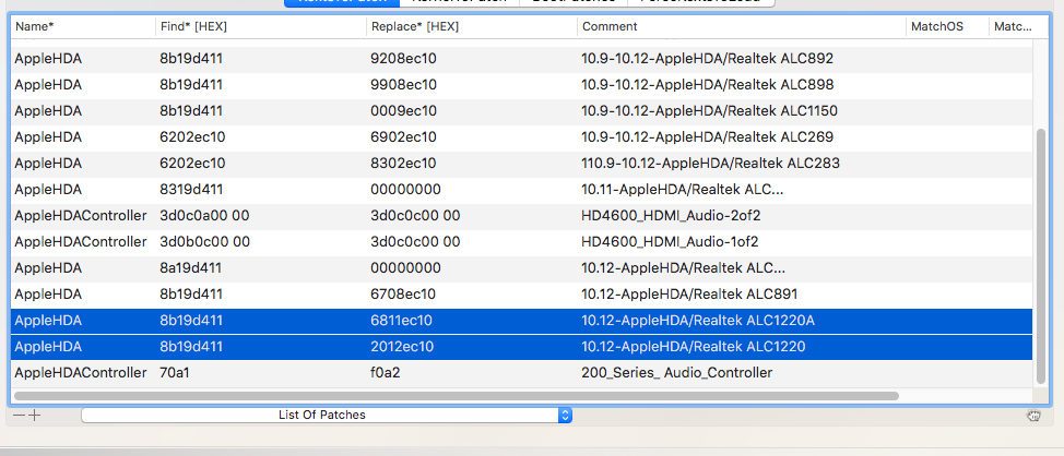

blackbird_n1 Posted October 5, 2017 Share Posted October 5, 2017 Hi guys, Ive been through some Audio turmoil since upgrading to High Sierra with my recent rig i7 7700k @5100mhz on a GA Z270-UD5. F5 BIOS 16gig 3000mhz GTX1070 The awesome audio command script did not give me any audio throughput. The devices were displayed but not working, thus neither iTunes nor Youtube were playing anything. Since the script worked flawless in Sierra I looked through the 130 one for HS and maybe got confused, but it seemed not to patch the Z270-UD5's ALC1220A chip properly looking at the plist I found that it applied the normal ALC1220 patch to my ALC1220A. I tried changing the kext patch in the config file, but this did not gave me the desired result. Thus there seems to be the patching in the AppleHDA affected as well. With the older 124 command script working perfectly in 10.12 I dived into that script (which is a lot shorter than the 130) and changed the limitation of the OS (10.12.x) to 10.13 and ran it. and voila perfect Audio as usual.. I'm gonna attach the changed script, maybe someone with connections can contact Toleda And a screenshot of the kext patch. Hopefully this is useful to some one out there with a ALC1220A who did not go the DSDT route yet. Have an awesome week everyone MODDED 10.13 audio_200_Series_hda-124_v1.0.command.zip Link to comment Share on other sites More sharing options...

Edkroket Posted October 9, 2017 Share Posted October 9, 2017 What about config file? What do you have in these settings? I Have sam board and ran you script but no audio.? Link to comment Share on other sites More sharing options...
umangloria Posted October 10, 2017 Share Posted October 10, 2017 Tried your script.i have z270x ultra gaming.but not worked . Does it requires any special workarounds? Like sip enable etc? Link to comment Share on other sites More sharing options...
