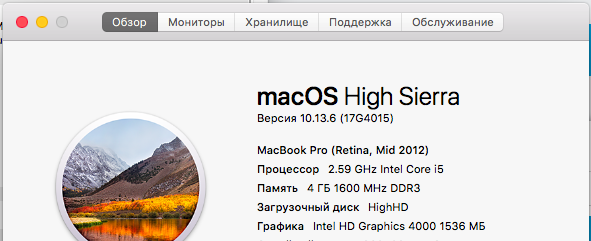

Slice Posted April 25, 2018 Author Share Posted April 25, 2018 My guide was good for ElCapitan where Nvidia 5200M works fine. But now I decided to install HighSierra and I found that Nvidia family Fermi will not work in the OS anyway. So I switched Optimus ON in my BIOS so I have Intel HD4000 as main graphics and switched off Nvidia by ACPI methods. Here it is. ACPI_for HSierra.zip 1 Link to comment https://www.insanelymac.com/forum/topic/327824-dell-latitude-e6430-full-solution/page/2/#findComment-2611400 Share on other sites More sharing options...

Slice Posted May 21, 2018 Author Share Posted May 21, 2018 2 hours ago, chummdoggin said: That was all you needed changed for HSierra? the other things still worked ok? Yes, other things work. Link to comment https://www.insanelymac.com/forum/topic/327824-dell-latitude-e6430-full-solution/page/2/#findComment-2614489 Share on other sites More sharing options...

Momen1/2001 Posted December 5, 2018 Share Posted December 5, 2018 I have dell latitude e6430 with core i5-3320M 4GB Ram intel hd 4000 , nvs5200m i have tried your efi and successfully booted mac os but only with 5mb vram intel hd 4000 i have tried to downgrade my bios from a22 to a03 and upgrade to a12 with no success it still have artifacts , 5mb vram intel hd 4000 with optimus enabled i have tried to disable optimus boot into mac os after i have tried that i found that in about mac shows nvs5200m with 1023mb vram but no brightness control with artifacts and no transparency in dock. i have tried to install nvidia web driver it successfully installed but artifacts increase background not appear with pixels in the top left corner of screen how i can fix it ? I want vram of intel hd 4000 be at least 1024mb and fix nvidia artifacts with black windows Link to comment https://www.insanelymac.com/forum/topic/327824-dell-latitude-e6430-full-solution/page/2/#findComment-2652085 Share on other sites More sharing options...
Slice Posted December 6, 2018 Author Share Posted December 6, 2018 21 hours ago, Momen1/2001 said: I have dell latitude e6430 with core i5-3320M 4GB Ram intel hd 4000 , nvs5200m i have tried your efi and successfully booted mac os but only with 5mb vram intel hd 4000 i have tried to downgrade my bios from a22 to a03 and upgrade to a12 with no success it still have artifacts , 5mb vram intel hd 4000 with optimus enabled i have tried to disable optimus boot into mac os after i have tried that i found that in about mac shows nvs5200m with 1023mb vram but no brightness control with artifacts and no transparency in dock. i have tried to install nvidia web driver it successfully installed but artifacts increase background not appear with pixels in the top left corner of screen how i can fix it ? I want vram of intel hd 4000 be at least 1024mb and fix nvidia artifacts with black windows What system did you install? 1. 10.11.6 - you can use Nvidia with system drivers or with web drivers. I found no difference. 2. 10.13.6 - you have to switch Optimus ON in BIOS. Bios must be A12. Use my settings to see Intel graphics. Link to comment https://www.insanelymac.com/forum/topic/327824-dell-latitude-e6430-full-solution/page/2/#findComment-2652263 Share on other sites More sharing options...
