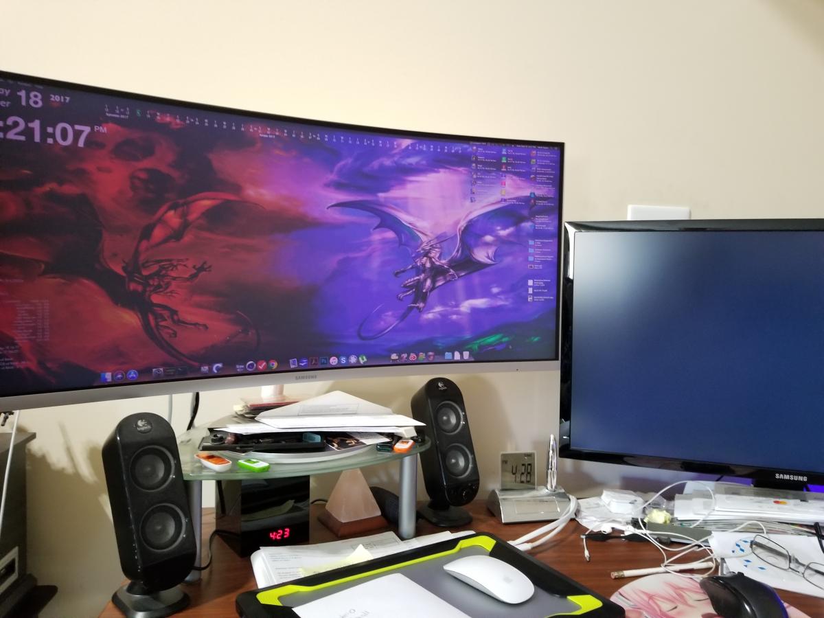

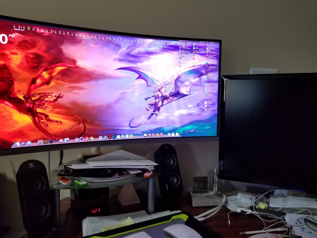

Gogeta5026 Posted September 18, 2017 Share Posted September 18, 2017 I have: Intel Core i7 7700K 4.2 Ghz Gigabyte GA-Z270MX/Gaming 5 Samsung CF791 Series 34-Inch Curved Widescreen Monitor (C34F791) 3440x1440 4K Samsung U28E590D 28-Inch UHD LED-Lit Monitor with Freesync support 3840x2160 4K XFX AMD Radeon™ RX 580 8GB 256 Bit GDDR5 Graphics Card Both monitors are hooked up through Display Port Sierra works fine and I get full 4K off both monitors and everything works. However.... With High Sierra I can only boot into High Sierra with 1 of the monitors turned on. Whenever I turn on the 2 monitor everything freezes within High Sierra and screen goes gray. I can still see the desktop but can't click on anything. Anybody know what I can do to get both monitors working fully in 4K? Some Success ------------- After 2 days of constant testing with no luck. I think the problem has something to do with the AMD .kexts in S/L/E. When I copied the AMD .kexts from Sierra to High Sierra I got weird colors (red & blues flipped) and the 2nd monitor will go on and not lock up the computer Even though the method of copying kexts somewhat worked... It made the graphics choppy and everything was running slow (open windows and programs). Is there a FakeID (FB Name, NVCAP, VRAM, Video Ports, Display-cfg, ig-platform-id, BootDisplay) of some sort I can use in Clover to fix this? Kext? My clover config is attached if that helps anybody!Also...The 2 pictures attached are what happens. Boots with 1 monitor on. As soon as the 2nd monitor is turned on or plugged in... The working monitor goes black and everything stops responding. config.plist.zip Link to comment Share on other sites More sharing options...

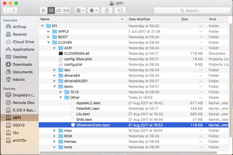

droples Posted September 18, 2017 Share Posted September 18, 2017 @Gogeta5026. I use the Lilu and the WhateverGreen http://www.insanelymac.com/forum/topic/321371-lilu-—-kext-and-process-patcher/ https://github.com/vit9696/WhateverGreen/releases and I don't have such problems. But I have installed RX-560 and my monitors are not so powerful. Maybe worth a try? 1 Link to comment Share on other sites More sharing options...
Gogeta5026 Posted September 18, 2017 Author Share Posted September 18, 2017 @Gogeta5026. I use the Lilu and the WhateverGreen http://www.insanelymac.com/forum/topic/321371-lilu-—-kext-and-process-patcher/ https://github.com/vit9696/WhateverGreen/releases and I don't have such problems. But I have installed RX-560 and my monitors are not so powerful. Maybe worth a try? WE.jpg Are you using any commands when you boot? Like -lilubeta or something along those lines. Did you place the Lilu and the WhateverGreen kexts in S/L/E or in your Clover EFI? Link to comment Share on other sites More sharing options...
droples Posted September 18, 2017 Share Posted September 18, 2017 Are you using any commands when you boot? Like -lilubeta or something along those lines. Did you place the Lilu and the WhateverGreen kexts in S/L/E or in your Clover EFI? I don't use /S/L/E for Lilu.kext and WhateverGreen.kext.They are /EFI/Clover/kexts/Other. For Lilu1.1.7 and above <key>Arguments</key> <string> darkwake=0 -lilubetaall -rad24</string> In addition ... if you use .../Other <key>SystemParameters</key> <dict> <key>InjectKexts</key> <string>Yes</string> ...... 1 Link to comment Share on other sites More sharing options...
Gogeta5026 Posted September 18, 2017 Author Share Posted September 18, 2017 I don't use /S/L/E for Lilu.kext and WhateverGreen.kext.They are /EFI/Clover/kexts/Other. Other.jpg For Lilu1.1.7 and above <key>Arguments</key> <string> darkwake=0 -lilubetaall -rad24</string> In addition ... if you use .../Other <key>SystemParameters</key> <dict> <key>InjectKexts</key> <string>Yes</string> ...... Right now... I'm 98.9% sure that both kexts are in /S/L/E and /EFI/Clover/kexts/Other. I'll try your way when I get home from work in about 6-7 hours. THANK YOU! Link to comment Share on other sites More sharing options...
Gogeta5026 Posted September 18, 2017 Author Share Posted September 18, 2017 I don't use /S/L/E for Lilu.kext and WhateverGreen.kext.They are /EFI/Clover/kexts/Other. Other.jpg For Lilu1.1.7 and above <key>Arguments</key> <string> darkwake=0 -lilubetaall -rad24</string> In addition ... if you use .../Other <key>SystemParameters</key> <dict> <key>InjectKexts</key> <string>Yes</string> ...... Just gave it a shot. NO LUCK. The 2 pictures attached are what happens. Boots with 1 monitor on. As soon as the 2nd monitor is turned on or plugged in... The working monitor goes black and everything stops responding. 1 Link to comment Share on other sites More sharing options...
