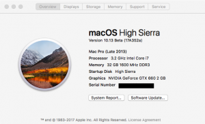

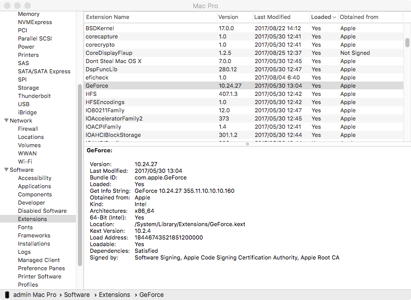

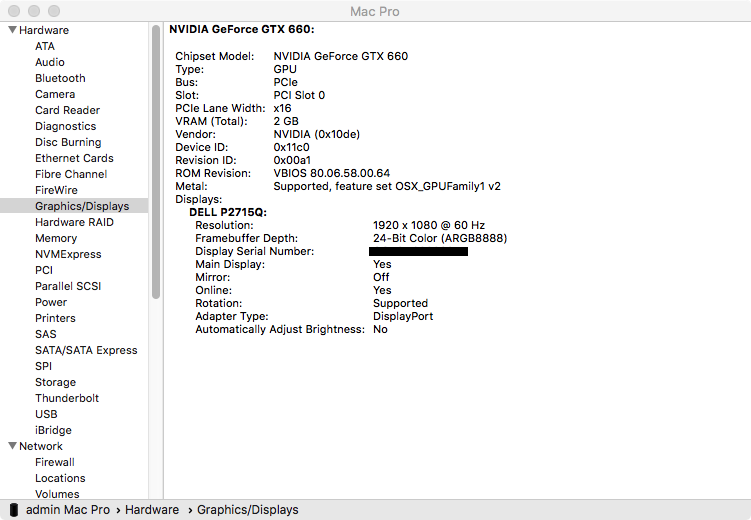

skykeeper Posted August 27, 2017 Share Posted August 27, 2017 Hi Stefan,GK104 Kepler GTX 660 High Sierra 10.13 will work with NvidiaGraphicsFixup.kext.You should delete AppleGraphicsDevicePolicy.kext and install NvidiaGraphicsFixup.kext..However current High Sierra apple native NVIDIA driver did not work well with HiDPI mode. There was glitch problem. MB: GA-Z97X-UD5H (rev. 1.0), Processor: i7-4790S, Video: GV-N660WF2-2GD (rev. 2.0), RAM: 32 Gb 1600Mhz, Storage: ST2000DM00, Wi-Fi+Bluetooth: 4.0 Hobbypower BCM94360CD to PCI-E Mini PCI Express X1, SMBIOS: MP61.88Z.0120.B00.1708080652 1 Link to comment https://www.insanelymac.com/forum/topic/326072-nvidia-evga-gtx660-and-high-sierra/#findComment-2485721 Share on other sites More sharing options...
