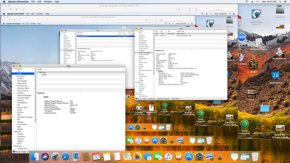

jnolla Posted July 11, 2017 Share Posted July 11, 2017 Seems like High Sierra Beta 3 is fully working for RX580 and Vega, without any patches and no IGPU! I have both, and will be posting screenshots shortly! OK so during installation you can definitely tell the RX580 is fully supported. After installation is completed it goes black. This is no patches or helper gpu. 2 Link to comment https://www.insanelymac.com/forum/topic/325132-high-sierra-beta-3-fully-working-for-rx580-and-vega/ Share on other sites More sharing options...

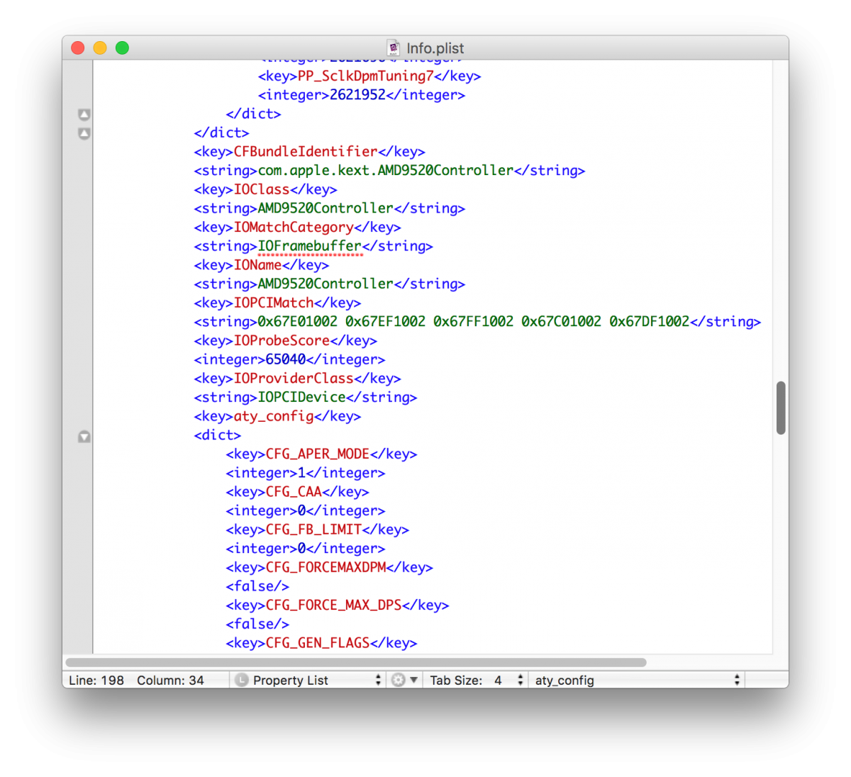

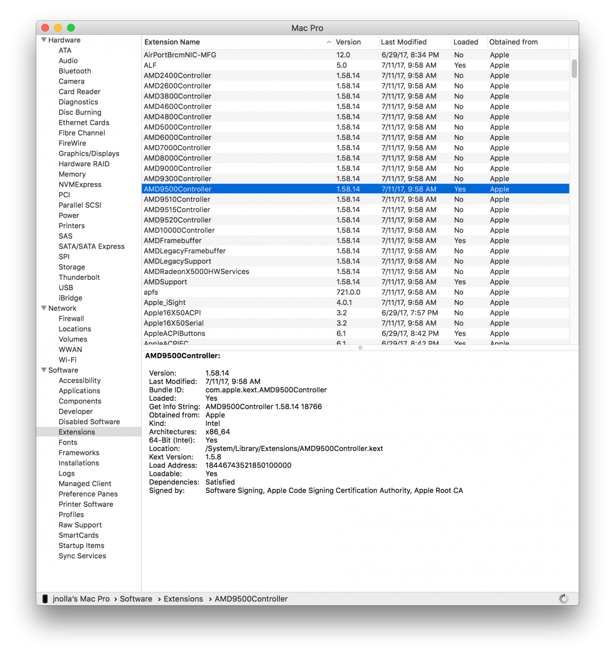

jnolla Posted July 11, 2017 Author Share Posted July 11, 2017 Interesting findings on what is been loaded against what is defined on the KEXT. I'm not sure why the correct KEXT is not loading. Wonder if there is a way to force it. 2 Link to comment https://www.insanelymac.com/forum/topic/325132-high-sierra-beta-3-fully-working-for-rx580-and-vega/#findComment-2460929 Share on other sites More sharing options...

jnolla Posted July 15, 2017 Author Share Posted July 15, 2017 Ok, so I can confirm all ports are working on Vega OOB with full metal support on my ASUS Maximus IX Z270 with 7700k. No patches and iGPU! I'm not sure what is going on with the X99 and the ports not working 1 Link to comment https://www.insanelymac.com/forum/topic/325132-high-sierra-beta-3-fully-working-for-rx580-and-vega/#findComment-2463007 Share on other sites More sharing options...
