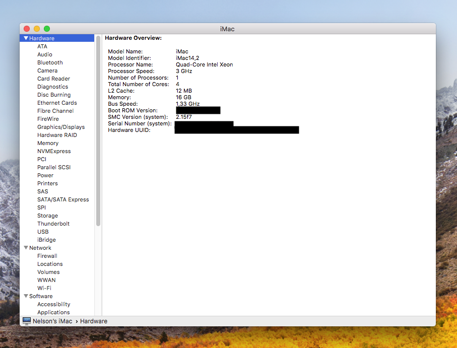

NelsonF Posted September 11, 2017 Share Posted September 11, 2017 Olá pessoal, estou tentando instalar o High Serra na minha gigabyte EP45T-DS3R lga 775, sem sucesso até o momento. Aparece a tela que o OS não pode ser instalado devido a arquivo danificado (ou algo Parecido). Aparece tbm a tela embaralhada c/ sinal de proibido e dá pra entender "still waiting for root device". Alguma instrução à respeito? Desculpem pela falta das fotos. Link to comment https://www.insanelymac.com/forum/topic/324222-macos-1013-betas-dps-disponiveis/page/6/#findComment-2492920 Share on other sites More sharing options...
Allan Posted September 11, 2017 Author Share Posted September 11, 2017 Trocou o SMBios? Link to comment https://www.insanelymac.com/forum/topic/324222-macos-1013-betas-dps-disponiveis/page/6/#findComment-2492933 Share on other sites More sharing options...
NelsonF Posted September 12, 2017 Share Posted September 12, 2017 Uso o SMBios do iMac 14.2 Link to comment https://www.insanelymac.com/forum/topic/324222-macos-1013-betas-dps-disponiveis/page/6/#findComment-2492984 Share on other sites More sharing options...

NelsonF Posted September 14, 2017 Share Posted September 14, 2017 Tentei e aconteceu a mesma coisa. Mas eu refiz o instalador e "aparentemente" está instalado no HDD em GPT! Agora é só fazer o pós-instalação e testar!✌Depois tento instalar no SSD. Parece que o problema era no pendrive mesmo. Obrigado pela atenção! VLW 1 Link to comment https://www.insanelymac.com/forum/topic/324222-macos-1013-betas-dps-disponiveis/page/6/#findComment-2494438 Share on other sites More sharing options...

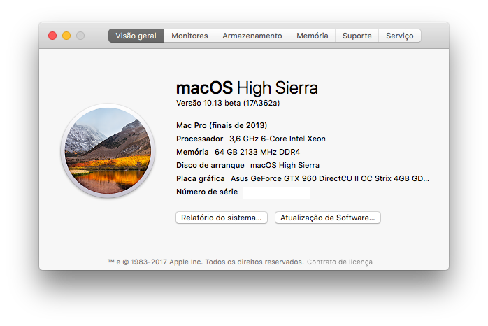

Fergarth Posted September 15, 2017 Share Posted September 15, 2017 10.13 beta (17A362a) Tudo ok, apenas à espera da Web Drive... 2 Link to comment https://www.insanelymac.com/forum/topic/324222-macos-1013-betas-dps-disponiveis/page/6/#findComment-2494906 Share on other sites More sharing options...

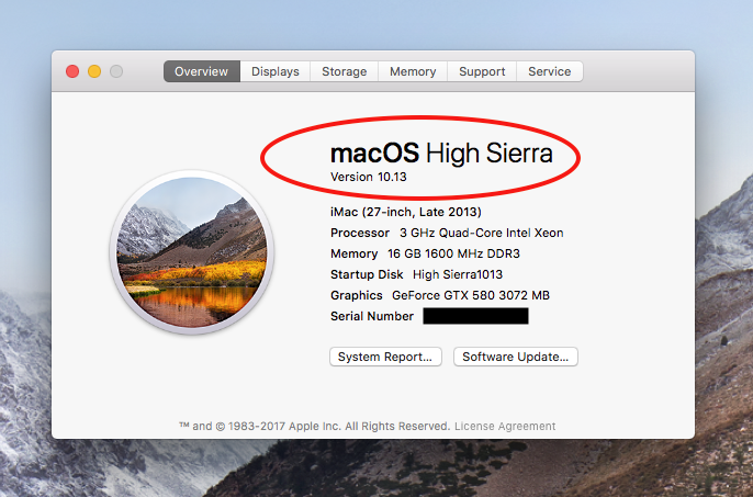

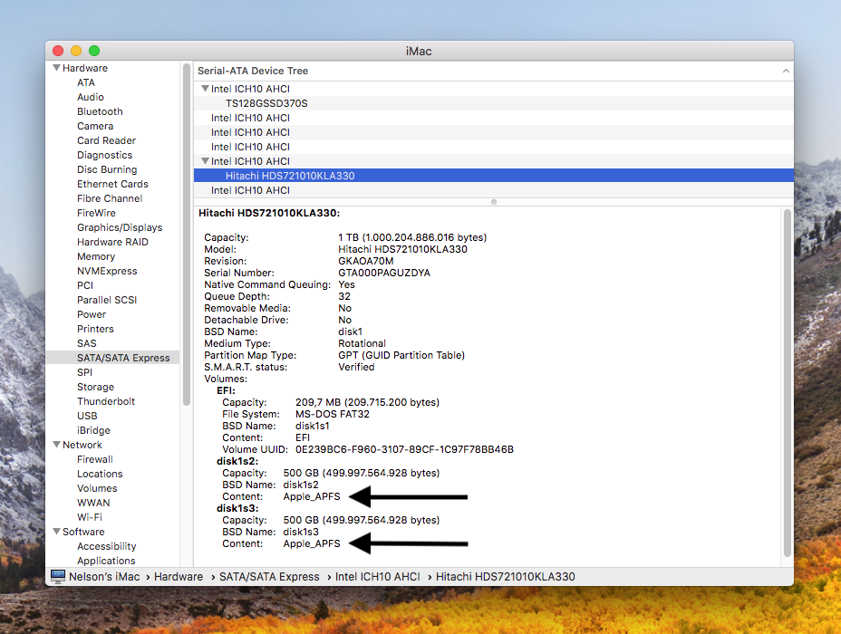

NelsonF Posted September 16, 2017 Share Posted September 16, 2017 Depois de alguns testes pude constatar que o HS só dá pra instalar nas lga775 em HDD. Enquanto que em SSD, na 2a parte da instalação aparece a mensagem de erro "que o OS não pode ser instalado por erro/corrompimento em arquivo blá-blá-blá". O que eu fiz foi subir o sistema no Sierra e utilizar o CCC e clonar o HS do HDD para o SSD. Depois fiz o pós instalação e o HS carrega no SSD. Com exceção do vídeo está tudo normal (na minha visão superficial em hackintosh, DSDT eu utilizei o do Sierra, LPC.kext está carregando). Só falta o reconhecimento da GTX 580. 2 Link to comment https://www.insanelymac.com/forum/topic/324222-macos-1013-betas-dps-disponiveis/page/6/#findComment-2495156 Share on other sites More sharing options...

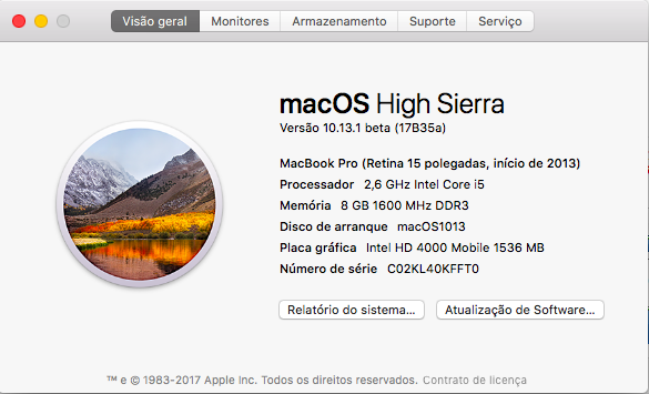

artur_pt Posted October 10, 2017 Share Posted October 10, 2017 olá versão 2 de 10.13.1 build (17B35a) bom hack 2 Link to comment https://www.insanelymac.com/forum/topic/324222-macos-1013-betas-dps-disponiveis/page/6/#findComment-2512616 Share on other sites More sharing options...

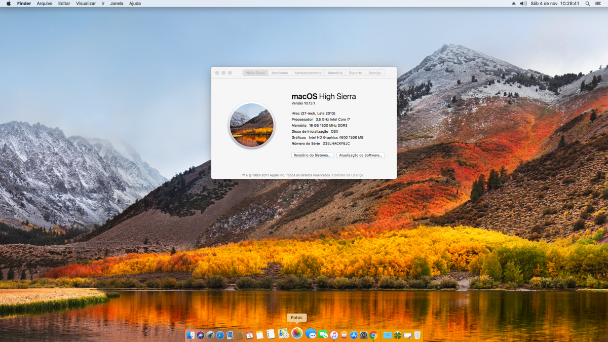

Lucas-Nash Posted November 4, 2017 Share Posted November 4, 2017 Aqui estou usando o Intel HD 4600 (vendi a fonte e guardei a rx480, sem tempo para jogar no momento). Funcionando muito bem. https://uploaddeimagens.com.br/imagens/captura_de_tela_2017-11-04_as_10-28-41-png 1 Link to comment https://www.insanelymac.com/forum/topic/324222-macos-1013-betas-dps-disponiveis/page/6/#findComment-2528861 Share on other sites More sharing options...

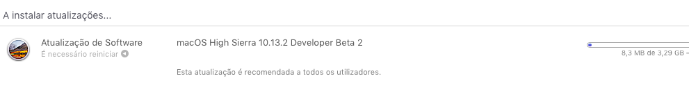

artur_pt Posted November 4, 2017 Share Posted November 4, 2017 olá novo dev beta 10.13.2 bom hack 1 Link to comment https://www.insanelymac.com/forum/topic/324222-macos-1013-betas-dps-disponiveis/page/6/#findComment-2529122 Share on other sites More sharing options...
artur_pt Posted November 8, 2017 Share Posted November 8, 2017 olá novo dev beta de 10.13.2 bom hack 1 Link to comment https://www.insanelymac.com/forum/topic/324222-macos-1013-betas-dps-disponiveis/page/6/#findComment-2530924 Share on other sites More sharing options...

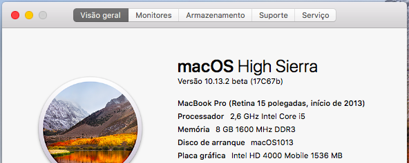

artur_pt Posted November 14, 2017 Share Posted November 14, 2017 olá terceiro beta dev de 10.13.2 update sem problemas bom hack 1 Link to comment https://www.insanelymac.com/forum/topic/324222-macos-1013-betas-dps-disponiveis/page/6/#findComment-2534516 Share on other sites More sharing options...
