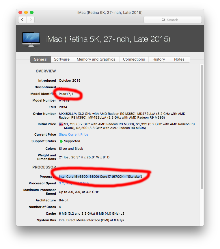

MacPros don't have Skylake CPUs inside but the latest iMac17,1 has a Skylake processor, it's better to use the iMac17,1 SMBIOS to get the full utilization of the skylake architecture, and it has a better chance for power management on skylake processors.

MacPro5,1 is a "Bloomfield, Westmere, Gulftown"
iMac17,1 use ur processor
SMBIOS is not a cosmetic ;)
Load correct profile, good PM, etc

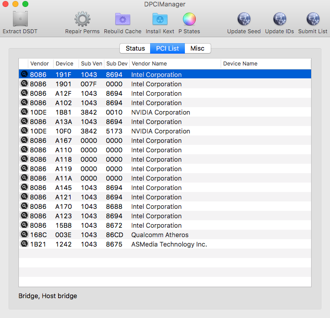

I can't find any useful info on your wifi chipset go to the following URL : https://sourceforge.net/projects/dpcimanager/
download the DPCIManager and run it and send me a snapshot so I can find out your wifi's device ID
Click the PCI list and click update IDs then make a snapshot and post it here, justify the columns so I can read the whole info.

Ok I appreciate!!
Here is the screenshot I made:
Ok now it's better, I will get back to you on that.
It's Qualcomm Atheros 168C:003E

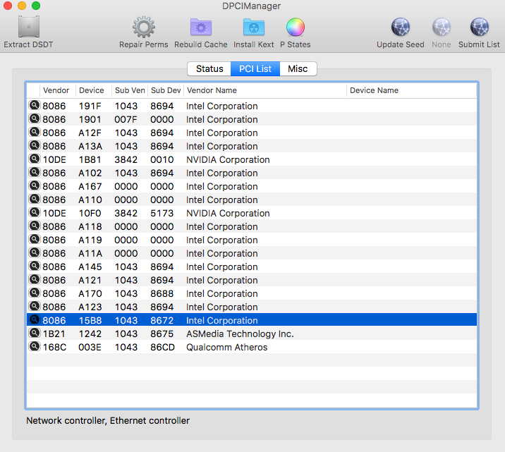

just to make sure that the info is correct remove FakePCIID.kext and FakePCIID_Broarcom_WiFi.kext from EFI/clover/kext and make another screenshot.
Ok I removed the kexts and I did again the screenshot!
