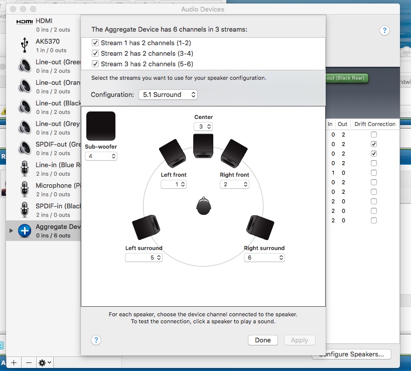

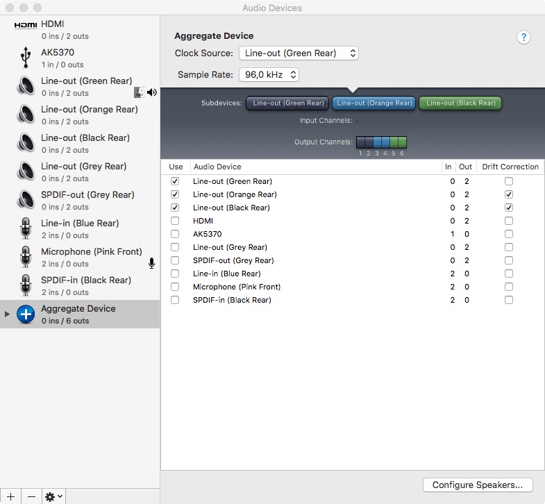

chippackage Posted September 30, 2017 Share Posted September 30, 2017 I have full surround sound working. Once Voodoo is onstalled then create the aggregate layout. Initially upon reboot the sound will be 2.1, but click on the sound icon top right, select aggregate device and immediately again select the Line Out (Green Rear) again. The sound will now be 5.1 and when I play games or watch movies, I mean true 5.1sound. Not duplicating the stereo to all speakers. PS: My card is the same as yours: Emu20k2, SB0880. Let me know if you need help. VoodooHDA.kext.zip 1 Link to comment https://www.insanelymac.com/forum/topic/323631-creative-x-fi-titanium-pro-mic-doesnt-work/#findComment-2505314 Share on other sites More sharing options...
