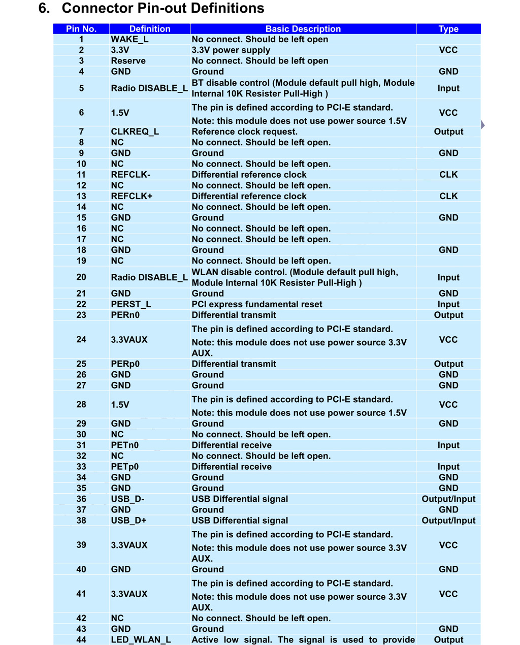

Nonta72 Posted April 25, 2017 Author Share Posted April 25, 2017 Run these commands in Terminal, and put the results here: syslog |grep -i "Wake reason" pmset -g assertions Hi, I have solved my problem somehow. After analyzing the problem; I came to understand that the network card wasn't being turned on after the laptop wakes from sleep by the BIOS (incompatible OS?). I did some research and found that there is a pin on the card that controls the radio ON/OFF. I had a spare AR5B95 card (had to rebrand it too). I went ahead and used it as a TEST SUBJECT by removing the pin that controls the radio switch (hardware switch). It was the 20th pin on the bottom (really the 17th). When I booted to OS X, this issue went away. So I removed the pin on the second card too (AR5B195 with BT 3.0) and put that card back in the laptop. I use the second one for BT because my audio jack is busted and I must connect to a BT headset. Now the problem seems to have been solved. Below are pictures that explain the pin thing (I hope). I SUGGEST ANYONE WHO WANTS TO TRY THIS TO COVER THE PIN WITH SOMETHING SUCH AS A PLASTIC TAPE. REMOVING THE PIN CAN BE DANGEROUS. 2 Link to comment Share on other sites More sharing options...
