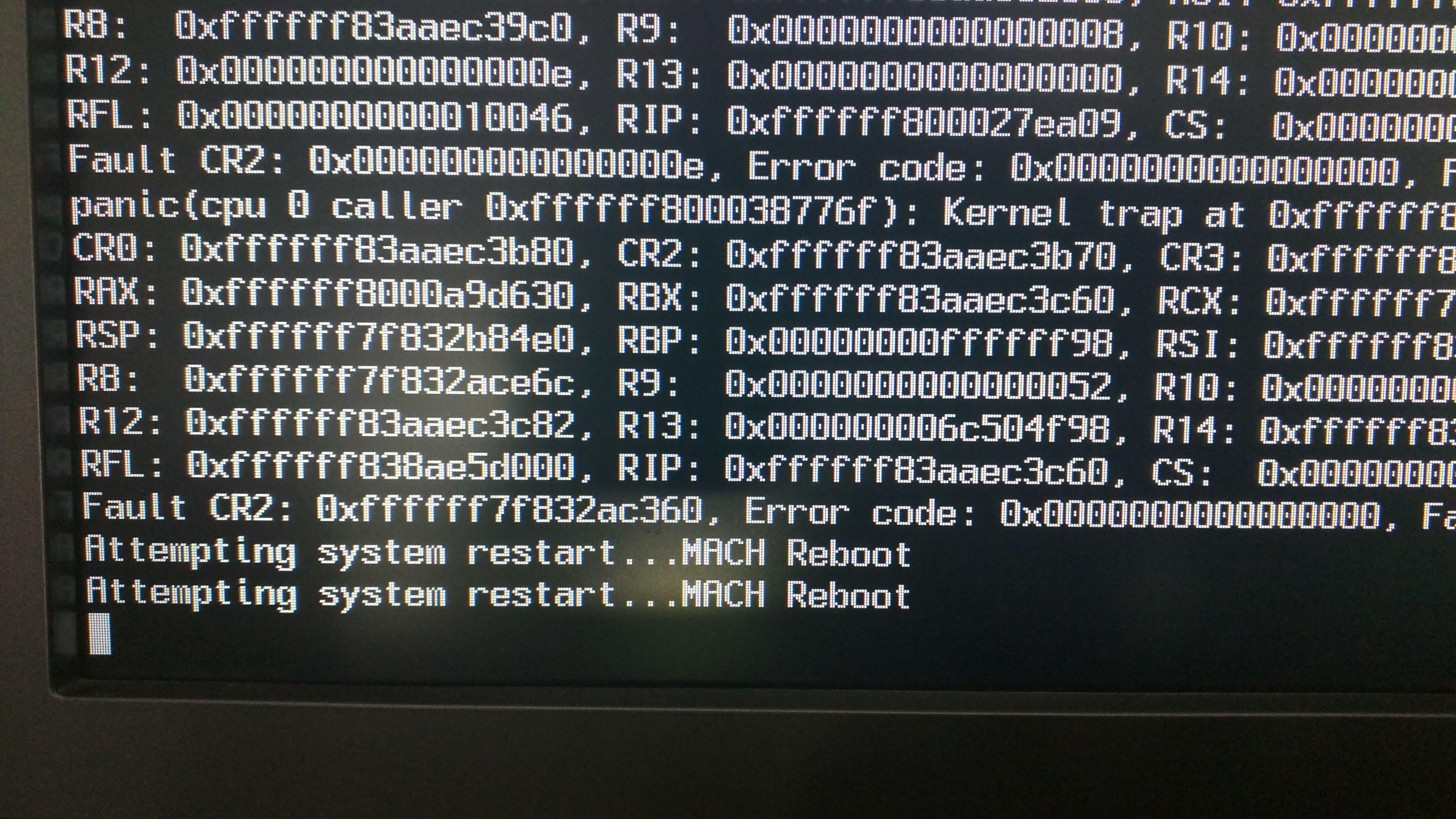

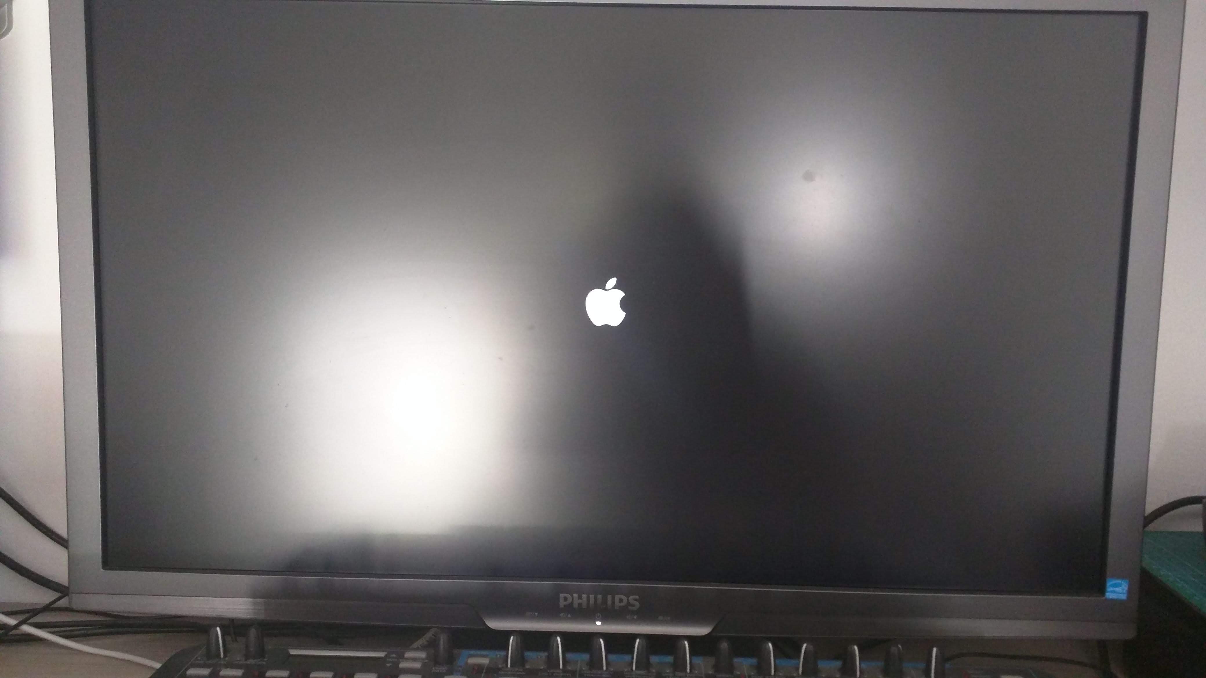

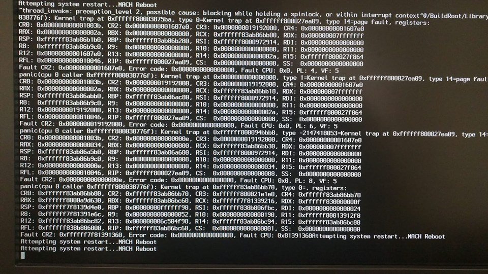

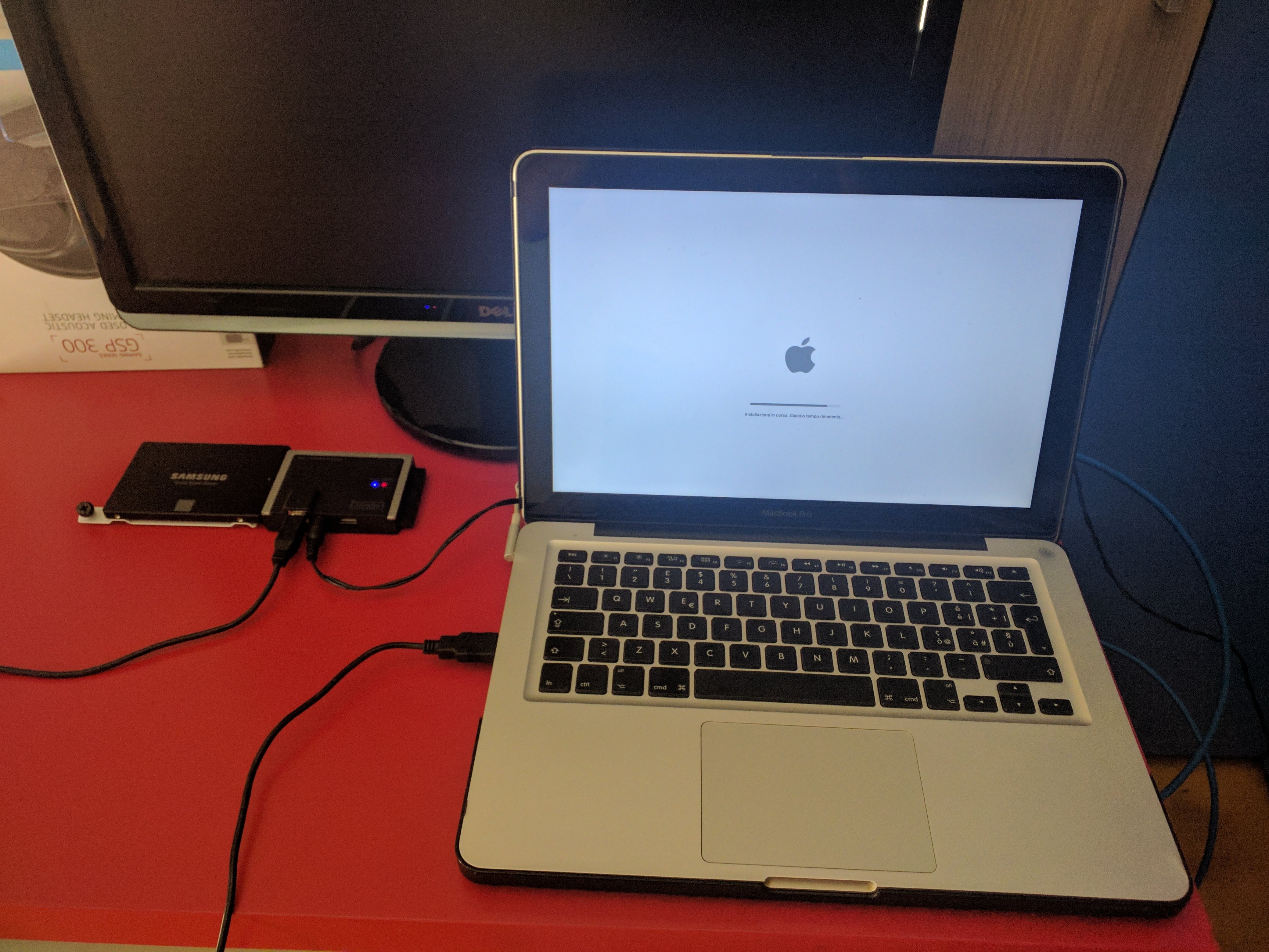

moonbase70 Posted June 30, 2019 Share Posted June 30, 2019 Hi MaLd0n , I have a problem with my hackintosh : Today i have try to upgrade my system from Sierra 10.12.6 to High Sierra but i could not make the update from the Hackintosh because is stuck on apple logo , so i try to start in verbose mode but without success ... (in attached some picture of the logs). After that i disconnect the SSD from the hackintosh and i tried the update from my macbook pro and the update goes fine , after that i reconnect the SSD to the hackintosh but still don't start and the error in verbose mode is the same. The SM bios is Mac pro 5.1 and i use the SSDT tha you make for me for Sierra (i have tried to remove the SSDT but without success the hack still not start) This is the configuration of my sistem MOBO GA Z87X UD7 TH rev 2.0 CPU i7 4790k GPU GTX 760 4gb 32 GB RAM What can i do for solve the problem ? Thank you in advance Link to comment https://www.insanelymac.com/forum/topic/322164-guide-sierra-high-sierra-on-gigabyte-ga-h97m-d3h-dsdt/page/6/#findComment-2679729 Share on other sites More sharing options...
MaLd0n Posted June 30, 2019 Author Share Posted June 30, 2019 27 minutes ago, moonbase70 said: Hi MaLd0n , I have a problem with my hackintosh : Today i have try to upgrade my system from Sierra 10.12.6 to High Sierra but i could not make the update from the Hackintosh because is stuck on apple logo , so i try to start in verbose mode but without success ... (in attached some picture of the logs). After that i disconnect the SSD from the hackintosh and i tried the update from my macbook pro and the update goes fine , after that i reconnect the SSD to the hackintosh but still don't start and the error in verbose mode is the same. The SM bios is Mac pro 5.1 and i use the SSDT tha you make for me for Sierra (i have tried to remove the SSDT but without success the hack still not start) This is the configuration of my sistem MOBO GA Z87X UD7 TH rev 2.0 CPU i7 4790k GPU GTX 760 4gb 32 GB RAM What can i do for solve the problem ? Thank you in advance use a fresh install https://olarila.com/forum/viewtopic.php?f=50&t=8685 Link to comment https://www.insanelymac.com/forum/topic/322164-guide-sierra-high-sierra-on-gigabyte-ga-h97m-d3h-dsdt/page/6/#findComment-2679733 Share on other sites More sharing options...

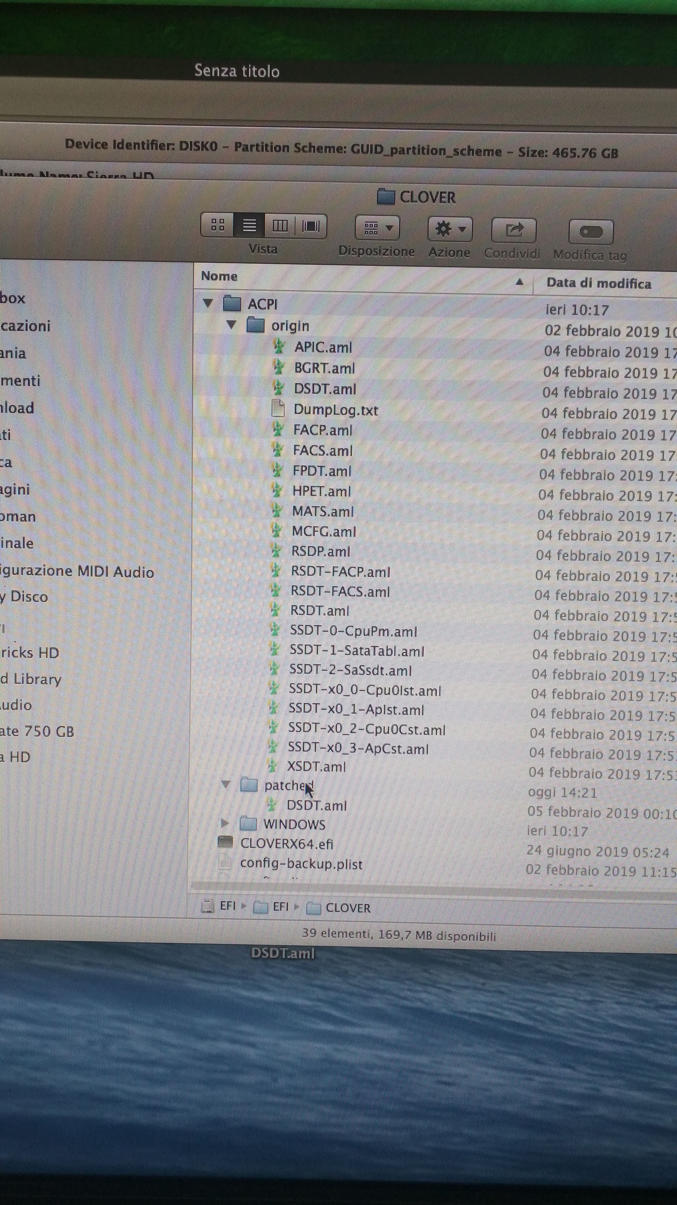

moonbase70 Posted June 30, 2019 Share Posted June 30, 2019 Hi MaLd0n , Finally Solved !! dropping the ACPI MATS/DMAR tables Now it start correctly , i can use the SAME SSDT you make for sierra or not ? Let me know Thank you !! Link to comment https://www.insanelymac.com/forum/topic/322164-guide-sierra-high-sierra-on-gigabyte-ga-h97m-d3h-dsdt/page/6/#findComment-2679735 Share on other sites More sharing options...
MaLd0n Posted June 30, 2019 Author Share Posted June 30, 2019 Just now, moonbase70 said: Hi MaLd0n , Finally Solved !! dropping the ACPI MATS/DMAR tables Now it start correctly , i can use the SAME SSDT you make for sierra or not ? Let me know Thank you !! extract new --Run_Me RunMe.app have some updates Link to comment https://www.insanelymac.com/forum/topic/322164-guide-sierra-high-sierra-on-gigabyte-ga-h97m-d3h-dsdt/page/6/#findComment-2679736 Share on other sites More sharing options...
