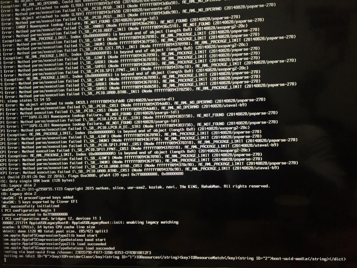

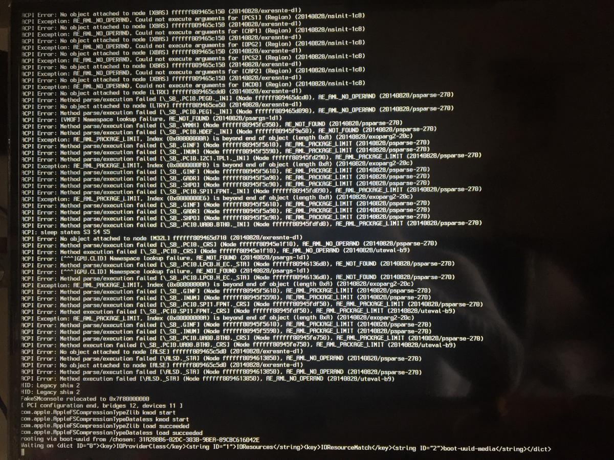

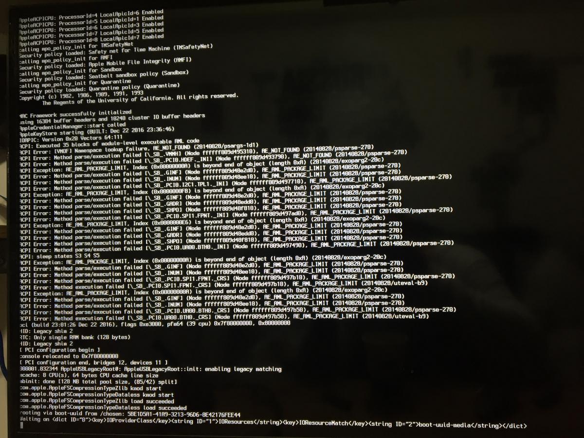

psydrug Posted March 2, 2017 Author Share Posted March 2, 2017 I re-installed the Clover_v2.4k_r4028.pkg.zip And changed the folder CLOVER sent me the latest post And still the same problem This pic error after i add -v to config.plist I just do not know what to do Do not understand what's wrong Thanks in advance Link to comment https://www.insanelymac.com/forum/topic/321545-some-problems-after-installing-the-sierra-on-ga-z170mx-gaming-5/page/2/#findComment-2376054 Share on other sites More sharing options...
MaLd0n Posted March 2, 2017 Share Posted March 2, 2017 not my clover folder, i see other version of fakesmc 1 Link to comment https://www.insanelymac.com/forum/topic/321545-some-problems-after-installing-the-sierra-on-ga-z170mx-gaming-5/page/2/#findComment-2376057 Share on other sites More sharing options...

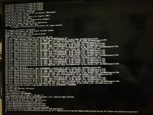

psydrug Posted March 2, 2017 Author Share Posted March 2, 2017 I replace the CLOVER folder You sent me before CLOVER psydrug.zip Attaching a picture of the problem Thanks in advance CLOVER psydrug.zip Link to comment https://www.insanelymac.com/forum/topic/321545-some-problems-after-installing-the-sierra-on-ga-z170mx-gaming-5/page/2/#findComment-2376152 Share on other sites More sharing options...

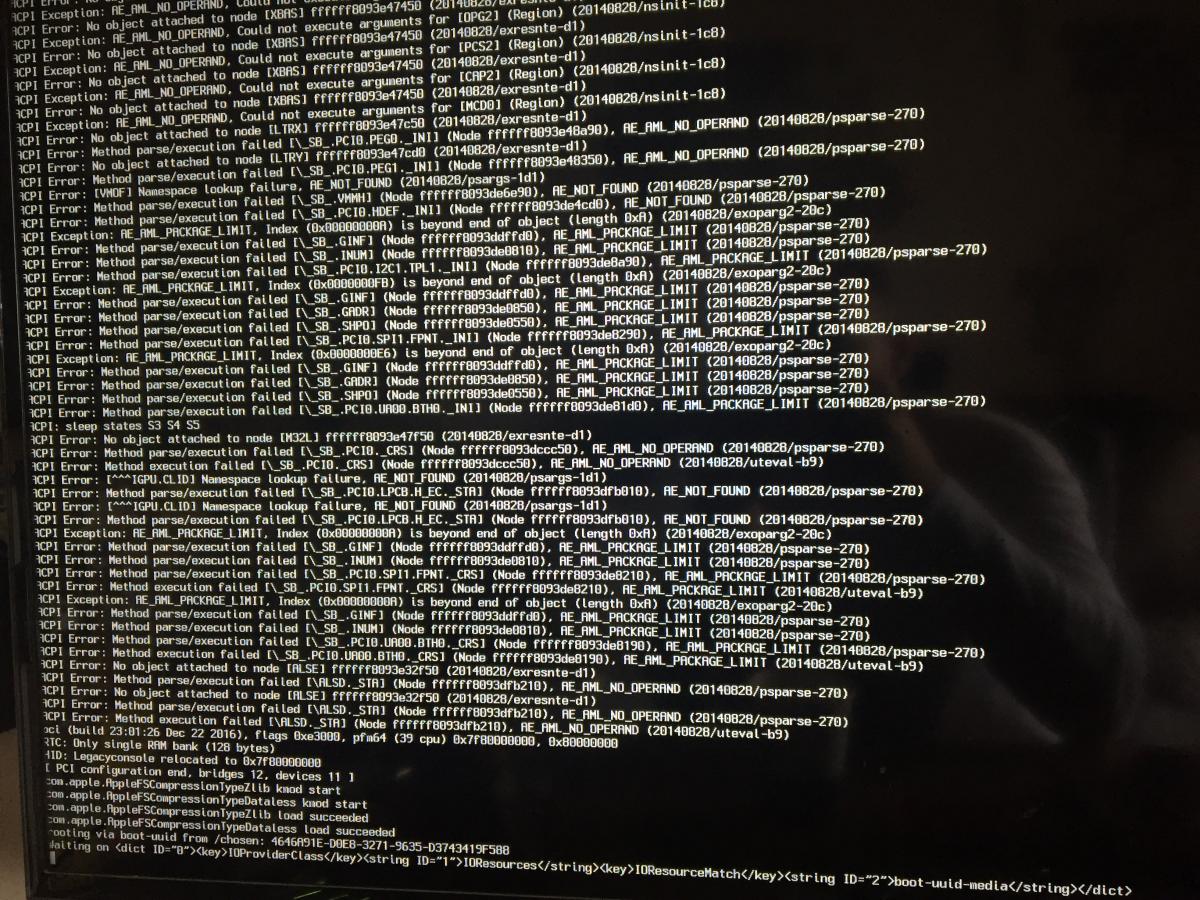

MaLd0n Posted March 2, 2017 Share Posted March 2, 2017 test EFI.zip new clover Clover_v2.4k_r4031.pkg.zip Link to comment https://www.insanelymac.com/forum/topic/321545-some-problems-after-installing-the-sierra-on-ga-z170mx-gaming-5/page/2/#findComment-2376779 Share on other sites More sharing options...
psydrug Posted March 2, 2017 Author Share Posted March 2, 2017 Hello MaLd0n Thank you very much for your response I did it, but again it hangs over this place Thanks in advance 1 Link to comment https://www.insanelymac.com/forum/topic/321545-some-problems-after-installing-the-sierra-on-ga-z170mx-gaming-5/page/2/#findComment-2376783 Share on other sites More sharing options...

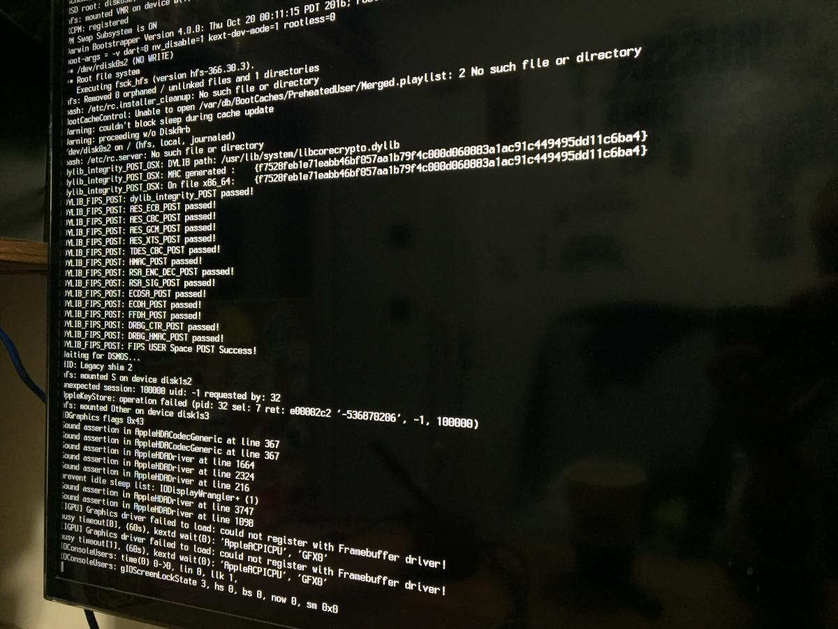

psydrug Posted March 2, 2017 Author Share Posted March 2, 2017 Hello MaLd0n Thank you very much for your response I replace this folder and ... There is little change for the better, Now it's stuck in this situation Maybe you know what's the problem? Thanks in advance 1 Link to comment https://www.insanelymac.com/forum/topic/321545-some-problems-after-installing-the-sierra-on-ga-z170mx-gaming-5/page/2/#findComment-2376818 Share on other sites More sharing options...
MaLd0n Posted March 2, 2017 Share Posted March 2, 2017 the problem is Video use the search forum and inject ig-platform-id and others patches for intelhd530...if u need Link to comment https://www.insanelymac.com/forum/topic/321545-some-problems-after-installing-the-sierra-on-ga-z170mx-gaming-5/page/2/#findComment-2376821 Share on other sites More sharing options...

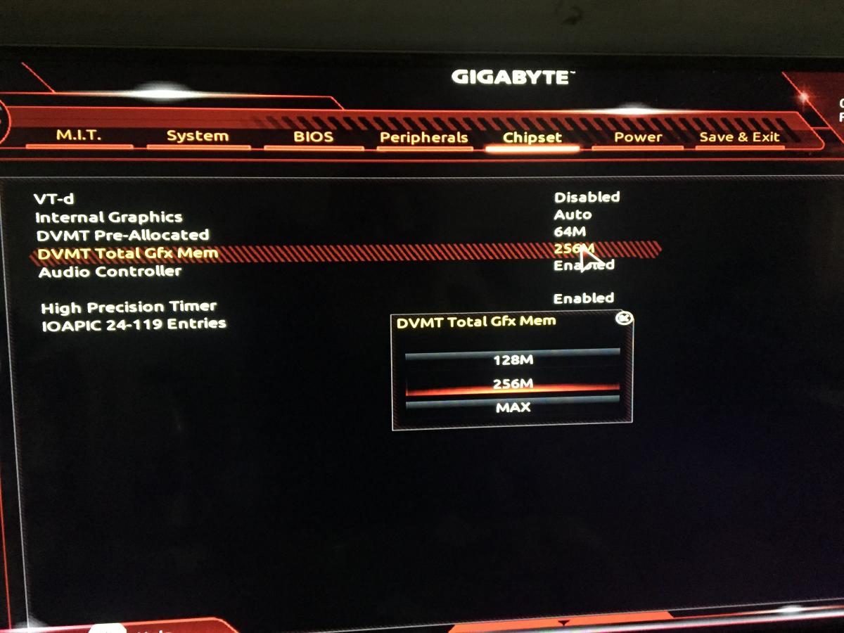

MaLd0n Posted March 3, 2017 Share Posted March 3, 2017 after Clover update with new and oldWay, many problems with DSDT full patched, but i have gigabyte and asus z170, x99 too, no problems here, but i dont use Intel Hd. if u try inject Intel, the problem back too, need many tests. try set modify DVMT in bios, need tests 1 Link to comment https://www.insanelymac.com/forum/topic/321545-some-problems-after-installing-the-sierra-on-ga-z170mx-gaming-5/page/2/#findComment-2377095 Share on other sites More sharing options...
C.Frio Posted March 3, 2017 Share Posted March 3, 2017 hi,, see post #7 http://www.insanelymac.com/forum/topic/317560-help-intel-hd-530-only-has-7mb-of-graphics-ram/ c.frio 1 Link to comment https://www.insanelymac.com/forum/topic/321545-some-problems-after-installing-the-sierra-on-ga-z170mx-gaming-5/page/2/#findComment-2377106 Share on other sites More sharing options...

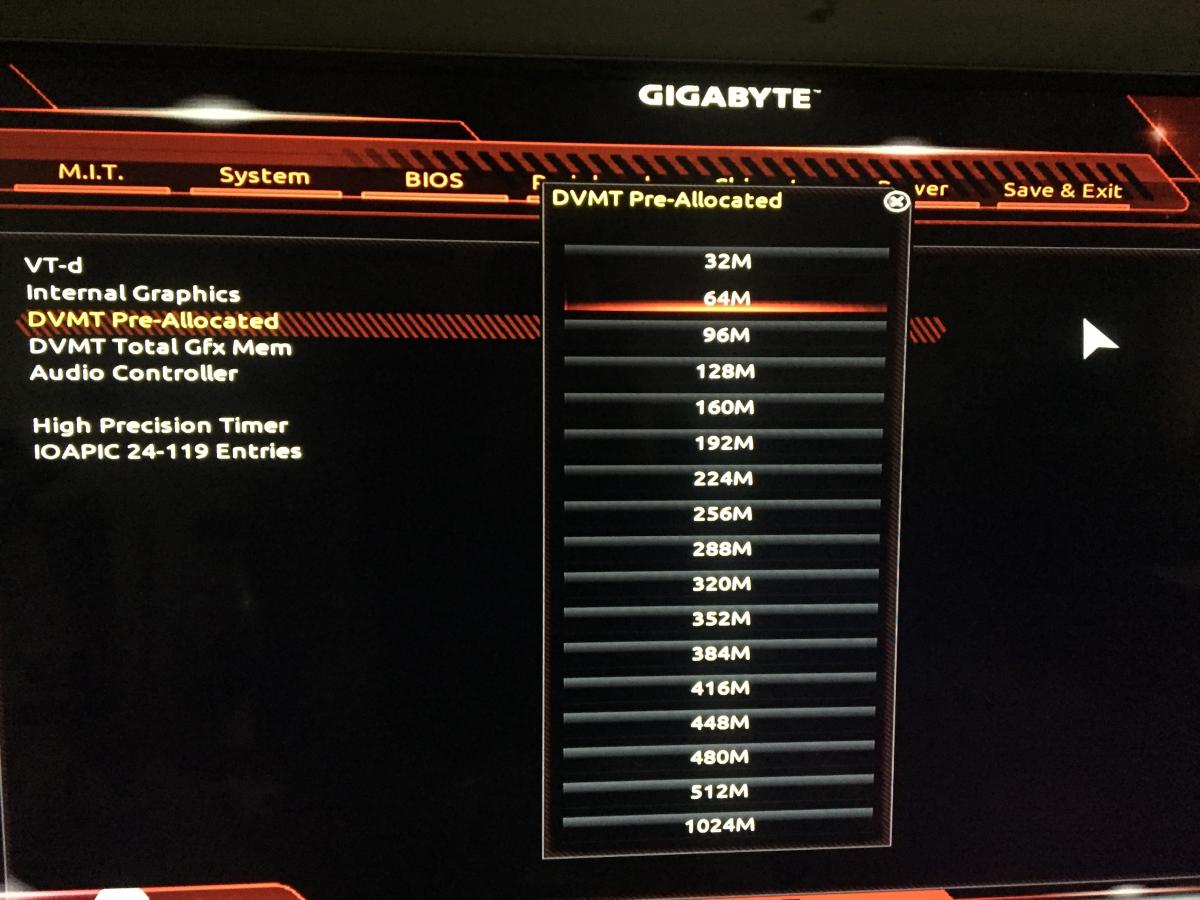

psydrug Posted March 3, 2017 Author Share Posted March 3, 2017 Hello MaLd0n I have a couple of options in bios DVMT What to choose? And file DSDT.aml I deleted from the folder Working part-time I use with CLOVER psydrug.zip CLOVER psydrug.zip Hello C.Frio Thank you very much for answering It did not help me Thanks in advance 1 Link to comment https://www.insanelymac.com/forum/topic/321545-some-problems-after-installing-the-sierra-on-ga-z170mx-gaming-5/page/2/#findComment-2377140 Share on other sites More sharing options...

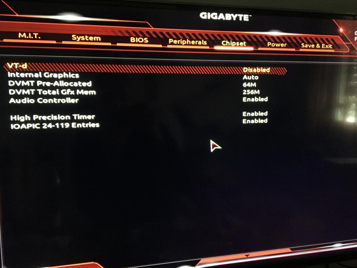

Cyberdevs Posted March 3, 2017 Share Posted March 3, 2017 Hello MaLd0n I have a couple of options in bios DVMT What to choose? And file DSDT.aml I deleted from the folder Working part-time I use with CLOVER psydrug.zip CLOVER psydrug.zip Hello C.Frio Thank you very much for answering It did not help me Thanks in advance Hello everybody, Hi psydrug, I've been reading your posts and I must say you are already in good hands here, Thanks to MaLd0n, he is a legend in this great forum. But there are few things that I noticed and you need to know before we could troubleshoot you problems. First of all you need to Disable IOAPIC 24-119 Entries in your BIOS and you should know I use VoodooHDA for activating my Audio so if you are going to use Toledo's script let me know. send me the latest working version of your EFI folder and we'll start from there. and last but not least if you used the EFI folder i uploaded in my thread and it worked for you, all you have to do is to replace your DSDT and with the one is placed under ACPI\origin and patched. To do so simply delete the files placed under ACPI folders and reboot you computer and when you see clover's bootloader press F4 key on the keyboard which will extract all the ACPI tables for you in the same path. Good luck and let's make it work!! 2 Link to comment https://www.insanelymac.com/forum/topic/321545-some-problems-after-installing-the-sierra-on-ga-z170mx-gaming-5/page/2/#findComment-2377181 Share on other sites More sharing options...

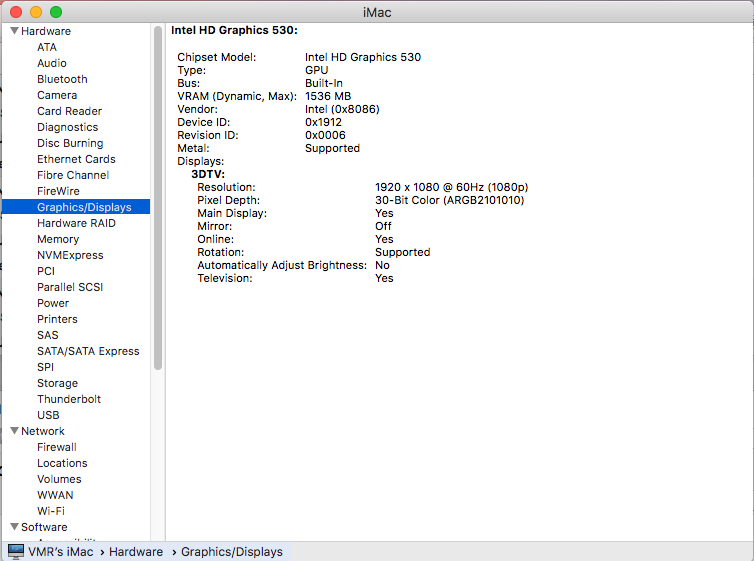

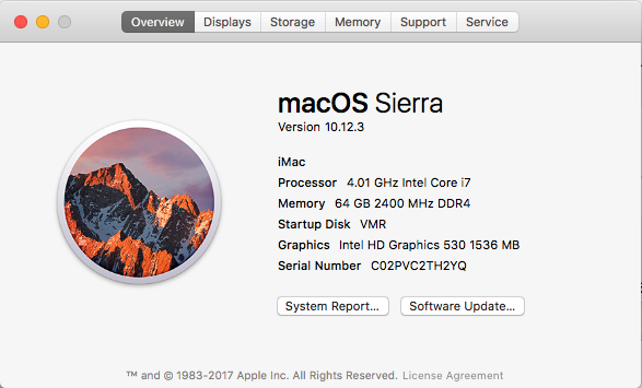

psydrug Posted March 3, 2017 Author Share Posted March 3, 2017 Hello cyberdevs Thank you very much for your response MaLd0n really amazing person I Disable IOAPIC 24-119 in BIOS Now good graphics, I think I'm sending you to the last folder EFI Thanks in advance Last Psydrug EFI:CLOVER.zip Link to comment https://www.insanelymac.com/forum/topic/321545-some-problems-after-installing-the-sierra-on-ga-z170mx-gaming-5/page/2/#findComment-2377185 Share on other sites More sharing options...
Cyberdevs Posted March 3, 2017 Share Posted March 3, 2017 Good, so now what's next? do you need Audio support? or there is something else? 1 Link to comment https://www.insanelymac.com/forum/topic/321545-some-problems-after-installing-the-sierra-on-ga-z170mx-gaming-5/page/2/#findComment-2377191 Share on other sites More sharing options...

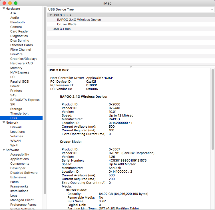

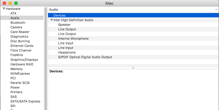

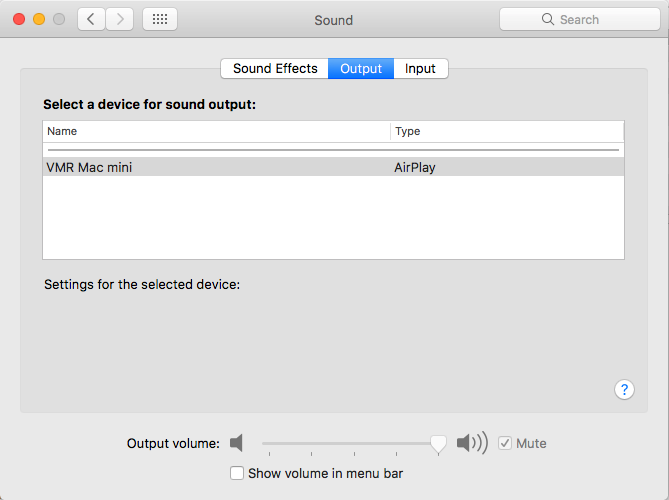

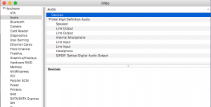

psydrug Posted March 3, 2017 Author Share Posted March 3, 2017 Thank you very much for your response Yes, I need help with audio that currently I'm do not have audio And Can also play audio from HDMI? And I have a problem with the USB, I do not have any ports And another thing, shutdown does not work Restart the computer do if I do shutdown Thanks in advance Link to comment https://www.insanelymac.com/forum/topic/321545-some-problems-after-installing-the-sierra-on-ga-z170mx-gaming-5/page/2/#findComment-2377196 Share on other sites More sharing options...
Cyberdevs Posted March 3, 2017 Share Posted March 3, 2017 Replace your config plist with this one and male sure to backup yours before replacing it just in case. For audio you can use VoodooHDA from download section of this site or you can use toledo's script to activate the Audio. see the following: http://www.insanelymac.com/forum/topic/309352-el-capitan-on-ga-z170x-gaming-5/?p=2199304 config.plist.zip 1 Link to comment https://www.insanelymac.com/forum/topic/321545-some-problems-after-installing-the-sierra-on-ga-z170mx-gaming-5/page/2/#findComment-2377218 Share on other sites More sharing options...

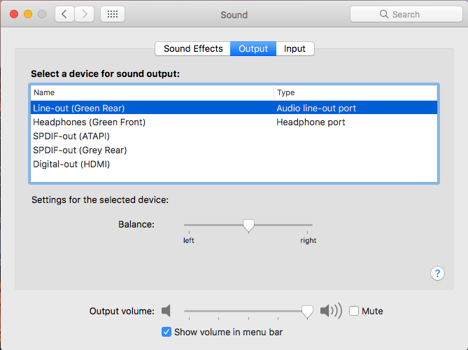

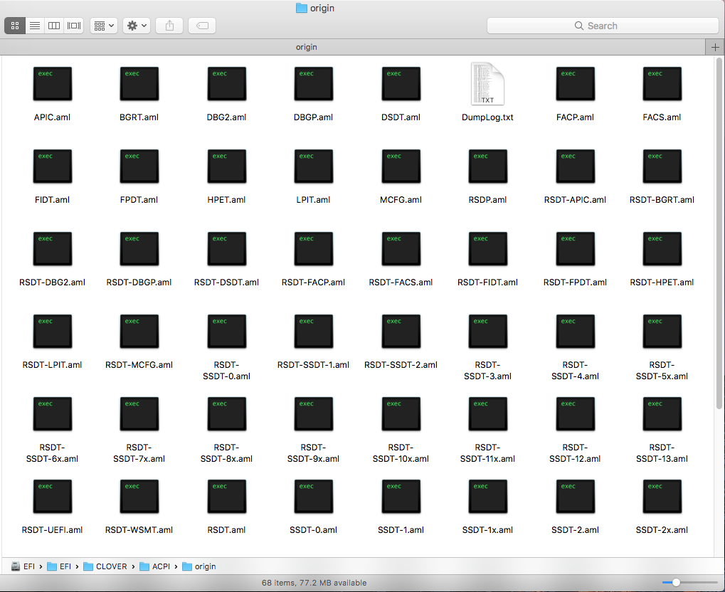

psydrug Posted March 3, 2017 Author Share Posted March 3, 2017 Everything works great Apart from HDMI AUDIO There is a possibility to arrange it? And another thing, I did not understand how I create DSDT I press the F4 key and there is nothing, nothing happens I saw this guide http://www.insanelymac.com/forum/topic/278170-dsdt-%E2%80%94-what-is-it-and-how-do-i-get-it/ The command is written in this guide cat /proc/acpi/dsdt > dsdt.aml I need it? editing: I realized that after pressing the F4 I get all the files to ACPI\origin What do I do with it now? Thanks in advance Link to comment https://www.insanelymac.com/forum/topic/321545-some-problems-after-installing-the-sierra-on-ga-z170mx-gaming-5/page/2/#findComment-2377247 Share on other sites More sharing options...
