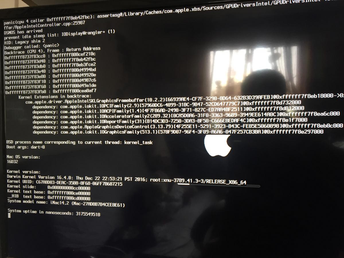

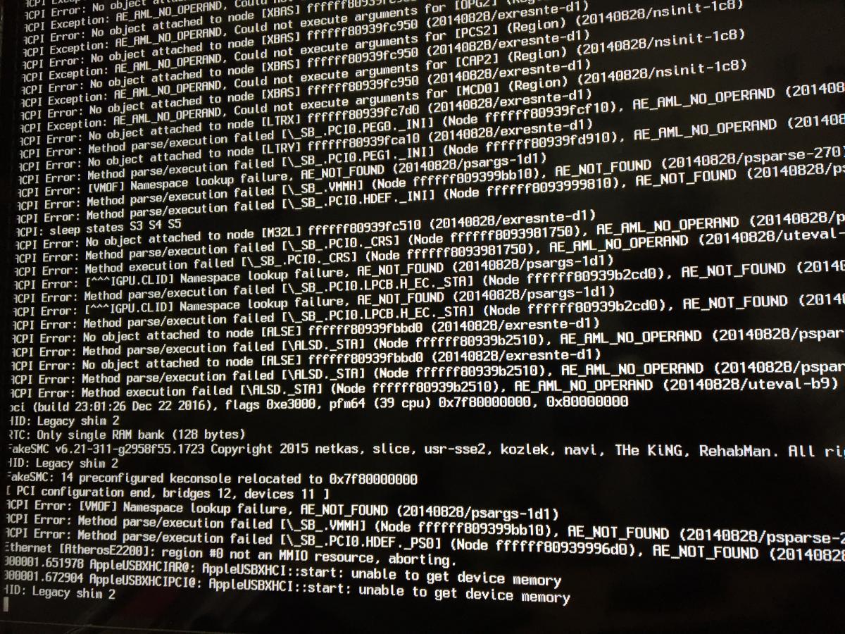

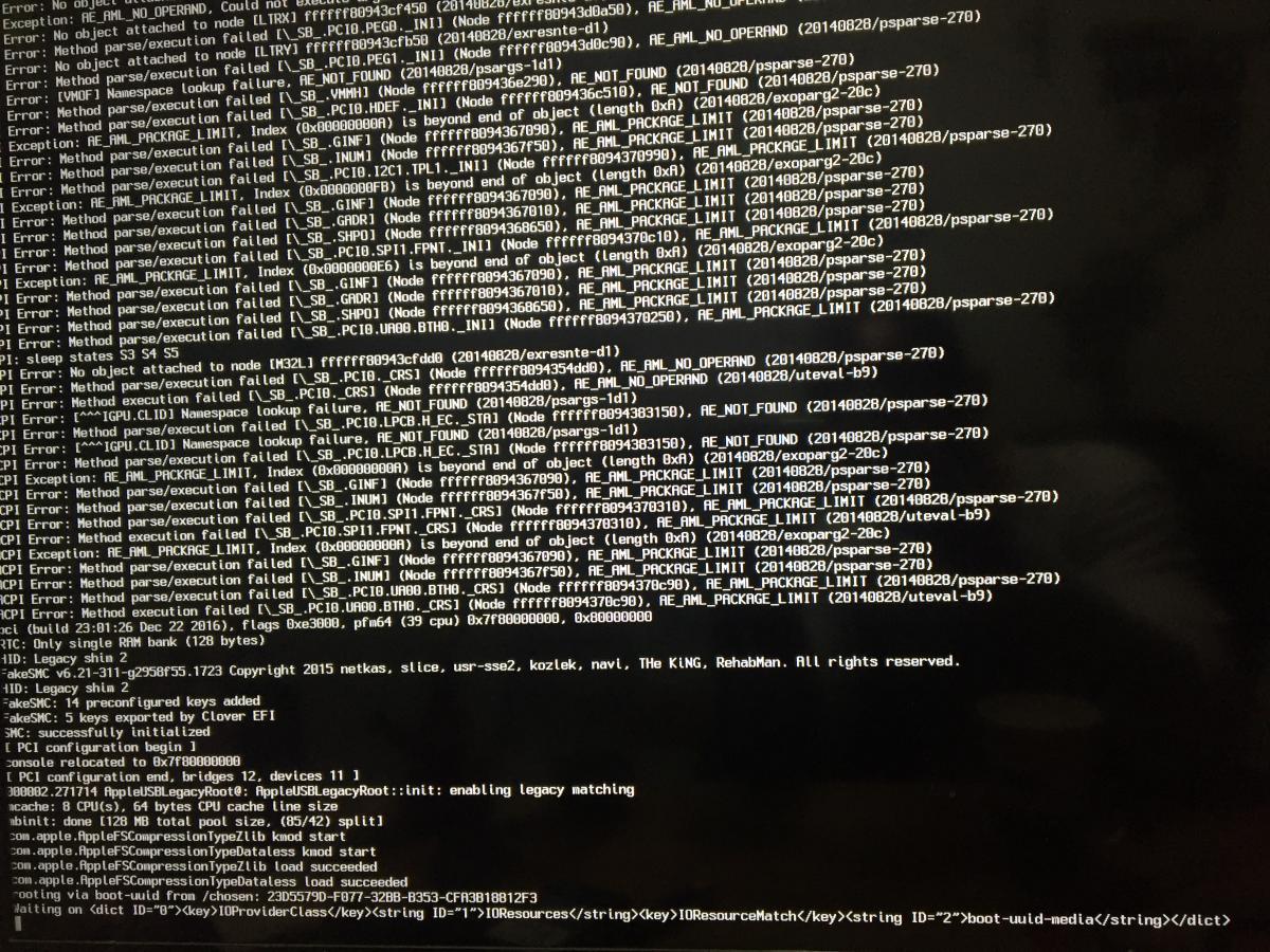

psydrug Posted February 28, 2017 Share Posted February 28, 2017 (edited) Hello everyoneI bought my hackintosh new partsMotherboard: GA-Z170MX-Gaming 5 ver1.0 F20 biosMemories: HX424C15FBK4 / 64Processor: I7-6700K 4GHZ 8MBGPU: intel 530I have successfully installed the system 10.12.3After I installed the 100 Series AudioAnd ALC1150 and sound worksThen I installed the AtherosE22000Ethernet (the latest version)I did restart, and network card workNow the problem with an internal graphics card 530xxxxxxxxxxxxxxxxxxxxxxxxI did restart and check the situation, and it makes infinite restartI I've included a picture What am I doing wrong? Even I uploaded the file config.plistThanks in advance config.plist.zip Edited April 3, 2017 by carlo_67 The tool tony are not and should not be supported here, please Regulation 1 Link to comment https://www.insanelymac.com/forum/topic/321545-some-problems-after-installing-the-sierra-on-ga-z170mx-gaming-5/ Share on other sites More sharing options...
nawcom Posted February 28, 2017 Share Posted February 28, 2017 You can either raise the DVMT value in the UEFI BIOS settings to at least 64MB or you can use the minStolenSize patch and see if that gets around it. Here's your config.plist with that patch added for 10.12.x: config.plist.zip Link to comment https://www.insanelymac.com/forum/topic/321545-some-problems-after-installing-the-sierra-on-ga-z170mx-gaming-5/#findComment-2375523 Share on other sites More sharing options...

psydrug Posted March 1, 2017 Author Share Posted March 1, 2017 Hello nawcom and MaLd0n Thank you very much for your response I was a default of DVMT Pre-Allocated have 32MB I changed it to 1024M It works in part I upload my files Please check them if everything is OK Thanks in advance VMR’s iMac.ioreg.zip Send me VMR’s iMac.zip 1 Link to comment https://www.insanelymac.com/forum/topic/321545-some-problems-after-installing-the-sierra-on-ga-z170mx-gaming-5/#findComment-2375583 Share on other sites More sharing options...

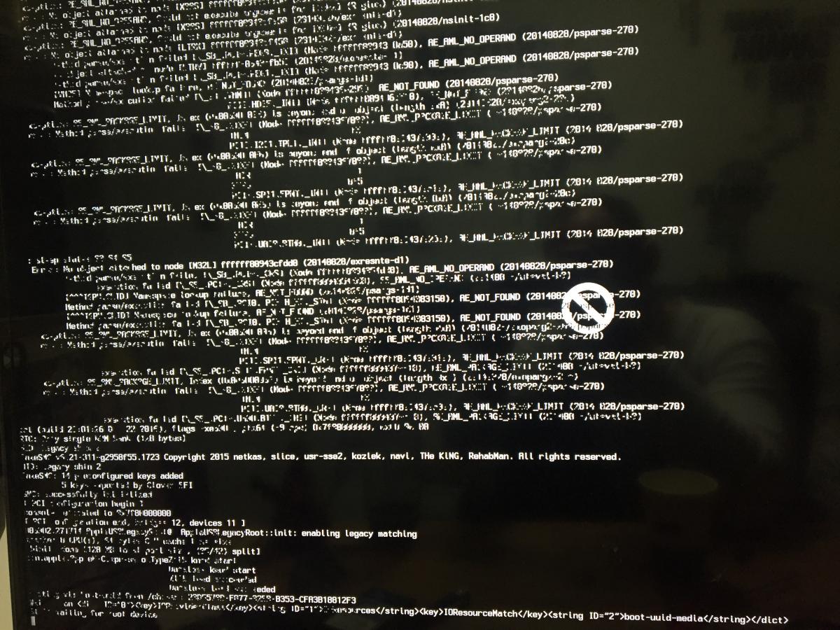

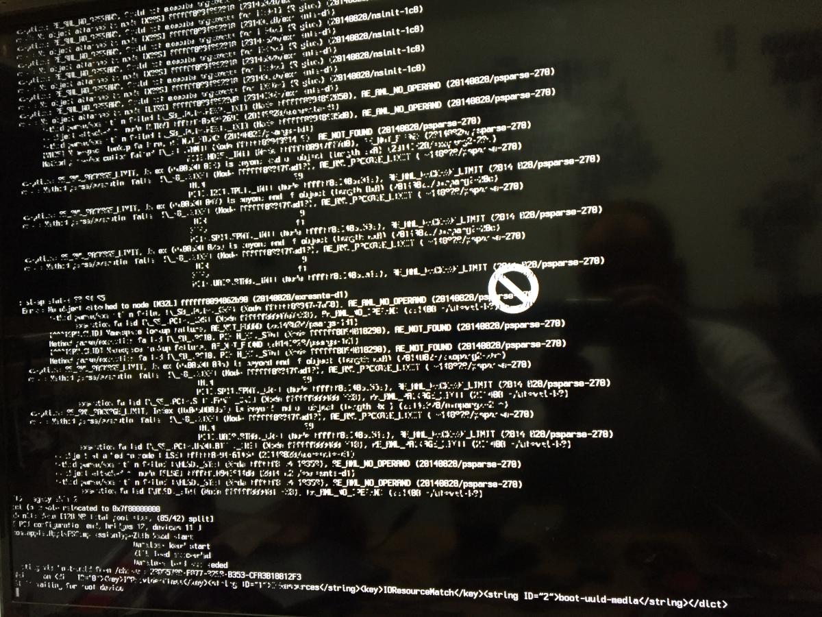

psydrug Posted March 1, 2017 Author Share Posted March 1, 2017 Hello MaLd0n Thank you very much for your response I replaced the full Clover folder Now there is another problem What's wrong? Thanks in advance After I changed the DVMT Pre-Allocated to 64MB from 1024MB These results 1 Link to comment https://www.insanelymac.com/forum/topic/321545-some-problems-after-installing-the-sierra-on-ga-z170mx-gaming-5/#findComment-2375801 Share on other sites More sharing options...
MaLd0n Posted March 1, 2017 Share Posted March 1, 2017 try remove usbinjectall in Clover/Kext/10.12 1 Link to comment https://www.insanelymac.com/forum/topic/321545-some-problems-after-installing-the-sierra-on-ga-z170mx-gaming-5/#findComment-2375843 Share on other sites More sharing options...
psydrug Posted March 1, 2017 Author Share Posted March 1, 2017 Hello MaLd0n Thank you very much for your response I deleted the usbinjectall in Clover/Kext/10.12 And still the same problem Thanks in advance 1 Link to comment https://www.insanelymac.com/forum/topic/321545-some-problems-after-installing-the-sierra-on-ga-z170mx-gaming-5/#findComment-2375855 Share on other sites More sharing options...
MaLd0n Posted March 1, 2017 Share Posted March 1, 2017 replace DSDT and fakesmc Arquivo Comprimido.zip i think work now, if dont work, i can remove glitch patch in config.plist 1 Link to comment https://www.insanelymac.com/forum/topic/321545-some-problems-after-installing-the-sierra-on-ga-z170mx-gaming-5/#findComment-2375867 Share on other sites More sharing options...

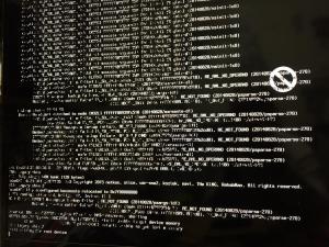

psydrug Posted March 1, 2017 Author Share Posted March 1, 2017 Hello MaLd0n Thank you very much for your response Same problem after replacing DSDT file and Fakesmc I'm desperate, I do not know what my problem Thanks in advance 1 Link to comment https://www.insanelymac.com/forum/topic/321545-some-problems-after-installing-the-sierra-on-ga-z170mx-gaming-5/#findComment-2375874 Share on other sites More sharing options...
MaLd0n Posted March 1, 2017 Share Posted March 1, 2017 go to tests replace config.plist and run Olarila.command config.plist.zip Olarila.command.zip 1 Link to comment https://www.insanelymac.com/forum/topic/321545-some-problems-after-installing-the-sierra-on-ga-z170mx-gaming-5/#findComment-2375888 Share on other sites More sharing options...

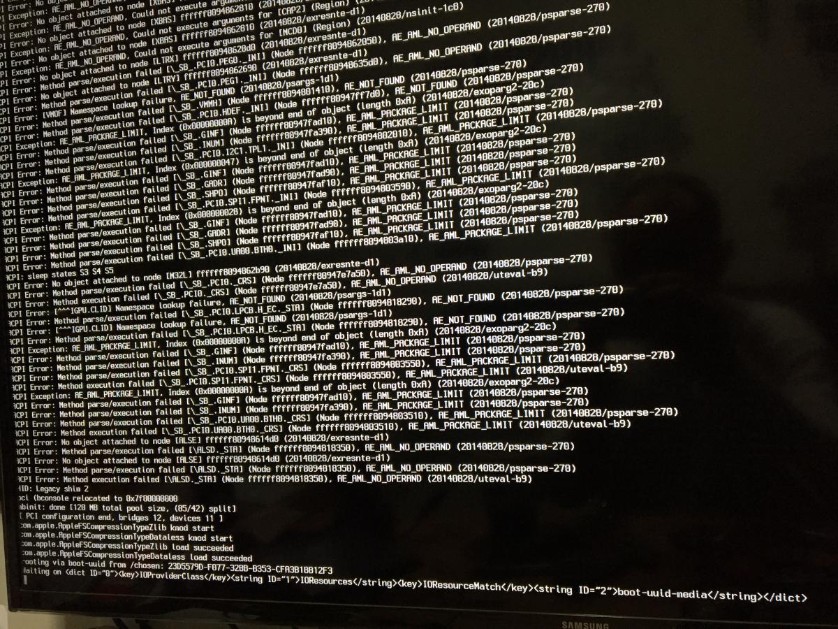

psydrug Posted March 1, 2017 Author Share Posted March 1, 2017 I tried to replace config.plist and run Olarila.command My result from this Olarila.command Waiting for I/O Kit to quiesce. kext-dev-mode allowing invalid signature -67062 0xFFFFFFFFFFFEFA0A for kext realtekALC.kext kext-dev-mode allowing invalid signature -67062 0xFFFFFFFFFFFEFA0A for kext FakeSMC_LPCSensors.kext kext-dev-mode allowing invalid signature -67062 0xFFFFFFFFFFFEFA0A for kext FakeSMC_CPUSensors.kext kext-dev-mode allowing invalid signature -67062 0xFFFFFFFFFFFEFA0A for kext FakeSMC_ACPISensors.kext kext-dev-mode allowing invalid signature -67062 0xFFFFFFFFFFFEFA0A for kext FakeSMC.kext kext-dev-mode allowing invalid signature -67062 0xFFFFFFFFFFFEFA0A for kext AtherosE2200Ethernet.kext kext-dev-mode allowing invalid signature -67013 0xFFFFFFFFFFFEFA3B for kext AppleMobileDevice.kext KernelCache ID: 5205485C2EEC00FA4305DD237FDDB7F6 Created prelinked kernel "/System/Library/PrelinkedKernels/prelinkedkernel" Created prelinked kernel using "/System/Library/Kernels/kernel" Symlink "/System/Library/Caches/com.apple.kext.caches/Startup/kernelcache" -> "/System/Library/PrelinkedKernels/prelinkedkernel" symlink("/System/Library/PrelinkedKernels/prelinkedkernel", "/System/Library/Caches/com.apple.kext.caches/Startup/kernelcache") failed 17 (File exists) <createPrelinkedKernel 2795> Directory caches updated for /System/Library/Extensions. Directory caches updated for /Library/Extensions. logout Saving session... ...copying shared history... ...saving history...truncating history files... ...completed. And still the same problem Thanks in advance 1 Link to comment https://www.insanelymac.com/forum/topic/321545-some-problems-after-installing-the-sierra-on-ga-z170mx-gaming-5/#findComment-2375901 Share on other sites More sharing options...

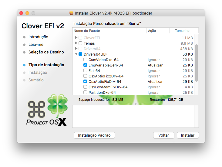

MaLd0n Posted March 1, 2017 Share Posted March 1, 2017 remove realtekALC.kext, FakeSMC_LPCSensors.kext, FakeSMC_CPUSensors.kext, FakeSMC_ACPISensors.kext, FakeSMC.kext My Clover folder is for UEFI mode, only, dont have drivers for legacy see, use this for install clover and emuvariable for F20 bios after it replace with Clover folder CLOVER.zip if u have install in legacy mode, try a fresh install, use UEFI mode 1 Link to comment https://www.insanelymac.com/forum/topic/321545-some-problems-after-installing-the-sierra-on-ga-z170mx-gaming-5/#findComment-2375913 Share on other sites More sharing options...

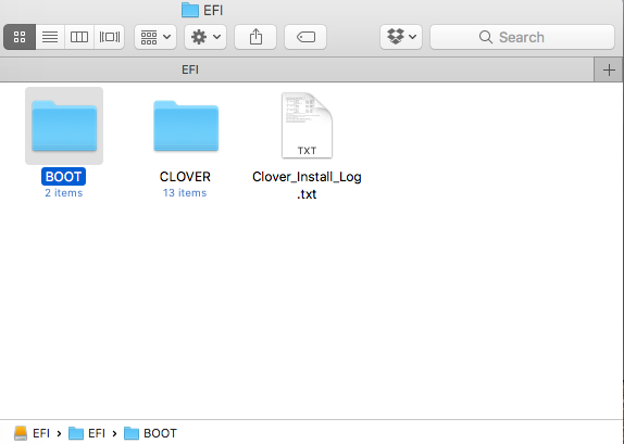

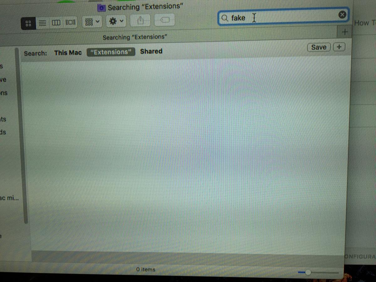

psydrug Posted March 1, 2017 Author Share Posted March 1, 2017 The truth I do not have these files realtekALC.kext, FakeSMC_LPCSensors.kext, FakeSMC_CPUSensors.kext, FakeSMC_ACPISensors.kext, FakeSMC.kext in s / l / e I have attached a photo I installed my system as UEFI mode I need to install the clover on the main partition? Or on EFI partition? I just do not see EFI partition on clover install Thanks in advance Link to comment https://www.insanelymac.com/forum/topic/321545-some-problems-after-installing-the-sierra-on-ga-z170mx-gaming-5/#findComment-2375922 Share on other sites More sharing options...
MaLd0n Posted March 1, 2017 Share Posted March 1, 2017 in UEFI mode, the Clover installer create a EFI partition, just mount and unmount efi if u can modify something 1 Link to comment https://www.insanelymac.com/forum/topic/321545-some-problems-after-installing-the-sierra-on-ga-z170mx-gaming-5/#findComment-2375924 Share on other sites More sharing options...
psydrug Posted March 1, 2017 Author Share Posted March 1, 2017 Yes, my system is installed as UEFI mode My question is where to install the clover? To the main partition? To (Mackintosh HD)? Thanks in advance Link to comment https://www.insanelymac.com/forum/topic/321545-some-problems-after-installing-the-sierra-on-ga-z170mx-gaming-5/#findComment-2375930 Share on other sites More sharing options...
MaLd0n Posted March 1, 2017 Share Posted March 1, 2017 to Macintosh hd with same configs in installer, see http://www.insanelymac.com/forum/topic/321545-some-problems-after-installing-the-sierra-on-ga-z170mx-gaming-5/?p=2375913 Link to comment https://www.insanelymac.com/forum/topic/321545-some-problems-after-installing-the-sierra-on-ga-z170mx-gaming-5/#findComment-2375939 Share on other sites More sharing options...

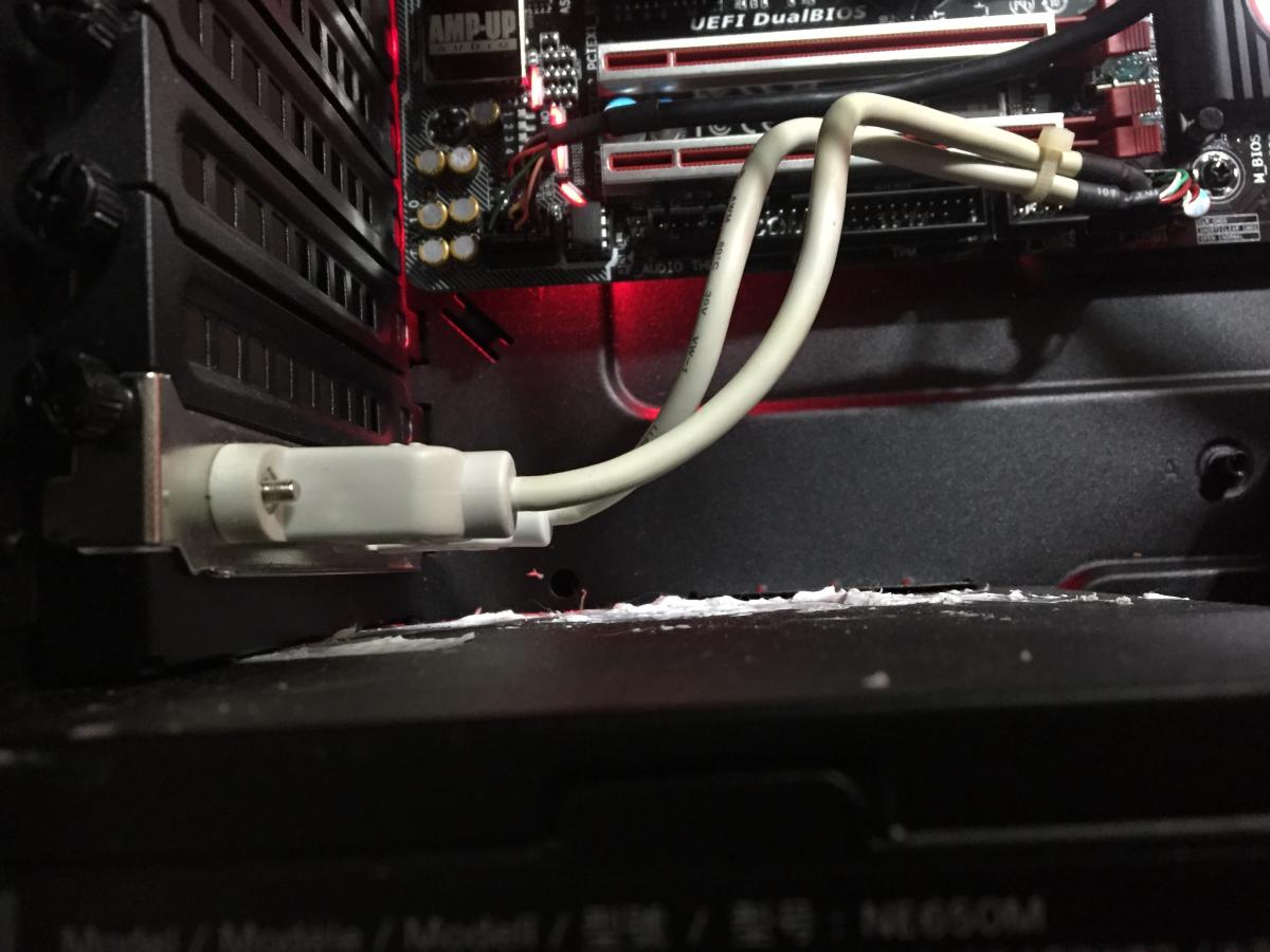

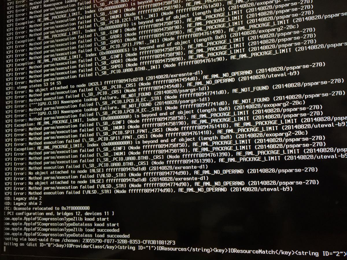

psydrug Posted March 1, 2017 Author Share Posted March 1, 2017 Thank you very much for answering I installed the clover like you said after i replace with Clover folder you send And still the same problem Maybe because I have 64GB of memory? Or maybe because I plugged this thing as a picture (USB2 splitter) Thanks in advance 1 Link to comment https://www.insanelymac.com/forum/topic/321545-some-problems-after-installing-the-sierra-on-ga-z170mx-gaming-5/#findComment-2375949 Share on other sites More sharing options...
MaLd0n Posted March 1, 2017 Share Posted March 1, 2017 ok now test more one thing for me use clover 4003 https://sourceforge.net/projects/cloverefiboot/files/Installer/Clover_v2.4k_r4003.zip/download after replace Clover folder http://www.insanelymac.com/forum/index.php?app=core&module=attach§ion=attach&attach_id=221472 Link to comment https://www.insanelymac.com/forum/topic/321545-some-problems-after-installing-the-sierra-on-ga-z170mx-gaming-5/#findComment-2375954 Share on other sites More sharing options...

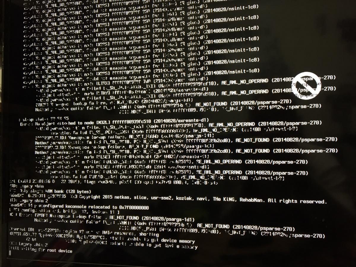

psydrug Posted March 1, 2017 Author Share Posted March 1, 2017 Thank you very much for answering I am sad today, does not work for me Still the same problem I still have hope that it will work? Thanks in advance Link to comment https://www.insanelymac.com/forum/topic/321545-some-problems-after-installing-the-sierra-on-ga-z170mx-gaming-5/#findComment-2375964 Share on other sites More sharing options...
MaLd0n Posted March 1, 2017 Share Posted March 1, 2017 u can try with Clover folder http://www.insanelymac.com/forum/index.php?app=core&module=attach§ion=attach&attach_id=221472 u use other, other fakesmc version etc try a fresh install, install Clover 4003 in UEFI mode and replace folder above Link to comment https://www.insanelymac.com/forum/topic/321545-some-problems-after-installing-the-sierra-on-ga-z170mx-gaming-5/#findComment-2375981 Share on other sites More sharing options...

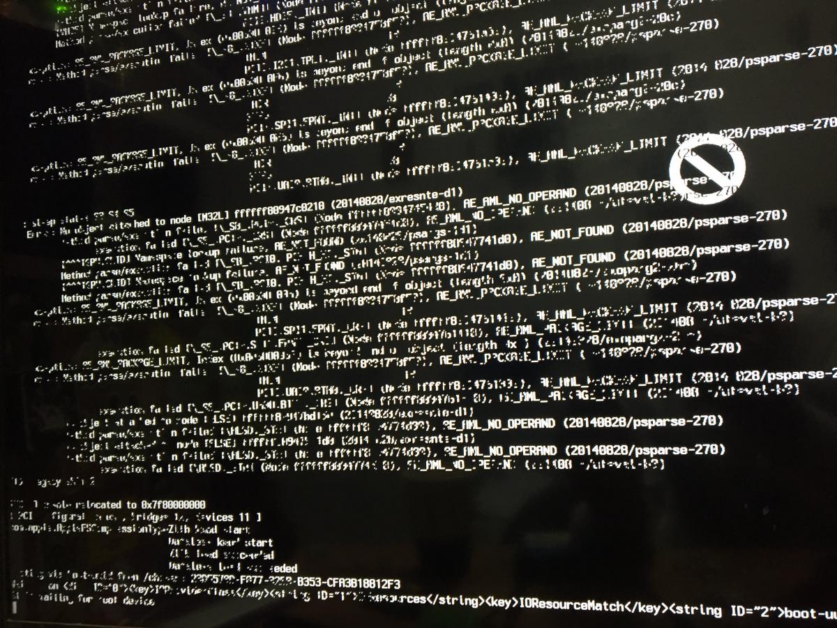

psydrug Posted March 1, 2017 Author Share Posted March 1, 2017 I did everything as you said I reinstalled the system I installed the clover And exchanged between folders Nothing helps Only boot from usb stick what could it be? Thanks in advance PsyDrug’s iMac.ioreg.zip Send me PsyDrug’s iMac.zip 1 Link to comment https://www.insanelymac.com/forum/topic/321545-some-problems-after-installing-the-sierra-on-ga-z170mx-gaming-5/#findComment-2375993 Share on other sites More sharing options...
MaLd0n Posted March 1, 2017 Share Posted March 1, 2017 send me ur Clover folder inside USB stick 1 Link to comment https://www.insanelymac.com/forum/topic/321545-some-problems-after-installing-the-sierra-on-ga-z170mx-gaming-5/#findComment-2376015 Share on other sites More sharing options...

MaLd0n Posted March 1, 2017 Share Posted March 1, 2017 Clover Clover_v2.4k_r4028.pkg.zip Folder CLOVER.zip Link to comment https://www.insanelymac.com/forum/topic/321545-some-problems-after-installing-the-sierra-on-ga-z170mx-gaming-5/#findComment-2376048 Share on other sites More sharing options...
