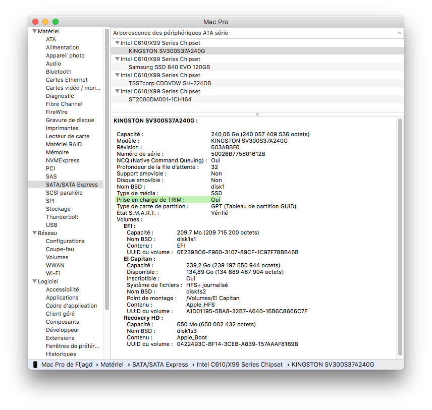

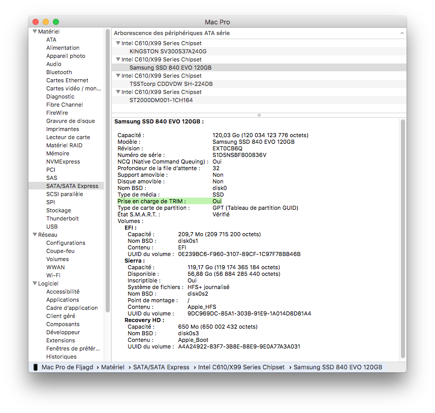

Sandokan7100 Posted December 17, 2016 Share Posted December 17, 2016 After the update, I found trim disabled on my SSD. So I had to run trimforce enable again... Does it happen for you too? Link to comment https://www.insanelymac.com/forum/topic/319193-macos-10122-avalaible-to-download/page/2/#findComment-2335665 Share on other sites More sharing options...

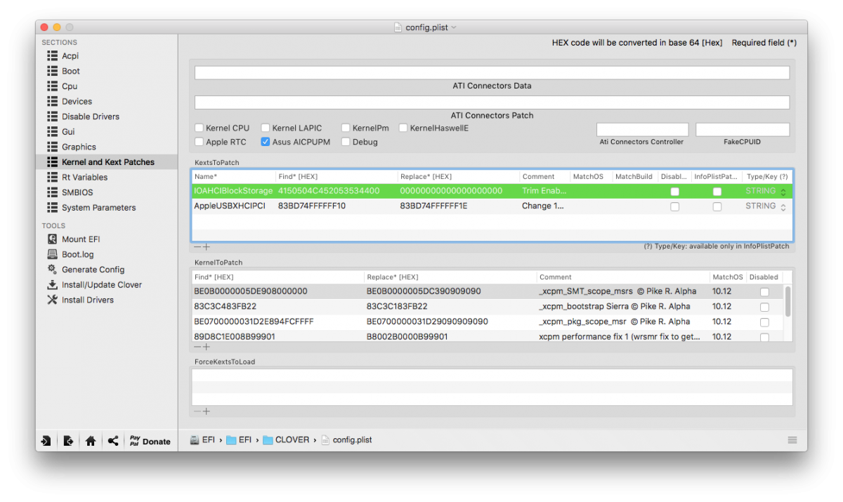

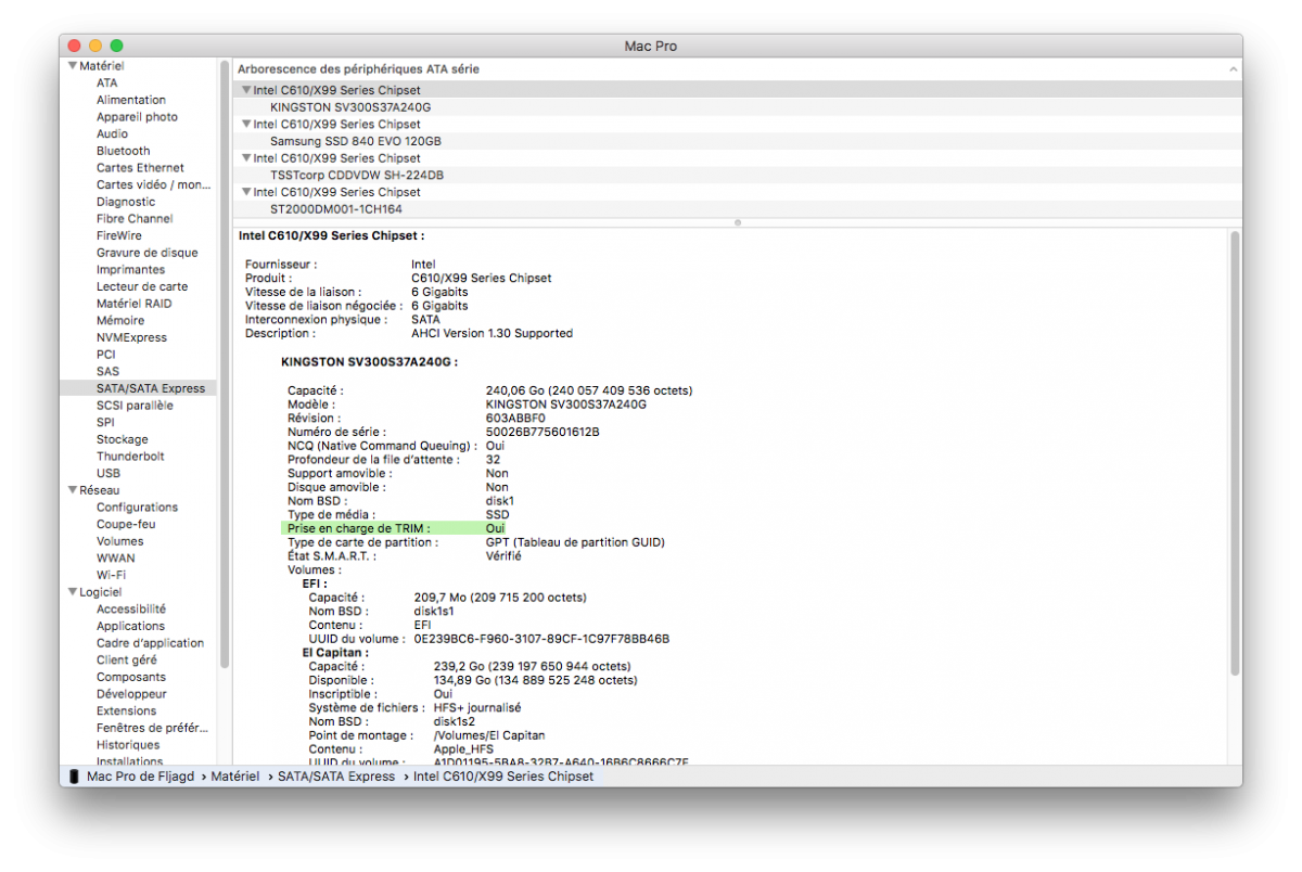

Fljagd Posted December 17, 2016 Share Posted December 17, 2016 trim is disabled on my SSD always even on 16C67 After the update, I found trim disabled on my SSD. So I had to run trimforce enable again... Does it happen for you too? To no longer be bored with the Trim, here is the patch I use in the config.plist 2 Link to comment https://www.insanelymac.com/forum/topic/319193-macos-10122-avalaible-to-download/page/2/#findComment-2335775 Share on other sites More sharing options...
Allan Posted December 17, 2016 Share Posted December 17, 2016 To no longer be bored with the Trim, here is the patch I use in the config.plist +1 1 Link to comment https://www.insanelymac.com/forum/topic/319193-macos-10122-avalaible-to-download/page/2/#findComment-2335784 Share on other sites More sharing options...

PMheart Posted December 18, 2016 Share Posted December 18, 2016 To no longer be bored with the Trim, here is the patch I use in the config.plist Why not add info properties... It's not suggested to patch binary files. PMheart Link to comment https://www.insanelymac.com/forum/topic/319193-macos-10122-avalaible-to-download/page/2/#findComment-2336316 Share on other sites More sharing options...
Fljagd Posted December 18, 2016 Share Posted December 18, 2016 Why not add info properties... It's not suggested to patch binary files. PMheart With the patche in config.plist Link to comment https://www.insanelymac.com/forum/topic/319193-macos-10122-avalaible-to-download/page/2/#findComment-2336349 Share on other sites More sharing options...
PMheart Posted December 18, 2016 Share Posted December 18, 2016 With the patche in config.plist Add properties will do the same thing. 1 Link to comment https://www.insanelymac.com/forum/topic/319193-macos-10122-avalaible-to-download/page/2/#findComment-2336355 Share on other sites More sharing options...
Fljagd Posted December 18, 2016 Share Posted December 18, 2016 Add properties will do the same thing. If I understand correctly, you're talking about the terminal command For me the advantage of the patch is that it does it automatically even after an update of the Os. The only restriction is that the patch can change with each major version Link to comment https://www.insanelymac.com/forum/topic/319193-macos-10122-avalaible-to-download/page/2/#findComment-2336370 Share on other sites More sharing options...
Fljagd Posted December 18, 2016 Share Posted December 18, 2016 Hi. Try to add Trim properties in FakeSMC if your AppleDataSetManagement has been broken... This is equal to `trimforce enable`. May check here for more details? (https://www.idelta.info/archives/how-os-x-open-the-gate-for-trim-on-3rd-party-ssd) PMheart In any case thank you for the information and the address, it is very informative. Friendly Link to comment https://www.insanelymac.com/forum/topic/319193-macos-10122-avalaible-to-download/page/2/#findComment-2336384 Share on other sites More sharing options...

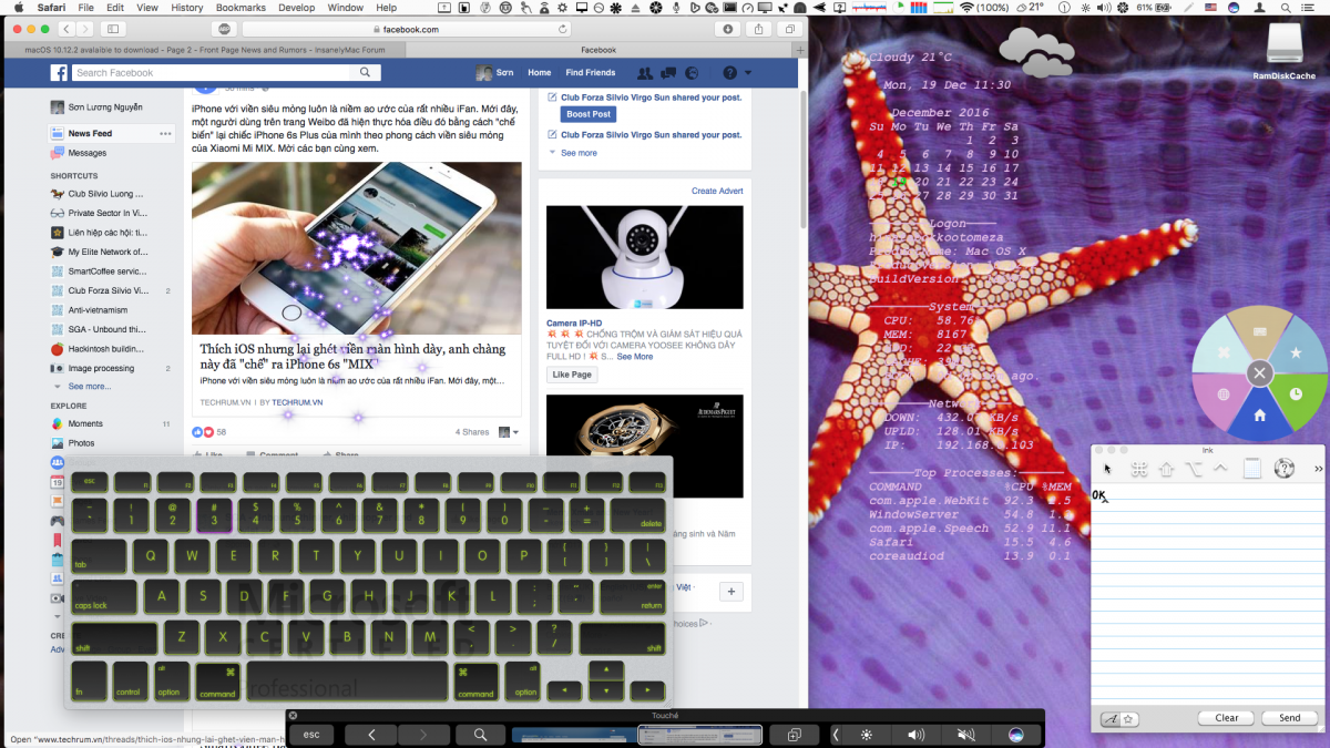

Lucy183 Posted December 18, 2016 Share Posted December 18, 2016 Anyone have lag scrolling on facebook or same sites? 1 Link to comment https://www.insanelymac.com/forum/topic/319193-macos-10122-avalaible-to-download/page/2/#findComment-2336450 Share on other sites More sharing options...
virgosun Posted December 19, 2016 Share Posted December 19, 2016 Anyone have lag scrolling on facebook or same sites? I have this. Use istats and discover that this is overall system lags, cpu using almost 100%. i3 5020u, 8gig, ssd 240g there is a thread at macrumors concerning sierra performance vs el capitan Link to comment https://www.insanelymac.com/forum/topic/319193-macos-10122-avalaible-to-download/page/2/#findComment-2336735 Share on other sites More sharing options...
virgosun Posted December 19, 2016 Share Posted December 19, 2016 Facebook is really the most slaggist site, even to an i7 xxxxHK, found this http://www.overclock.net/t/1617903/high-end-laptop-laggy-stuttery-driving-me-crazy Link to comment https://www.insanelymac.com/forum/topic/319193-macos-10122-avalaible-to-download/page/2/#findComment-2336846 Share on other sites More sharing options...

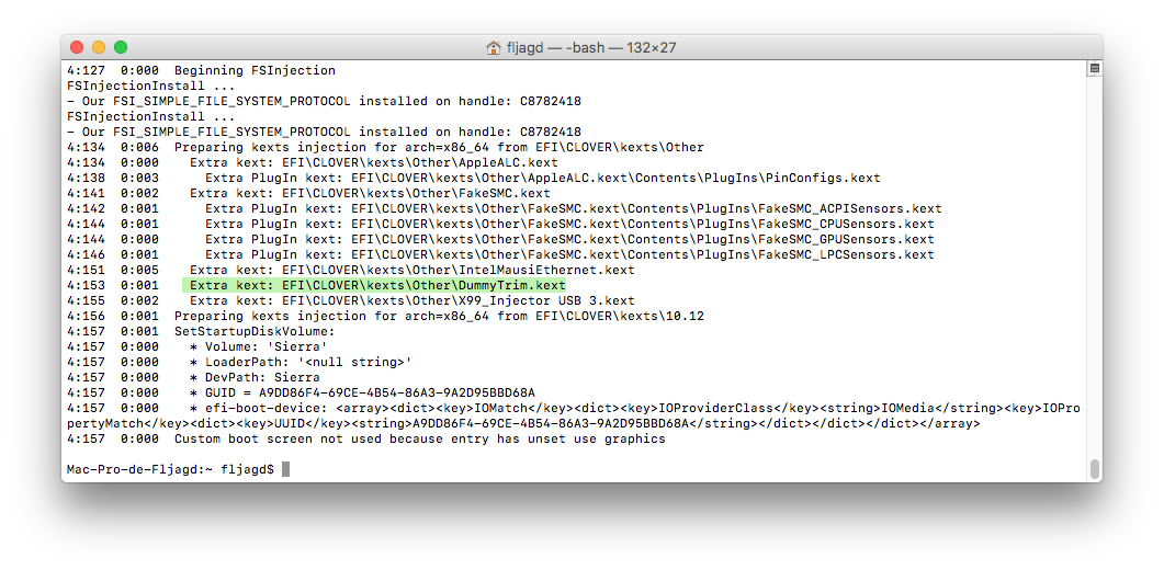

Fljagd Posted December 20, 2016 Share Posted December 20, 2016 So I made a fake kext to activate the trim, it works at home.No need for a patch in the config.plistFriendly DummyTrim.kext.zip 2 Link to comment https://www.insanelymac.com/forum/topic/319193-macos-10122-avalaible-to-download/page/2/#findComment-2337185 Share on other sites More sharing options...
virgosun Posted December 20, 2016 Share Posted December 20, 2016 Unfortunately Windows 10 is faster on same machine Link to comment https://www.insanelymac.com/forum/topic/319193-macos-10122-avalaible-to-download/page/2/#findComment-2337206 Share on other sites More sharing options...
virgosun Posted December 20, 2016 Share Posted December 20, 2016 So I made a fake kext to activate the trim, it works at home. No need for a patch in the config.plist Friendly I have downloaded the kext Does it activate trim if I sudo trimforce disavle ? Link to comment https://www.insanelymac.com/forum/topic/319193-macos-10122-avalaible-to-download/page/2/#findComment-2337230 Share on other sites More sharing options...
Fljagd Posted December 20, 2016 Share Posted December 20, 2016 (edited) I have downloaded the kext Does it activate trim if I sudo trimforce disavle ? I have not enabled Trimforce enable. It is all the interest of false kext, it is he who does it Edit: I only tried it on Sierra Edited December 20, 2016 by Fljagd 1 Link to comment https://www.insanelymac.com/forum/topic/319193-macos-10122-avalaible-to-download/page/2/#findComment-2337231 Share on other sites More sharing options...
virgosun Posted December 20, 2016 Share Posted December 20, 2016 I have not enabled Trimforce enable. It is all the interest of false kext, it is he who does it Edit: I only tried it on Sierra I used both config.plist patch and trimforce But now with your kext I disable other mothods and it works Thank you for your share. 1 Link to comment https://www.insanelymac.com/forum/topic/319193-macos-10122-avalaible-to-download/page/2/#findComment-2337249 Share on other sites More sharing options...
PMheart Posted December 21, 2016 Share Posted December 21, 2016 (edited) So I made a fake kext to activate the trim, it works at home. No need for a patch in the config.plist Friendly Yes. This is the same as adding info properties into FakeSMC. But anyway. Here is the FakeSMC with the Trim info properties. It works just like your dummy info injector/kext. FakeSMC-6.23.1417-SSD.zip I have not enabled Trimforce enable. It is all the interest of false kext, it is he who does it Edit: I only tried it on Sierra Your added info properties is equal to running `trimforce enable`. This can be used on Yosemite 10.10.4+. So. Must be compatible. Edited December 21, 2016 by PMheart 1 Link to comment https://www.insanelymac.com/forum/topic/319193-macos-10122-avalaible-to-download/page/2/#findComment-2337669 Share on other sites More sharing options...
