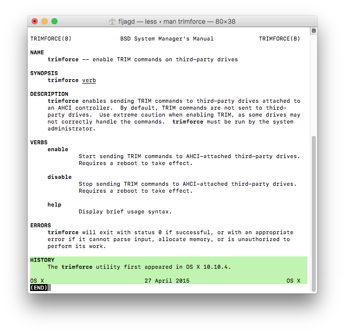

Fljagd Posted December 21, 2016 Share Posted December 21, 2016 (edited) Your added info properties is equal to running `trimforce force`. This can be used on Yosemite 10.10.4+. So. Must be compatible. Yes, I read man, and thank again edit: I think this kext can be considered a plugin of FakeSMC Edited December 21, 2016 by Fljagd 1 Link to comment https://www.insanelymac.com/forum/topic/319193-macos-10122-avalaible-to-download/page/3/#findComment-2337785 Share on other sites More sharing options...
PMheart Posted December 21, 2016 Share Posted December 21, 2016 Yes, I read man, and thank again Yes. This command line tool relies on the new IOAHCIBlockStorage.kext of 10.10.4+, and `trimforce` CLT also appears in 10.10.4 firstly. Yes, I read man, and thank again edit: I think this kext can be considered a plugin of FakeSMC Of course. But this is NOT a plugin of FakeSMC. Anyway you can put your dummy kext to FakeSMC.kext/C*/PlugIns if you like. Link to comment https://www.insanelymac.com/forum/topic/319193-macos-10122-avalaible-to-download/page/3/#findComment-2337786 Share on other sites More sharing options...
