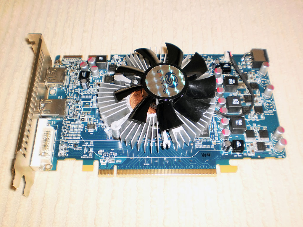

netgear Posted December 7, 2016 Share Posted December 7, 2016 Ho trovato nel cassetto questa 5750, mi pareva compatibile se non sbaglio, almeno in un lontano passato... Link to comment https://www.insanelymac.com/forum/topic/319017-ati-5750/ Share on other sites More sharing options...
Ciro82 Posted December 7, 2016 Share Posted December 7, 2016 Ho trovato nel cassetto questa 5750, mi pareva compatibile se non sbaglio, almeno in un lontano passato... Compatibile senza nessun accorgimento, inject ATI e fine Link to comment https://www.insanelymac.com/forum/topic/319017-ati-5750/#findComment-2330660 Share on other sites More sharing options...
netgear Posted December 7, 2016 Author Share Posted December 7, 2016 Ah ottimo Ciro , per le prestazioni desktop dovrebbe anche essere accettabile, sai mica se come alcune Nvidia si riesce ad uscire anche in VGA... Link to comment https://www.insanelymac.com/forum/topic/319017-ati-5750/#findComment-2330663 Share on other sites More sharing options...
AkimoA Posted December 7, 2016 Share Posted December 7, 2016 well it doesnt work with just ATI Inject ... u will have to add your device/vendor id in the IOPCIMatch Part of the Juniper Graphics Accelerator in the Info.plist inside the AMDRadeonX3000.kext and also in the AMD5000Controller.kext (right click kext-> Show Package Contents)( this method Works since 10.7-10.12.1 used it myself like that for years) after u edited them on the desktop reinstall them using Kext Utility set your ATI Inject in Clover config.plist to false ! reboot and enjoy Full Graphics. (it will assign the default Radeon Framebuffer which sometimes isnt the rite one for some people ) if this is the case u can set ATI Config= Vervet in Clover to have slightly better performance) also if you do it this way u would have to do it over again with the next update ... Binarie or Info.plist KextPatch via Clover would be an alternative for that . use google translate if things are unclear Link to comment https://www.insanelymac.com/forum/topic/319017-ati-5750/#findComment-2330682 Share on other sites More sharing options...
netgear Posted December 7, 2016 Author Share Posted December 7, 2016 Bene, grazie, in settimana vedo di provarla, non dovesse funzionare aggiungerò L'ID, o magari un Fake per emularne uno contemplato... Link to comment https://www.insanelymac.com/forum/topic/319017-ati-5750/#findComment-2330685 Share on other sites More sharing options...
AkimoA Posted December 7, 2016 Share Posted December 7, 2016 Prego sure fake id could also do the trick havent tried that one myself though Link to comment https://www.insanelymac.com/forum/topic/319017-ati-5750/#findComment-2330690 Share on other sites More sharing options...
netgear Posted December 7, 2016 Author Share Posted December 7, 2016 Oggi ho smontato la video, ripulita e fatto il cambio della pasta termica, fatto un oretta di Unigine sotto Windows, tutto a posto. Appena posso la testo su OS X, ho visto l'ID: 0x1002 0x68BE Se non dovesse funzionare provo il FakeID = 0x68B81002 Qualcuno consiglia anche (non so quale prende) framebuffer Vervet e port 3, ma la porta penso sia dipendente dall'uscita usata... Link to comment https://www.insanelymac.com/forum/topic/319017-ati-5750/#findComment-2330883 Share on other sites More sharing options...

netgear Posted December 9, 2016 Author Share Posted December 9, 2016 Allora sono su questa video, sistema SandyBridge, il mio scopo è quello di farla funzionare in VGA... Provato con o senza Fake, in entrambi i modi viene riconosciuta come 5750, ma la memoria non è allocata e manca l'accelerazione.. Framebuffer Vervet e Baboon, avevo letto che con Baboon la VGA funzionava. Non ho capito se il mio ID è supportato di default. Link to comment https://www.insanelymac.com/forum/topic/319017-ati-5750/#findComment-2331453 Share on other sites More sharing options...
gengik84 Posted December 9, 2016 Share Posted December 9, 2016 Quale ID? hai messo inject ali sul config? Link to comment https://www.insanelymac.com/forum/topic/319017-ati-5750/#findComment-2331498 Share on other sites More sharing options...
netgear Posted December 9, 2016 Author Share Posted December 9, 2016 Quello del post 7, ciao gengik, inject ati si l'ho messo, stavo provando vari FB, ma nulla per ora, di positivo e che si arriva sempre al desktop, ma le porte non ho capito se sono una variante o devo metterle. Con la VGA avrei 4 porte. http://www.insanelymac.com/forum/topic/231756-ati-hd5000-bootloader/ EDIT: La mia scheda non ha gli ID nei kext, appena controllato, procedo con gli ID nei medesimi invece del FAKE. Link to comment https://www.insanelymac.com/forum/topic/319017-ati-5750/#findComment-2331515 Share on other sites More sharing options...
netgear Posted December 9, 2016 Author Share Posted December 9, 2016 Iniettando i KEXT con Baboon è andato alla prima... Link to comment https://www.insanelymac.com/forum/topic/319017-ati-5750/#findComment-2331582 Share on other sites More sharing options...
netgear Posted December 9, 2016 Author Share Posted December 9, 2016 La cosa interessante e che a differenza di Nvidia non ci sono errori ACPI, il che mi fa pensare che AMD sotto certi aspetti sia più nel suo in questi sistemi, anche se io non ho molta simpatia per AMD con Hack, magari a torto eh... Avete mica un profilo AGPM da integrare nel mio sistema per la 5750, tanto per fare le cose per bene. In avvio ho l'immancabile strisciata colorata credo quando inietta il FB. A differenza del portatile dell'altro giorno su questo sistema 4 Gb sono veramente stretti, lavora molto di swap... Mi viene in mente che forse il FakeID non mi funzionava per la mancanza di FixDisplay in ACPI... Link to comment https://www.insanelymac.com/forum/topic/319017-ati-5750/#findComment-2331614 Share on other sites More sharing options...
netgear Posted December 9, 2016 Author Share Posted December 9, 2016 Confermo era quello, ora il Fake funziona. Pure AGPM, che gioiellino, sto uscendo in VGA in sostanza con la sola iniezione ed il Fake... Lo Stop è perfetto. Jolly ti chiedo un piacere quando puoi, ti allego DSDT pulito + config + patch per questa scheda di Olarila. Se mi puoi aggiungere oltre a queste i FIX ACPI diciamo quelli standard, io vado già con questa configurazione e volevo aggiungere quello che mancava al DSDT, l'audio c'è già, poi vedi te . Chiedo a te in primis come il più navigato in fatto di DSDT... Link to comment https://www.insanelymac.com/forum/topic/319017-ati-5750/#findComment-2331651 Share on other sites More sharing options...
