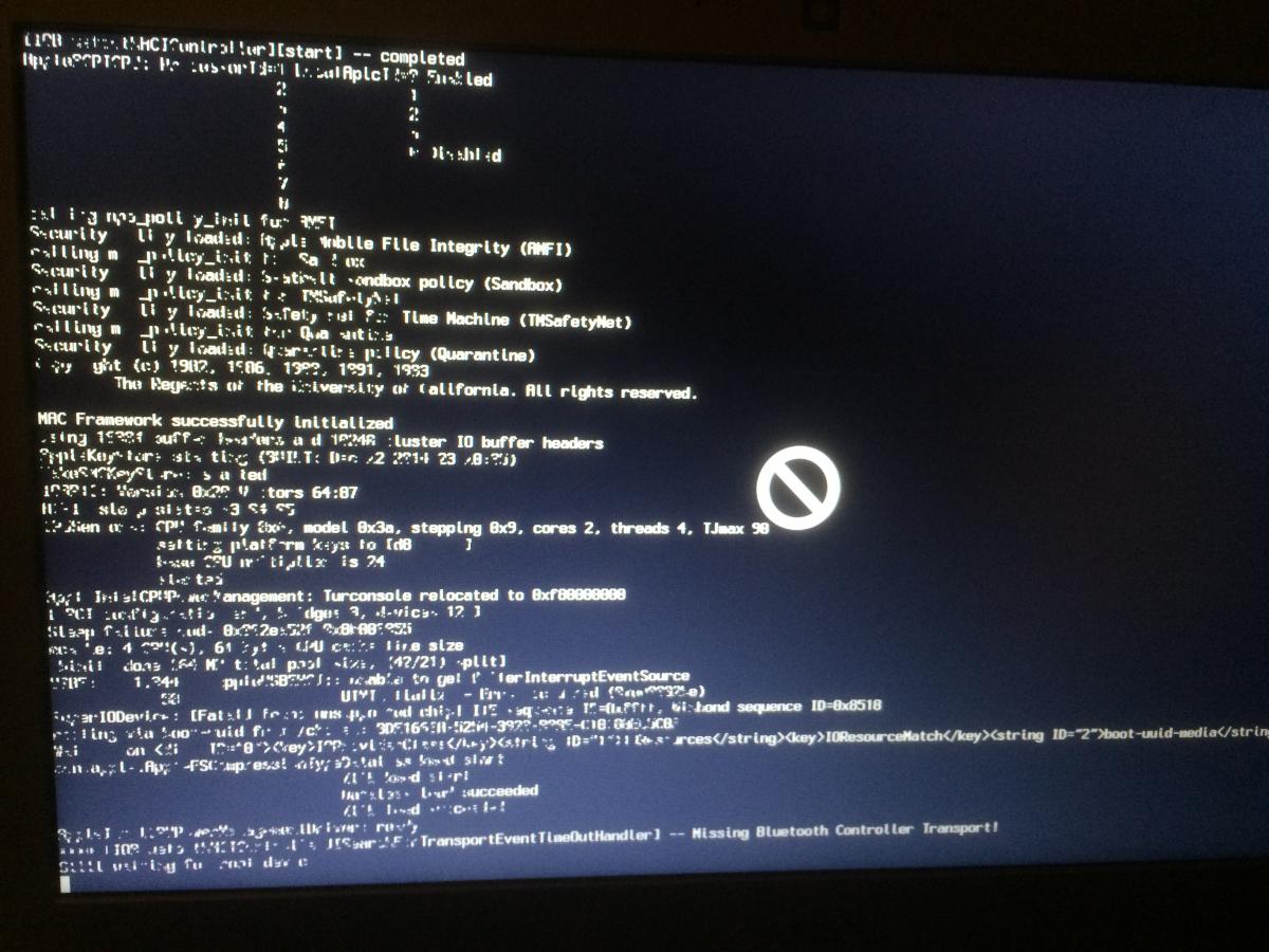

Tricchi Posted November 23, 2016 Share Posted November 23, 2016 Ho provato ad installare Yosemite su Notebook Dell Vostro 3460 con le seguenti caratteristiche: Intel I3, 4gb ram, hd 120 ssd. Ho seguito la guida di gengik84: http://www.insanelymac.com/forum/topic/306828-guida-installazione-os-x-101x-clover-usb/?do=findComment&comment=2148378 Ecco la schermata che mi appare: Dopo questa schermata si riavvia. Link to comment https://www.insanelymac.com/forum/topic/318293-yosemite-su-dell-vostro-3460/ Share on other sites More sharing options...

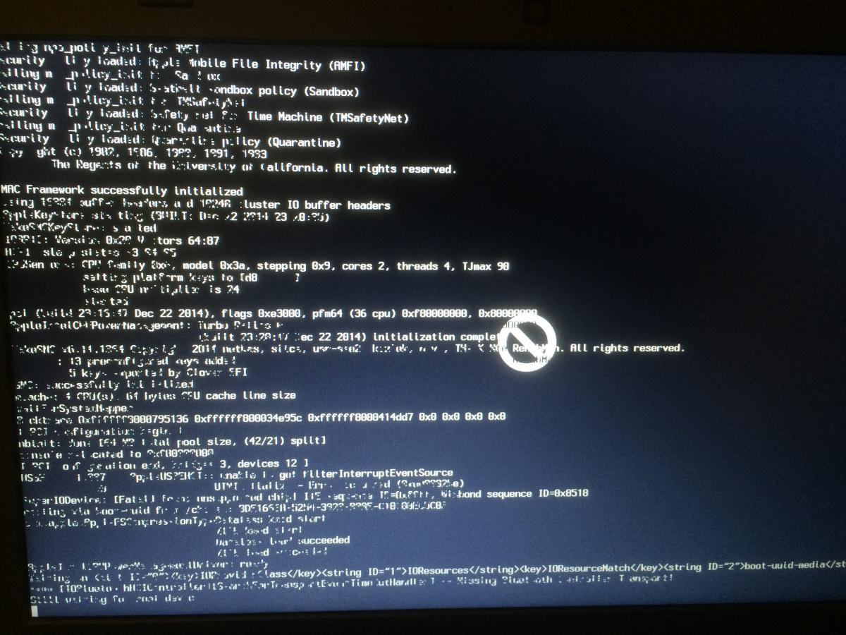

Tricchi Posted November 23, 2016 Author Share Posted November 23, 2016 Ho fatto le variazioni che mi hai indicato. Adesso sono apparse queste schermate: dopo di che vedo scorrere il cursore di una riga in basso ogni minuto circa. Link to comment https://www.insanelymac.com/forum/topic/318293-yosemite-su-dell-vostro-3460/#findComment-2323685 Share on other sites More sharing options...
gengik84 Posted November 23, 2016 Share Posted November 23, 2016 metti inject intel Sul bios disabilita Vt-d Link to comment https://www.insanelymac.com/forum/topic/318293-yosemite-su-dell-vostro-3460/#findComment-2323688 Share on other sites More sharing options...
Tricchi Posted November 23, 2016 Author Share Posted November 23, 2016 metti inject intel Sul bios disabilita Vt-d Nel bios dove trovo Vt-d? Io in Advanced vedo "Virtualization", per caso è questo? In che sezione si trova "inject intel"? Link to comment https://www.insanelymac.com/forum/topic/318293-yosemite-su-dell-vostro-3460/#findComment-2323694 Share on other sites More sharing options...
gengik84 Posted November 23, 2016 Share Posted November 23, 2016 graphics.. poi basterebbe cercare/guardare.... Link to comment https://www.insanelymac.com/forum/topic/318293-yosemite-su-dell-vostro-3460/#findComment-2323695 Share on other sites More sharing options...

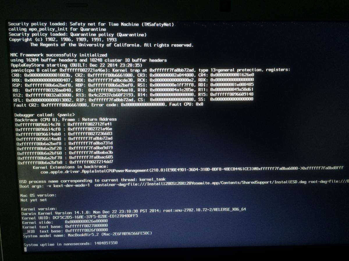

Tricchi Posted November 23, 2016 Author Share Posted November 23, 2016 graphics.. poi basterebbe cercare/guardare.... Hai ragione, scusa. E dire che l'avevo anche guardati tutti!! Ho fatto quanto mi hai detto ma continua ad apparire la seguente schermata: attachment=206627:IMG_0541.jpg] Link to comment https://www.insanelymac.com/forum/topic/318293-yosemite-su-dell-vostro-3460/#findComment-2323703 Share on other sites More sharing options...
gengik84 Posted November 23, 2016 Share Posted November 23, 2016 su ig-platform-id aggiungi 0x01660003 Disabilita tutti i fix acpi sia old che new way nella sezione boot aggiungi dart=0 Link to comment https://www.insanelymac.com/forum/topic/318293-yosemite-su-dell-vostro-3460/#findComment-2323710 Share on other sites More sharing options...

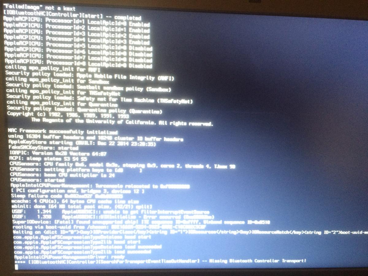

Tricchi Posted November 24, 2016 Author Share Posted November 24, 2016 Ho provato a cambiare tutte le porte USB ma non cambia nulla. Compare sempre il simbolo di divieto al centro, i caratteri non si vedono più bene e non va più avanti. Link to comment https://www.insanelymac.com/forum/topic/318293-yosemite-su-dell-vostro-3460/#findComment-2324100 Share on other sites More sharing options...
Tricchi Posted November 24, 2016 Author Share Posted November 24, 2016 Ho letto che alla fine appare: "Still waiting for root device" Link to comment https://www.insanelymac.com/forum/topic/318293-yosemite-su-dell-vostro-3460/#findComment-2324222 Share on other sites More sharing options...
