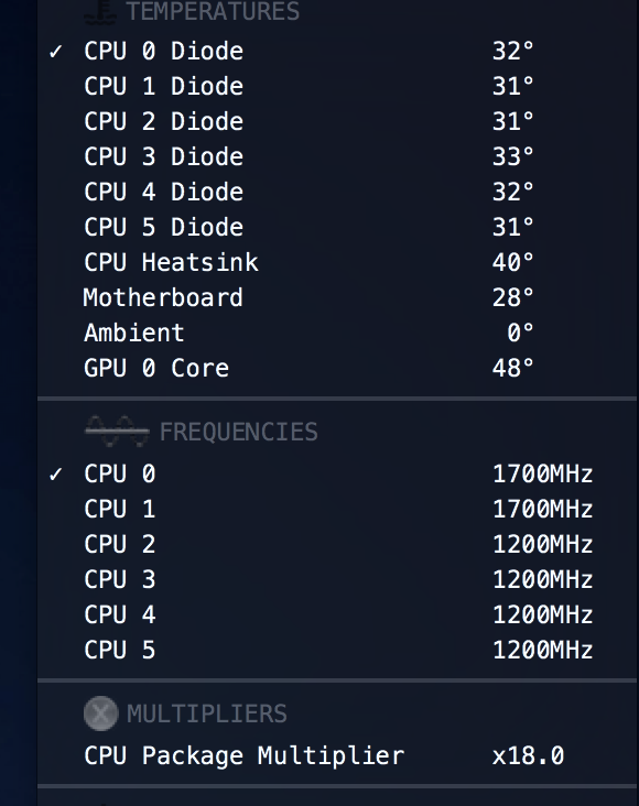

Matthew82 Posted November 23, 2016 Share Posted November 23, 2016 I change kext in EFI folder Only one gpu temp is showing Boot with CLOVERX64.efi-3943 dmsg.zip debug.log.zip Link to comment https://www.insanelymac.com/forum/topic/317915-clover-test-and-patches-for-polaris-gpu/page/5/#findComment-2323620 Share on other sites More sharing options...
Slice Posted November 23, 2016 Share Posted November 23, 2016 I change kext in EFI folder Only one gpu temp is showing Zrzut ekranu 2016-11-23 o 16.14.26.png Boot with CLOVERX64.efi-3943 Yes, it is probably a lack of functionality. I am not sure if RadeonMonitor can look three cards. Anyway I see no messages from him. Give me full system.log. It is large but I hope to see messages like "RadeonMonitor:..." Link to comment https://www.insanelymac.com/forum/topic/317915-clover-test-and-patches-for-polaris-gpu/page/5/#findComment-2323680 Share on other sites More sharing options...

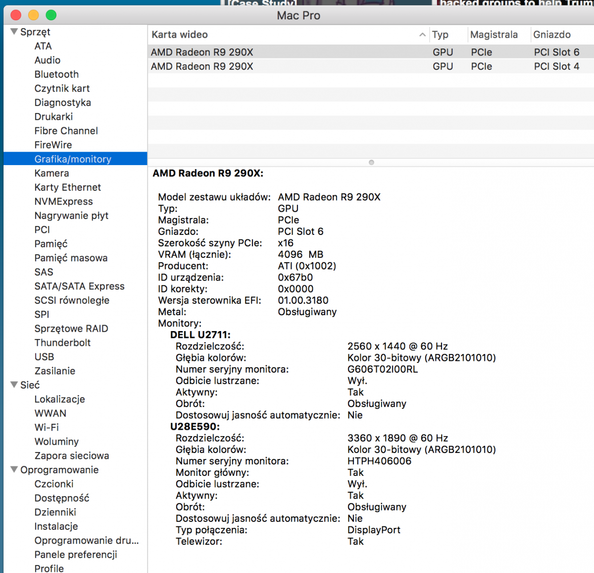

Matthew82 Posted December 14, 2016 Share Posted December 14, 2016 I was able to to boot MacOS only with R9290X. Thanks to Okrasit (http://www.insanelymac.com/forum/topic/313977-r9-nano/?p=2333976) Just insert fake PCI ID to videoROM and save it to GPU. I attach boots.log and IO.reg. I hope this will help to find good and more comfortable solution for "BlackScreen" Mateusz’s Mac Pro.zip debug.log.zip 2 Link to comment https://www.insanelymac.com/forum/topic/317915-clover-test-and-patches-for-polaris-gpu/page/5/#findComment-2334128 Share on other sites More sharing options...
