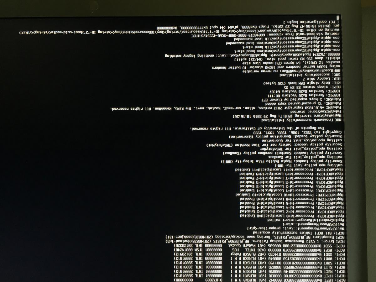

Now, the problem is, this build right now, which is going to be mainly work, refuses to pass the first 3-5 lines of coding, which hangs at ++++++++ (plus signs).
I believe that is related to CPUID, since, maybe, this one is not supported out of the box, but, can't find any info on this.
I've tried multiple things, and install methods (uefi vs legacy, kext replacement as per various guides and posts, and nothing seems to work), but, i'll try everything again if posted.
The only thing that seems to take me further, is chaging cpuid, but hangs with something that i cannot see (the pause button doesn't seem to work).

With that i can pass the first error, only to be stuck at another:
Config.plist attached, and only diference is the use of 0x0306e4 in cpuid (wich i didn't put on config.plist)

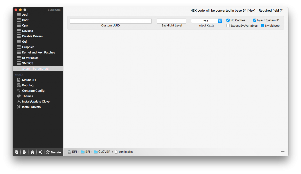

That being said, nvda_drv=1 does not work in Sierra, you have to use System Paramers -> [check] NvidiaWeb (use clover configurator as in the image attached)

So, if you can boot with nv_disable=1, what you need to do is, boot that way, install nVidia Web Drivers (latest ones), enable Nvidia web drivers, DON'T RESTART YET, apply the AGDPfix.app, and then reboot.
This time, boot without nv_disable=1, but with the parameter that is in the screenshot. Also, test with only one monitor first (it gives me reboots if I use anything other then DVI+DVI.).

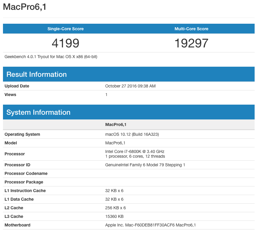

EDIT:
her his my benchmark with 14.1 smbios
https://drive.google.com/file/d/0B6AS3GlgY7ZFNUFPalU2YWs5QzQ/view?usp=sharing
