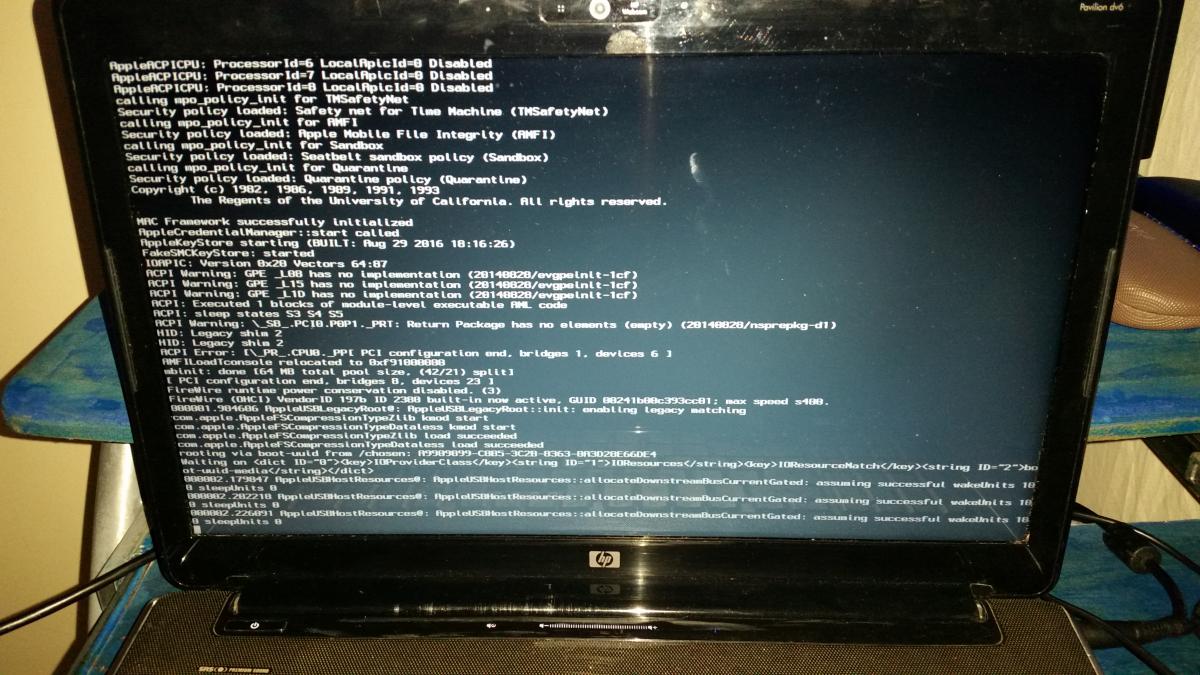

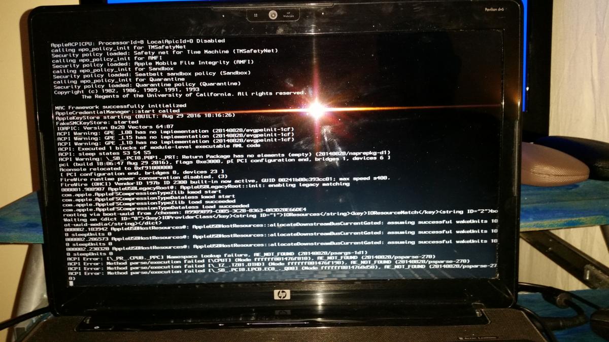

PumpkenPie Posted October 16, 2016 Share Posted October 16, 2016 Hi,I have been having this error for weeks but I don't really know what to do since this is my first time installing a OS X os on a pc (actually a laptop).Every time I boot up the installation I end up with the error but with different numbers all the time.This is probably not working because the laptop is quite old. And probably because of how much ram it has.Model=dv6-2105Intel i5 processor Arrandale4gb ramClover bootloaderNvidea geforce G105M Quote Link to comment https://www.insanelymac.com/forum/topic/316902-stuck-on-system-uptime-in-nanoseconds-booting-to-installation/ Share on other sites More sharing options...
SavageAUS Posted October 17, 2016 Share Posted October 17, 2016 Please post config.plist or EFI folder, emit themes if excessive, Quote Link to comment https://www.insanelymac.com/forum/topic/316902-stuck-on-system-uptime-in-nanoseconds-booting-to-installation/#findComment-2301157 Share on other sites More sharing options...
dbdb Posted October 17, 2016 Share Posted October 17, 2016 Make sure FakeSMC.kext is being applied. I don't think the standard Clover install does this automatically. Quote Link to comment https://www.insanelymac.com/forum/topic/316902-stuck-on-system-uptime-in-nanoseconds-booting-to-installation/#findComment-2301184 Share on other sites More sharing options...
The_Village_Idiot Posted October 17, 2016 Share Posted October 17, 2016 Make sure FakeSMC.kext is being applied. I don't think the standard Clover install does this automatically. i think he already has fakesmc as shown in the screen. he can try booting with cpus=1 -v Quote Link to comment https://www.insanelymac.com/forum/topic/316902-stuck-on-system-uptime-in-nanoseconds-booting-to-installation/#findComment-2301202 Share on other sites More sharing options...

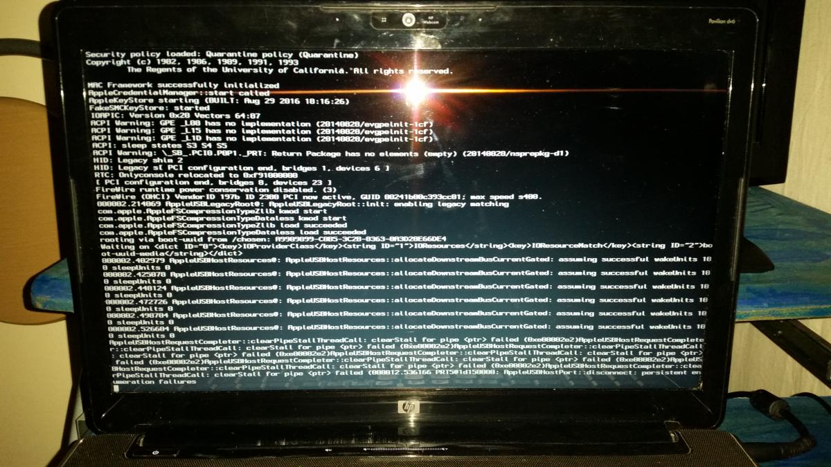

PumpkenPie Posted October 25, 2016 Author Share Posted October 25, 2016 Sadly I got the same error... Quote Link to comment https://www.insanelymac.com/forum/topic/316902-stuck-on-system-uptime-in-nanoseconds-booting-to-installation/#findComment-2306097 Share on other sites More sharing options...
PumpkenPie Posted October 29, 2016 Author Share Posted October 29, 2016 hello we don't support tony's methods .. maybe ur problems come from there and by the way .. what u say about dsdt is a no sense .. read about clover .. clover bible https://clover-wiki.zetam.org/Home VERY IMPORTANT: PLEASE READ! (ABOUT TONYMACX86 AND iATKOS M / Y) Why InsanelyMac does not support tonymacx86 Making a 10.10/10.11 USB Installer /w Clover (UEFI and Legacy) the correct way! read .. good hack Hey artiur i have dropped the oem ssdt i am also using pandora's box this time but as i said it came with the same error I have attached my config.plist config.zip Error after dropping em ssdt Quote Link to comment https://www.insanelymac.com/forum/topic/316902-stuck-on-system-uptime-in-nanoseconds-booting-to-installation/#findComment-2309140 Share on other sites More sharing options...

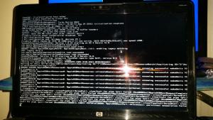

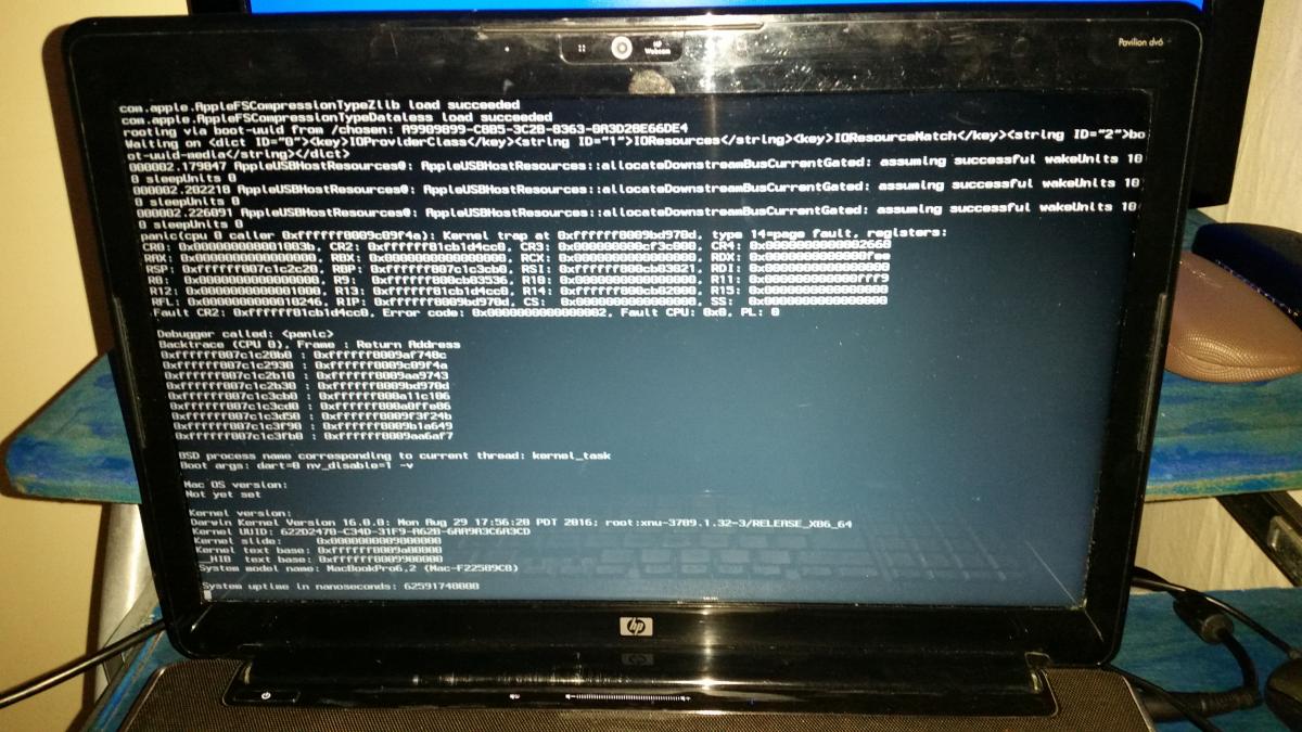

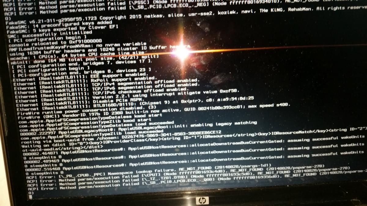

PumpkenPie Posted October 30, 2016 Author Share Posted October 30, 2016 hello try this setup EFI.zip if no go post photo again good hack Hey i tried the efi folder, it came with these errors after i booting it up twice First error: Second error: Quote Link to comment https://www.insanelymac.com/forum/topic/316902-stuck-on-system-uptime-in-nanoseconds-booting-to-installation/#findComment-2309821 Share on other sites More sharing options...
artur_pt Posted October 30, 2016 Share Posted October 30, 2016 hello in clover GUI extract ur ACPI tables (dsdt e ssdt) after upload to be patched .. If you were able to start Clover somehow, you can enter its GUI and press F4. If Clover was installed on a FAT32 partition, then it will be able to save all ORM ACPI tables, including DSDT and FADT. The process can take a while, especially when saving many tables to a USB flash drive. https://clover-wiki.zetam.org/Fixing-DSDT good hack Quote Link to comment https://www.insanelymac.com/forum/topic/316902-stuck-on-system-uptime-in-nanoseconds-booting-to-installation/#findComment-2309866 Share on other sites More sharing options...

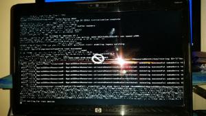

PumpkenPie Posted October 31, 2016 Author Share Posted October 31, 2016 hello try this one in /clover/acpi/patched DSDT.aml.zip good hack It came up with a new error after patching the dsdt It ends with "waiting for root device" When I checked the dsdt in dsdt editor apparently there is two errors in dsdt. Should I fix it? Quote Link to comment https://www.insanelymac.com/forum/topic/316902-stuck-on-system-uptime-in-nanoseconds-booting-to-installation/#findComment-2310913 Share on other sites More sharing options...
artur_pt Posted October 31, 2016 Share Posted October 31, 2016 hello check if u have ahci enable on bios .. really don't have any more ideas good hack Quote Link to comment https://www.insanelymac.com/forum/topic/316902-stuck-on-system-uptime-in-nanoseconds-booting-to-installation/#findComment-2310918 Share on other sites More sharing options...

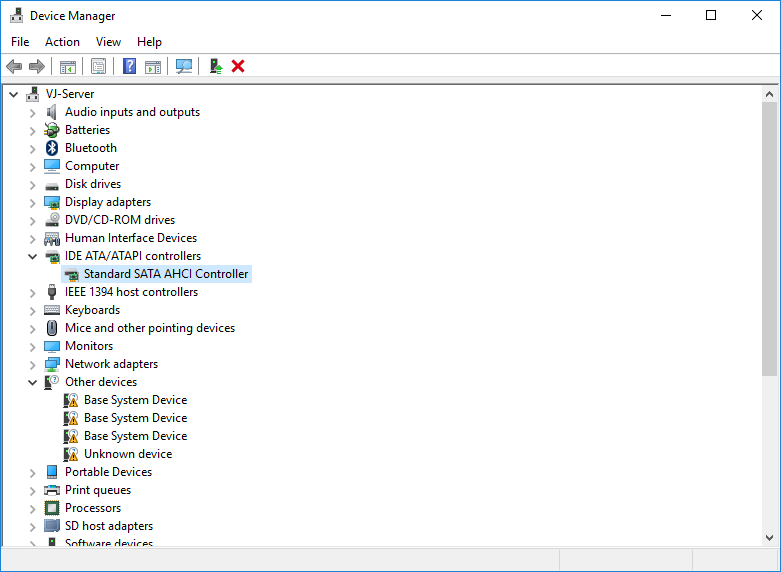

PumpkenPie Posted October 31, 2016 Author Share Posted October 31, 2016 hello check if u have ahci enable on bios .. really don't have any more ideas good hack does this mean anything? Quote Link to comment https://www.insanelymac.com/forum/topic/316902-stuck-on-system-uptime-in-nanoseconds-booting-to-installation/#findComment-2311141 Share on other sites More sharing options...
artur_pt Posted October 31, 2016 Share Posted October 31, 2016 hello is not what i ask to u ? is that enable in bios just see u have several unknown devices .. even in windows .. maybe someone else have a idea about ur hardware good hack Quote Link to comment https://www.insanelymac.com/forum/topic/316902-stuck-on-system-uptime-in-nanoseconds-booting-to-installation/#findComment-2311183 Share on other sites More sharing options...
PumpkenPie Posted October 31, 2016 Author Share Posted October 31, 2016 hello is not what i ask to u ? is that enable in bios just see u have several unknown devices .. even in windows .. maybe someone else have a idea about ur hardware good hack it is enabled in the bios... the errors in Windows are because i have not installed my computer drivers since this is a fresh install of Windows 10 pro i found a person called niknod but can't seem to contact him.. http://www.insanelymac.com/forum/topic/268528-dsdt/ Quote Link to comment https://www.insanelymac.com/forum/topic/316902-stuck-on-system-uptime-in-nanoseconds-booting-to-installation/#findComment-2311257 Share on other sites More sharing options...
