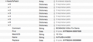

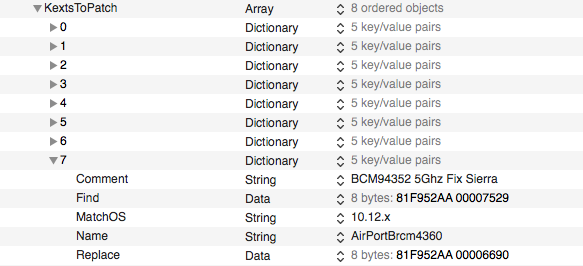

epazotl Posted October 10, 2016 Share Posted October 10, 2016 Wifi not working on all new hardware. Wifi card on the board replaced with BCM 94352Z while building. I know wifi works because I got it to work in an ubuntu live cd. I followed this guide: https://rossfisher.me/2016/05/how-to-bcm94352z-for-hackintosh-including-5ghz-patch-handoff-and-hotspot/ (sidenote), in EFI/Clover/Kexts I don't have a 10.12 folder. I also tried adding this kexts to Other and creating a 10.12 folder and adding to them, since they weren't working in the 10.11 folder. In KextViewr, the kexts in the EFI folder do not appear to be loading at all. Any tips? (Yes, I've seen http://www.insanelymac.com/forum/topic/312759-fix-macos-sierra-dp1-bcm94532z-wifi/ Edit: now working after setting the cache not to load in clover. Is there any downside to leaving it like that? Link to comment https://www.insanelymac.com/forum/topic/316687-wifi-not-working-with-bcm94352z-on-fresh-sierra-install/ Share on other sites More sharing options...
artur_pt Posted October 10, 2016 Share Posted October 10, 2016 hello the post here is not to messy with any kext .. is to patch the kext on fly .. in the cache .. should read again and carefully the post from darkvoid here about ur other problems .. what u tell a mess .. should read a bit more about clover and is config.plist clover bible https://clover-wiki.zetam.org/Contents and must apply something like this good hack Link to comment https://www.insanelymac.com/forum/topic/316687-wifi-not-working-with-bcm94352z-on-fresh-sierra-install/#findComment-2297235 Share on other sites More sharing options...
