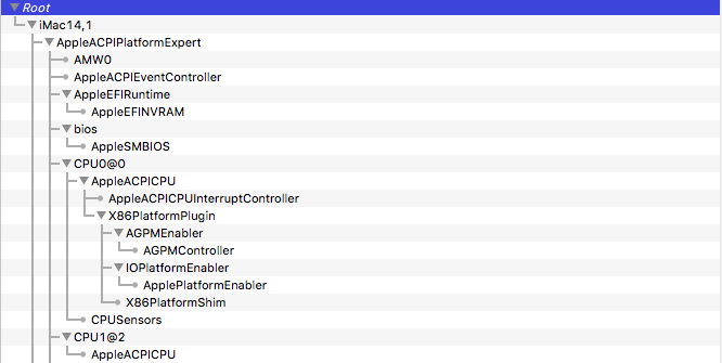

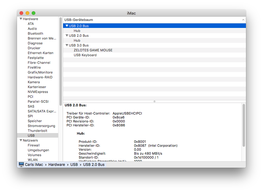

Allan Posted September 3, 2016 Share Posted September 3, 2016 Set this in your UEFI/BIOS: Advanced\USB Configuration Legacy USB Support > Enabled Intel xHCI Mode > Auto EHCI Hand-off > Enabled Do you have any USB devices other than keyboard/mouse? Do you have any PCI devices or add-in cards other than your video card? You have the shutdown function working properly? Link to comment https://www.insanelymac.com/forum/topic/314850-maximus-vii-ranger-sleep-wake-issue/page/2/#findComment-2273259 Share on other sites More sharing options...
Thogg Niatiz Posted September 3, 2016 Author Share Posted September 3, 2016 Check, everything set. Still no success... I had a Microsoft Webcam connected, but for now I'm just running my peripherals: I have no PCI extensions, not even a dedicated GPU, just the iGPU of my 4790K. How do I check if it works properly? Seems ok to me... Link to comment https://www.insanelymac.com/forum/topic/314850-maximus-vii-ranger-sleep-wake-issue/page/2/#findComment-2273403 Share on other sites More sharing options...
Allan Posted September 3, 2016 Share Posted September 3, 2016 How do I check if it works properly? Seems ok to me... When you shut down your Hack, all coolers are off, motherboard leds off, video etc... Link to comment https://www.insanelymac.com/forum/topic/314850-maximus-vii-ranger-sleep-wake-issue/page/2/#findComment-2273527 Share on other sites More sharing options...
Thogg Niatiz Posted September 3, 2016 Author Share Posted September 3, 2016 Yeah, that works alright... Link to comment https://www.insanelymac.com/forum/topic/314850-maximus-vii-ranger-sleep-wake-issue/page/2/#findComment-2273529 Share on other sites More sharing options...

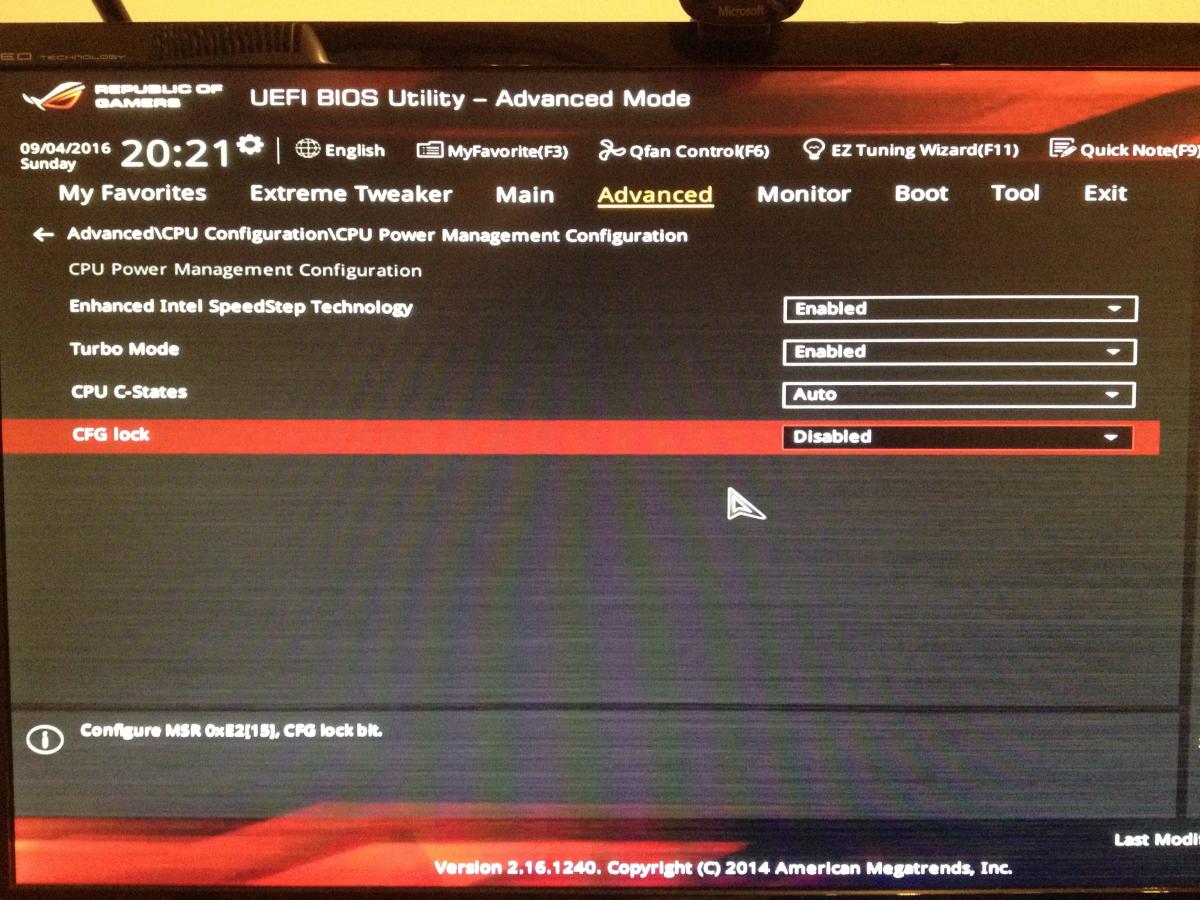

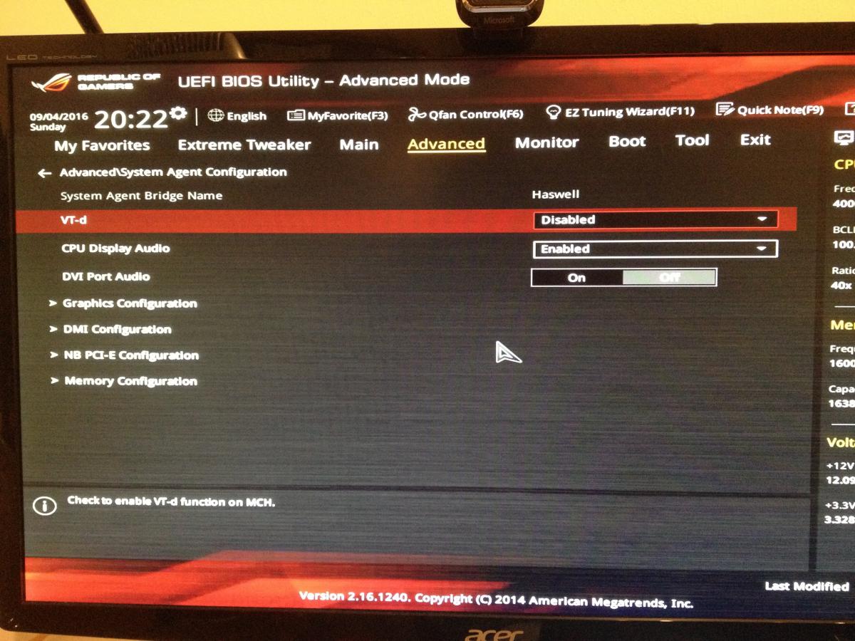

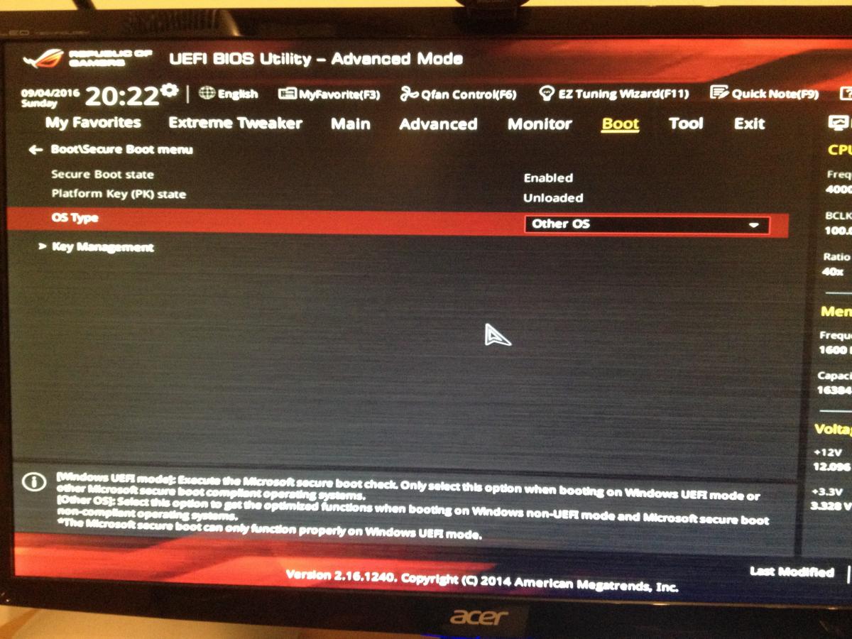

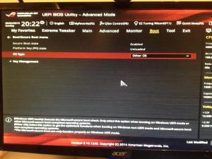

Allan Posted September 4, 2016 Share Posted September 4, 2016 Hmm, I don't have these problems with Sleep, this Q-Code is like Windows blue screen In BIOS/UEFI did you disable VT-d, and set SecureBoot as OtherOS? Look with you have this option too: Advanced -> CPU Configuration -> CPU Power Management Configuration -> CFG-Lock: Disabled Link to comment https://www.insanelymac.com/forum/topic/314850-maximus-vii-ranger-sleep-wake-issue/page/2/#findComment-2273983 Share on other sites More sharing options...
Thogg Niatiz Posted September 4, 2016 Author Share Posted September 4, 2016 Interesting, that's really bad... All set, system wouldn't boot Clover if not. I also checked my RAM, sometimes S3 errors are connected to RAM failure. But no, RAM is fine in both single and dual channel Link to comment https://www.insanelymac.com/forum/topic/314850-maximus-vii-ranger-sleep-wake-issue/page/2/#findComment-2273994 Share on other sites More sharing options...
