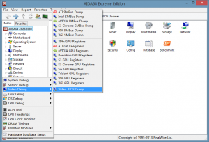

spakk Posted September 4, 2016 Share Posted September 4, 2016 the best way to find the installed version of your video.rom ==> start Windows OS and install AIDA64 then export the video.rom File and the hardware report. Link to comment https://www.insanelymac.com/forum/topic/314811-system-dies-at-login-screen-before-actual-login/page/3/#findComment-2273697 Share on other sites More sharing options...
ylluxiun Posted September 4, 2016 Author Share Posted September 4, 2016 I've gotten the report (attached here) from that for you, but I don't see an option in AIDA to export the video rom. Am I missing it somewhere? Link to comment https://www.insanelymac.com/forum/topic/314811-system-dies-at-login-screen-before-actual-login/page/3/#findComment-2273707 Share on other sites More sharing options...

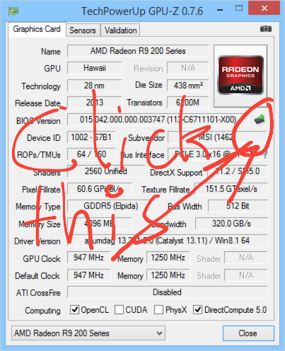

spakk Posted September 4, 2016 Share Posted September 4, 2016 Then use GPU-Z Link to comment https://www.insanelymac.com/forum/topic/314811-system-dies-at-login-screen-before-actual-login/page/3/#findComment-2273749 Share on other sites More sharing options...
ylluxiun Posted September 4, 2016 Author Share Posted September 4, 2016 Well I had no problem with GPU-Z (here's the bios from it), but AIDA is not presenting the option you're showing; I apparently have a newer version of AIDA here than what you're using and I wonder if they've removed the option or if they've changed it to a new area of the application. Link to comment https://www.insanelymac.com/forum/topic/314811-system-dies-at-login-screen-before-actual-login/page/3/#findComment-2273833 Share on other sites More sharing options...
