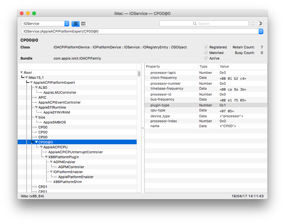

daleski75 Posted April 18, 2017 Author Share Posted April 18, 2017 More tweaking over the weekend... Removed ALL kext patches for the HD530 Removed InjectIntel from clover Removed the ig-platform-id Down clocked back to 4.0Ghz as this was making the CPU run at full speed all the time Verified that X86PlatformPlugin is loaded upon boot Get my 1050 TI today (could not wait) so this should fix the last remaining issues with sleep/wake 1 Link to comment https://www.insanelymac.com/forum/topic/313071-asus-z170p-sierra-almost-perfect-but-not-quite/#findComment-2406404 Share on other sites More sharing options...

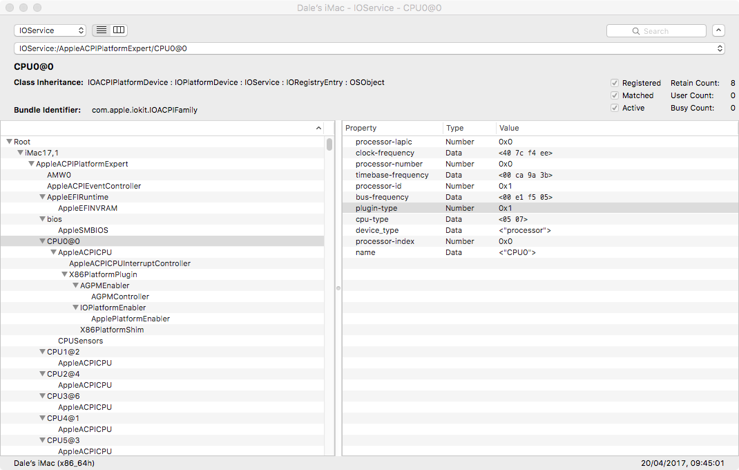

daleski75 Posted April 19, 2017 Author Share Posted April 19, 2017 Removed a couple of SSDT edits for power management and also removed the SSDT.aml generated by ssdtPRgen and power management still works and XF86PlatformPlugin is still working. Just got 2 remaining issues to fix with HWMonitor not reporting the GPU clock speed nor CPU speed. Intel power management widget reports fine even though HWMonitor repots it's running only at 800 or 4000mhz 1 Link to comment https://www.insanelymac.com/forum/topic/313071-asus-z170p-sierra-almost-perfect-but-not-quite/#findComment-2407541 Share on other sites More sharing options...

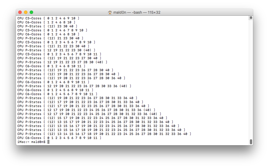

MaLd0n Posted April 19, 2017 Share Posted April 19, 2017 for check if u have good PM, use AppleIntelInfo.kext By Pike and look at ur ioreg too 1 Link to comment https://www.insanelymac.com/forum/topic/313071-asus-z170p-sierra-almost-perfect-but-not-quite/#findComment-2407568 Share on other sites More sharing options...

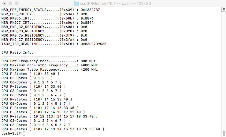

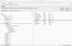

daleski75 Posted April 20, 2017 Author Share Posted April 20, 2017 for check if u have good PM, use AppleIntelInfo.kext By Pike 01.png and look at ur ioreg too 02.png This is how mine looks (nowhere near as many c/p states as yours with and without my SSDT.aml Without the DSDT edits X86PlatformPlugin is always loaded. Double checked this is with no ssdt patches for power management. Thought I would attach the whole lot as a zip file including clover, all patches etc for anyone to have a look at who is way more knowledgeable than me. iMac.zip Link to comment https://www.insanelymac.com/forum/topic/313071-asus-z170p-sierra-almost-perfect-but-not-quite/#findComment-2408024 Share on other sites More sharing options...

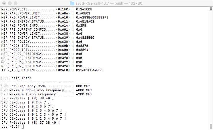

daleski75 Posted April 23, 2017 Author Share Posted April 23, 2017 With the help of @MaLd0n I have got everything working much better in my quest for perfection on my hackintosh. I have now sorted out all of the USB ports and got only the ones connected to be seen by the hackintosh so no further need to raise the port limit. Power Nap is still bugging me as well as WOL but I won't give up until these are fixed. 1 Link to comment https://www.insanelymac.com/forum/topic/313071-asus-z170p-sierra-almost-perfect-but-not-quite/#findComment-2410328 Share on other sites More sharing options...
daleski75 Posted April 23, 2017 Author Share Posted April 23, 2017 Powermanagement looking a bit better now CPU Ratio Info: ------------------------------------ CPU Low Frequency Mode.............: 800 MHz CPU Maximum non-Turbo Frequency....: 4000 MHz CPU Maximum Turbo Frequency........: 4200 MHz CPU P-States [ 38 (40) ] CPU C3-Cores [ 1 2 4 6 ] CPU C6-Cores [ 1 2 3 5 6 7 ] CPU P-States [ (8) 26 38 40 ] CPU C3-Cores [ 0 1 2 4 5 6 ] CPU C6-Cores [ 0 1 2 3 5 6 7 ] CPU P-States [ 8 23 26 38 (40) ] CPU C3-Cores [ 0 1 2 4 5 6 7 ] CPU P-States [ (8) 23 25 26 38 40 ] CPU C6-Cores [ 0 1 2 3 4 5 6 7 ] CPU P-States [ 8 20 23 25 26 38 (40) ] CPU P-States [ 8 20 23 25 26 34 38 (40) ] CPU C3-Cores [ 0 1 2 3 4 5 6 7 ] CPU P-States [ 8 20 23 25 26 30 34 38 (40) ] CPU P-States [ 8 20 23 25 26 27 30 34 38 (40) ] CPU P-States [ 8 20 23 25 26 27 30 34 37 38 (40) ] CPU P-States [ (8) 18 20 23 25 26 27 30 34 37 38 40 ] CPU P-States [ (8) 18 20 23 24 25 26 27 30 34 37 38 40 ] CPU P-States [ 8 18 20 22 23 24 25 26 27 30 34 37 38 (40) ] CPU P-States [ (8) 18 20 21 22 23 24 25 26 27 30 34 37 38 40 ] CPU P-States [ (8) 18 20 21 22 23 24 25 26 27 30 32 34 37 38 40 ] CPU P-States [ (8) 18 20 21 22 23 24 25 26 27 30 32 34 36 37 38 40 ] CPU P-States [ (8) 16 18 20 21 22 23 24 25 26 27 30 32 34 36 37 38 40 ] CPU P-States [ (8) 16 18 20 21 22 23 24 25 26 27 30 32 33 34 36 37 38 40 ] CPU P-States [ (8) 16 18 20 21 22 23 24 25 26 27 30 32 33 34 35 36 37 38 40 ] CPU P-States [ 8 16 18 20 21 22 23 24 25 26 27 30 32 33 34 35 36 37 38 39 (40) ] CPU P-States [ (8) 14 16 18 20 21 22 23 24 25 26 27 30 32 33 34 35 36 37 38 39 40 ] CPU P-States [ (8) 14 16 17 18 20 21 22 23 24 25 26 27 30 32 33 34 35 36 37 38 39 40 ] CPU P-States [ (8) 14 15 16 17 18 20 21 22 23 24 25 26 27 30 32 33 34 35 36 37 38 39 40 ] CPU P-States [ (8) 14 15 16 17 18 19 20 21 22 23 24 25 26 27 30 32 33 34 35 36 37 38 39 40 ] CPU P-States [ (8) 13 14 15 16 17 18 19 20 21 22 23 24 25 26 27 30 32 33 34 35 36 37 38 39 40 ] CPU P-States [ (8) 12 13 14 15 16 17 18 19 20 21 22 23 24 25 26 27 30 32 33 34 35 36 37 38 39 40 ] CPU P-States [ (8) 12 13 14 15 16 17 18 19 20 21 22 23 24 25 26 27 28 30 32 33 34 35 36 37 38 39 40 ] CPU P-States [ (8) 12 13 14 15 16 17 18 19 20 21 22 23 24 25 26 27 28 29 30 32 33 34 35 36 37 38 39 40 ] CPU P-States [ (8) 11 12 13 14 15 16 17 18 19 20 21 22 23 24 25 26 27 28 29 30 32 33 34 35 36 37 38 39 40 ] CPU P-States [ (8) 11 12 13 14 15 16 17 18 19 20 21 22 23 24 25 26 27 28 29 30 31 32 33 34 35 36 37 38 39 40 ] CPU P-States [ 8 11 12 13 14 15 16 17 18 19 20 21 22 23 24 25 26 27 28 29 30 31 32 33 34 35 36 37 38 39 40 (42) ] CPU P-States [ (8) 10 11 12 13 14 15 16 17 18 19 20 21 22 23 24 25 26 27 28 29 30 31 32 33 34 35 36 37 38 39 40 42 ] CPU P-States [ 8 10 11 12 13 14 15 16 17 18 19 20 21 22 23 24 25 26 27 28 29 30 31 32 33 34 35 36 37 38 39 (40) 41 42 ] Link to comment https://www.insanelymac.com/forum/topic/313071-asus-z170p-sierra-almost-perfect-but-not-quite/#findComment-2410403 Share on other sites More sharing options...
