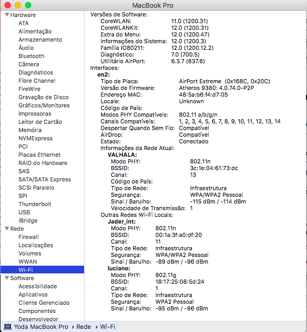

jalves Posted May 16, 2017 Share Posted May 16, 2017 (edited) Confirmed on 10.12.5 vanilla + id changing(on the vanilla plist) + Clover KextToPatch (AR9565.plist). QCA9565 1608c,36 Finding networks and stable (for now) -------- New, 10.12.5 vanilla + Clover KextToPath (AR9565.plist) http://www.insanelymac.com/forum/topic/312045-atheros-wireless-driver-os-x-101112-for-unsupported-cards/?p=2414859 + KextToPath change pci-id <dict> <key>Comment</key> <string>Change pci168c,30 to pci168c,36</string> <key>Disabled</key> <false/> <key>Find</key> <data>PHN0cmluZz5wY2kxNjhjLDMwPC9zdHJpbmc+</data> <key>InfoPlistPatch</key> <true/> <key>MatchOS</key> <string>10.12.x</string> <key>Name</key> <string>com.apple.driver.AirPort.Atheros40</string> <key>Replace</key> <data>PHN0cmluZz5wY2kxNjhjLDM2PC9zdHJpbmc+</data> </dict> Edited May 16, 2017 by jalves 1 Link to comment https://www.insanelymac.com/forum/topic/312045-atheros-wireless-driver-os-x-101112-for-unsupported-cards/page/8/#findComment-2424408 Share on other sites More sharing options...
