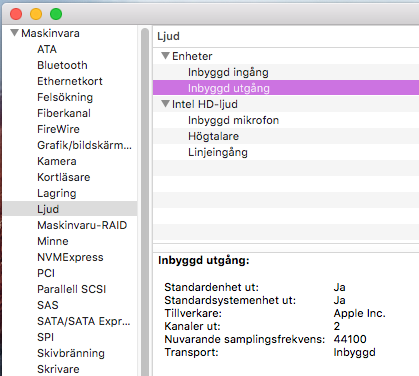

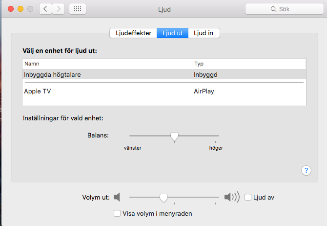

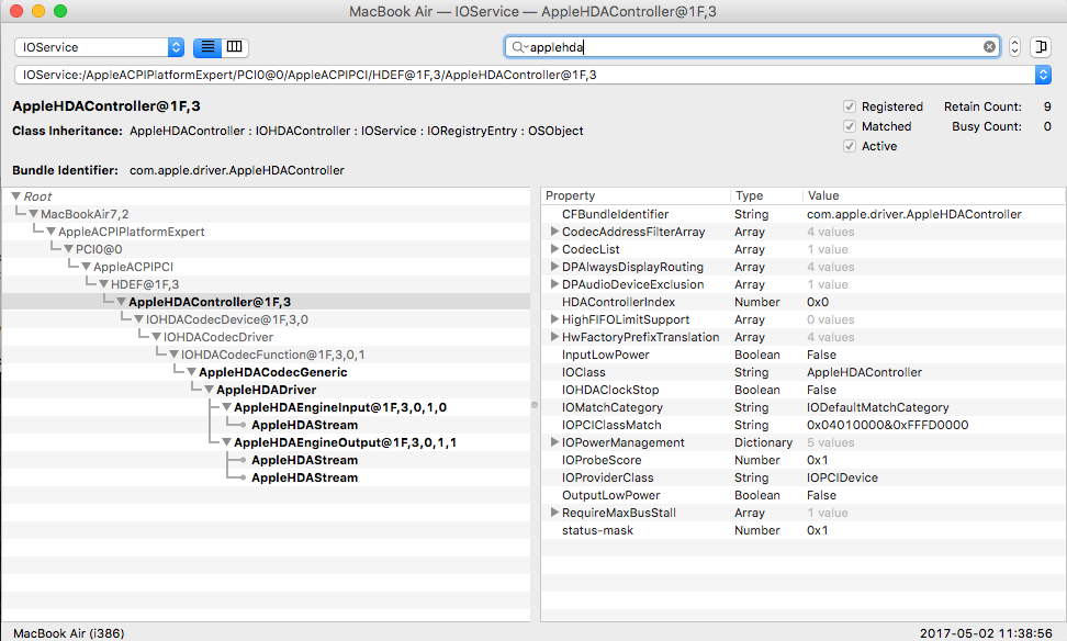

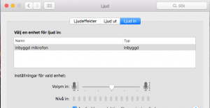

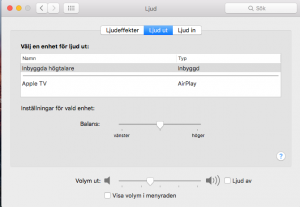

dronefriend Posted May 2, 2017 Share Posted May 2, 2017 I have a strange problem. Running a patch I made using Mirones AppleHDA patcher. It uses vanilla AppleHDA and aDummyHDA, and Clover patches. I have codec ALC236. The result is the same with the patched unsigned AppleHDA kext. Volume and mute keys affect sound levels when I press them. I have units in System Report: I have mic in Syspref-Sound in. It doesn't work though. I have units in Syspref-Sound Out: And IOReg looks good to me: But no sound gets out. No system sounds. iTunes cannot play anything. I have rebuilt caches and rebooted. It behaves like this all the time, not just after sleep. No videos play at all, probably because the computer senses audio is not outputted correctly. So I plan to follow a guide and fix it. Is there anyone who might know where to start? What is the problem? Is it the codec verbs clover patches? Is it something in Layout ID .zml or is it Platforms.zml? Something else that might help me? Some part of the patch is working since AppleHDA loads. I think maybe there is not a lot left to do. I have tried AppleALC and Lilu with LayoutID 11 which is correct for my codec (ALC236 rev 2) but it won't work unfortunately. Same result but Mute button won't do anything. So this solution is a little closer. Running 11.6 on Kaby Lake, Lenovo Ideapad 710s. Codec: Realtek Generic Address: 0 AFG Function Id: 0x1 (unsol 1) Vendor Id: 0x10ec0236 Subsystem Id: 0x17aa389a Revision Id: 0x100002 Thanks for any help Link to comment https://www.insanelymac.com/forum/topic/311293-applealc-%E2%80%94-dynamic-applehda-patching/page/60/#findComment-2415908 Share on other sites More sharing options...
vusun123 Posted May 2, 2017 Share Posted May 2, 2017 I have a strange problem. Running a patch I made using Mirones AppleHDA patcher. It uses vanilla AppleHDA and aDummyHDA, and Clover patches. I have codec ALC236. The result is the same with the patched unsigned AppleHDA kext. Volume and mute keys affect sound levels when I press them. I have units in System Report: Skärmavbild 2017-05-02 kl. 11.38.09.png I have mic in Syspref-Sound in. It doesn't work though. Skärmavbild 2017-05-02 kl. 11.38.34.png I have units in Syspref-Sound Out: Skärmavbild 2017-05-02 kl. 11.38.42.png And IOReg looks good to me: Skärmavbild 2017-05-02 kl. 11.39.05.png But no sound gets out. No system sounds. iTunes cannot play anything. I have rebuilt caches and rebooted. It behaves like this all the time, not just after sleep. No videos play at all, probably because the computer senses audio is not outputted correctly. So I plan to follow a guide and fix it. Is there anyone who might know where to start? What is the problem? Is it the codec verbs clover patches? Is it something in Layout ID .zml or is it Platforms.zml? Something else that might help me? Some part of the patch is working since AppleHDA loads. I think maybe there is not a lot left to do. I have tried AppleALC and Lilu with LayoutID 11 which is correct for my codec (ALC236 rev 2) but it won't work unfortunately. Same result but Mute button won't do anything. So this solution is a little closer. Running 11.6 on Kaby Lake, Lenovo Ideapad 710s. Codec: Realtek Generic Address: 0 AFG Function Id: 0x1 (unsol 1) Vendor Id: 0x10ec0236 Subsystem Id: 0x17aa389a Revision Id: 0x100002 Thanks for any help Dump your audio codec in linux and do inbox, I will do the work 2 Link to comment https://www.insanelymac.com/forum/topic/311293-applealc-%E2%80%94-dynamic-applehda-patching/page/60/#findComment-2415915 Share on other sites More sharing options...
dronefriend Posted May 2, 2017 Share Posted May 2, 2017 Dump your audio codec in linux and do inbox, I will do the work Will do! Let me know if there is anything else you need. Thanks!! Link to comment https://www.insanelymac.com/forum/topic/311293-applealc-%E2%80%94-dynamic-applehda-patching/page/60/#findComment-2415935 Share on other sites More sharing options...

dronefriend Posted May 3, 2017 Share Posted May 3, 2017 Give me the specific name for this Clevo laptop so I will try to add support to it. There are tons of Clevo laptops out there and I have seen one using ALC892 (same as MSI laptops) Use this AppleALC with layout 28, do install with the newest Lilu.kext Many thanks! Installed AppleALC to SLE with Lilu. Took away old Clover KextToPatches. Changed LayoutID to 28. Deleted old aDummyHDA.kext The result is similiar to the old solution, but now the microphone works. I also have one more option in System Report-> Audio, "Headphones", which wasn't available before. Volume and mute keys work after inserting headphones too, but still no audio out. The volume keys react very slowly though. I don't know if this has anything to do with the AppleHDA.kext though. Link to comment https://www.insanelymac.com/forum/topic/311293-applealc-%E2%80%94-dynamic-applehda-patching/page/60/#findComment-2416613 Share on other sites More sharing options...
vusun123 Posted May 3, 2017 Share Posted May 3, 2017 Many thanks! Installed AppleALC to SLE with Lilu. Took away old Clover KextToPatches. Changed LayoutID to 28. Deleted old aDummyHDA.kext The result is similiar to the old solution, but now the microphone works. I also have one more option in System Report-> Audio, "Headphones", which wasn't available before. Volume and mute keys work after inserting headphones too, but still no audio out. The volume keys react very slowly though. I don't know if this has anything to do with the AppleHDA.kext though. Do install vanilla AppleHDA and vanilla IOAudioFamily.kext; I suspect the problem lies in combining both headphones and internal speaker into one entry, so when I get home I will make another AppleALC that splits the entries for you Edit: do you have CodecCommander.kext in your SLE ? Put your laptop spec in your signature so I can see more to it 1 Link to comment https://www.insanelymac.com/forum/topic/311293-applealc-%E2%80%94-dynamic-applehda-patching/page/60/#findComment-2416616 Share on other sites More sharing options...

dronefriend Posted May 3, 2017 Share Posted May 3, 2017 @dronefriend use the below CodecCommander first ( still keep the first AppleALC.kext I sent you earlier ), check if you have any outputs working. If no install the AppleALC.kext I provided here, it will split the 2 entries for Headphones and Internal Speaker @Foxic use the AppleALC below with newest Lilu.kext, use layout ID 28. Please install vanilla IOAudioFamily and AppleHDA.kext, remove any aDummyHDA.kext or VoodooHDA.kext or AppleHDADisabler.kext if you are using them I installed the CodecCommander you provided. Gave same result, no audio out. Installed new AppleALC. Still no audio out. Changes in sys pref -> audio and ioreg shows it's properly loaded I think: If it is of any help, there is a patched AppleHDA that worked partially for me. Mirone made it. The problem was the audio was glitchy and poppy, and disappeared every other second. But there was audio out, can it provide any clue to the problem? It was this one: AppleHDA.kext.zip Link to comment https://www.insanelymac.com/forum/topic/311293-applealc-%E2%80%94-dynamic-applehda-patching/page/60/#findComment-2416761 Share on other sites More sharing options...

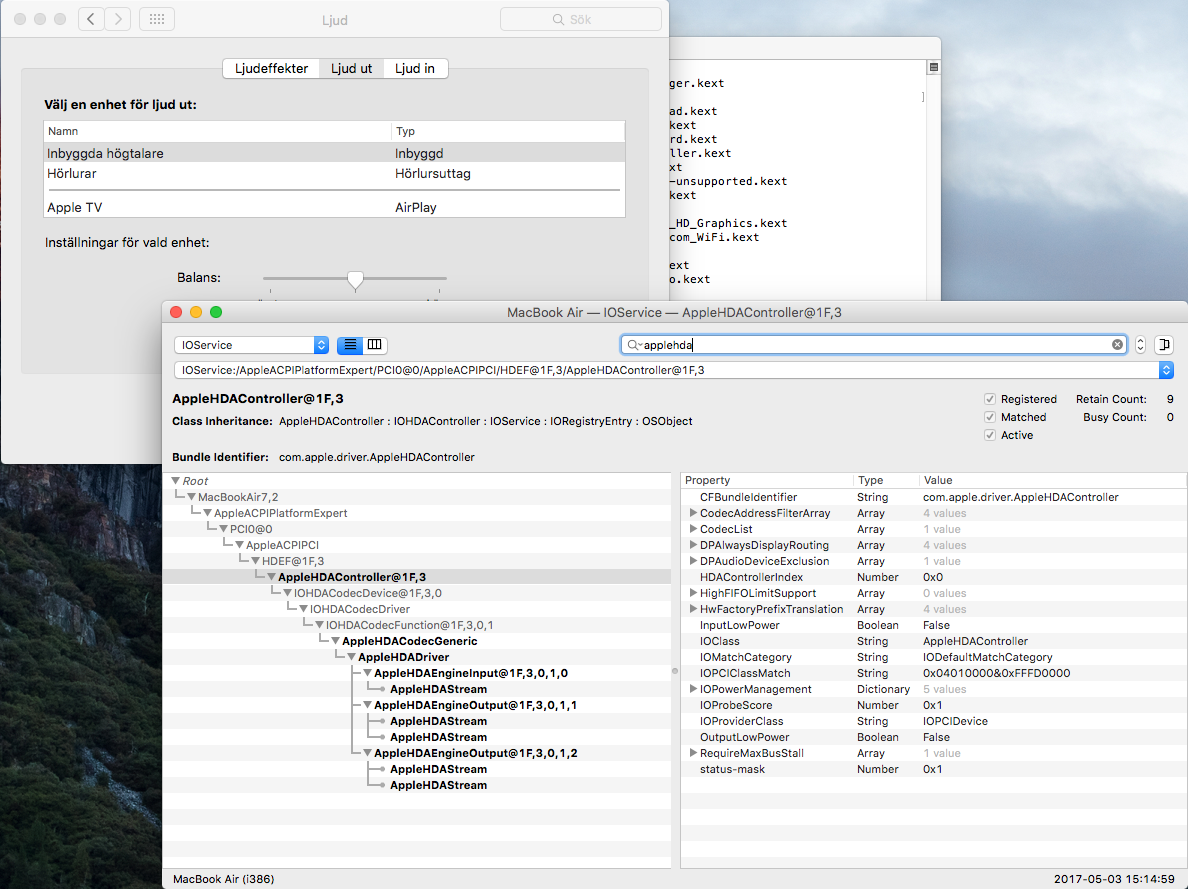

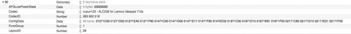

vusun123 Posted May 3, 2017 Share Posted May 3, 2017 I installed the CodecCommander you provided. Gave same result, no audio out. Installed new AppleALC. Still no audio out. Changes in sys pref -> audio and ioreg shows it's properly loaded I think: Skärmavbild 2017-05-03 kl. 15.14.52.png If it is of any help, there is a patched AppleHDA that worked partially for me. Mirone made it. The problem was the audio was glitchy and poppy, and disappeared every other second. But there was audio out, can it provide any clue to the problem? It was this one: AppleHDA.kext.zip If you have UseARTFrequency=True enabled in your config.plist, remove it. It is known to interfere with Skylake/Kabylake audio Link to comment https://www.insanelymac.com/forum/topic/311293-applealc-%E2%80%94-dynamic-applehda-patching/page/60/#findComment-2416766 Share on other sites More sharing options...
dronefriend Posted May 3, 2017 Share Posted May 3, 2017 If you have UseARTFrequency=True enabled in your config.plist, remove it. It is known to interfere with Skylake/Kabylake audio I do not. Attached /Clover/. AppleALC and Lilu is installed to SLE. vusun123.zip Why is it my computer is so tricky? Link to comment https://www.insanelymac.com/forum/topic/311293-applealc-%E2%80%94-dynamic-applehda-patching/page/60/#findComment-2416782 Share on other sites More sharing options...
