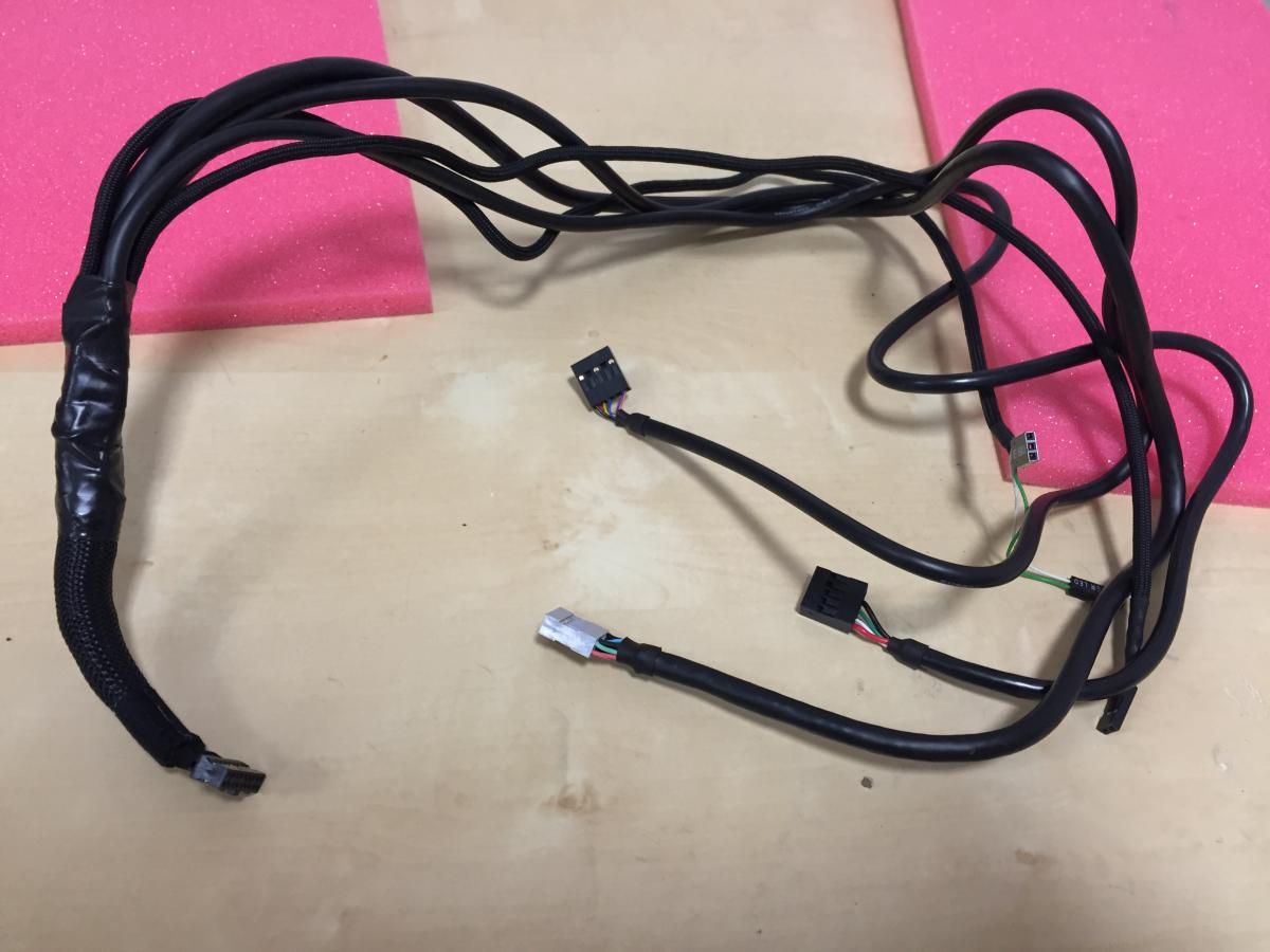

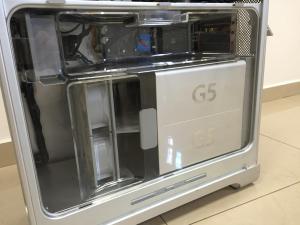

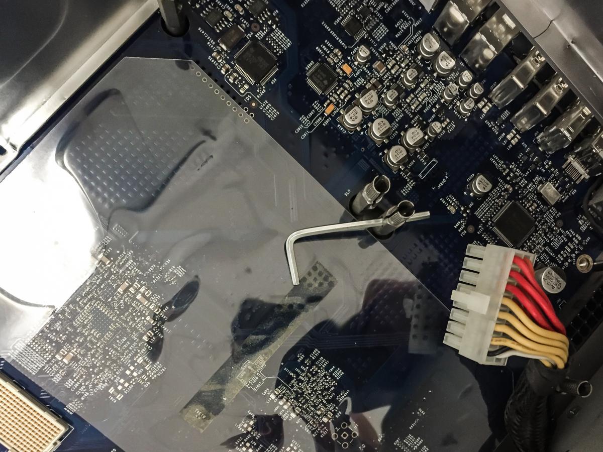

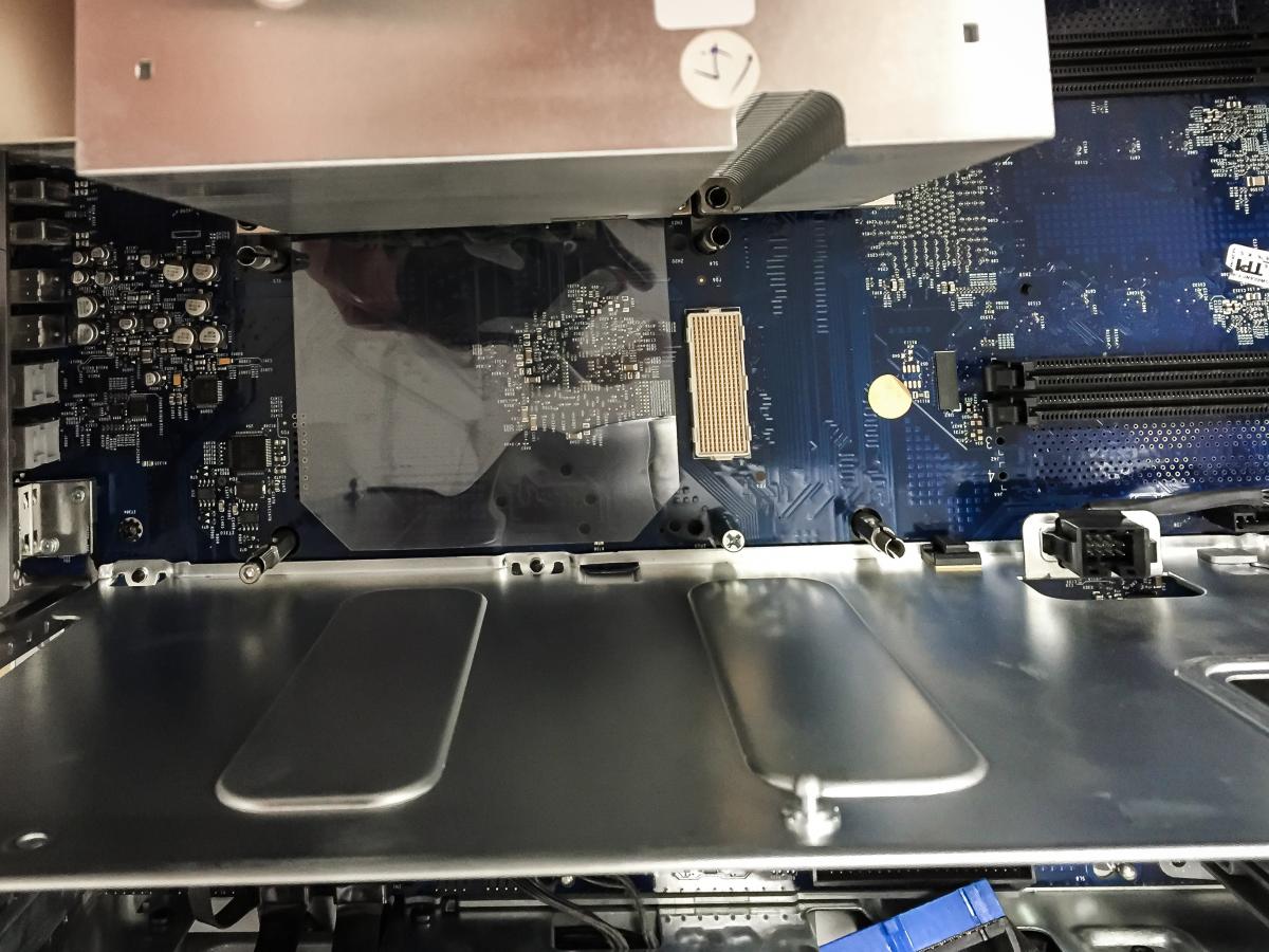

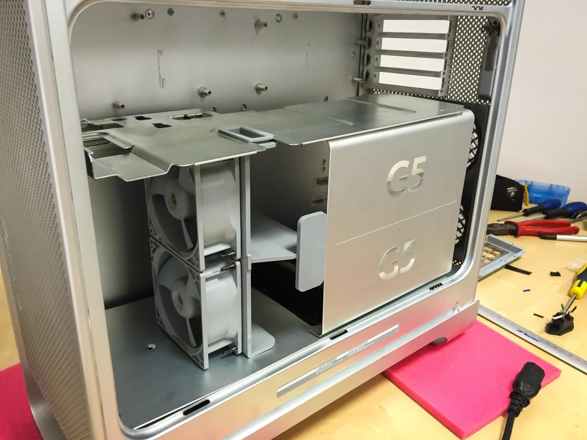

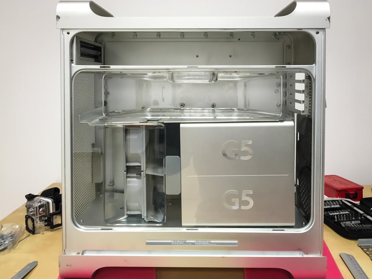

Here are some photos from stage 1 - dissassembly of the G5.
post-1554477-0-82617300-1456699516_thumb.jpgpost-1554477-0-92801700-1456699519_thumb.jpgpost-1554477-0-21878300-1456699551_thumb.jpgpost-1554477-0-67972300-1456699522_thumb.jpg

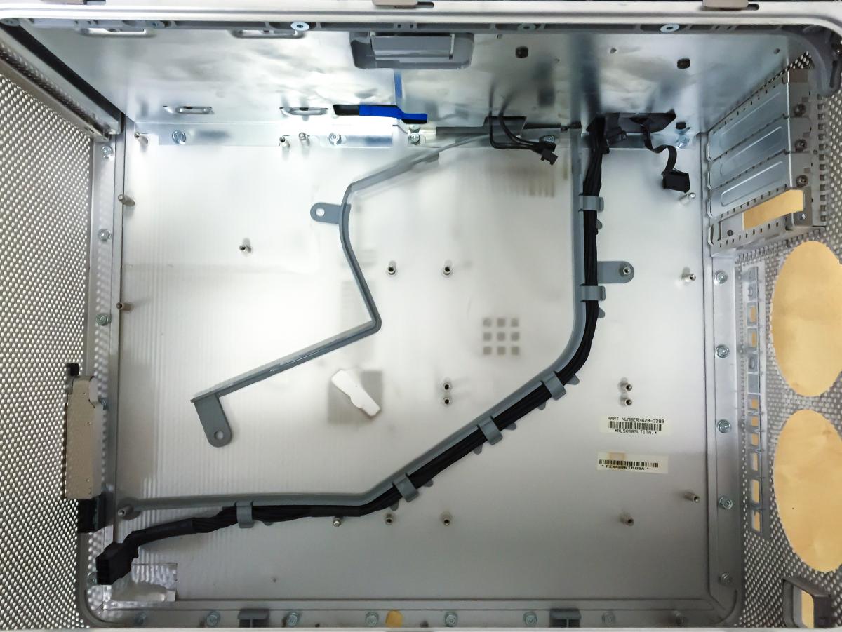

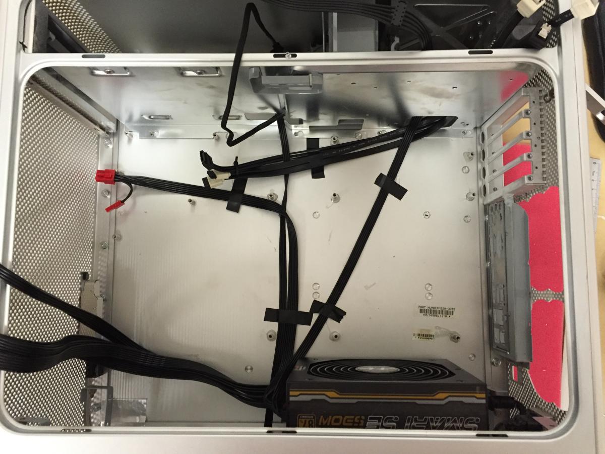

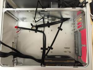

Ok, so the mod continues.

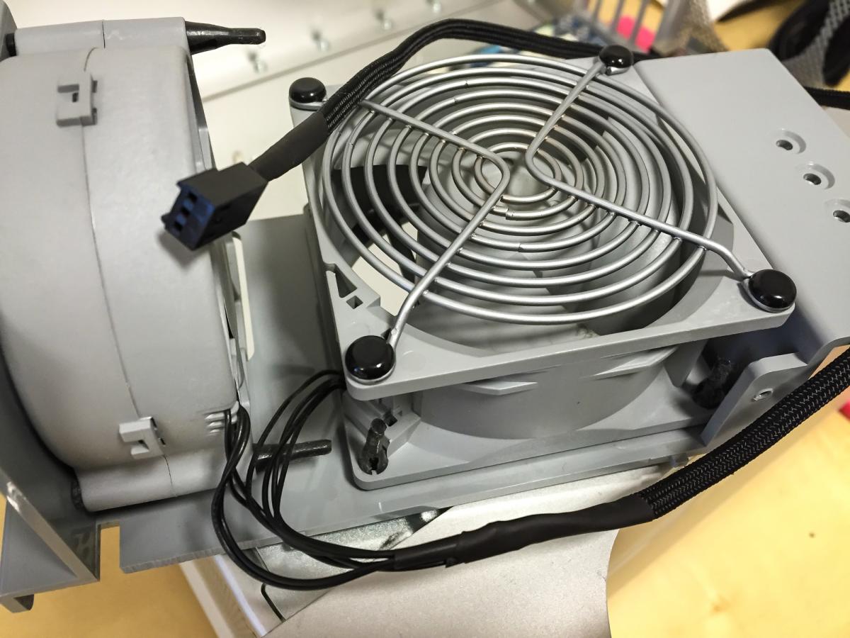

Now, i'm preparing the fans, front panel and dividers for new components. All of 4 FANs have 3 PIN plug. I'll use fan controller or molex splitter. Stil didnt decided if it'll be @5 or @7V. I think i'll decide after overclocking the cpu (which will be mounted with Scythe Ninja 3 (passive). The cooling is very good - now (also passive) the i5 3570k @4.4Ghz temperatures are 38 deg. at office work and ~50 deg. at stress.
I've realized that I dont have cables for front panel - audio and usb. Just ordered them so the project will have to wait few days.

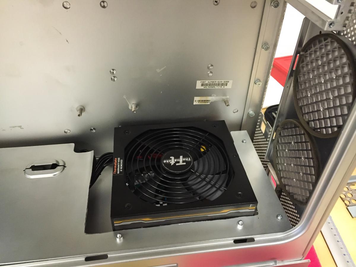

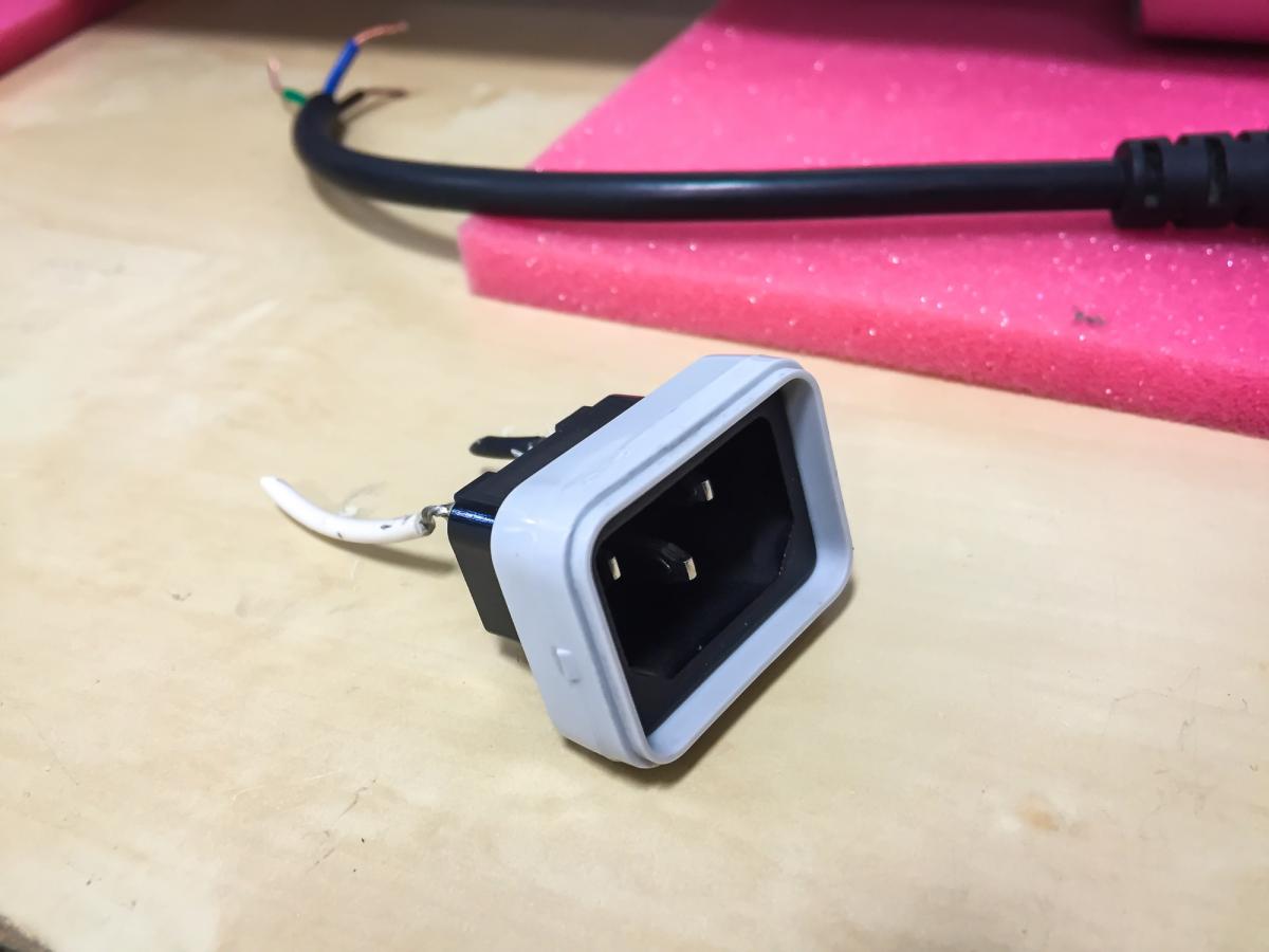

At this point I'm rather happy because the PSU is fully covered by original G5 cover. All of the PSU cables will go under MOBO (thermaltake have flat cables - yay) using original plastic guide.
The power cord is glued with original plastic cover - i'll nicely be placed at original position.
post-1554477-0-49444600-1456996462_thumb.jpgpost-1554477-0-85269500-1456996459_thumb.jpgpost-1554477-0-20516300-1456996461_thumb.jpgpost-1554477-0-37377900-1456996455_thumb.jpgpost-1554477-0-57896100-1456996458_thumb.jpg

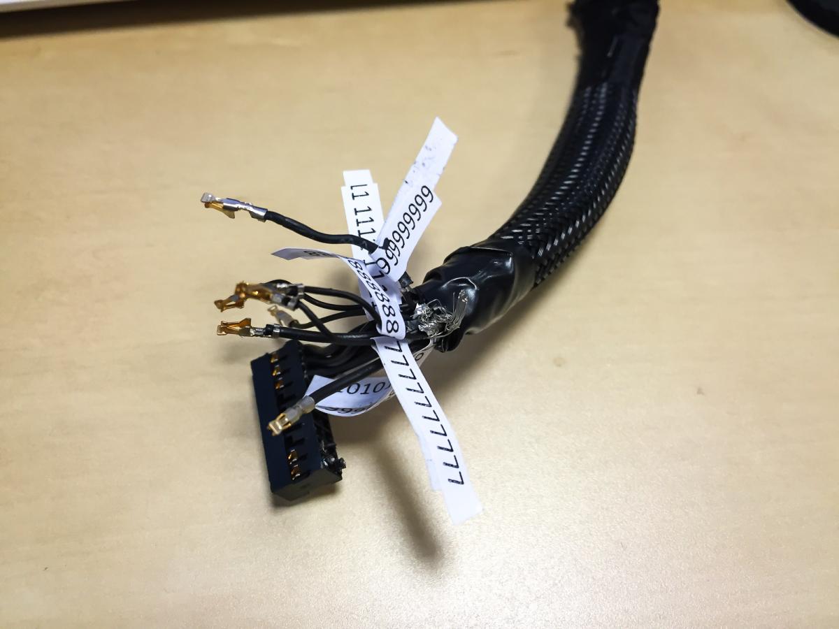

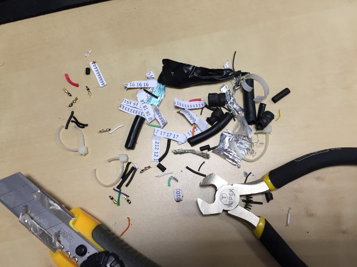

Most timetaking part of the project - rewiring the front panel. After searching GND for PWR Switch (it must be connected from FireWire), everything works like a charm :)
bundle of cables after the job.
and the mess...

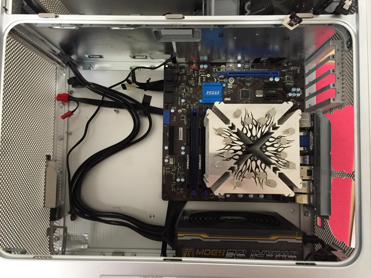

Well, the job is done in 95%. Now I have to made back plate to cover holes and still waiting for some black voltage sata cables, to connect third disk (it'l replace tri-color one which can be seen at photos).
First I ran FANs @12V. Well it wasnt a good idea. I cant stand the noise... Switched 12V to 5V and it's ok, but still rather noisy. I'll order potentiometer and mount it on 5V voltage cable, to make it less noisy.
post-1554477-0-49825300-1457817095_thumb.jpgpost-1554477-0-77978300-1457817097_thumb.jpgpost-1554477-0-83950200-1457817099_thumb.jpgpost-1554477-0-63961400-1457817101_thumb.jpg
OS X is already installed. Almost everything works fine... besides booting with dual monitors plugged in (got restart loop). Still struggling with HD4600 and 2 screens, but on good way to solve the problem (framebuffers).
I didn't excpect such problems after working on i5 3570k (HD4000) without any problems at all.

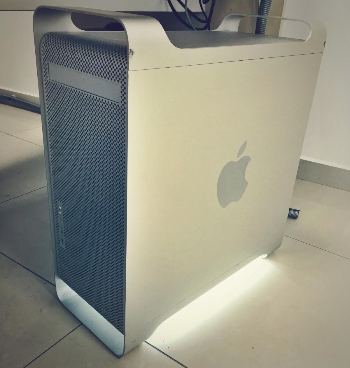

Thanks for your Wow :) This project really satisfied my. So far I had to change GPU to get CUDA support (from GTX 260 to 960) and Hack runs macOS Sierra 10.12.2 without any problems. Everythings work fine - wifi, bt, iMessage and Handoff!
