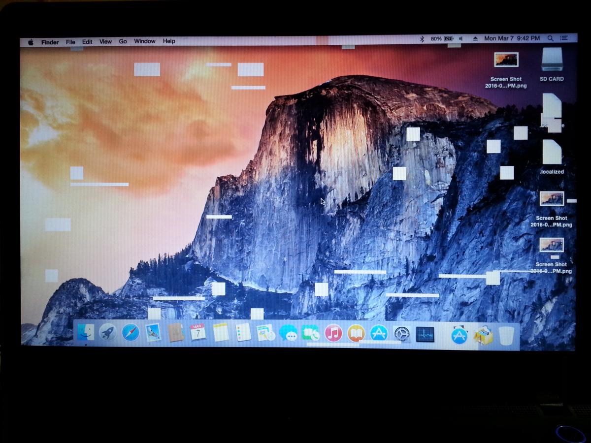

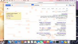

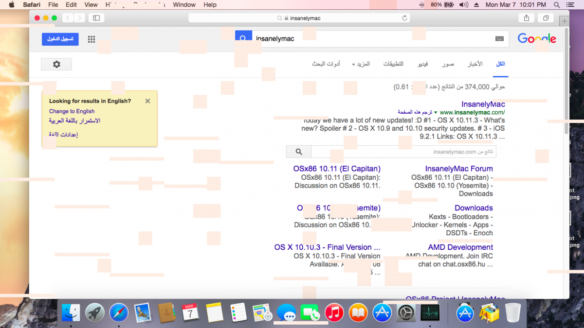

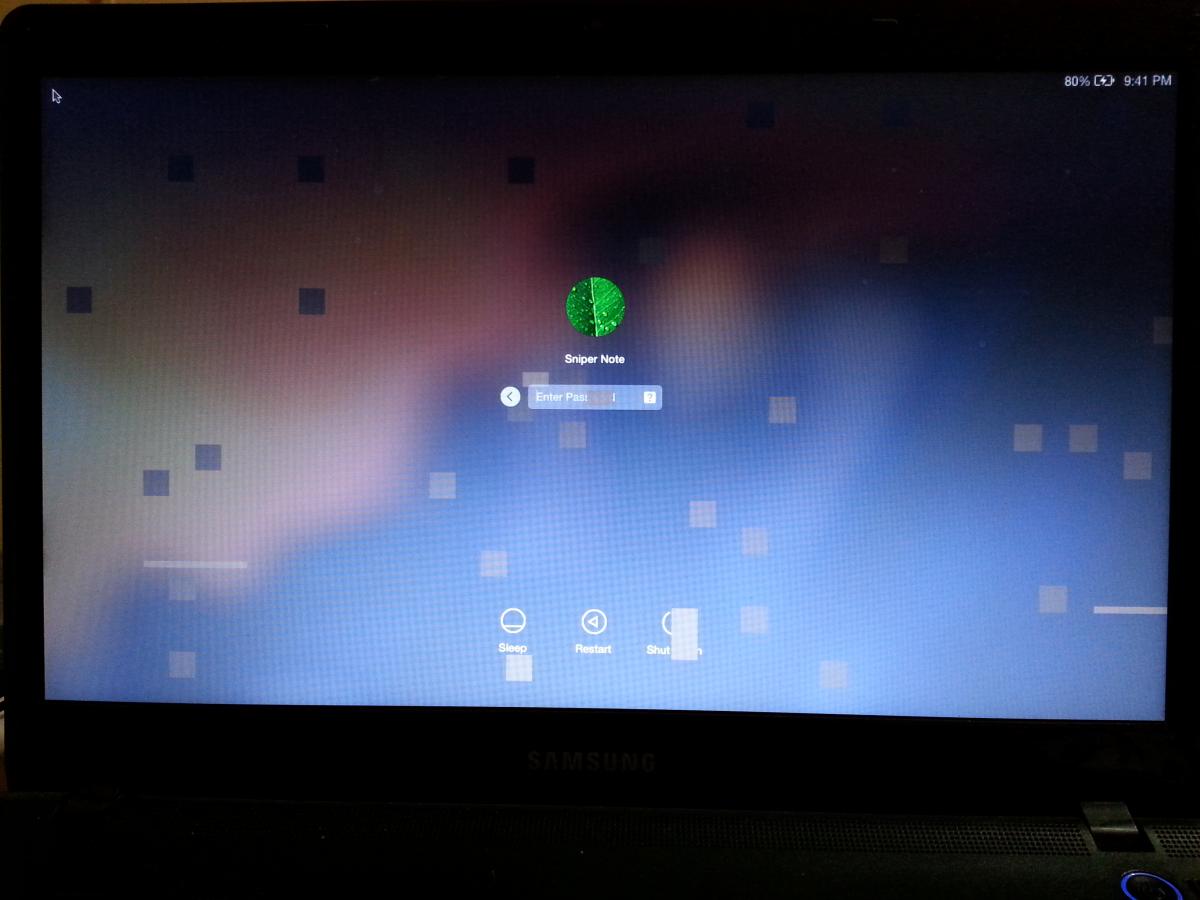

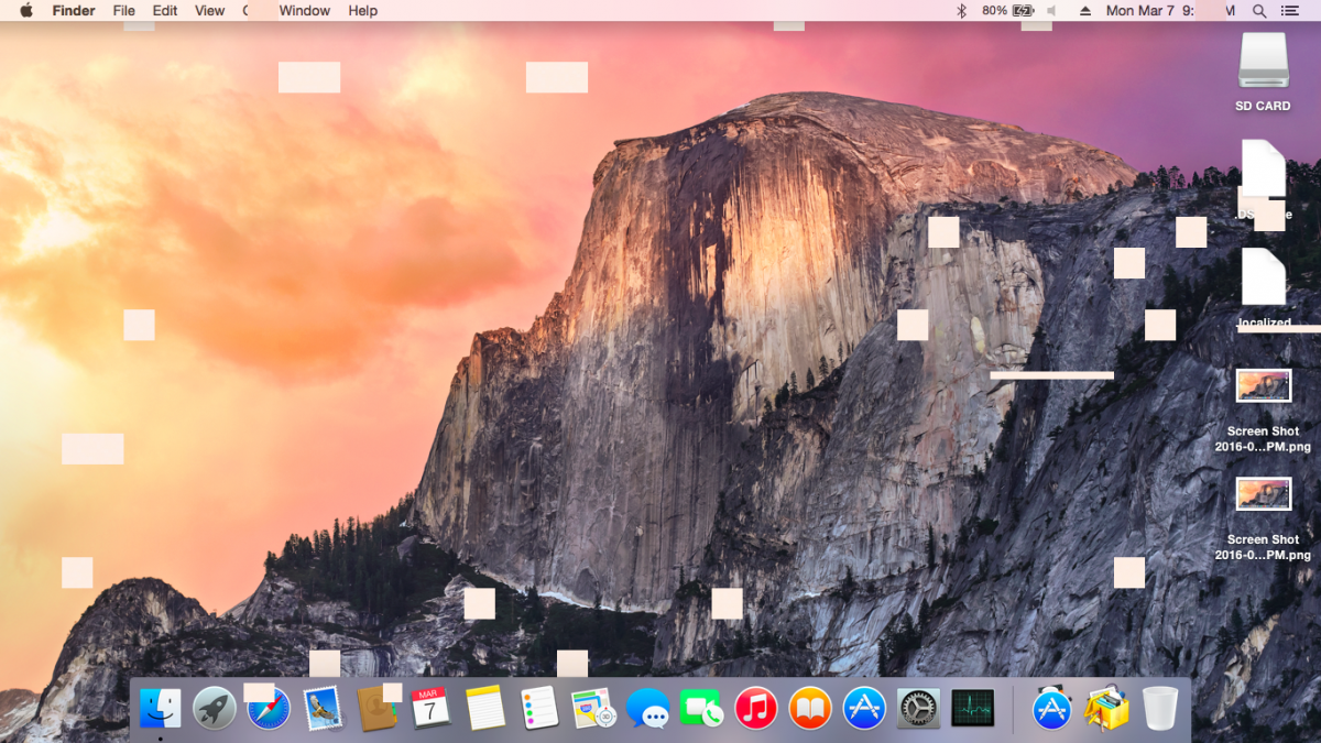

sniper9911 Posted March 6, 2016 Author Share Posted March 6, 2016 Ok my screen shot are working fine now But i am still having problems with artifacts on my intel hd 3000 I tried disabling nvidia processor from clover but it just makes things worse so i got nvidia back on for now Both yosmite and elcapitan have the same issue now ... can you help me fihure this out ? Today i am working on fixing the cpu power managment to ditch using nullcpupowermanagment.kext Link to comment https://www.insanelymac.com/forum/topic/311088-post-install-for-el-capitan-10113-on-samsung-300e4a-s0esa-laptop/page/2/#findComment-2221042 Share on other sites More sharing options...

Allan Posted March 6, 2016 Share Posted March 6, 2016 Post your files here, like: config.plist, DSDT and SSDT. How you've enabled HD 3000? Link to comment https://www.insanelymac.com/forum/topic/311088-post-install-for-el-capitan-10113-on-samsung-300e4a-s0esa-laptop/page/2/#findComment-2221137 Share on other sites More sharing options...
sniper9911 Posted March 6, 2016 Author Share Posted March 6, 2016 My hd3000 was vanilla when osx installation usb was done Now i think i did some dsdt patching for it (rehabman repo i chose hd3k_low ) because i run native res of 1366x768 Link to comment https://www.insanelymac.com/forum/topic/311088-post-install-for-el-capitan-10113-on-samsung-300e4a-s0esa-laptop/page/2/#findComment-2221270 Share on other sites More sharing options...
Allan Posted March 7, 2016 Share Posted March 7, 2016 Ok, but post here the files that i've said to you above. For analysis Link to comment https://www.insanelymac.com/forum/topic/311088-post-install-for-el-capitan-10113-on-samsung-300e4a-s0esa-laptop/page/2/#findComment-2221279 Share on other sites More sharing options...
sniper9911 Posted March 7, 2016 Author Share Posted March 7, 2016 this is my current EFI Folder i am booting OSX from clover most stuff now working on yousmite 10.10.2 (except nvidia card and wifi , intel hd3000 sometimes artifacts , longer boot time after ssdt.aml and removal of nullcpu kext) on elcapitan 10.11.3 i have that USB problem and camera still not recognized , bluetooth is not working also brightness works , buttons works also using appleintelbacklight.kext from rehabman battery works thanks to rehab man dsdt patch for samsung series 3 laptop applehda is patched and dsdt patched alot also (osx86 link ) dsdt patches applied so far are these : battery -rehabman brightness -rehabman sound "Fix _WAK Arg0 v2""SMBUS Fix""IRQ Fix""RTC Fix""OS Check Fix""Fix Mutex with non-zero SyncLevel""Fix PNOT/PPNT" (use only if you're dropping CPU related SSDTs)"Add IMEI" HPET dsdt fix did not compile correctly , gives syntax error _CRS so i did not apply it because i couldnt save dsdt.aml after that ssdt.aml generated by Maciasl app from rehabman original dsdt.aml i got from Maciasl.app also i did not try sleep and wake up yet on osx , i want to fix my graphics problem and cpu pm first Link to comment https://www.insanelymac.com/forum/topic/311088-post-install-for-el-capitan-10113-on-samsung-300e4a-s0esa-laptop/page/2/#findComment-2221376 Share on other sites More sharing options...
Allan Posted March 7, 2016 Share Posted March 7, 2016 Try this: EFI.zip Link to comment https://www.insanelymac.com/forum/topic/311088-post-install-for-el-capitan-10113-on-samsung-300e4a-s0esa-laptop/page/2/#findComment-2221415 Share on other sites More sharing options...
sniper9911 Posted March 7, 2016 Author Share Posted March 7, 2016 Ok trying nowElcapitan booted normally and the nvidia card was onThen i tried booting osx yousmite and got stuck before the login screen , screen was black and mouse pointer was in the top left edge and keeping doing the circle icon , i never saw the login screen so i force shutdown and try booting againg and now i see this on yousmite (screen garble very severe )Also garble changes if i move mouse and open finder or if i just want to shutdown osxThses are the images from my second boot on yousmiteBooting still takes alot more time than before ( both osx are on ssd and laptop has 8gb ram ) just tried again to boot yousmite after elcapitan and i got screen garble again :( Link to comment https://www.insanelymac.com/forum/topic/311088-post-install-for-el-capitan-10113-on-samsung-300e4a-s0esa-laptop/page/2/#findComment-2221534 Share on other sites More sharing options...

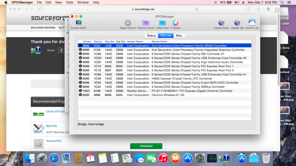

Allan Posted March 7, 2016 Share Posted March 7, 2016 Ok. Download DPCIManager.app and go to PCIList section, take a screenshot and post here please. Link to comment https://www.insanelymac.com/forum/topic/311088-post-install-for-el-capitan-10113-on-samsung-300e4a-s0esa-laptop/page/2/#findComment-2221577 Share on other sites More sharing options...
sniper9911 Posted March 7, 2016 Author Share Posted March 7, 2016 here it is Link to comment https://www.insanelymac.com/forum/topic/311088-post-install-for-el-capitan-10113-on-samsung-300e4a-s0esa-laptop/page/2/#findComment-2221607 Share on other sites More sharing options...
Allan Posted March 7, 2016 Share Posted March 7, 2016 Ok. What version of Clover you use? OBS: Do a EC reset = shutdown, remove battery, remove AC plug, hold power down 30 sec, put everything back & restart. Credits: RehabMan 1 Link to comment https://www.insanelymac.com/forum/topic/311088-post-install-for-el-capitan-10113-on-samsung-300e4a-s0esa-laptop/page/2/#findComment-2221633 Share on other sites More sharing options...
sniper9911 Posted March 7, 2016 Author Share Posted March 7, 2016 Clover_v2.3k_r3346 ok i will do EC reset and boot OS X afterwards booting on battery now first i booted osx yousmite booted successfully , no screen garble now i will boot elcappitan and boot back to yousmite update : elcappitan boot fine , no screen garble boot yousmite afterwards i got one black line on my wallpaper screen , changed the wallpaper and the black line is gone almost no screen garble now nvidia card is missing in my device list now elcapitan still doesn't see my bluetooth and camera boot time is better now , fast , i open maciasl app and generated ssdt_1.aml (CPUCst) and put it in patched folder with dsdt and ssdt 1 Link to comment https://www.insanelymac.com/forum/topic/311088-post-install-for-el-capitan-10113-on-samsung-300e4a-s0esa-laptop/page/2/#findComment-2221635 Share on other sites More sharing options...
