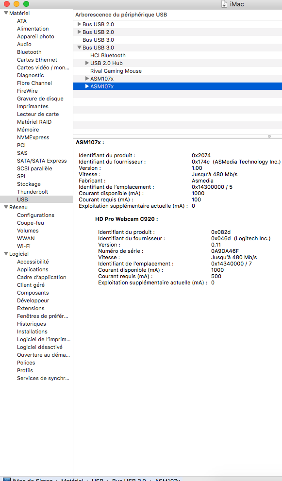

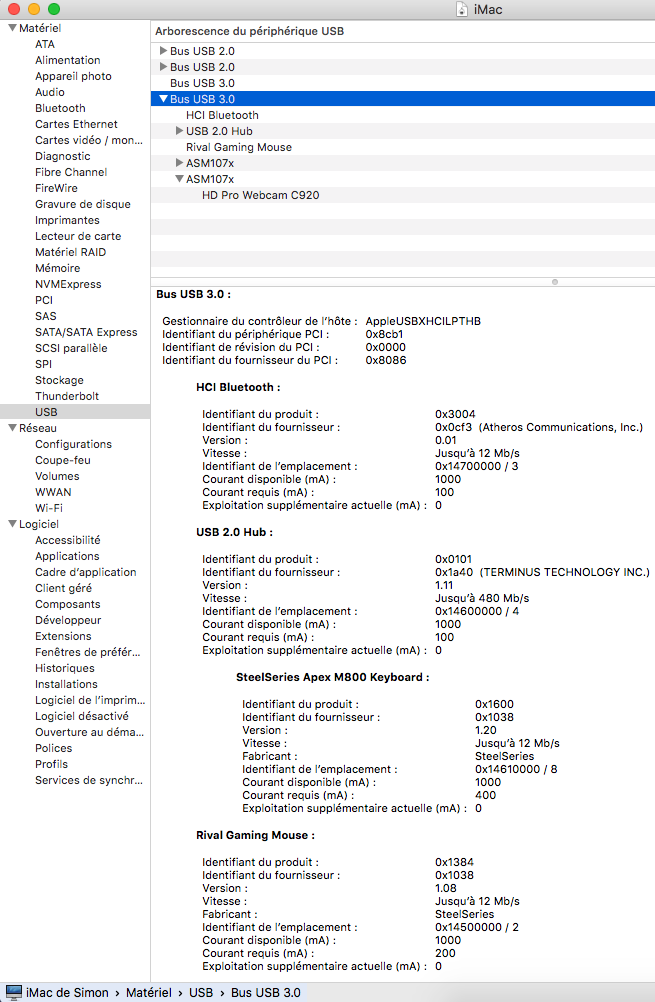

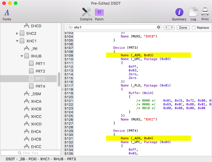

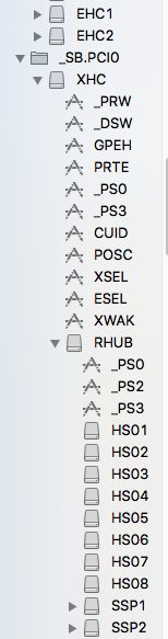

simras Posted January 25, 2016 Share Posted January 25, 2016 Hello i start a new post, i have a problem with my USB 3.0 ports, impossible to mount USB 3.0 key/drive on USB 3.0, but USB 2.0 key/drive can mount on 3.0 ports. I try to follow this guide : http://www.insanelymac.com/forum/topic/306777-guide-usb-fix-el-capitan-1011/ but in 2b. impossible to find XHC1 in my dsdt so impossible to finish the tutorial, but think that only for usb 3.0 INTEL ports. I listen that for some people, genericUSBXHCI.kext work under El Capitan 10.11.3 for repair USB 3.0, for me not. For my smbios i use iMac 14,2 I link my config.plist for Clover, my dsdt, my ioreg and a screen of USB preferences. So if someone can help me for fixing that USB 3.0 ports... Thank you. DSDT.aml.zip iogen.zip config.plist.zip Link to comment https://www.insanelymac.com/forum/topic/310585-msi-z97a-gaming-9-ack-usb-30/ Share on other sites More sharing options...
artur_pt Posted January 25, 2016 Share Posted January 25, 2016 hello sure u have look harder .. good hack Link to comment https://www.insanelymac.com/forum/topic/310585-msi-z97a-gaming-9-ack-usb-30/#findComment-2210239 Share on other sites More sharing options...
simras Posted January 25, 2016 Author Share Posted January 25, 2016 But that not match on what say pokenguyen ?! See on his screen, he does not go here ? Link to comment https://www.insanelymac.com/forum/topic/310585-msi-z97a-gaming-9-ack-usb-30/#findComment-2210242 Share on other sites More sharing options...
artur_pt Posted January 25, 2016 Share Posted January 25, 2016 hello what poken use is a example .. not ur bios .. or dsdt anyway ur dsdt without errors and several patch applied (sata,sbus,lpc..etc ) DSDT.aml.zip good hack Link to comment https://www.insanelymac.com/forum/topic/310585-msi-z97a-gaming-9-ack-usb-30/#findComment-2210243 Share on other sites More sharing options...
simras Posted January 25, 2016 Author Share Posted January 25, 2016 And if i follow this guide, there is no sens, if HS = USB 2.0, SSP = USB 3.0, mean that i have 8 usb 2.0 and 2 usb 3.0 ??? my motherboard have 2 usb 2.0, 6 usb 3.0, 2 usb 3.1 ok i go try that dsdt ! thanks. Ok so i place the dsdt fil into /EFI/CLOVER/ACPI/Patched reboot and nothing :/ Link to comment https://www.insanelymac.com/forum/topic/310585-msi-z97a-gaming-9-ack-usb-30/#findComment-2210246 Share on other sites More sharing options...
